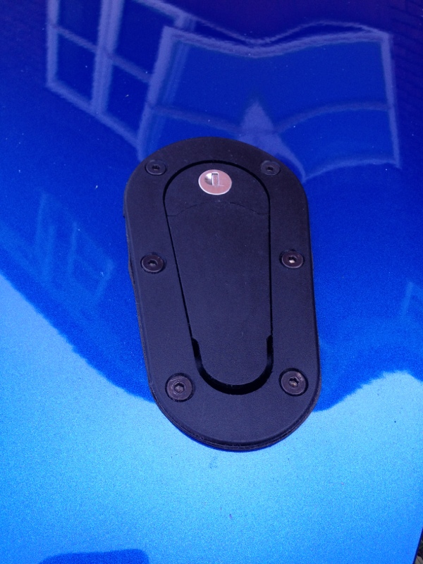

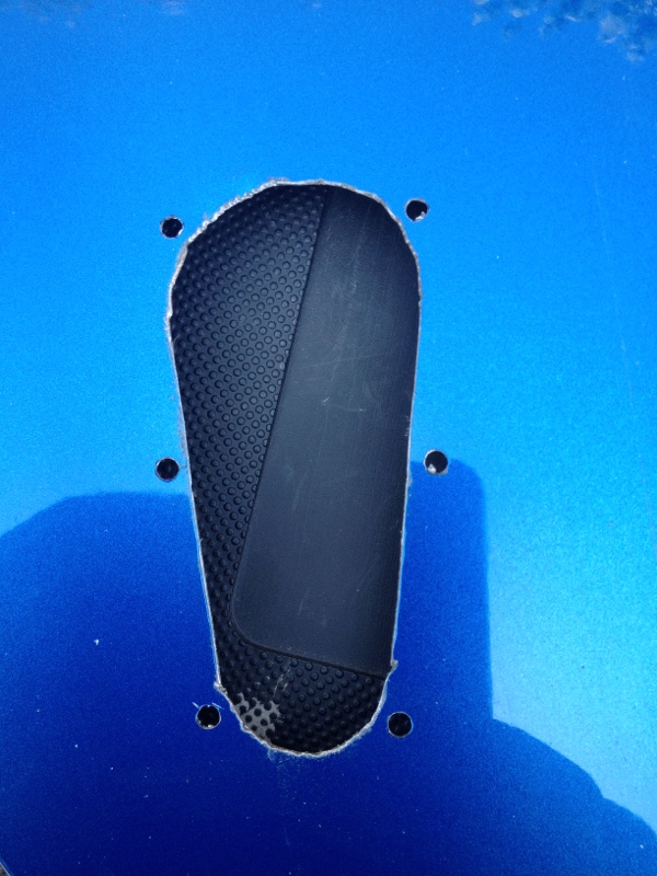

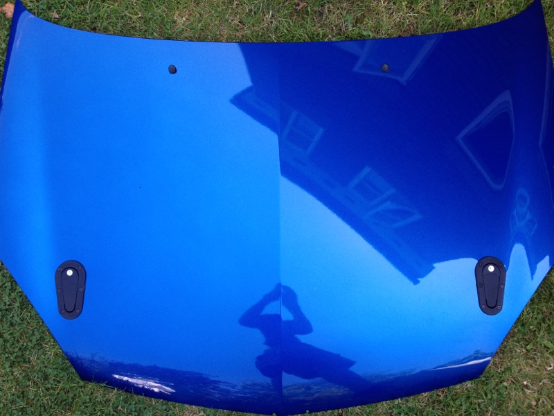

Today I finished off the job I have working on during the week - the aerocatches.
I managed to cut out both inner skins (allowing clearance for the nuts) and drilled the 4mm holes required to fix the catches. The dremel cutting disk, although quite fragile, produced quite a good finish:
I then filed any rough edges and applied a lick of paint to the bare metal. Following this I gave both sides of the bonnet a good wash down to remove any grinding dust (it gets everywhere!). Finally, I fastened the catches in place and was glad that job was over:
I'm pretty chuffed with the final fit to be honest. The time Mike and I put in to measuring it all out paid off. The catches do fit flush, line up with the profiles in the bonet and create next to no distortion in the surrounding panel area :)
The only small job left to do is fine tune the strike pin and bumpstop height but that can wait for final fit of the bonet after the engine is dropped back in.

Neat job on The catches!
Just bolt the fan to the rad, Fred will no doubt kick off but the plastic fasteners are just poo.
Really neat job on the catches :) Worth taking the time to get right as they always look bad if not done well!

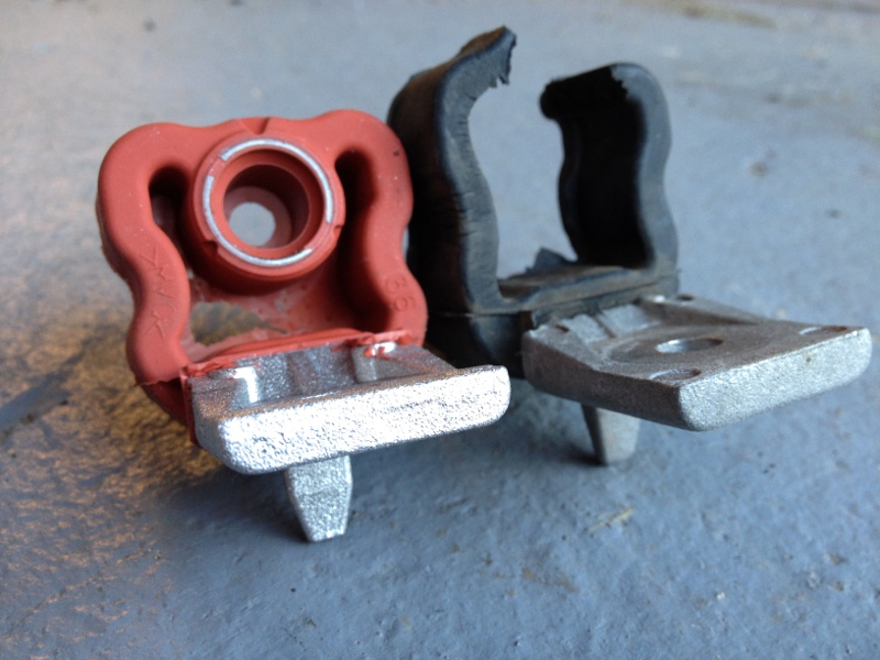

I was due to remove the rear exhaust silencer this evening but im afraid it never happend. I wheeled the car out on the drive, jacked it up and loosened off the rear mount. Next up I the rear to middle section bracket was removed. All going well up to this point. I then tried removing the rear section but despite my best efforts it was stuck fast! I'm not normally one to swear that much but ******* *** that exhaust ****** me off! - lol. With the engine out the whole exhaust was just swinging around so I couldn't leverage it againt anything else. After about 1hr I gave in - a job for the ramp me thinks.
As i had the car jacked up I set about replacing the middle mount as that was broken - see below (new v old):
Replacing that little bit was a nice little job in itself. It took me a while to realise that our exhaust bracket has a screw in spacer/washer to prevent the exhaust slipping out of the mount - cunning!
The exhaust now sits quite nicely. Im not sure for how long as I thing i have heard the centre mounts are a bit weak - bit like the rears I suppose.

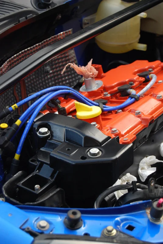

Just a little tease at what I've been doing today.

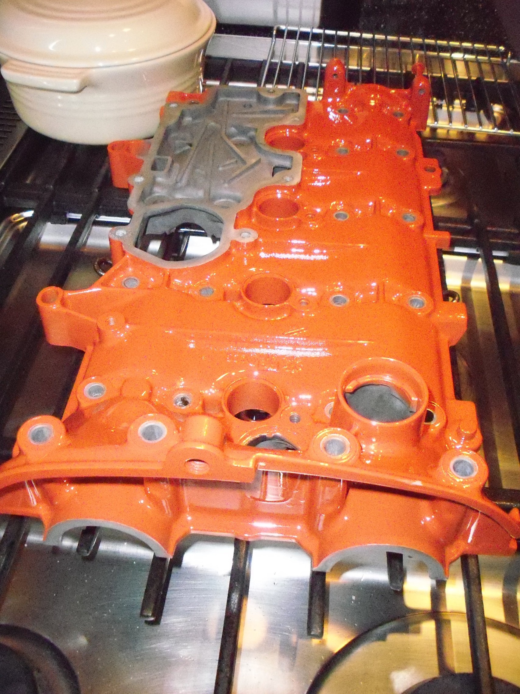

Had the cam cover cleaned, casting splatter removed and smoothed down, and then a mild acid dip, wash and hung to dry in our powder coating booth for an hour. More pics to follow ;)
All masked up ready for some paint... I used M5 bolts and a washers to mask the stud fixing points. I was a little worried that the paint would settle once the bolts were torqued down, so this was my failsafe. We will probably paint the bolt heads or I might have them chemically blacked if there is enough time.
Blast! I was hoping to see the finished product :)
Nice prep work though!

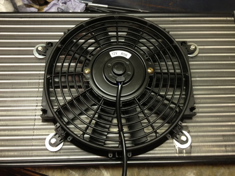

I have finally pulled my finger out and fitted the fan to the rad tonight. Just need to get some penny washers tomorrow to displace the pressure on the rad fins.
Mike - can you get an electrical connection for our new fan please? Obviously, it's 12 volts but not sure how many amps load it should be able to handle? Would prefer a connector just incase we need to remove the fan in the future and therefore not have to cut wires each time.
No doubt speak tomorrow;)
Looking good :)!
I used rubber tap washers on mine just to allow for expansion in the rad but I don't know if that was the correct thing to do!
I run a 10" fan now and it's rated to 11amp's so I need to get a 15A connector I guess your's will be similar :)
As Nick keeps reminding me, I for once brought home the connectors. I also found some 5mm penny washers but one seemed to escape during the day...

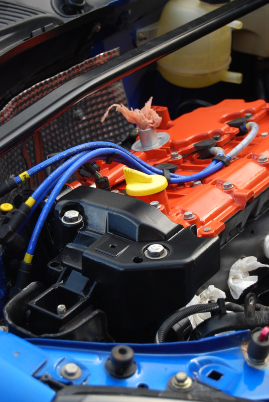

As mentioned yesterday, I had the cam cover baked in our oven today, it will still need a few days to cure hard but good results :) The orange is a bit more darker in person, sorry for the poor camera pics.
Primer:
Top coats:
Mike- That looks really nice on my phone. Also, you know you mentioned about the breather plate fitting hole looking different to the plenum. The spare plenum in your garage might be from a ph1 which I think is different. So, it should fit our propper one:)

Finished mounting the fan to the radiator tonight. Due to recommendations by others I chose to use bolts rather than the plastic ties shipped in the box. M5's fit through with ease i used the supplied sticky rubber pads to allow for a little bit of expansion. Looks like the connector Mike has got will be perfect for the fan too:)

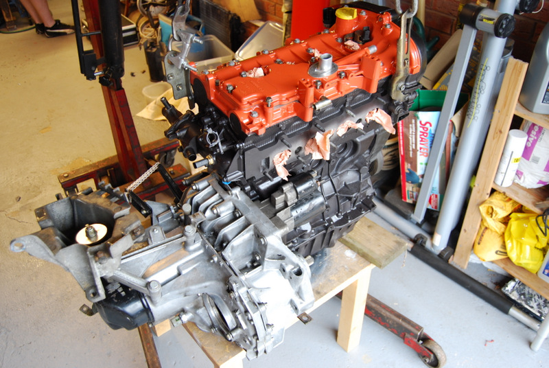

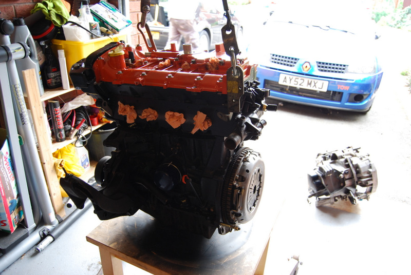

Yesterday Mike and I travelled see Fred @ BTM Performance, who over the period of the last x months had been building our new engine. It was to be a good day as the engine was finished - waiting in the workshop for the both of us on our arrival :)
After a bit of a chat with Fred we loaded the engine, fluids and a load of other miscellaneous items in to the back of the car and headed home. Now seems a good enough time as any to attempt to summarise what we have got:
Bored and Honed block to suit-
Wosner 83mm (2012cc) high comp (12.8:1) forged pistons
Vel Satis/F4RT rods
ARP rod bolts
New bearings/seals and oil pump
Cat Cams 438 camshafts (we supplied)
Polished/minor ported head (from old engine) with new stem seals and re-lapped valves
New belt and VVT pulley with oversized tensioner (to suit skimmed head)
New valeo clutch
Probably lots of other stuff that i have forgot about/Fred will know.
We are all hoping that it should go pretty well and make a nice noise whilst doing it!

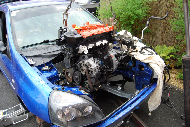

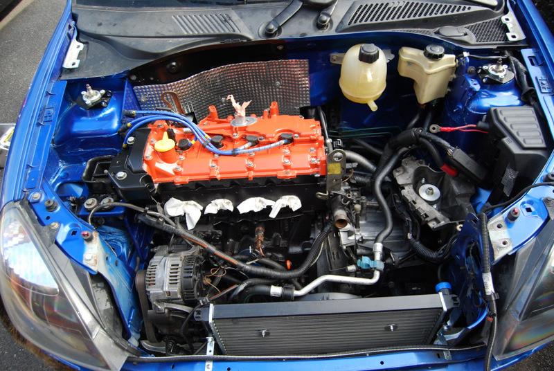

This morning we started the installation by refitting the gearbox, starter, mounts, alternator and PAS pump.
Typically, when we were ready to start putting the engine back in the car the heavens opened :( Rather than sit waiting for it to stop we decided to use this time to measure up a few bits an pieces that are required to complete another little side-line project Mike and I have been working on recently. More info about this in future updates hopefully.
Anyway, the skies cleared late in the morning and we were able to crack on :)
By the end of the afternoon we had the engine in, most of the sensors plugged, driveshafts in and wheels back on. It sounds easy when you write it like that but it was a bit of a job getting the engine in to be honest. I remember when we removed it that it was tight by the chassis legs but putting it back it in is definately harder! I think the hoist went up and down at least half a dozen times getting the exhaust manifold around the starter motor whilst, at the same time, getting the gearbox past the chassis leg.
I think we are 70% there. Off the top of my head we need to finish tidying/fastening the loom, fit inlet and filter box, install hoses then fill all the fluids.

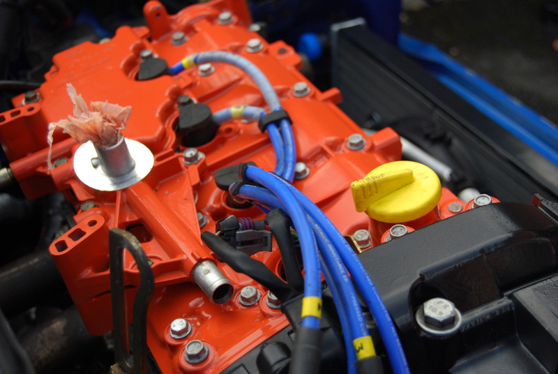

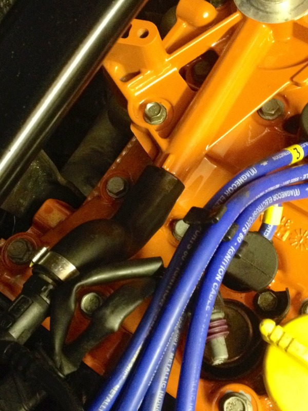

Btw - the rocker cover is painted with VHT - Hemi orange. Its quite a good finish but the colour could be a little stronger to be honest. Still, looks lots better than it previously did.
Hopefully by next weekend we should ready to briefly fire it up on the drive before heading out on the roads to break it in.

you haven't blocked off the breather plate, you have to otherwise the thing will idle at 3000rpm! I did tell nick!
Dont worry, it's on my things to do list. I have the pipe. Plan to do it before the plenum goes on.
you have to fit the pipe BEFORE you fit the plate to the rocker or you'll knacker the paint, i hope you haven't already sealed the plate on!
