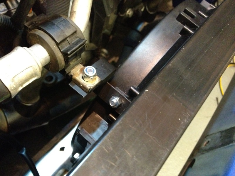

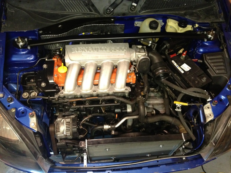

Made a little bracket for the PAS line:
Then put the inlet and plenum on:
I know the fuel rail guard isn't on there but it won't be staying like this for too long. And I cannot find the 2 long bolts to mount it with.
Fixed some other bits and bobs back in. Should be ready to fire up tomorrow evening. Fingers crossed!

Over 1 week without an update. Things didnt go quite to plan when we tried starting the new engine for the first time last week! Mike and I counted down from 3 then i turned the key and............nothing! Except for a popped fuse - doh!! Full details of problem listed here. Basically, the old starter motor solenoid wasnt working as it should and we had to swap out the starter this morning.
So once the motor was cranking over the engine (without firing - intentially) we checked the oil level and topped it up as the filter and other bits would no have filled up. We then connected the injector leads and it fired up pretty much first time :) Happy days! It idled at 2k though so we shut it off to check for air leaks. Couldnt spot anything with the pipework so proceeded to take it for a very short run to see what happened. When i put my foot on the brake the revs drop, but i know the servo vacuum pipes off the plenum so thats the reason for that i think. I tootled up the road, round the first roundabout then apply the throttle for the first time and nothing. Ooops - we dont have a working throttle body - despite it humming when turning on the ignition. Multi-plug is definately connected and Fred has since told Mike that if we have an air leak on the inlet it can knock out the throttle body.
Tomorrow i will be double checking the inlet and TB seals etc.
Overall, really chuffed that the car is now 100% back togther and finally running.
Will update when i know more and have fixed the TB issue.

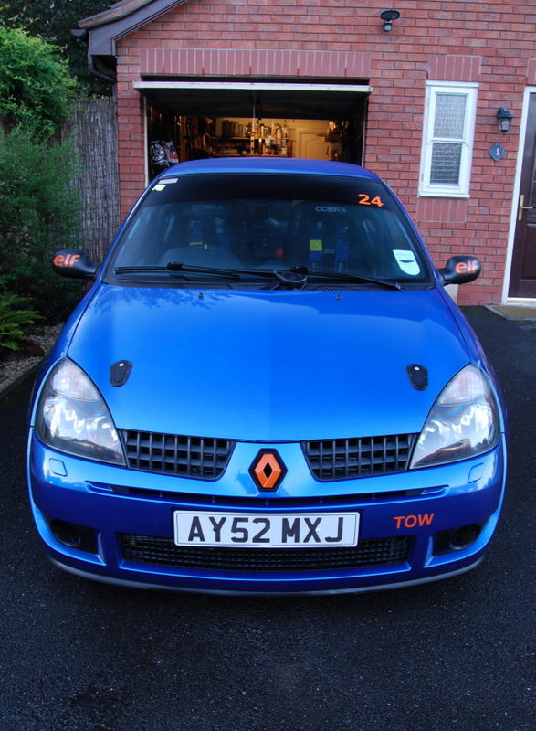

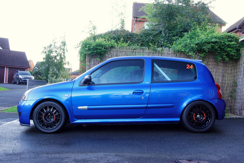

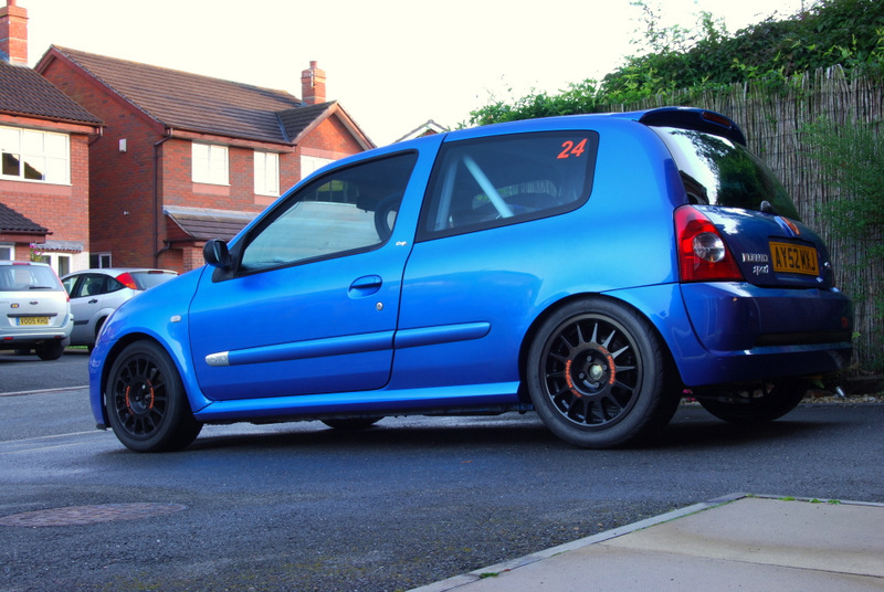

Wheeled the car out of the garage and gave it a very quick wash; the first one in 10 months! Plenty of dust had formed from its time in the garage. Hoping to start running in the new engine at the weekend so we can get it mapped in the very near future. We might even be able to start thinking about a trackday!
Couldn't resist a couple of photos (light was fading rapidly) to mark the occasion - it's been a very long winter for this car:
