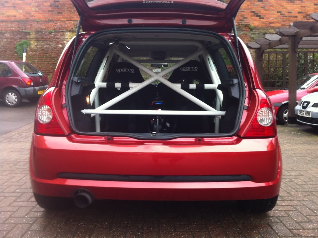

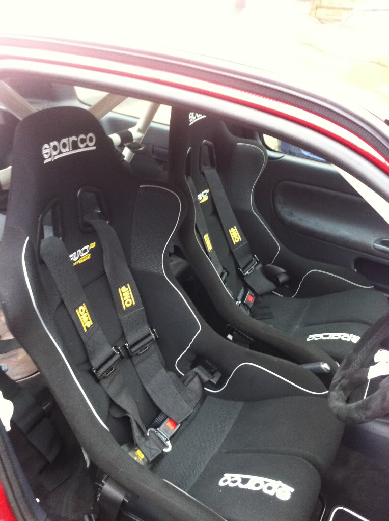

- 2x Sparco Evo 3 Bucket Seats
- OMP Subframes
- OMP 3" Harnesses

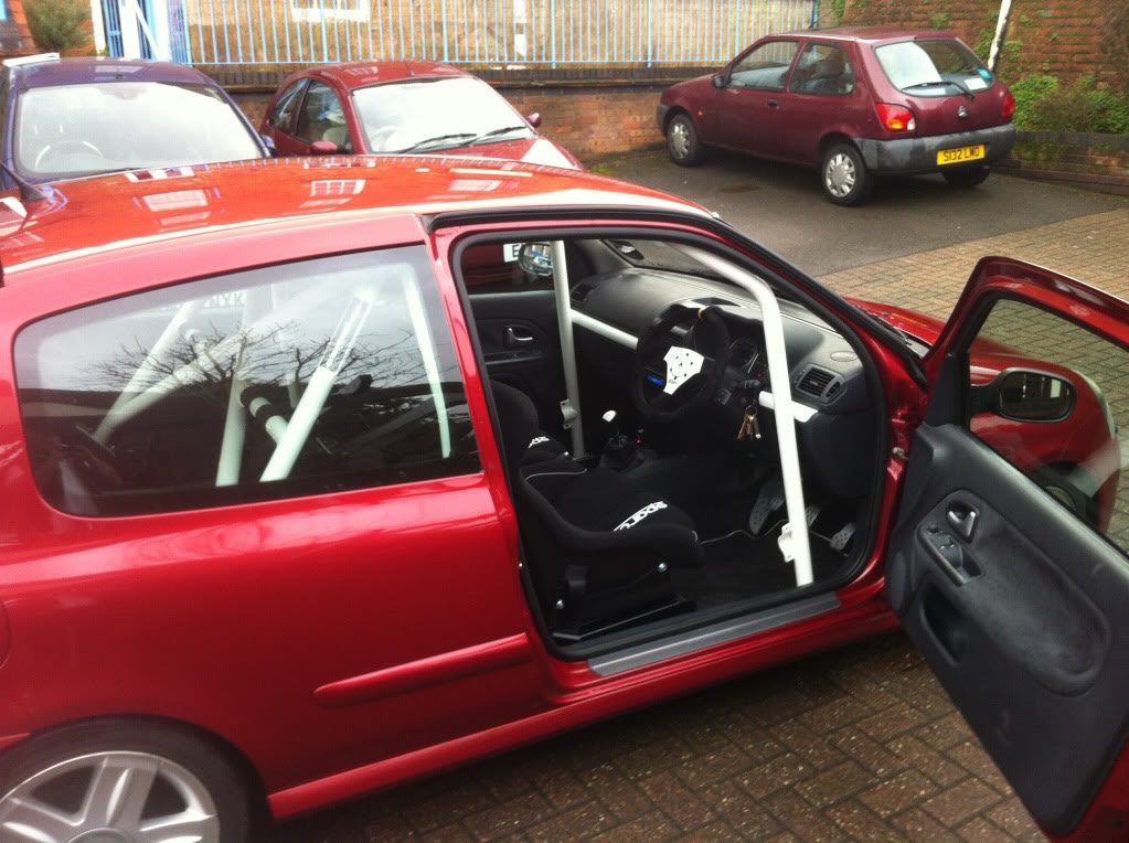

- 6 point Roll Cage

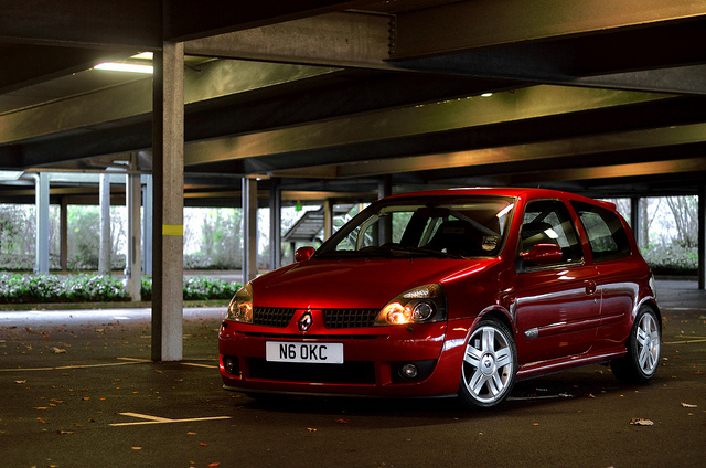

Piccies;

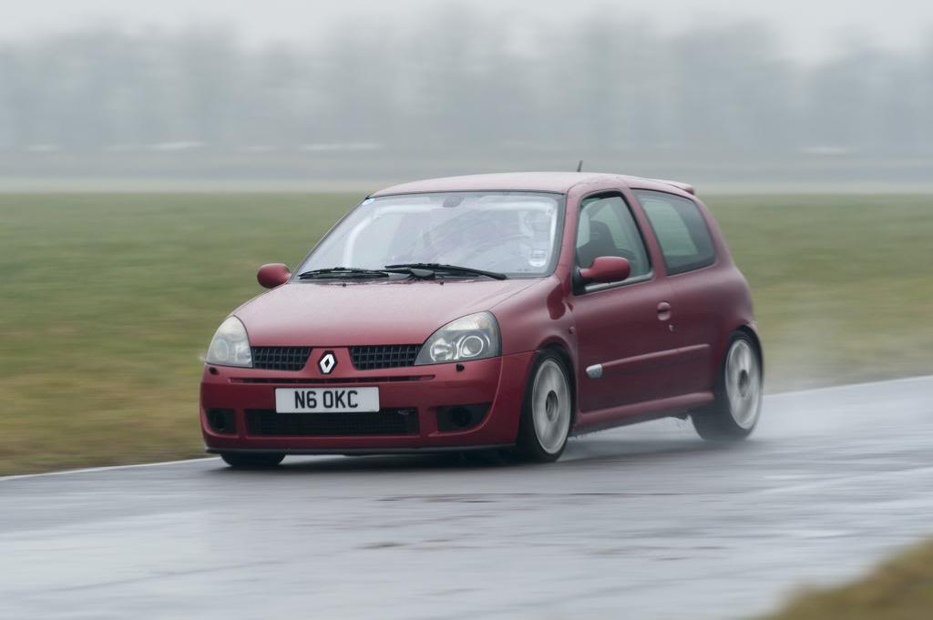

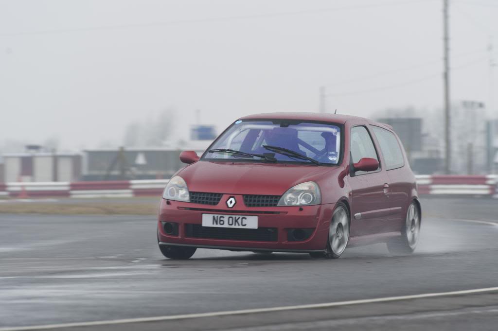

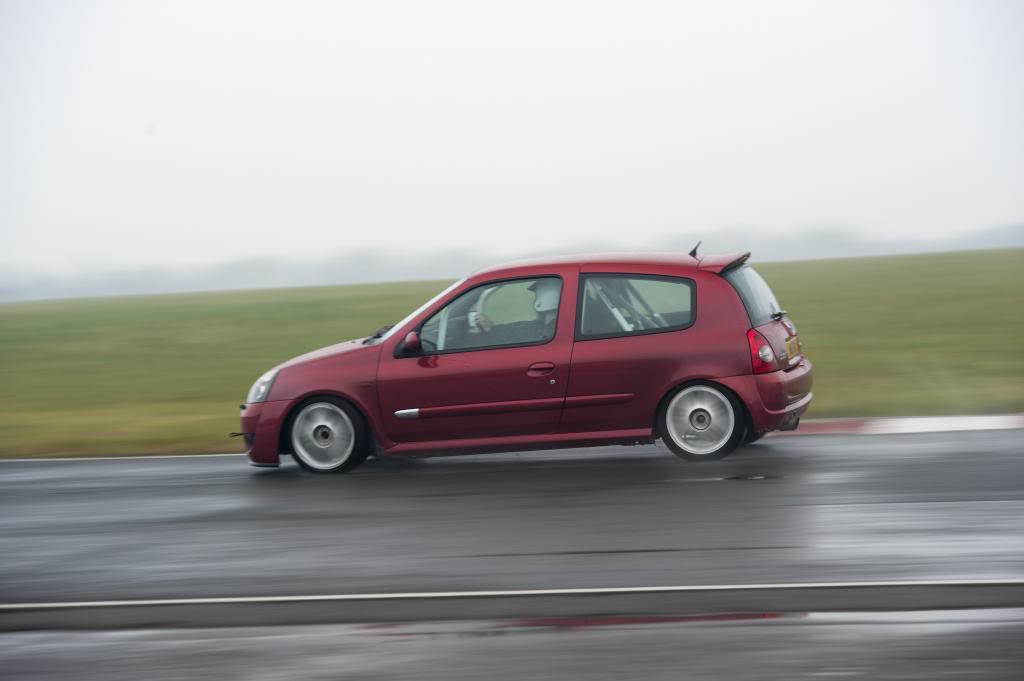

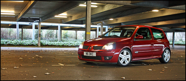

Here are some pics of it in action at llandow;

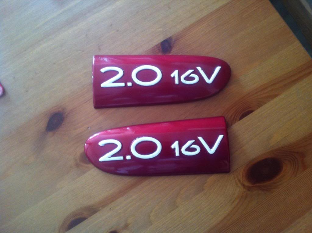

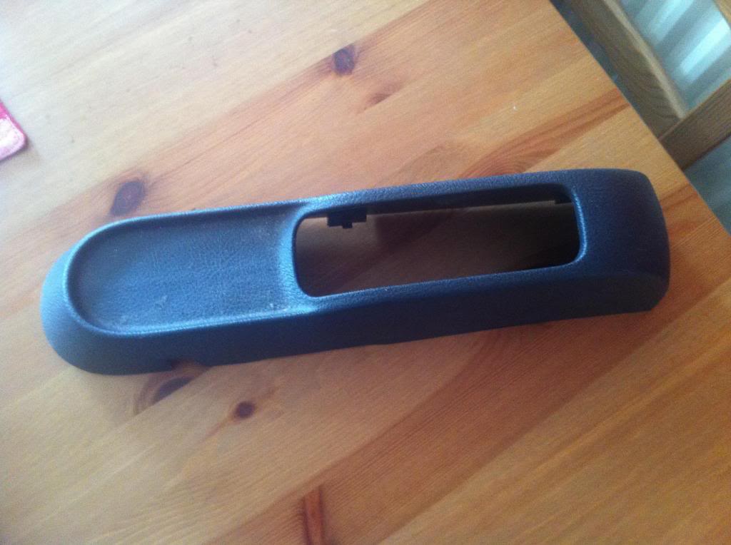

I hadn't put these photos in this thread yet, so dropped them in here as I love them and want the decent pics all in my project thread (courtesy of Luke and Ryan, who are much better with cameras than me).
