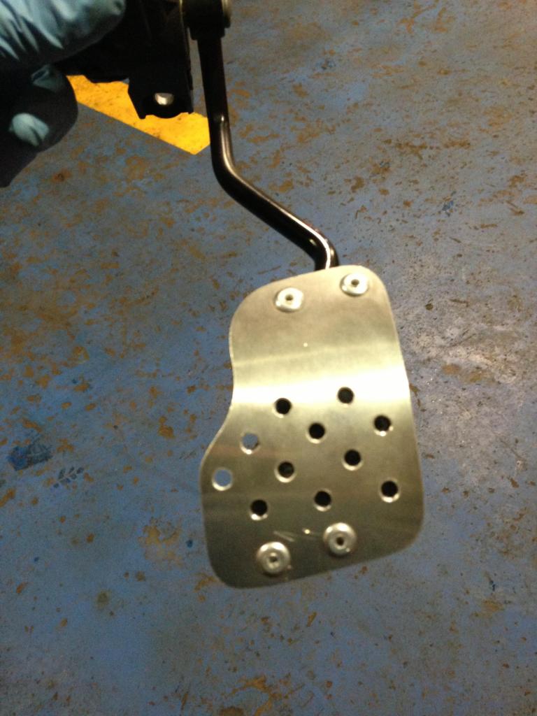

And a modified alloy accelerator pedal created by @NorthloopCup , to assist with Heel / Toe'ing. I believe he is putting these into fabrication so PM him if you want one :) @The Russian. @MicKPM @Nick172Cup Fletcher. @Tim.

The pedal looks good, northloop is a really great bloke.
it's all coming together now mate :)
Is that LSD oil necessary? If so il order some.

Your feet aren't big enough to do it without the extension ?

I like that pedal, I'll definitely be in touch with Mr @NorthloopCup
Mark is a top bloke, knows his stuff and is looking to bring some stuff out that is good for plenty of us CS folk. It's a shame he is a mincer @NorthloopCup
Looks good though. Coming together nicely, will we see you at SRR in the Micra love waggon ?
Lol! Size 12, but every little helps as my technique isn't really very good at the moment :o

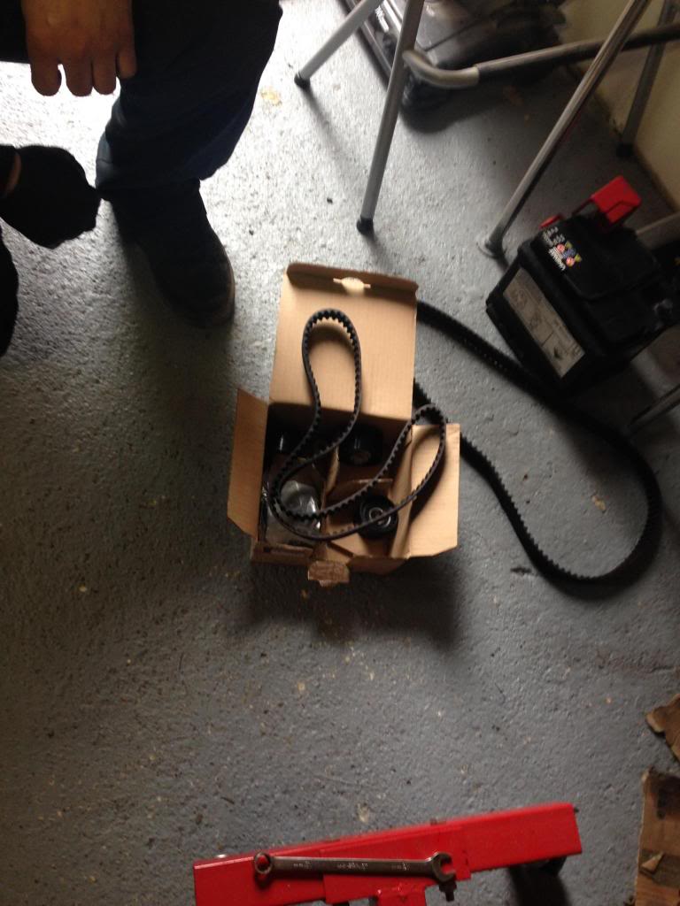

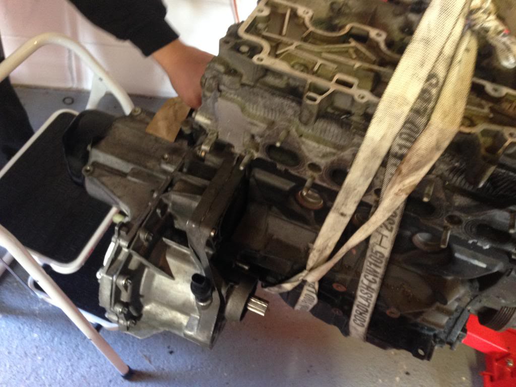

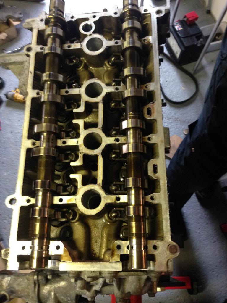

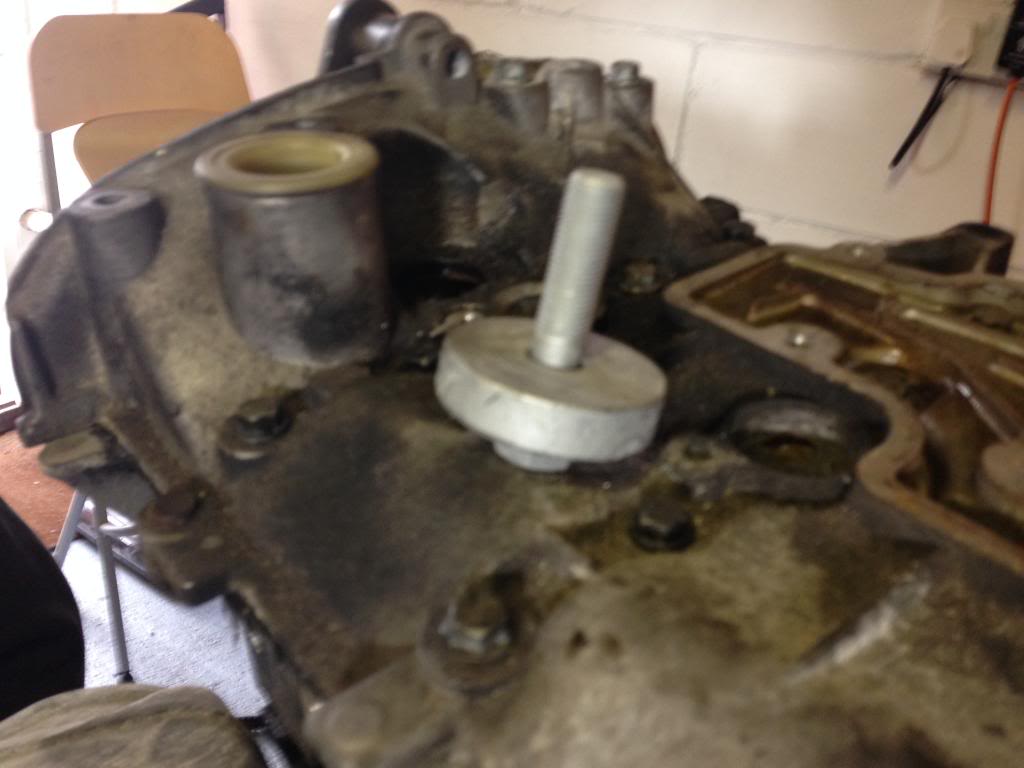

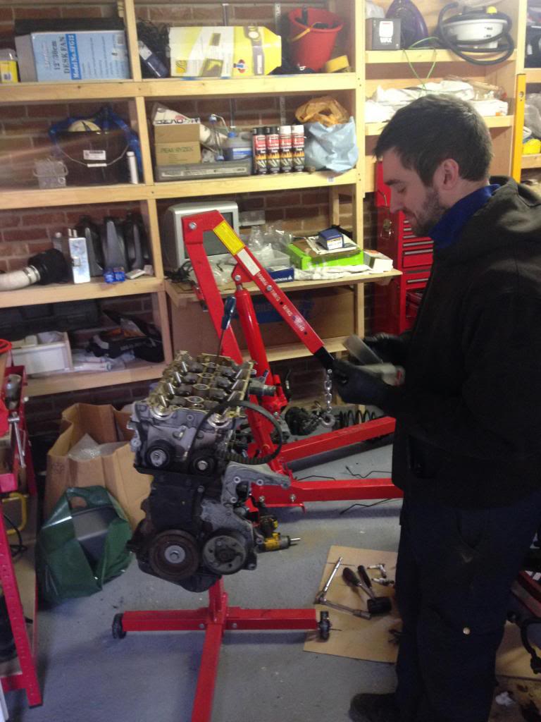

A very productive day with Dan@SJM. We compression tested the engine, fitted and timed up a new cambelt with dephaser, ran in the Cup brake setup so I could do away with ABS and chatted about superchargers. Top bloke Dan, his help was much appreciated and it was good to catch up.
Considering the engine was sat in a unit for 18 months, since it came out of Luke's Trophy, I was over the moon that it seems in tip top nick and very healthy. Certainly healthier than the one its replacing :) Compression Test results were;

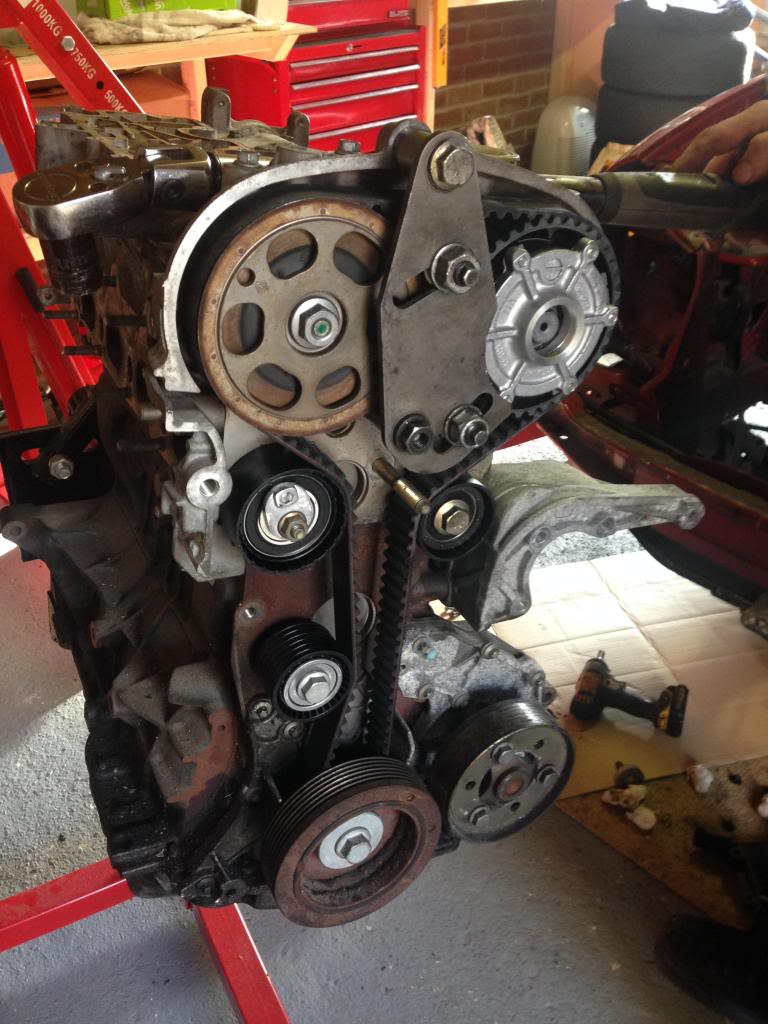

First, up took the rocker cover off the new engine to inspect the cams. Happy to report they were very clean and unmarked. The head was cleaned up a bit and the rocker cover sealed back on.

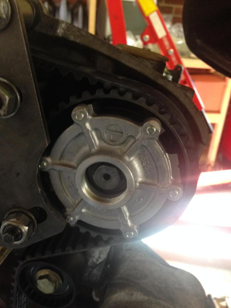

Genuine Renault cambelt and shiny new dephaser was put on, with Megane 225 Crank Pin as Adam was out of 1*2 ones, then the timing done.
Note how dirty the rocker cover / engine is, as its due a serious tidy up / paint this week :o
Everybody loves an accurately timed up F4R ;)

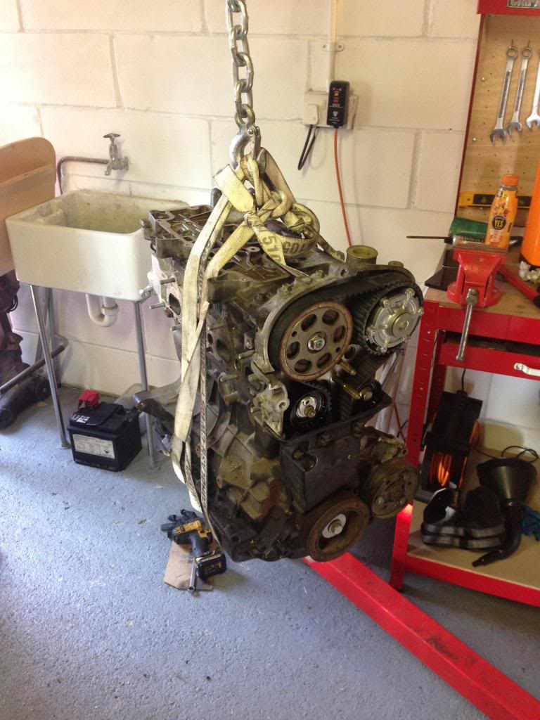

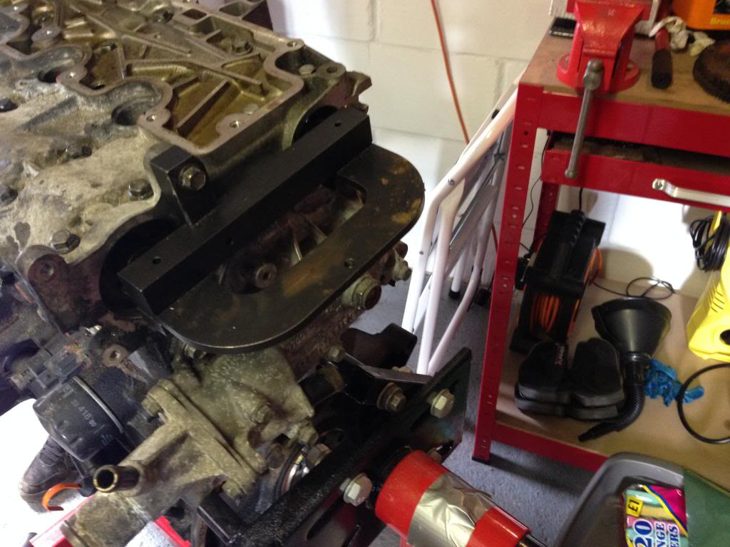

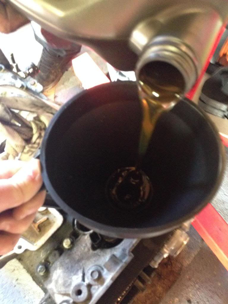

Got the crane out and took it off the stand, then put the flywheel, gearbox and starter motor back on to let us compression test it. Before anyone asks, yes the bolts in the box aren't the correct ones as we just needed to fix it on for the test, it came back off again
Filled it up with some oil, then did the test. My phone died here, so no photos of the compression test I am afraid.

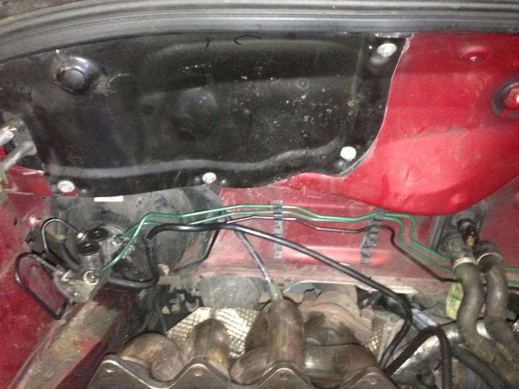

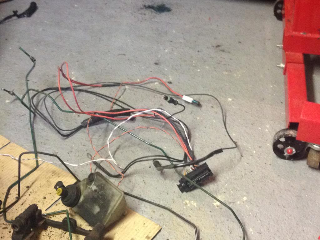

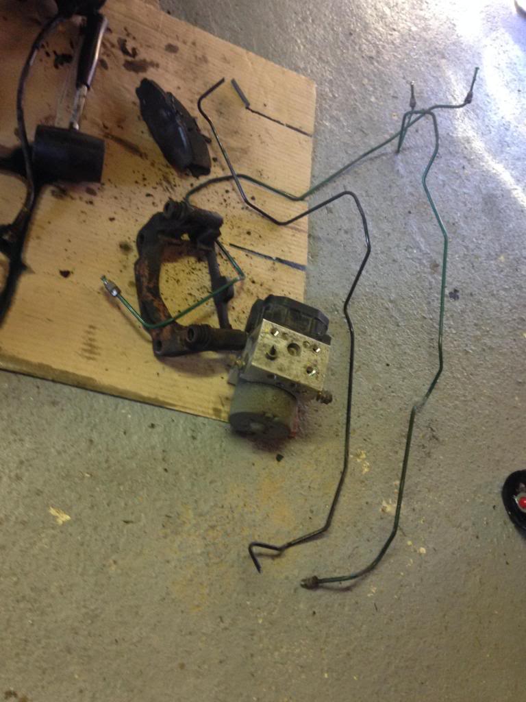

Dan then moved onto the removal of the ABS setup. I was chuffed to see this go as it has been playing up ever since the second Burpspeed Llandow day Jay Payne ;)
Good bye ABS pump / Ecu and old brake lines;
Good bye annoying Loom;
Hello new lines;
Hello CLiP

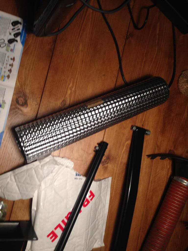

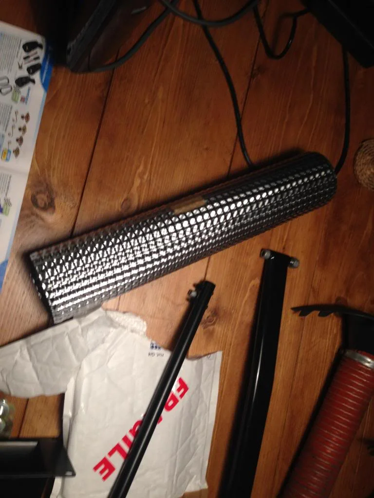

And some Nimbus Heatshield arrived;

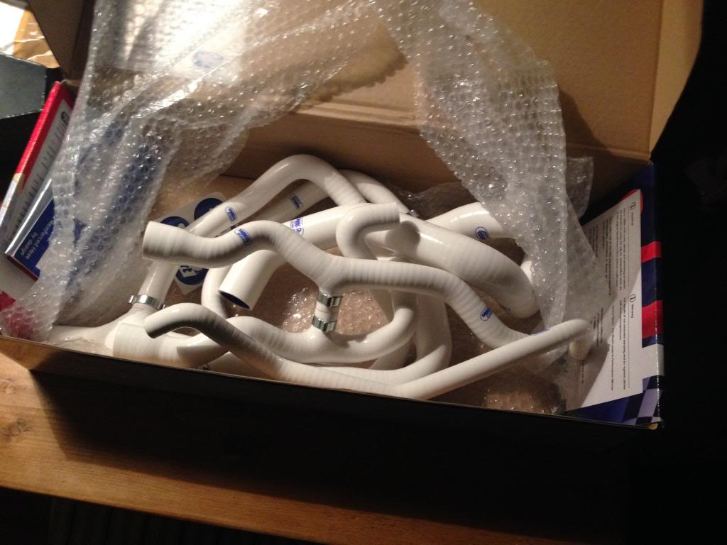

Oh also where did you buy the Samco hoses from?

Hoses - bought them from Demon Tweeks bud. I like the photos as it reminds me of what I have / haven't done! Lol.
