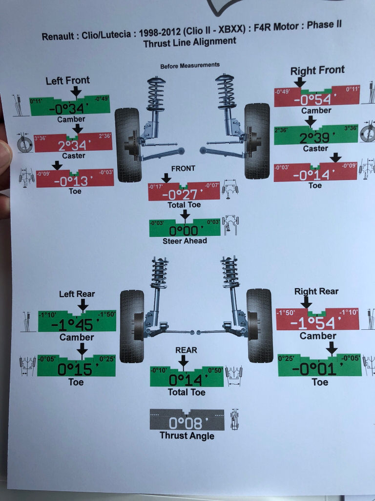

So, after a check of the adjustment, Brad recommends some Eibach camber bolts. So I’ll be ordering those to be fitted along with the tyres a week on Tuesday and have the alignment done all in one hit.
He said the alignment is a million miles out, just a few tweaks to the camber once the bolts are in and the toe is out causing uneven wear to the NSF tyre.
Luckily the tyres aren’t too bad so no massive rush to have those fitted.
Print out of the adjustment check:

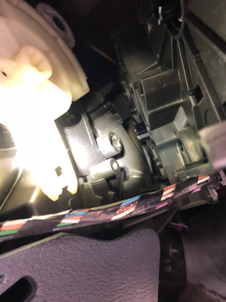

I’ve been changing the oil and filter this afternoon, dropped the oil, about to change the filter and I’ll be fucked if I can get the thing off! So whilst my wife has kindly gone to Halfords for an oil filter removal tool for me, I thought I’d have a bash at the air con. After my ch cursing and swearing trying to get the little footwell panel out, my spindle is fine! No breaks or wear at all!
Any other options to fix this??

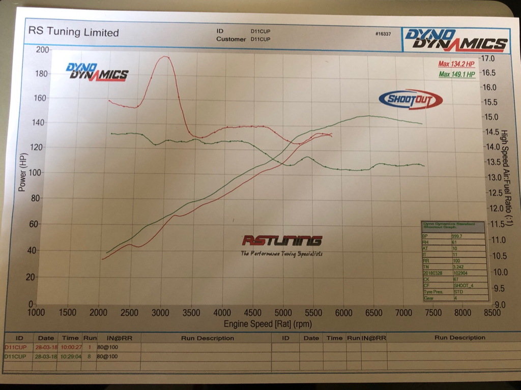

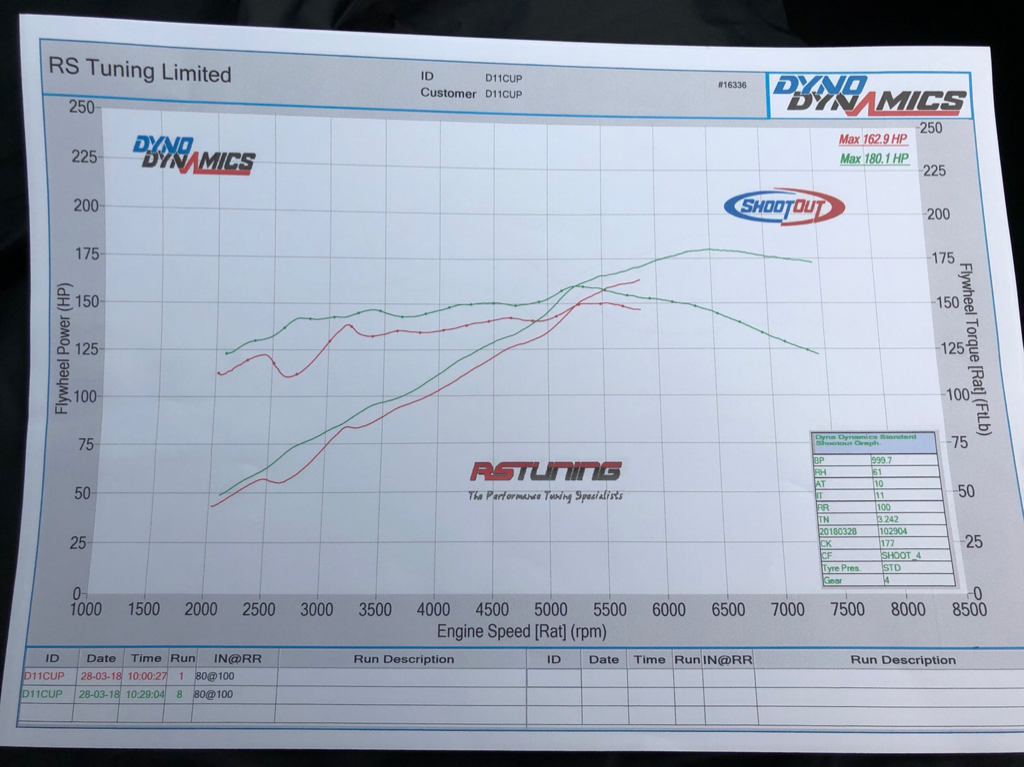

97,000 miles.

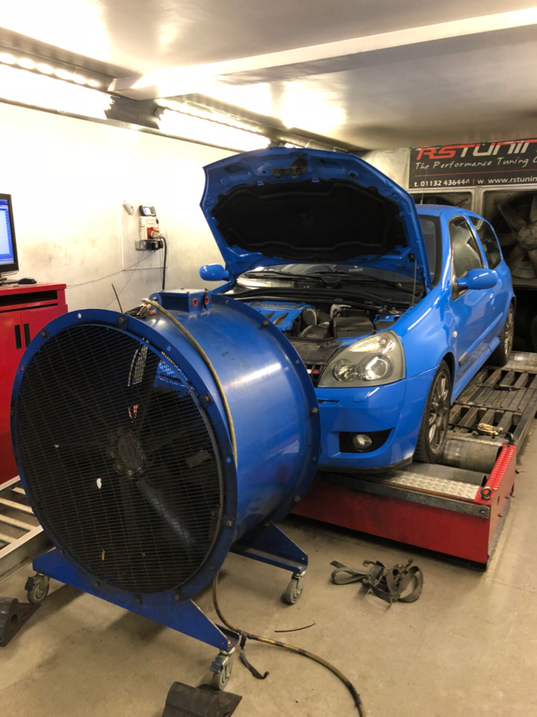

Just got back from @RSTuning. Had the car on the dyno to remove the map that was on it and the pops from the exhaust.
The car is running so much smoother now, it revs beautifully and pulls without any flat spots. Perfect.
Paul said that he thought the car had cams in it as when he was upping the fuel in the mixture the car just kept taking it and making more power, he said it runs great for standard cams, he did say the engine is a bit mucky inside so I will make sure to change the oil a bit more frequently to try and clean it through.
Proper chuffed with how the car feels. So smooth and pulls great. Massive difference.

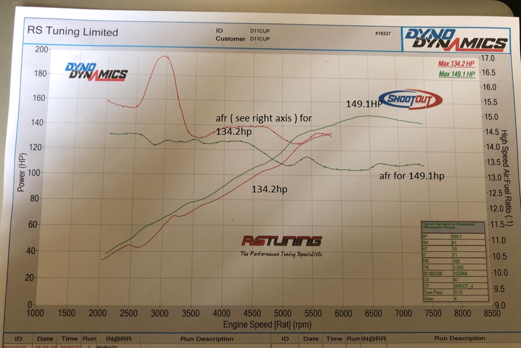

This is the 2nd print out I got.
If anyone could help me decipher these graphs it would be greatly appreciated. I forgot to ask the guys to explain them to me!
That's a great figure for an almost standard car, i'd be chuffed with that......... with a milltek cat-back, ktec induction kit and engine dynamics map mine made 180.9bhp so pretty much the same!
