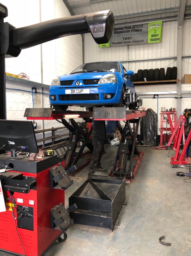

Just about to leave for Bram Racing. New tyres, camber bolts and alignment.
Looking forward to that.
Updates to follow [emoji41]

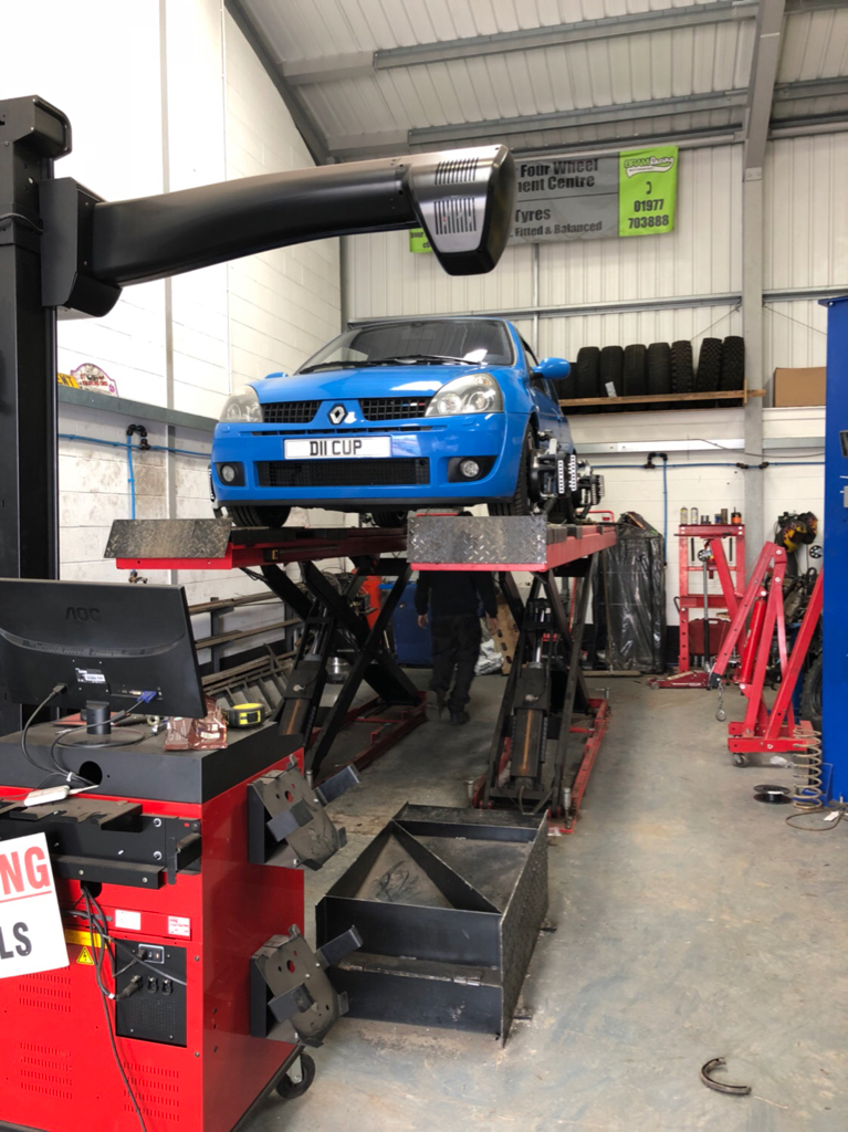

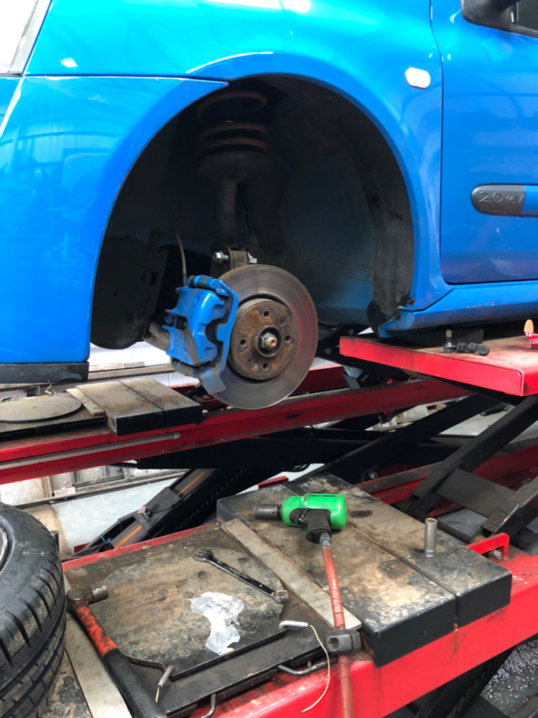

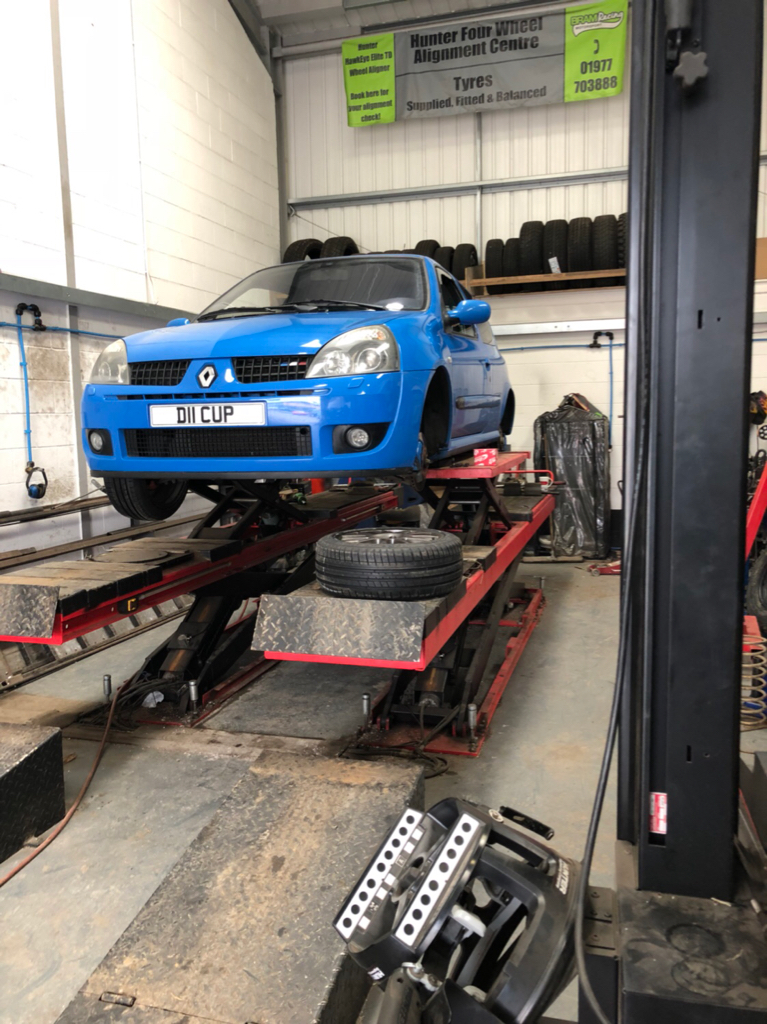

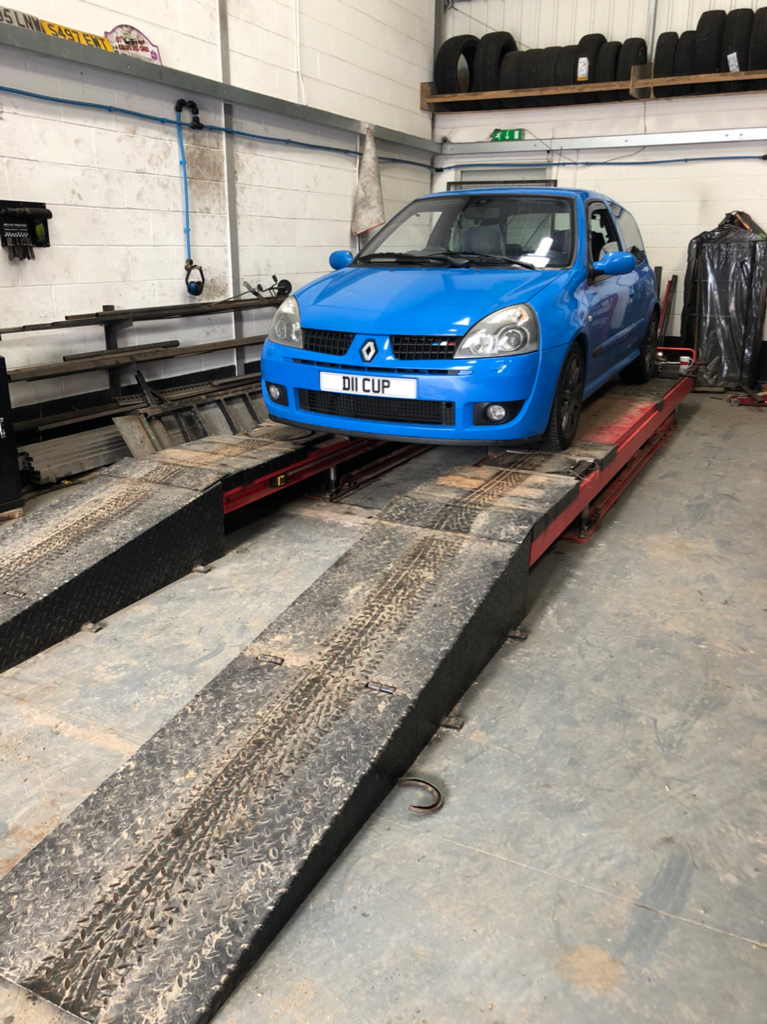

Update.
Arrived at Bram Racing at 9, left about 1.
4 Michelin Pilot Sport 3 in 195/45/16 fitted and balanced, 2 Eibach camber bolts added, and wheel alignment sorted.
And Brad confirmed my suspicions about the noise coming from the front of the car, he thinks it is probably a driveshaft. So that will need sorting ASAP. But will have to hang on until I’ve saved some coin to do it!
Drove the car back down the M62 and pretty much straight to work so haven’t had a chance to have a play yet to see how she feels, but hopefully will get out before weekend.
Top stuff from Brad. Worth the journey.

With the eibach camber bolts, this will sound thick, but what do they actually do? Much gain from having them?
Been reading about them recently but still not 100%, I've got new genuine cup shocks and cooksports so not too different from your set up

Allows you to adjust the camber on the shock. Gives you about 2 degrees I believe. Just means you can sort out the camber so it's correct then adjust the toe to suit.
  2004 Racing Blue 182
That makes sense! So worth doing then? Considering they are only about 20 quid!
Not sure from driving point of view yet as haven’t had chance to really drive properly. But for the sake of £20 and half an hours fitting, defo worth it.
Very true! Will be very interested to see what you think when you drive it properly :up:
Ive just driven the slightly longer way home as there is a 50mph twisty section. The car feels a lot lighter on its feet than it did before this morning. Turns in much sharper and doesn't feel like I'm trying to fight the wheel to get it to turn in. if that makes sense. It's like I've given it an energy drink 😂

Oh and this is probably a stupid question, but will replacing the driveshaft knock the alignment out as i'd be removing the hub and attached components wouldn't I?
Yeah makes sense. Easy to fit and then the alignment place adjusts to suit.
That's the next purchase sorted then 😂

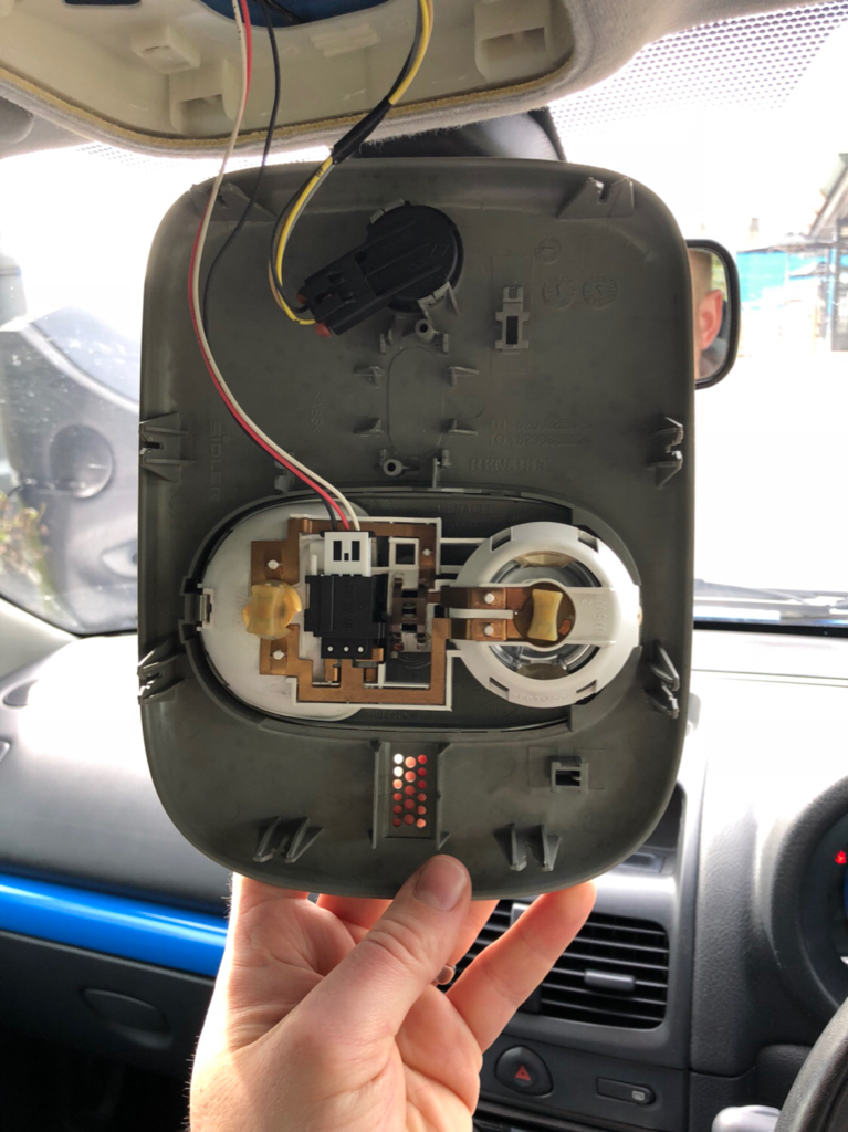

Am I being thick, or is my internal temperature sensor missing???
Is this why my climate is only blowing warm air on anything but mini??
Clio_fool
Mine is the same. I did search but all I found was threads about the temp sensor missing. Seems there may be a different sensor in the 182 but I didn't find a solution as to why the climate wouldn't work properly
Hmm,
Bugs me that I can’t have a constant temperature in the cabin. It’s either AC on and it’s cold, or AC not on and it’s boiling!
