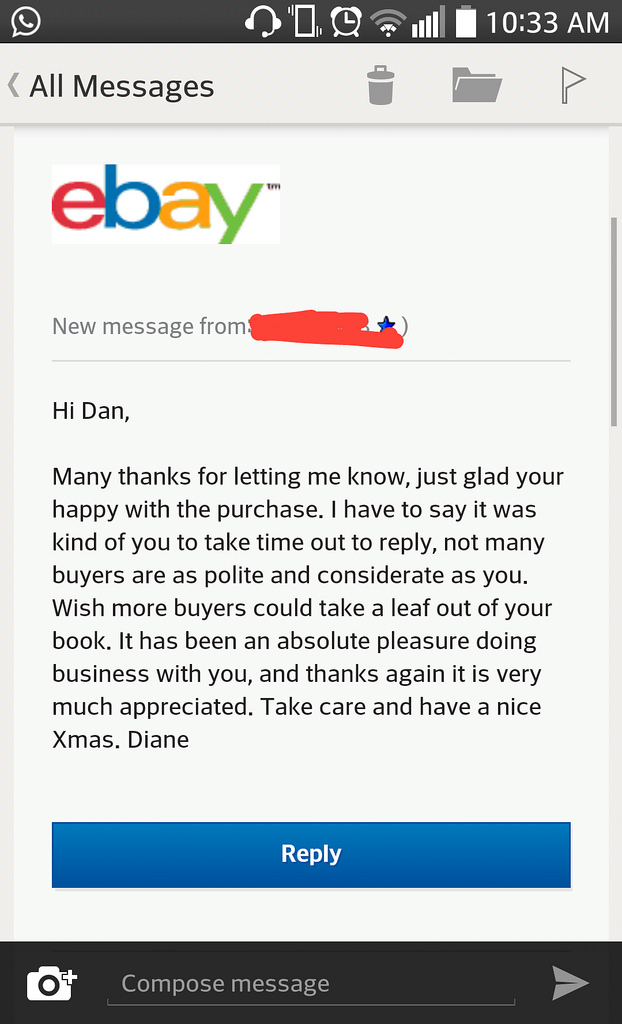

I also sent a message to the seller thanking her and she sent me this reply. What a lovely woman! Love the xmas spirit haha

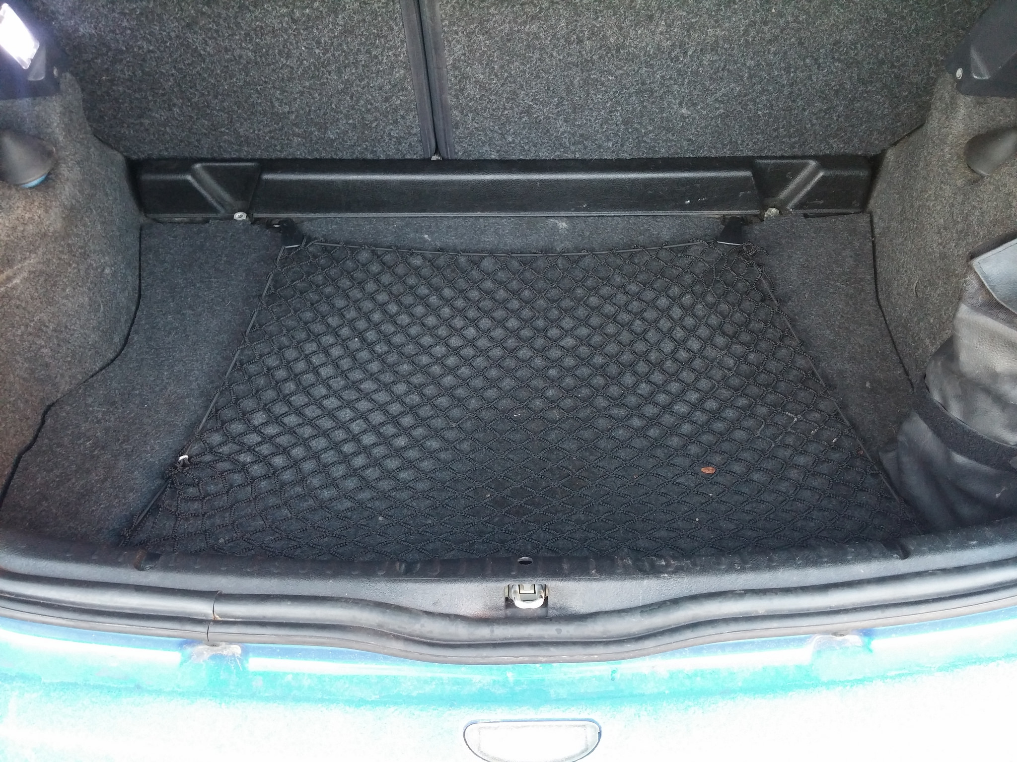

And the net itself
20141213_103505 by dann2707, on Flickr
Used it when I went xmas shopping on saturday and it's awesome. Such a handy accessory.

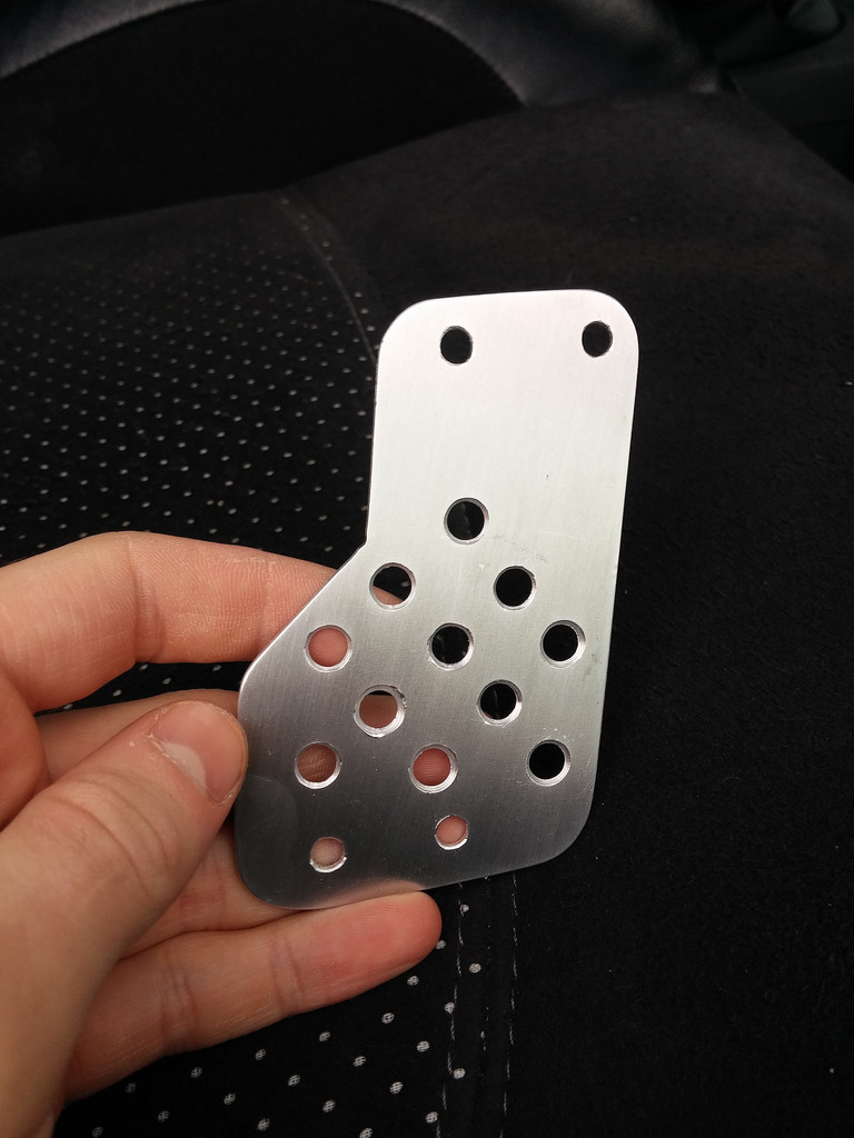

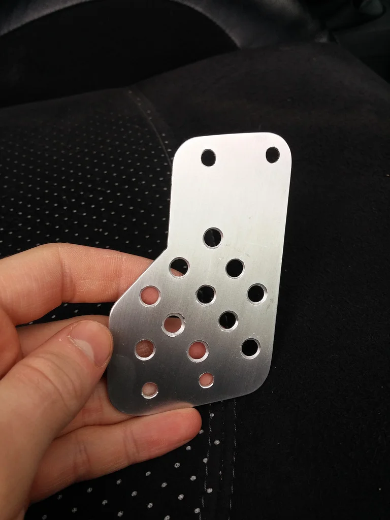

I then received this through from @NorthloopCup, it's an extended accelerator pedal for heel and toeing. I've tried it in the past on this car and with my stupidly small sized 7's it just isn't going to happen. Hopefully this will improve things :D
20141214_123643 by dann2707, on Flickr

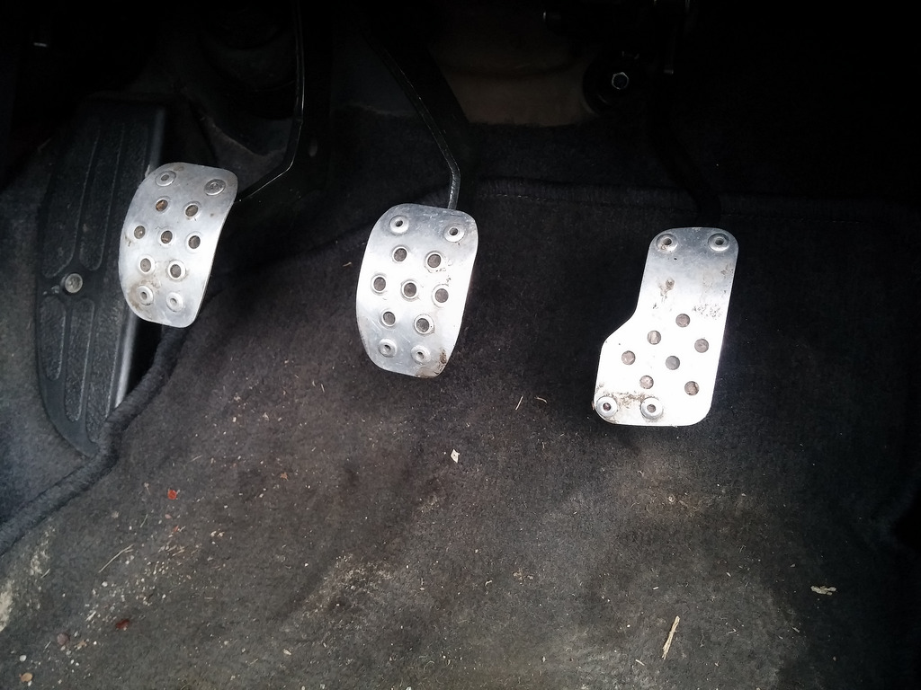

Before:

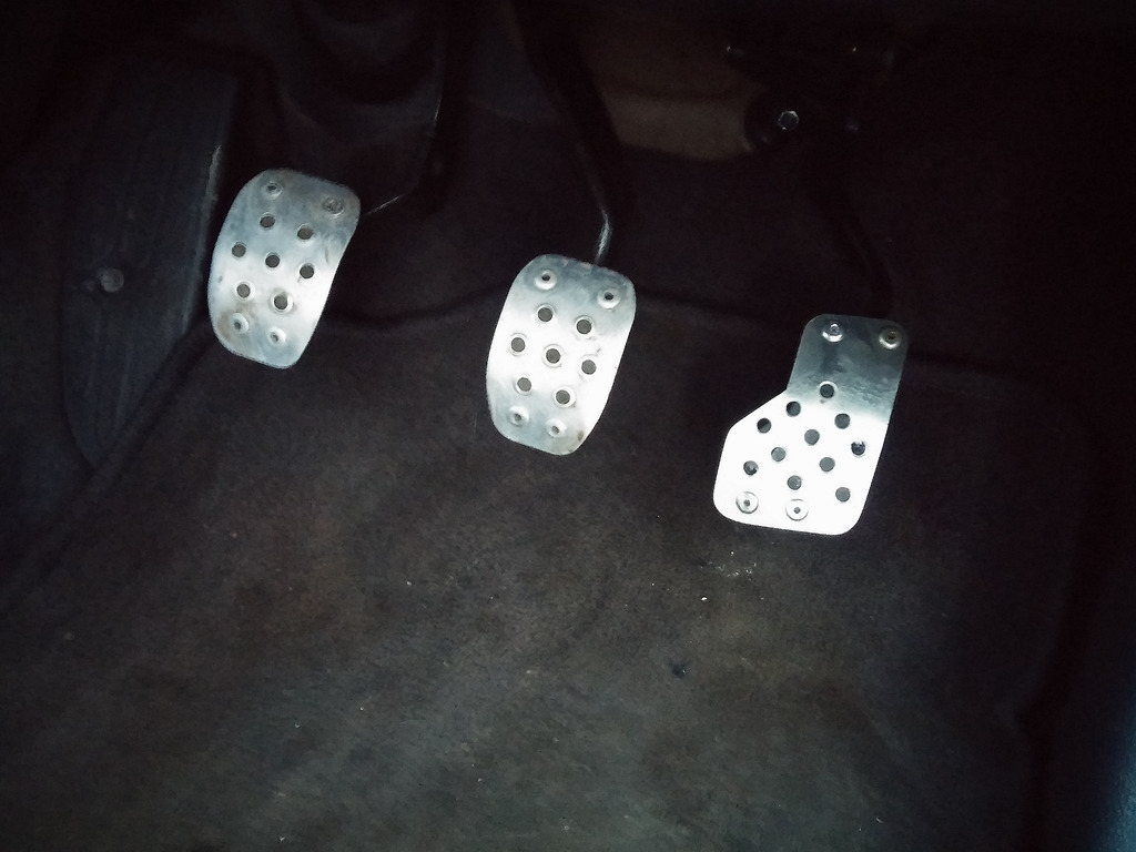

After:

I then received this through from @NorthloopCup, it's an extended accelerator pedal for heel and toeing. I've tried it in the past on this car and with my stupidly small sized 7's it just isn't going to happen. Hopefully this will improve things :smiley:

Lol! Glad your pleased with it mate! I'm also glad to see its not just me with size 7 feet!!! Do you have to buy shoes from Clarks kids range as well?! Flol

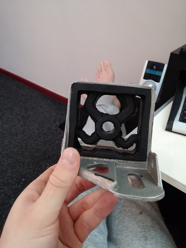

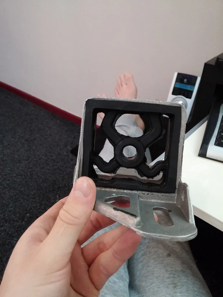

And received two of these! They look weak as f**k so I'm thinking of filling the holes with tigerseal to stiffen the f**k out of it?

Tigerseal or an old socket with a zip tie.

I tigersealed mine up, been fine for neally a year with no splits.
Did it on my old 182 (both mounts) and was fine again for an even longer amount of time. If you can measure the gaps I can always cut you some thick gauge metal "rings" to wedge in the lower mounts to "solid" it?

I got 22mm and 15mm copper pipe squashed it and fitted it in the holes in the rubber! And cable tied them in place!

Tigerseal will do the job then! I'm not sure, not a fan of the standard one as it's too quiet but £400 is a lot. Going to start saving for a house with the Mrs soon so might start being careful with the mods. Famous last words though haha.

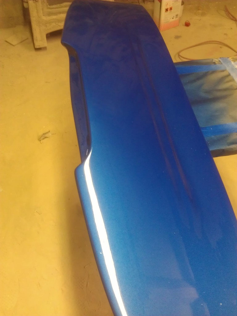

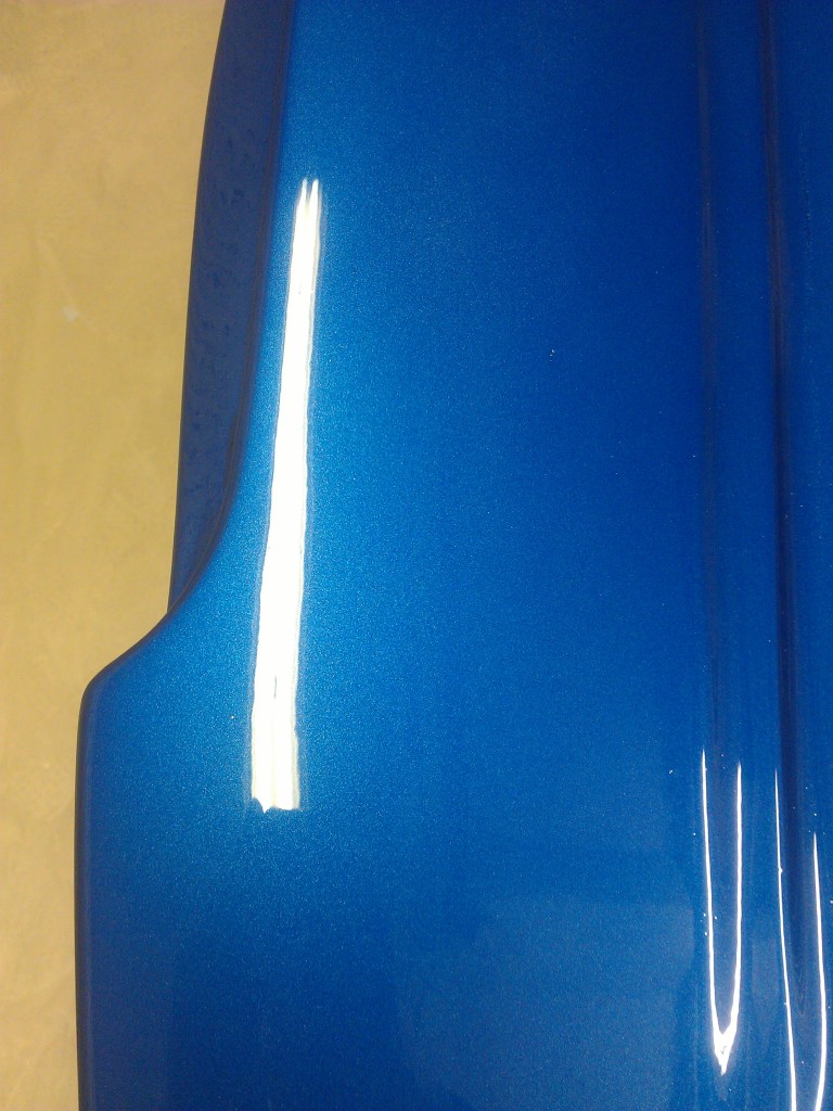

Got sent these pics of the spoiler tonight! It's looking fooking sweeeeeeeeeeeeeeeeeeeeeeeeeeeeeeeeeeeeeeeeeeeeeeeeeeeeeeeeeeeeeeeeeeeeeeeeet!!

Want I meant was wedge the tube in there and tigerseal them in and all over the mount.
I used some think wall fuel pipe and wedged it it the gaps, works really well because it still flexes!
Tbd I rolled up some card and wedged it in there both sides so it was tight then tigersealed it up.
Keep your old exhaust mounts so you can do this for next time
http://www.cliosport.net/threads/custom-1-2-exhaust-mount.741956/
The problem with those mounts is that they have a tendency to crack.

Spoiler looking good :smile: Mind me asking how much you paid for it to be sprayed?

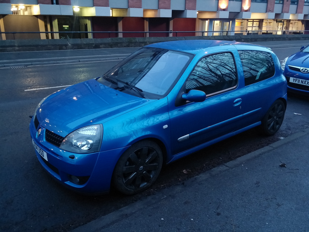

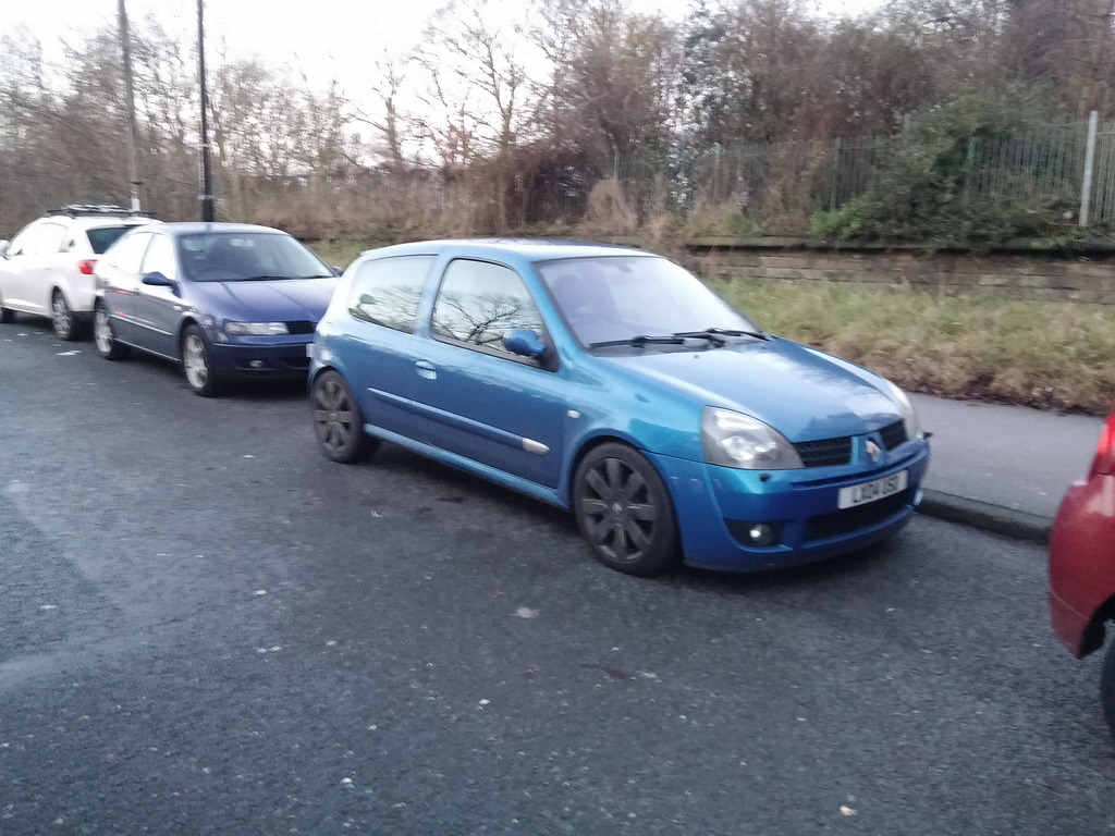

Here is a horribly blurry photo for now. I think I need to go lower though
