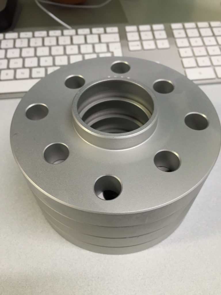

You're very welcome mate. When purchasing i'd get them to double check they're sending you 60mm ones. Screw waiting a week for you to receive 54mm ones ;) haha And when you're choosing shipping location, if you spend less than 15 minutes looking for what England is classed as on their site you're doing better than me. @optical did you have that trouble too or is it just me that might be that stupid? hahah

You're very welcome mate. When purchasing i'd get them to double check they're sending you 60mm ones. Screw waiting a week for you to receive 54mm ones :wink: haha And when you're choosing shipping location, if you spend less than 15 minutes looking for what England is classed as on their site you're doing better than me. @optical did you have that trouble too or is it just me that might be that stupid? hahah

My mate @DV8 spreche sie deutsch, here's a pic of some pain I experienced one eve at work in my excitement I didn't check what spacing I had been sent...
Literally the last bolt to go in and AH WHAT THE f**k!! Top hole didn't line up, Had to take it all back off again and put the old stuff back on, only gave myself an hour to do the job!! [emoji35][emoji35][emoji35]

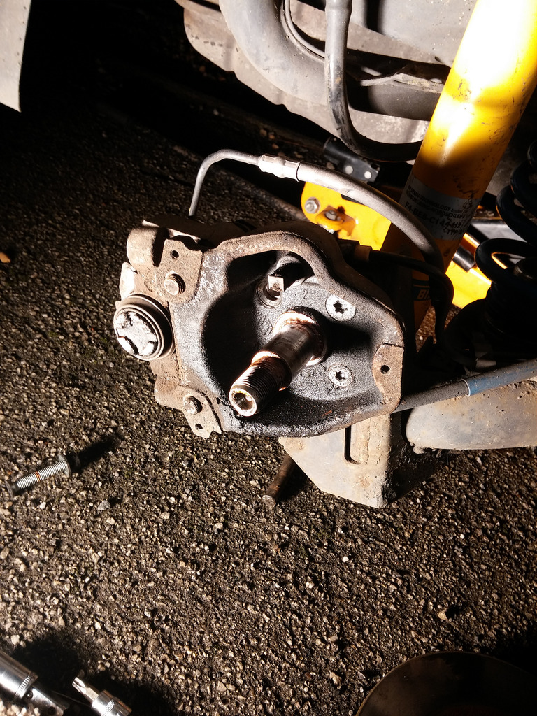

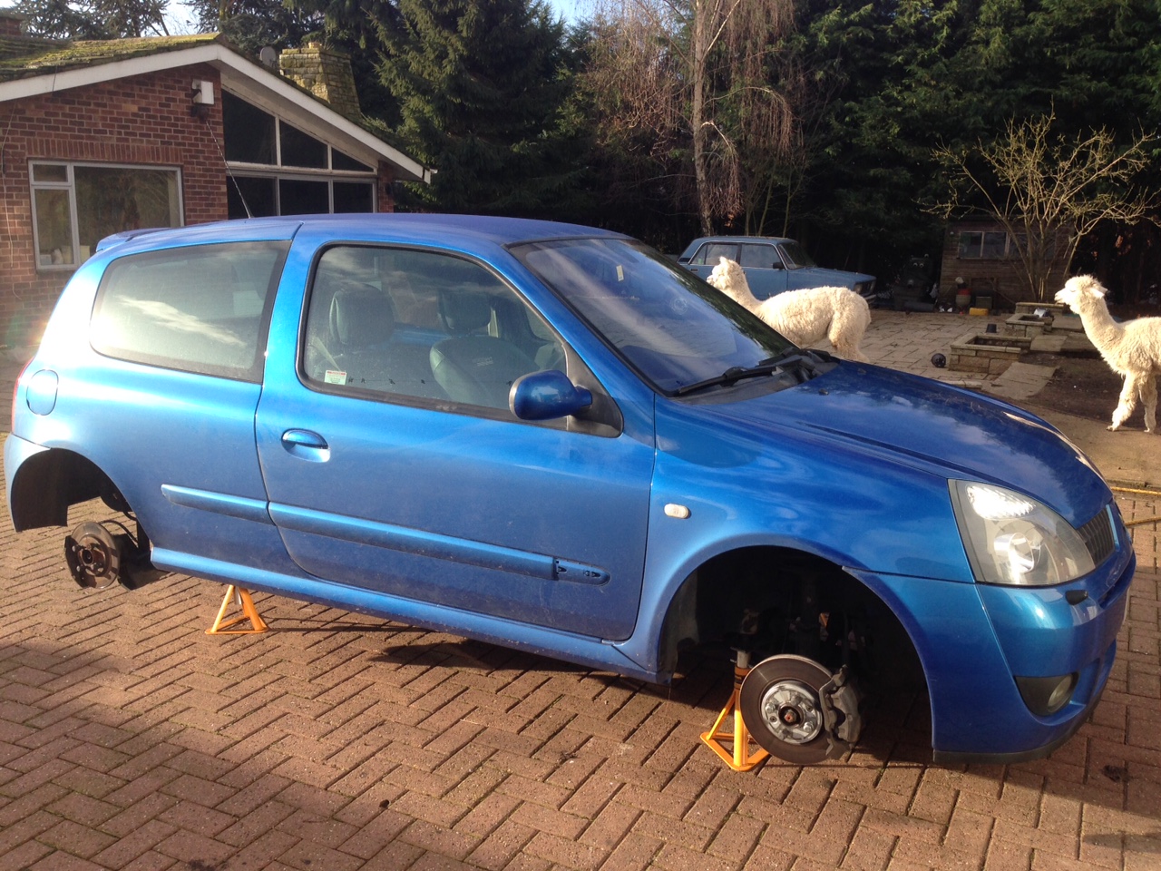

I got home and started fitting the 10mm stub axle spacers from Pure
It was very cold and I had to do the job quickly as I wanted to take the car back to the garage to tighten the hub nuts back up to 175nm as they have a torque wrench but here are a few before and after pics.
Fitting them was really easy. Simply undo the 2 x 17mm nuts holding the rear brake carrier to the hub, then undo the 30mm (I think) hub nut taking care not to lose the washer that is under the disc and taking note which way it goes on as it's very important!
Then this reveals the 4 torx bolts. I find it bizarre how 3 of them are the same and 1 is a smaller size. I thought someone had bodged it initially with wrong sized bolts!
20141212_164843 by dann2707, on Flickr
Then slide the stub axle spacer in and fit the new bolts and nuts.

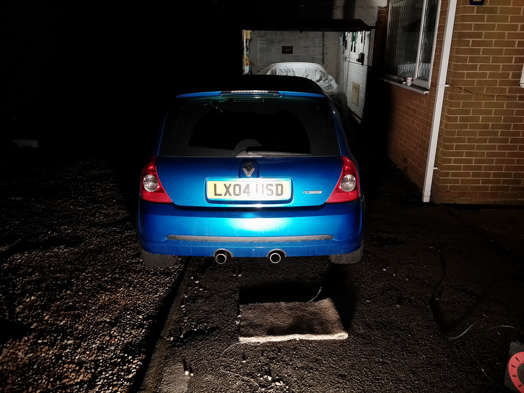

Now for some shocking before and after pics. HATE the dark. You can sort of see the difference. It is only 10mm though.
Before:
20141212_163302 by dann2707, on Flickr

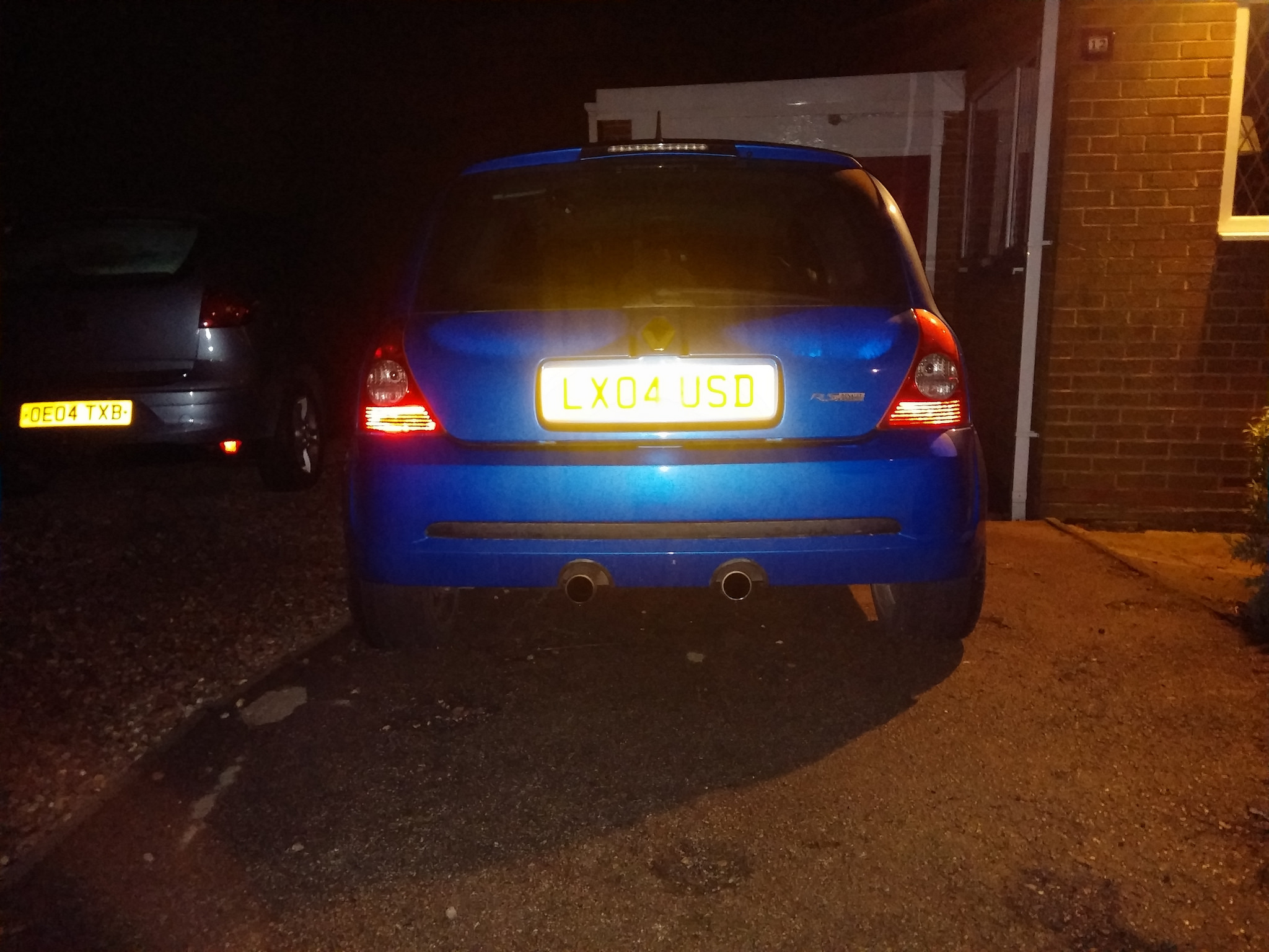

After:
20141212_174353 by dann2707, on Flickr
