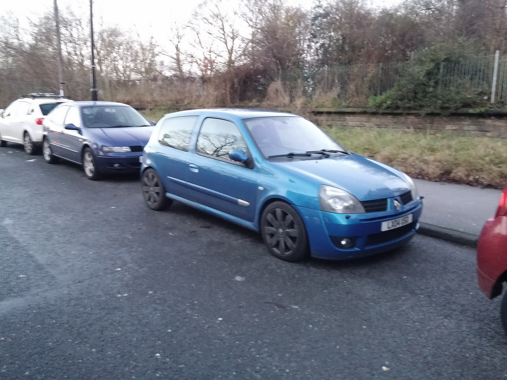

Here is a horribly blurry photo for now. I think I need to go lower though
20141219_081326 by dann2707, on Flickr
And i've just done a full circle and my SERV and abs light has come on. I'm thinking i've snagged the abs cable as i've realised in my stupidity that I forgot to put the ABS holder from my old struts on the new ones!! ARGHHHH Hope it's just pulled out the plug and not damaged anything.
Did you have to get a taxi to that kerb? ;)

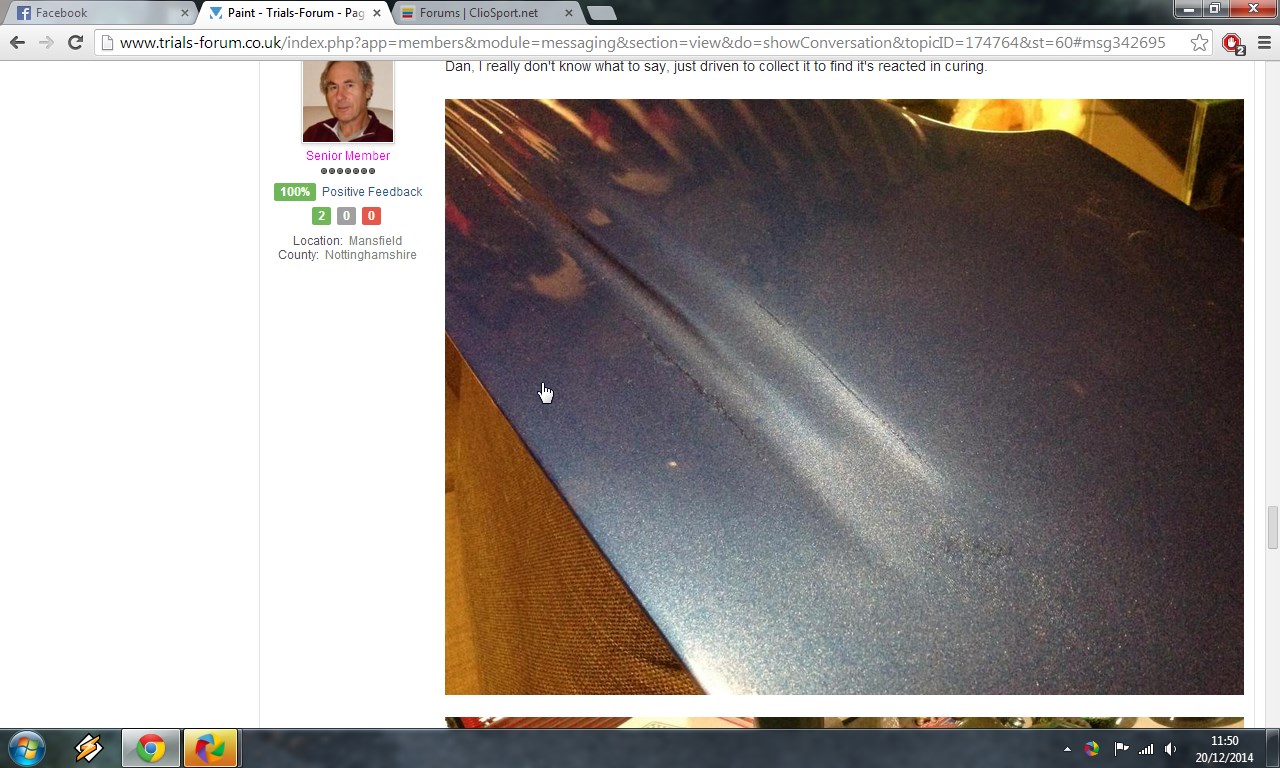

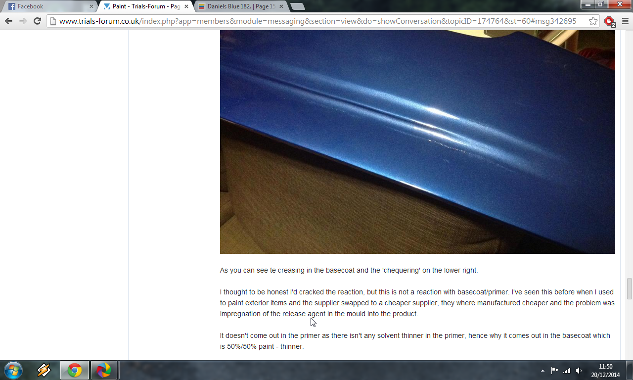

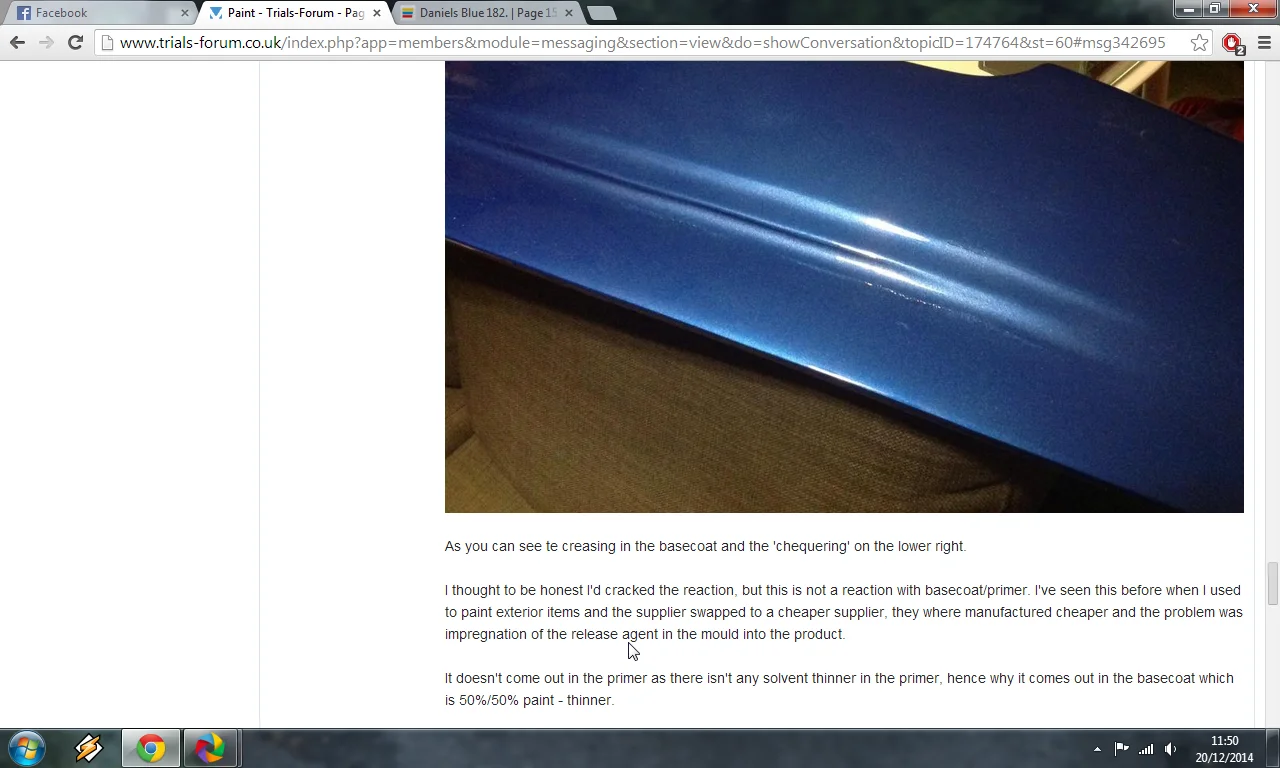

Thanks for the comments. Bad news about the spoiler :( it's reacted again at the last hurdle :(
I heard someone say something about this before with theirs!! Can't believe it. He's had to start it again :( I'm annoyed for him as it's a lot of work for him especially over Xmas. He knows his stuff though and I fully trust him, but he says it can sometimes be if the spoiler is a cheap version. He did give a full explanation I'll post up later I'm just on my phone where copy and paste is hard x
Gus
  182Turbo,DCi90
Gawd, why cant anything be simple and straight forward. Your man sounds like he knows his stuff and will be able to get it fixed with a different primer or something.
Tell me about it. It was so close to being done too :( Balls

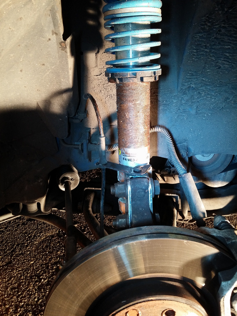

Fitted the front abs cable holders. I inspected both cables and they're both spot on?! No damage what so ever so i'm not really sure why the light came on the other day! Bizarre.

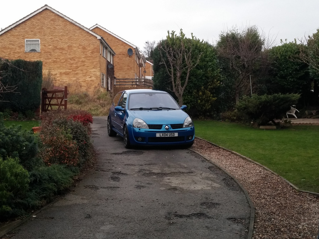

I've also lowered it a bit more at the front so it fills the arches nicer. Will see if I can get out of my driveway tomorrow though 😂😂

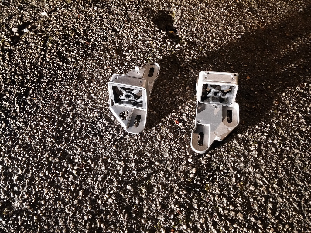

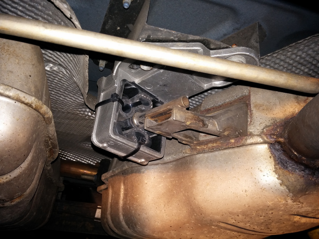

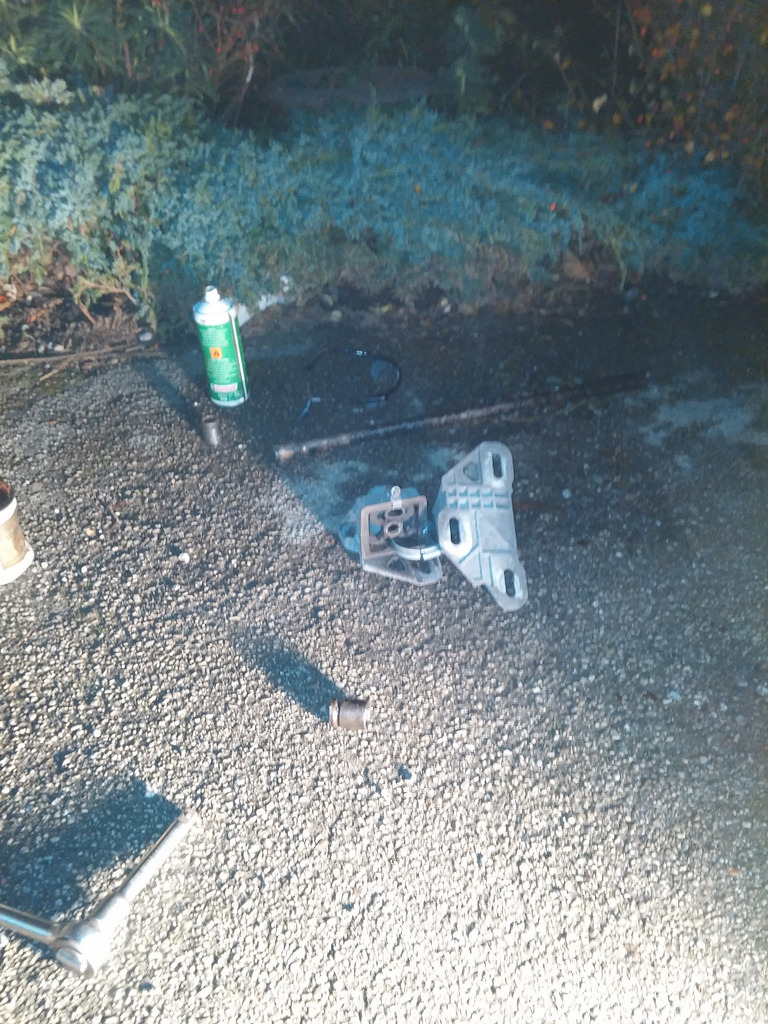

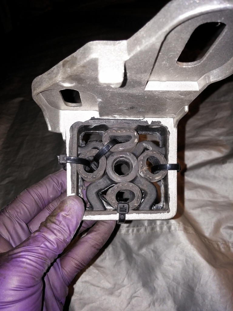

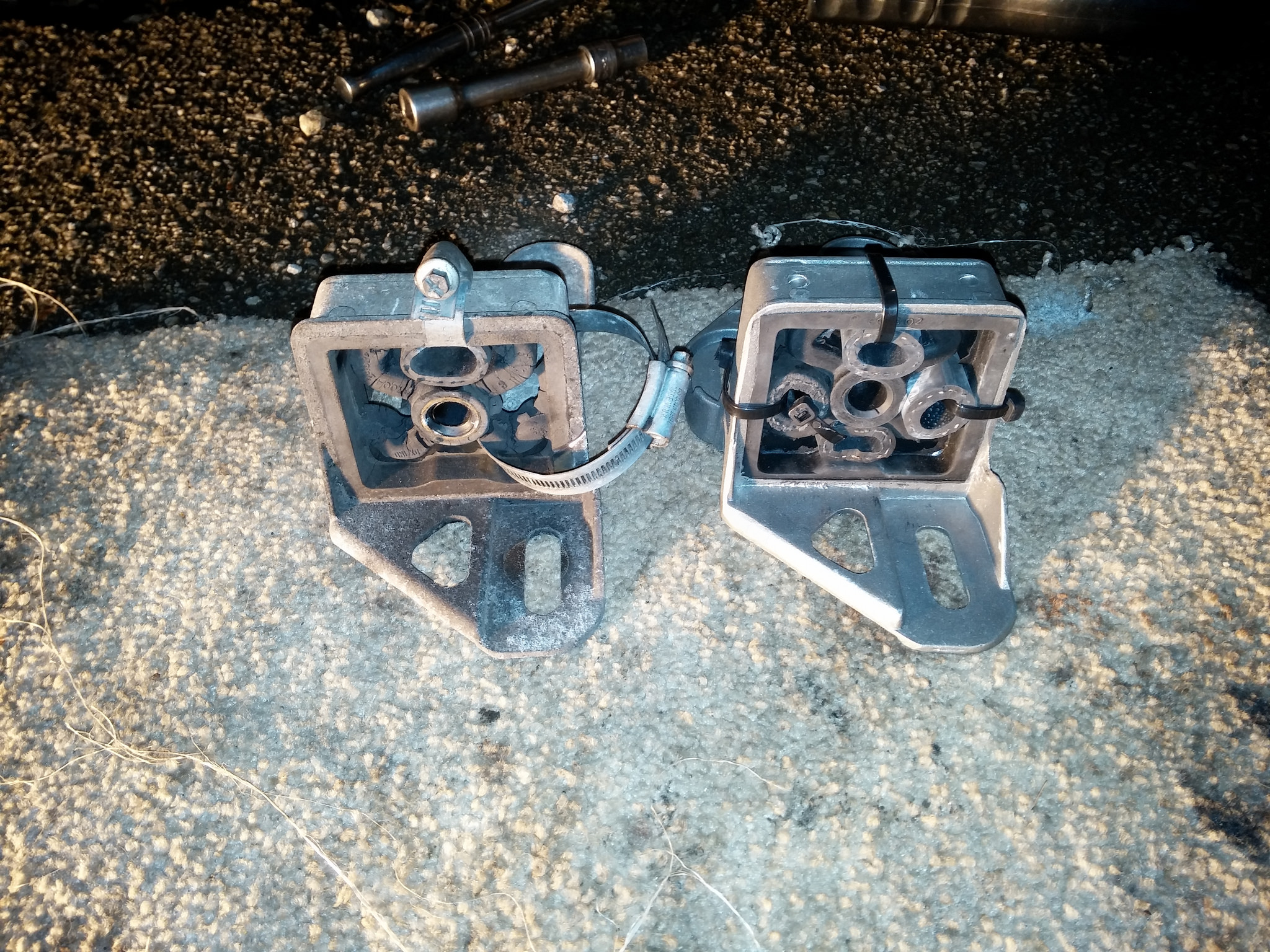

I started tackling the rear mounts as they are shot to pieces. Surprisingly easy as I expected the bolts to be rusted in but not a problem. Used an impact wrench too which is the f**king nuts for saving time.
20141220_201343 by dann2707, on Flickr
The new mounts!
20141220_201353 by dann2707, on Flickr

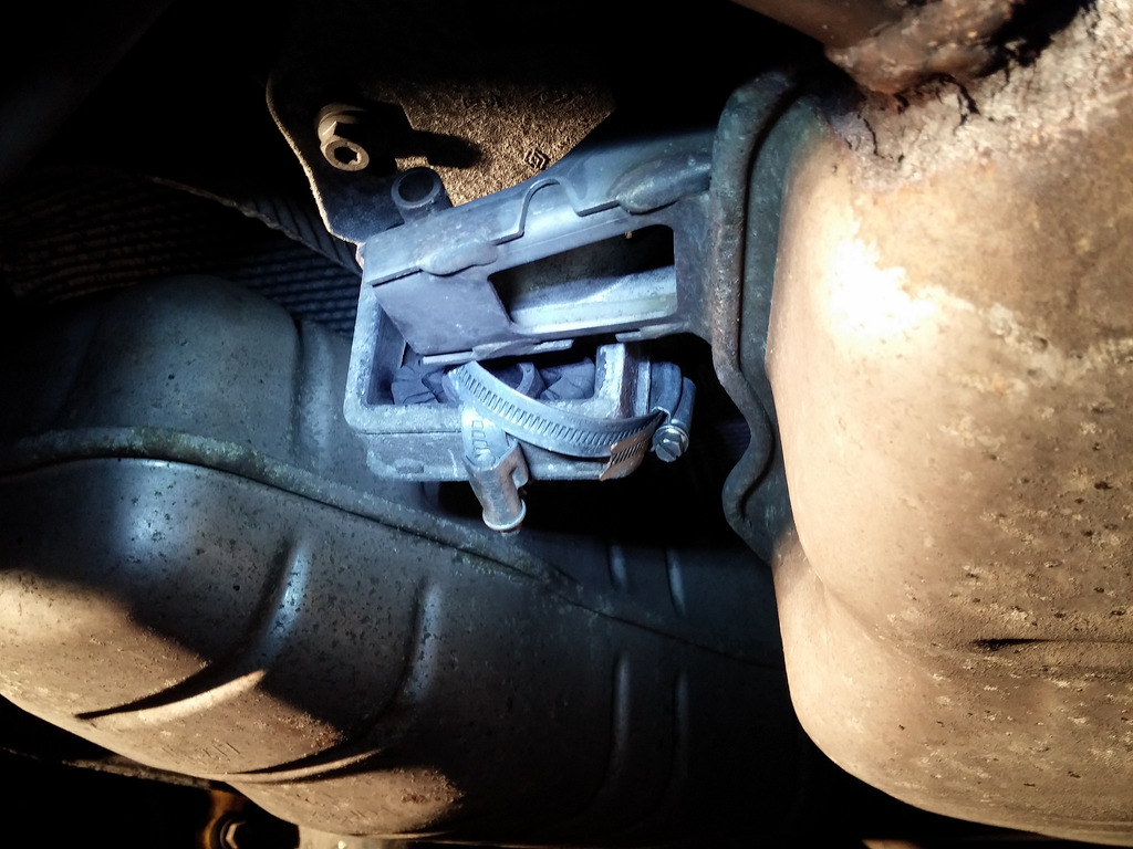

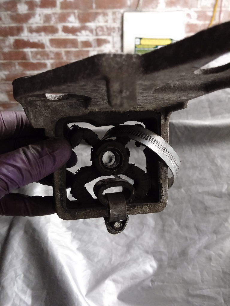

The old mounts haha!! Previous owner tried using cable ties and jubilee clips originally as the original mounts were shot. I tried to even it out a few times wit them but it was pointless.
20141220_201405 by dann2707, on Flickr
The other side wasn't better.
20141220_203341 by dann2707, on Flickr
20141220_201417 by dann2707, on Flickr
20141220_201912 by dann2707, on Flickr
I then packed the new mount with sturdy pipe at each 4 sides and cable tied them in place. Just to prevent the new mount from moving as much as no doubt it will fail soon with how flimsy they are standard.

Goodbye old shoddy mounts. Kept them though in my box of tricks.
20141220_203347 by dann2707, on Flickr

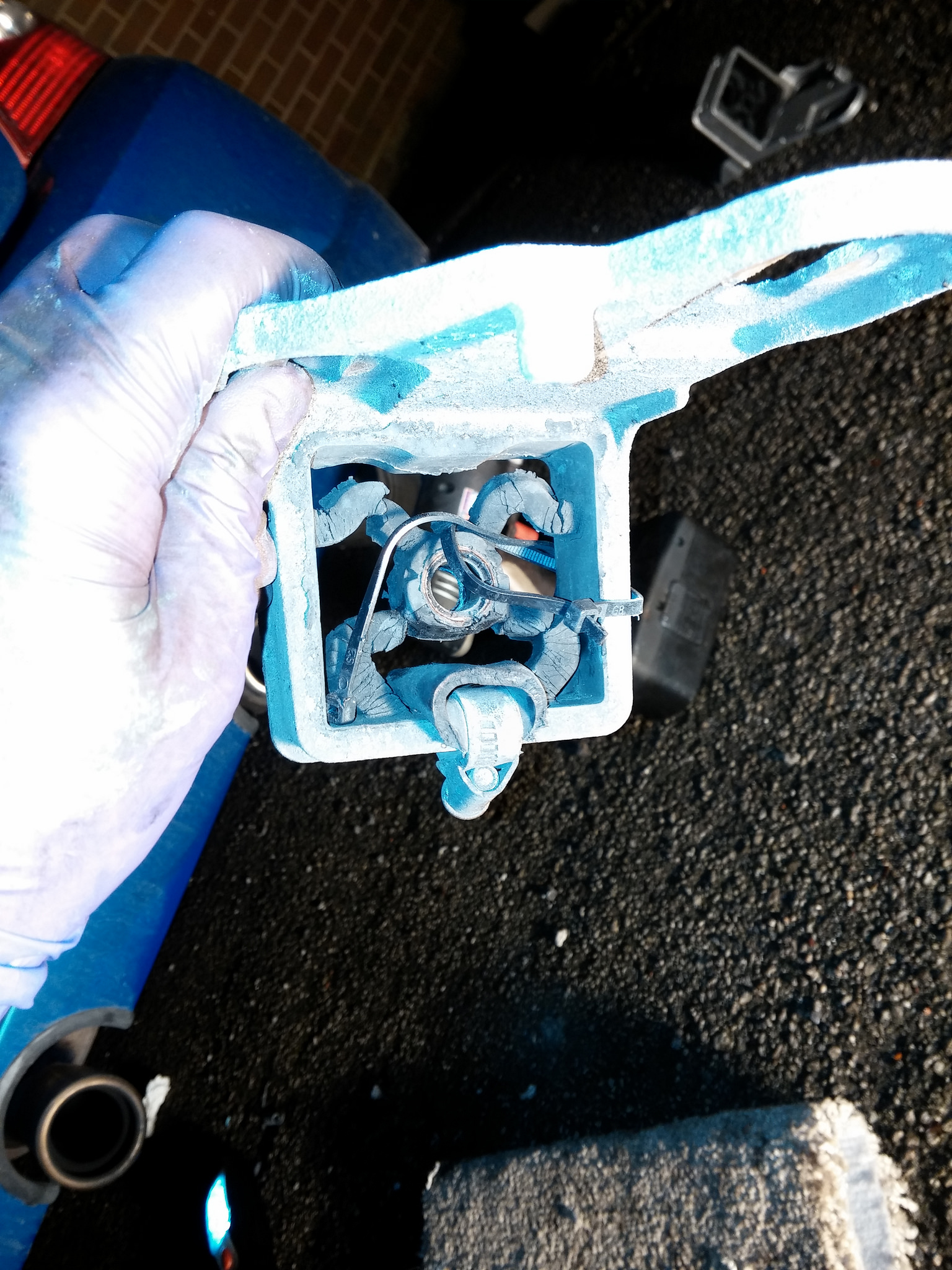

New mount in place.
20141220_203356 by dann2707, on Flickr

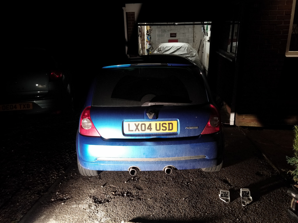

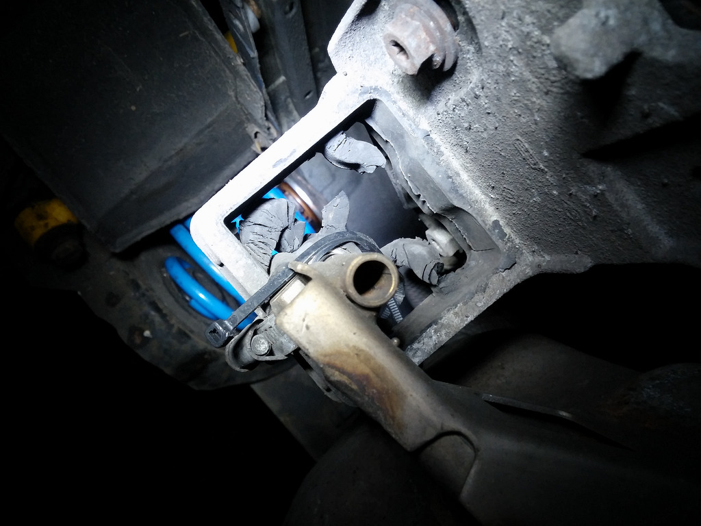

My only problem is that the exhaust tailpipes are not central :( And you can't adjust the exhausts to the side with these mounts :/

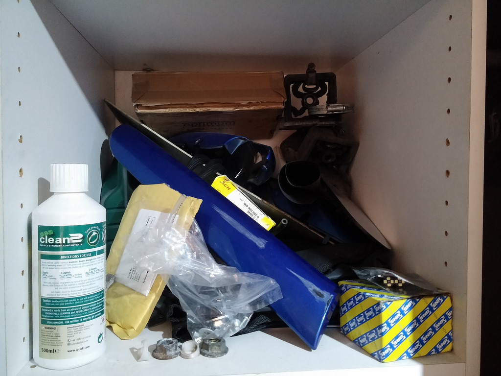

And this is my cupboard slowly filling up with old car parts that i'm deciding on keeping as they might come in handy at one point! There's actually a new wheel bearing in there ready for if mine goes!

The tie wraps are just to hold the bits of tubing in securely mate. They're not taking any load, just simply to stop the bits of tubing from wobbling free if you get me?
Yes mate i get you :smile:
It just bugs me knowing the mounts have tie wraps through them, i would love the underneath of my car to look as good as the exterior, its in the back of my mind even if my springs are mucky lol.

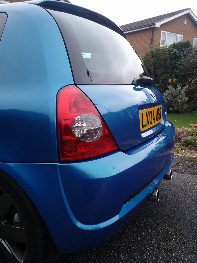

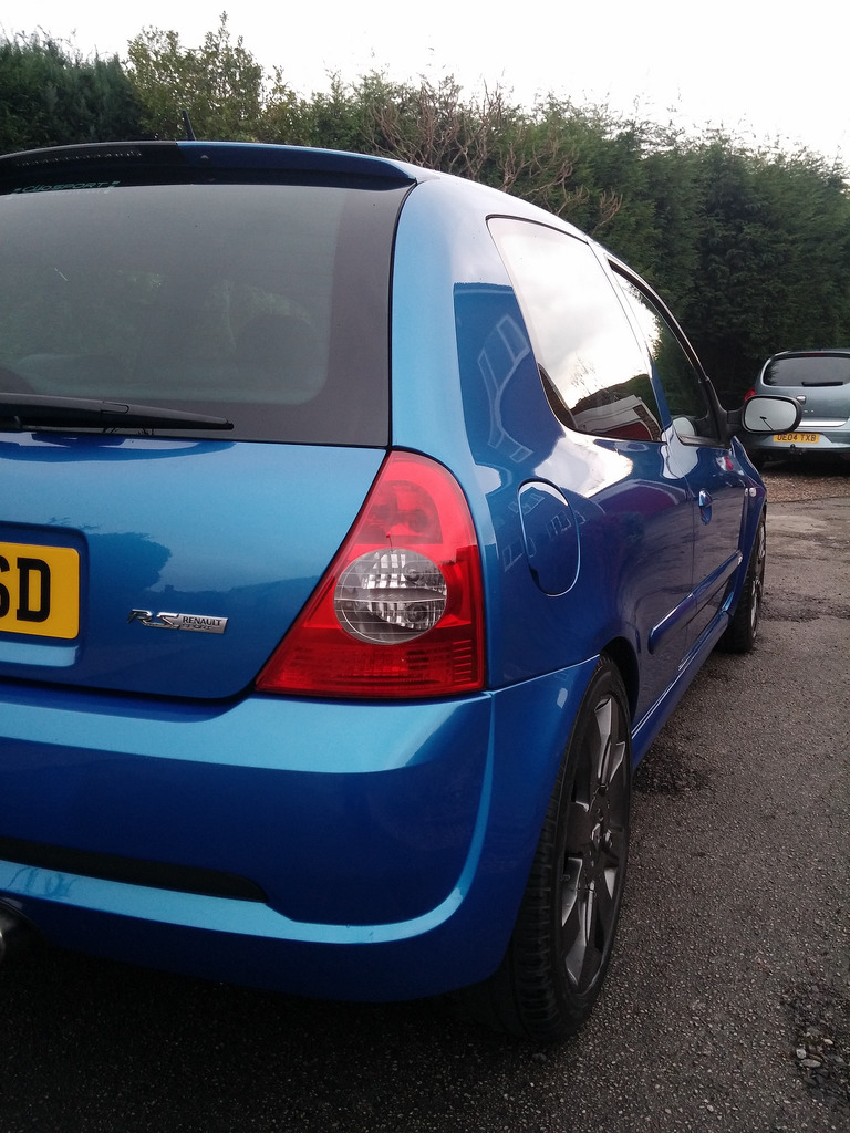

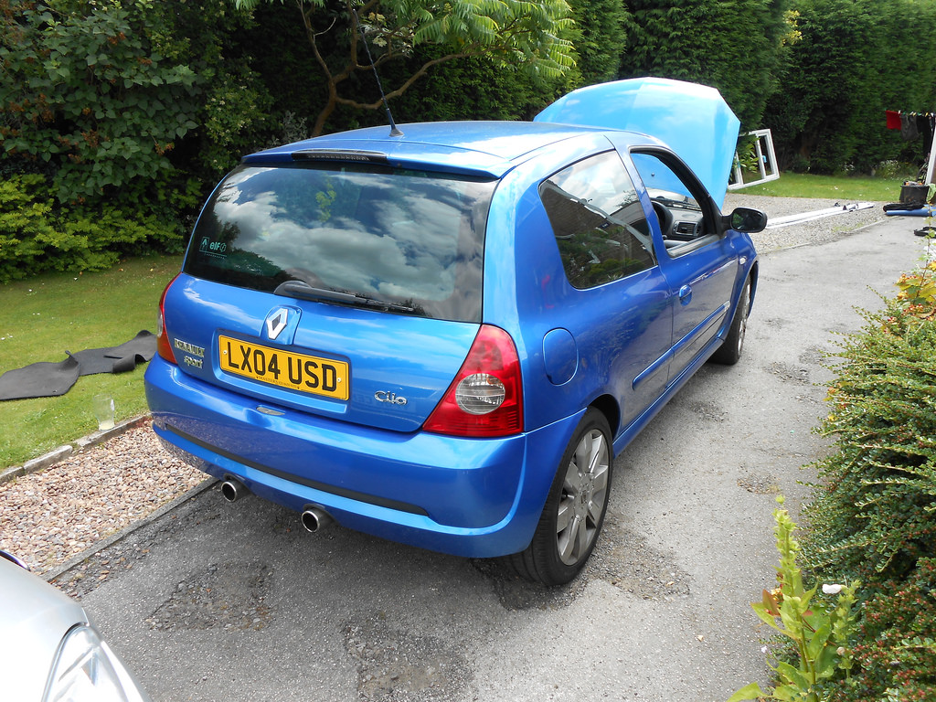

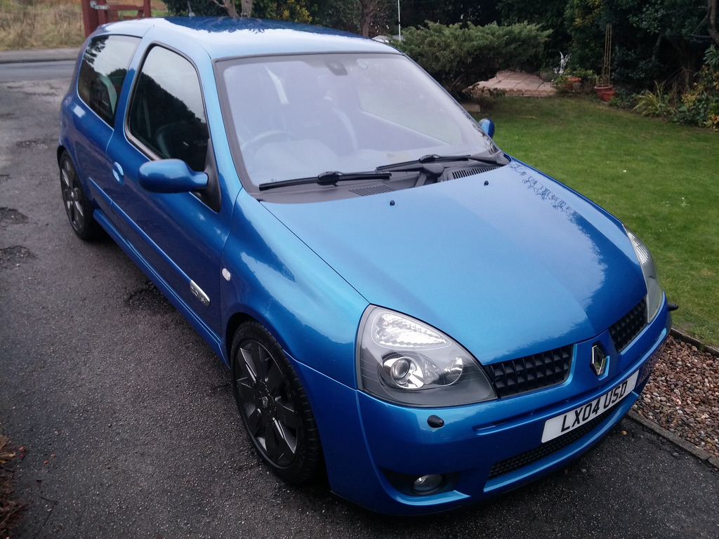

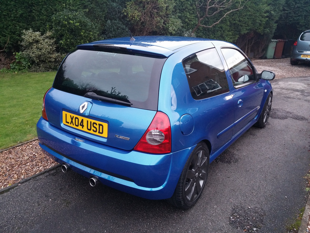

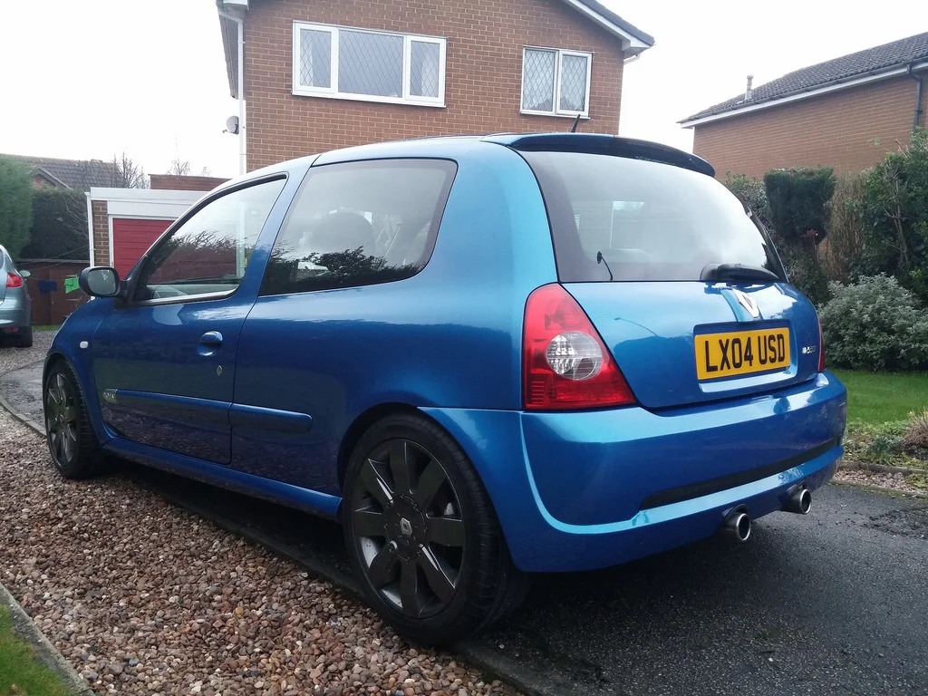

Today I cleaned the car some more and gave it another coat of Natty's paste wax blue as last week I gave it one coat but needed to stick another one on.
I also adjusted the tailpipes to the right. I realised how I could do it. Simply remove the rubber pipe I put in the left and right positions of the mount and put more at one side compared to the other. Hard to explain!
Anyway, instead of just posting the pics in my same old fashion as that gets boring I thought i'd trawl through my thread when I first started it 6 months ago and get the pics in the same angle and compare, just to see the differences, if any, that have been made! Some comparisons are fairly obvious. Some not so!!

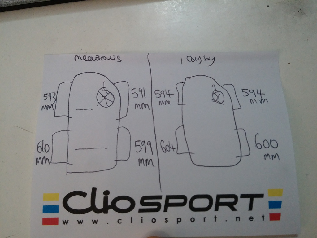

On my A3, one side sat lower than the other even with the adjusters in exactly the same place on either side, so to get it to actually sit level, one adjuster sat higher than the other.
Best way to do it, and what I did, is to find a piece of land that is 100% flat and measure from the top of the wheel arch to the floor and adjust from there.
Just out of curiosity as I have to do this too once I fit mine - when doing this would you get someone to sit in the drivers seat so that the car is level with the driver in the car.
TBH, I never did and it didn't make much of a difference. There's too many variables to get it 100% spot on, such as how much fuel you have etc.
Measuring from the arch to the floor on level ground and looking by eye is the best way to get it sitting as level as poss.

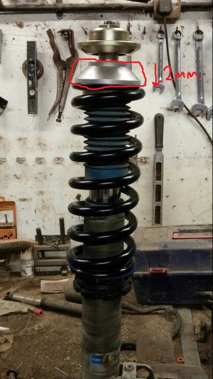

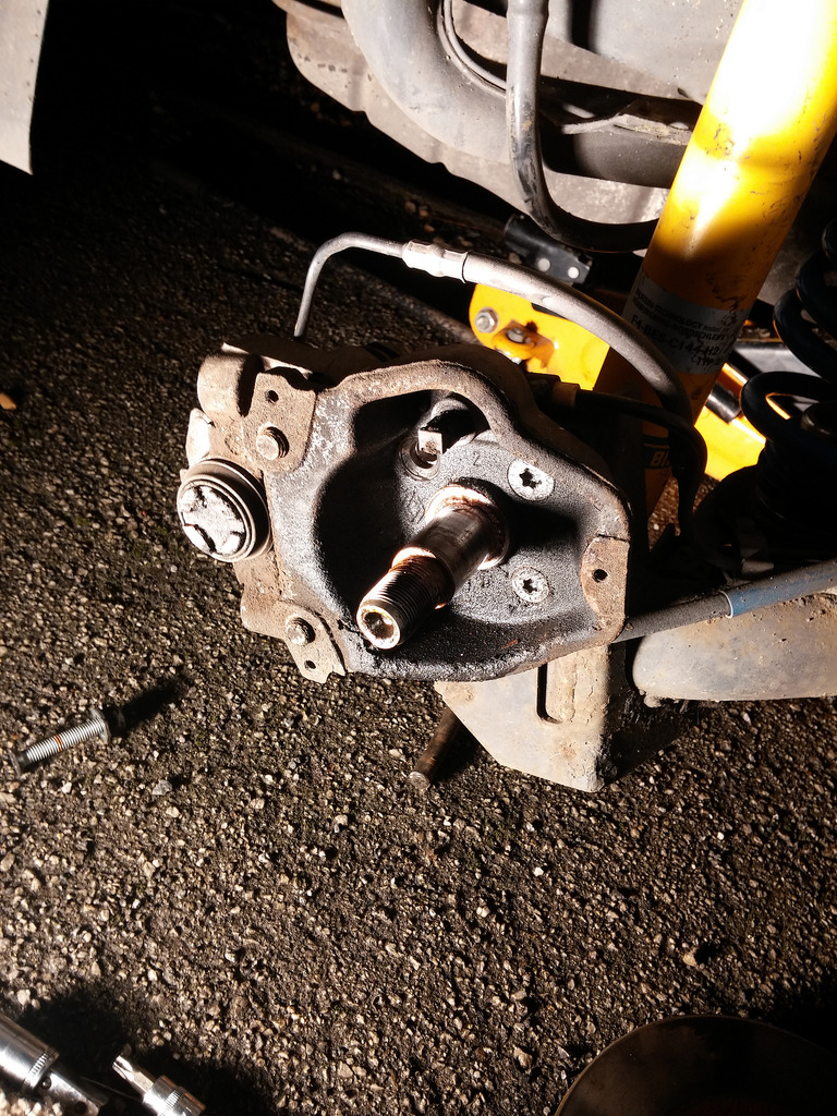

Anyway, i'm experiencing more clunking when turning the wheel and after removing the strut it all seems perfect bearing wise. They're still smooth as ever and no play in them. However one thing I have noticed is that when pressing the silver platform , I can push it down around 2mm! As per the detailed picture (not my bilsteins)🙈🙈
@incy-spider my lovely bilstein guru, is this 2mm movement normal or should that platform be tight as f**k? I've tried tightening it but it won't go anymore I don't think.
incy-spider
I found when I put mine together I had to put a big washer on the top because the collar on the PMS top mount was a bit on the narrow side, it was just a precaution because I'm like that, maybe that's what your problem is, also why are your springs black!!?

I went and gave it a measure tonight. Once on a very flat street near me, not sure how flat but on a scale of one to incredibly flat it's quite a lot flat.
Then another time in a layby near my house which isn't as flat, maybe a 5 out of flat but just to get a rough average / bit of validity.
Here are the incredibly detailed drawings!
20141222_214746 by dann2707, on Flickr
So there's a difference of ~11mm on the rears when on the flat ground! Fronts seem to be spot on though so I won't be adjusting them.
