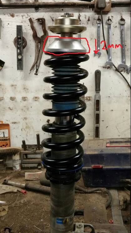

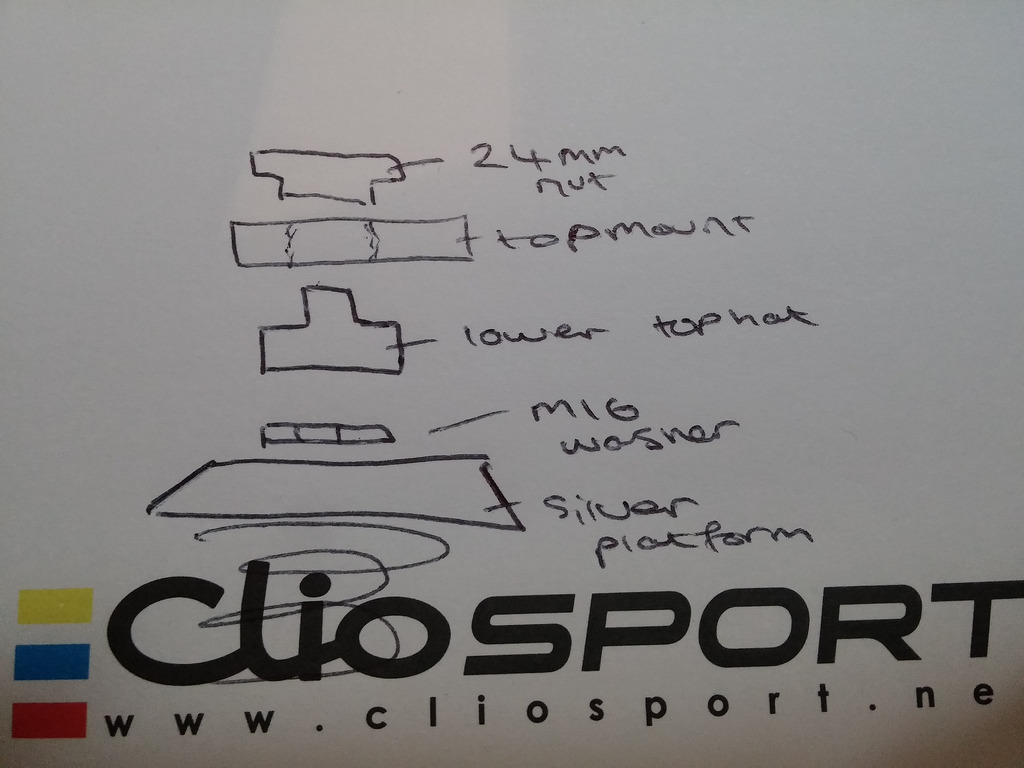

That's defo the sound of your spring twanging as you turn the suspension, because the top and bottom cups don't have a slot or stop to sit in the cup are moving and picking up on the spring, like I said mine did this only for a day or after I've had it in the air, I'd say if your top bearing is nice and free and there is no way that you have installed them wrong then apply some copper grease onto both upper and lower spring seats to allow it to move without picking up..
You defo have the collar under the top mounts to allow space between them? I'm sure you would have because it probably wouldn't go on without it very well, shame your not closer, would have it up on a ramp and sorted in no time! [emoji22]

I think i'll remove them both after work tomorrow and inspect them fully and grease them up like you say! Thanks again for your advice in here mate, I really do appreciate it.
I've done another little drawing of how i've assembled them (these post it notes are a godsend, my spatial awareness is not lol).
20141222_222924 by dann2707, on Flickr

That's spot on mate, lovely drawing too! The lines remind me of Édouard Manet... Truly dramatic, brings a tear to my eye!

You mentioned there is play in the strut like in this pic, if you want can dig mine out and have a look and see if mine are like that

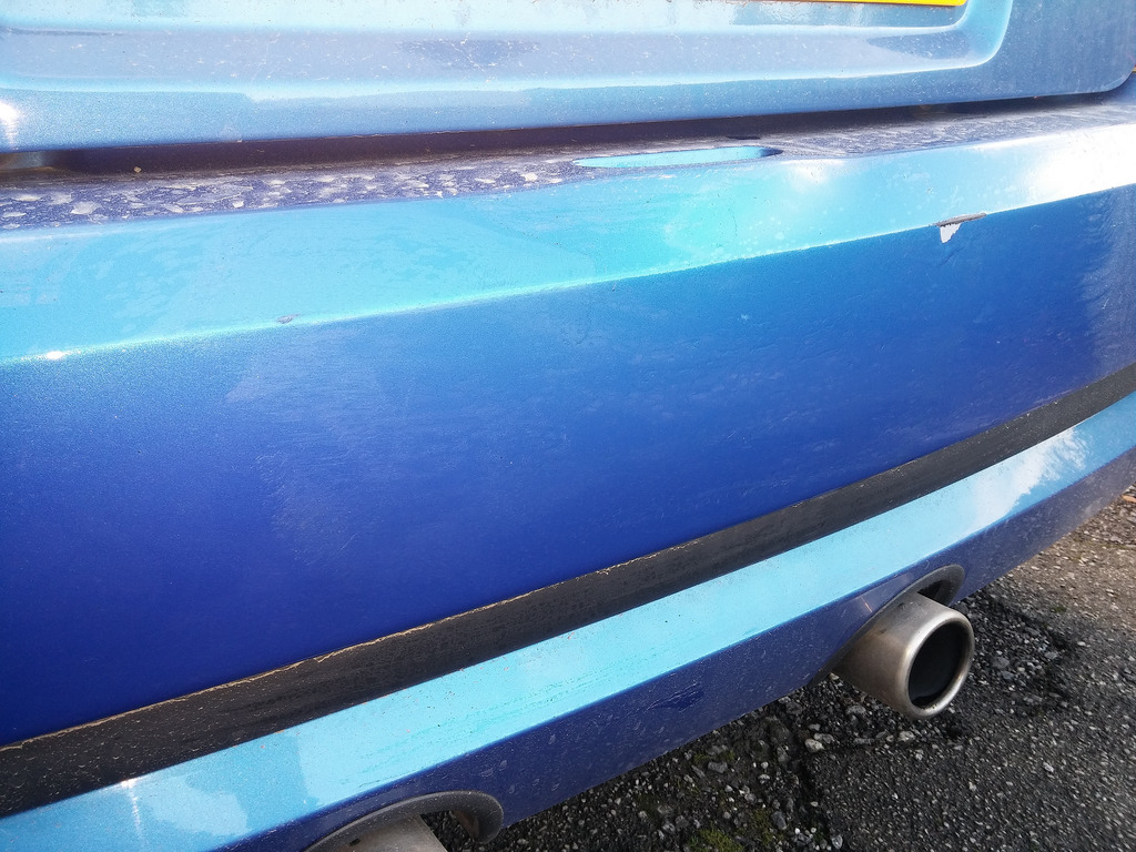

He's so apologetic so it's all good, was an accident . It's just rear bumper damage but needs a respray or a new one :(
How much do you think it would come to for a new one to be sprayed?!

Rear bumper is nice and easy only that black plastic trim out and the exhaust tips off, £150 - £200 I'd of thought for a top notch job..
That's not bad at all mate! Thanks. It'll most likely be in the new year now seeing as though the whole world shuts down around this time of year, bizarre!

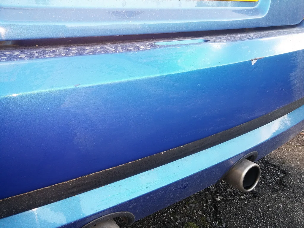

What's up with the car Tom?

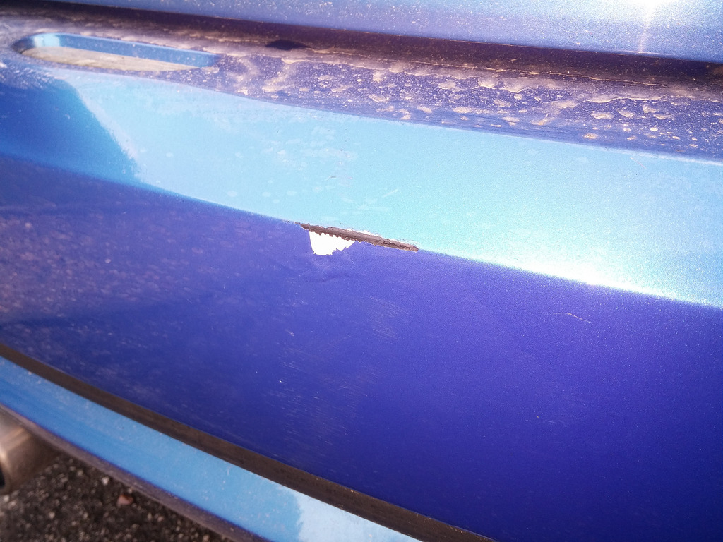

This is the damage. On closer inspection it's not as bad as I first though as lots of it was black paint transfer from his Avensis.
20141224_113531 by dann2707, on Flickr
20141224_113547 by dann2707, on Flickr
My phone doesn't show it but it's scuffed the lacquer to the left too.

Ah well, accidents happen, doesn't look too bad though, wouldn't have thought it'd be a new bumper jobby.
Me too, I'm just about to put my ayfree up for sale now so hopefully won't be too long :).
  Trophy 182
That Sucks Big time!! wouldn't it be cheaper to get it resprayed then get a whole new one?
Bumper doesn't looks structurally damaged from the pic bud. If its only paint, will be easier to get it SMART repaired or if you can afford it take the bumper off and get it down to a bodyshop for respray. A second hand bumper will more than likely have a few small scratches on which you will want to repair anyway. :)
dann2707
I think a respray would be on the cards yeah. Hopefully i'll be able to get it sorted before i'm back to work on the 5th.

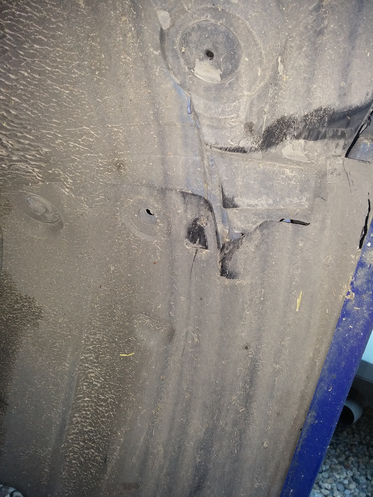

I've managed to do something today that no man has ever done in the history of car forums - I changed my pollen filter for a new one without taking a side by side picture of the new next to the old one with a comment similar to "FWOARRRR I'm glad i'm changing this, look at the colour difference" or "Pollen filter change was definitely over due" lol
I also inspected underneath to see where it was catching on full lock and the lovely black bits showed me where
20141224_145613 by dann2707, on Flickr
So I erm, cut them out!! Hope that will stop the horrible sound.

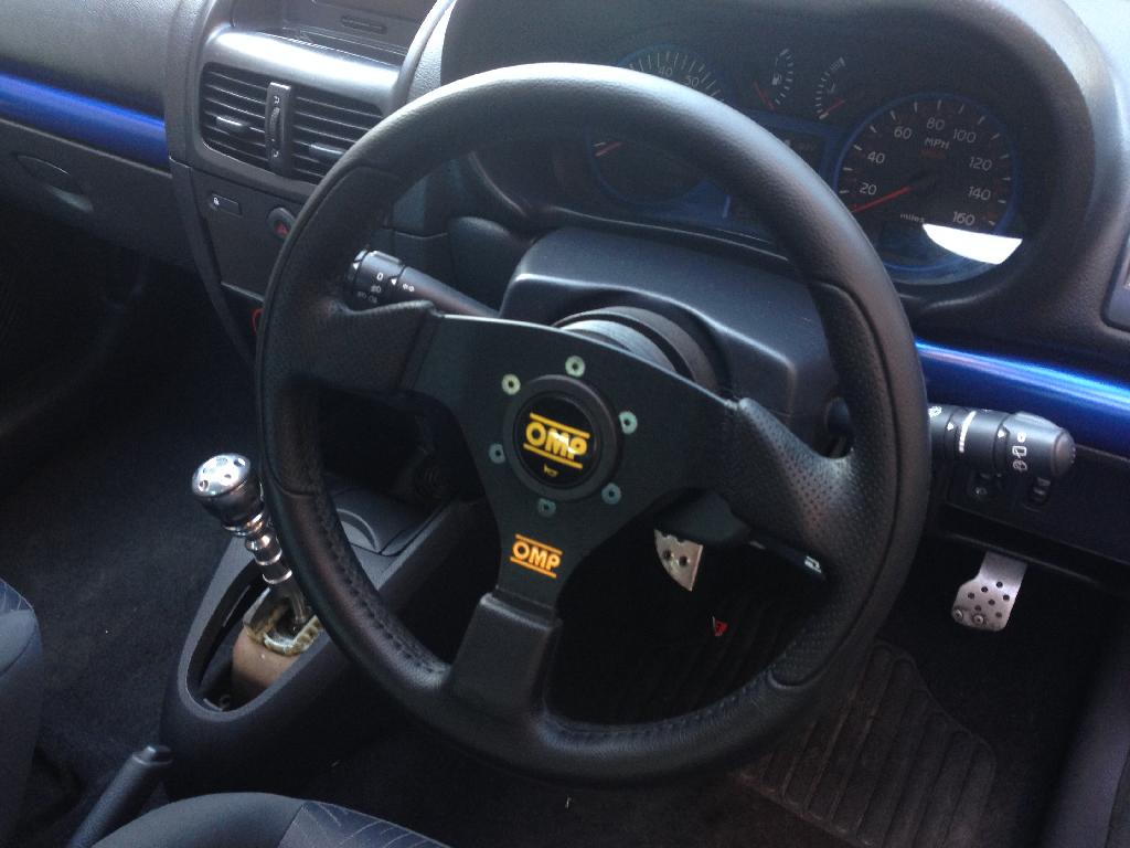

I've ordered this wheel and a momo boss this morning as a little xmas present to myself. Credit to @MarkX for the pic. Should really tidy up the interior even more, can't wait to get rid of the big ol' bus wheel and will be able to recoup some of money by selling it on seeing as though the thumb grips are brand new.
And despite me trying to reason with myself not to spend dollar I also may have bought another pair of Michelin PS3's and the Yanoo Stiff s**t 3.0
Can't wait to receive everything :D
New to-do list created!!
20141225_194505 by dann2707, on Flickr

It looks good, even has the lift up collar for reverse.
Needs a leather gaitor though and I think it would look good with a carbon fiber tube to cover the metal shaft.
dann2707
The stiff shift i've gone for isn't the full deal unfortunately, just the part at the base of the shaft (hehe) that stiffens the gear changes and removes a rubber bush that splits like mine has.
I've opted to stick this in a Renault Scenic gearshaft assembly to raise the gear stick like the PURE one but at a massively reduced cost! I wasn't sold on it originally but i've been looking at the longer sticks and felt one today and it definitely feels better despite me not liking them originally.
