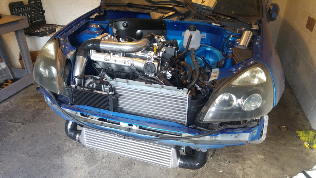

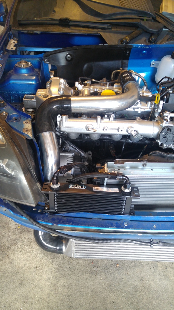

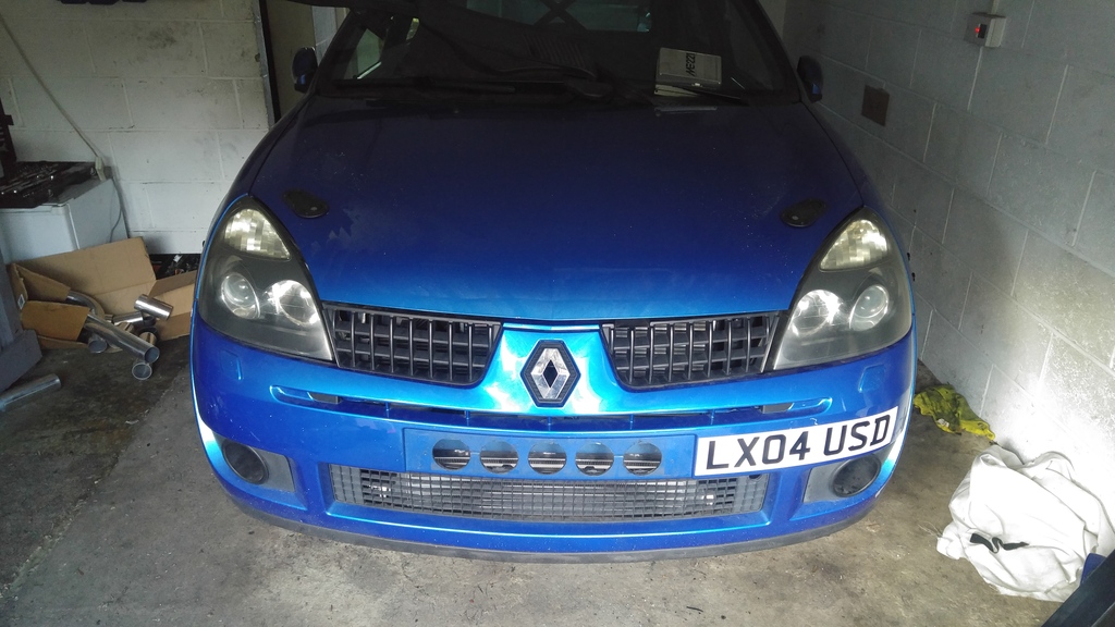

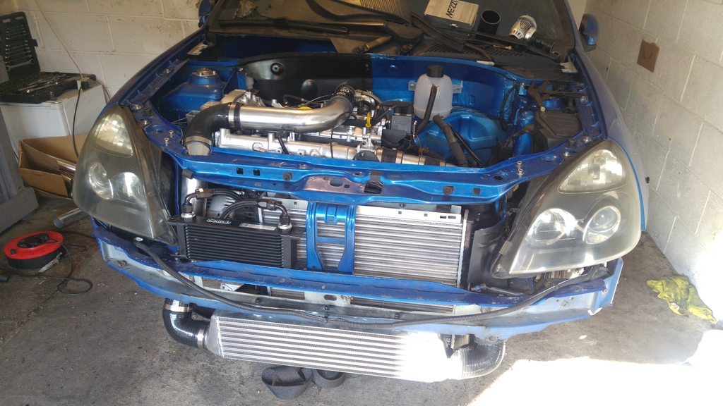

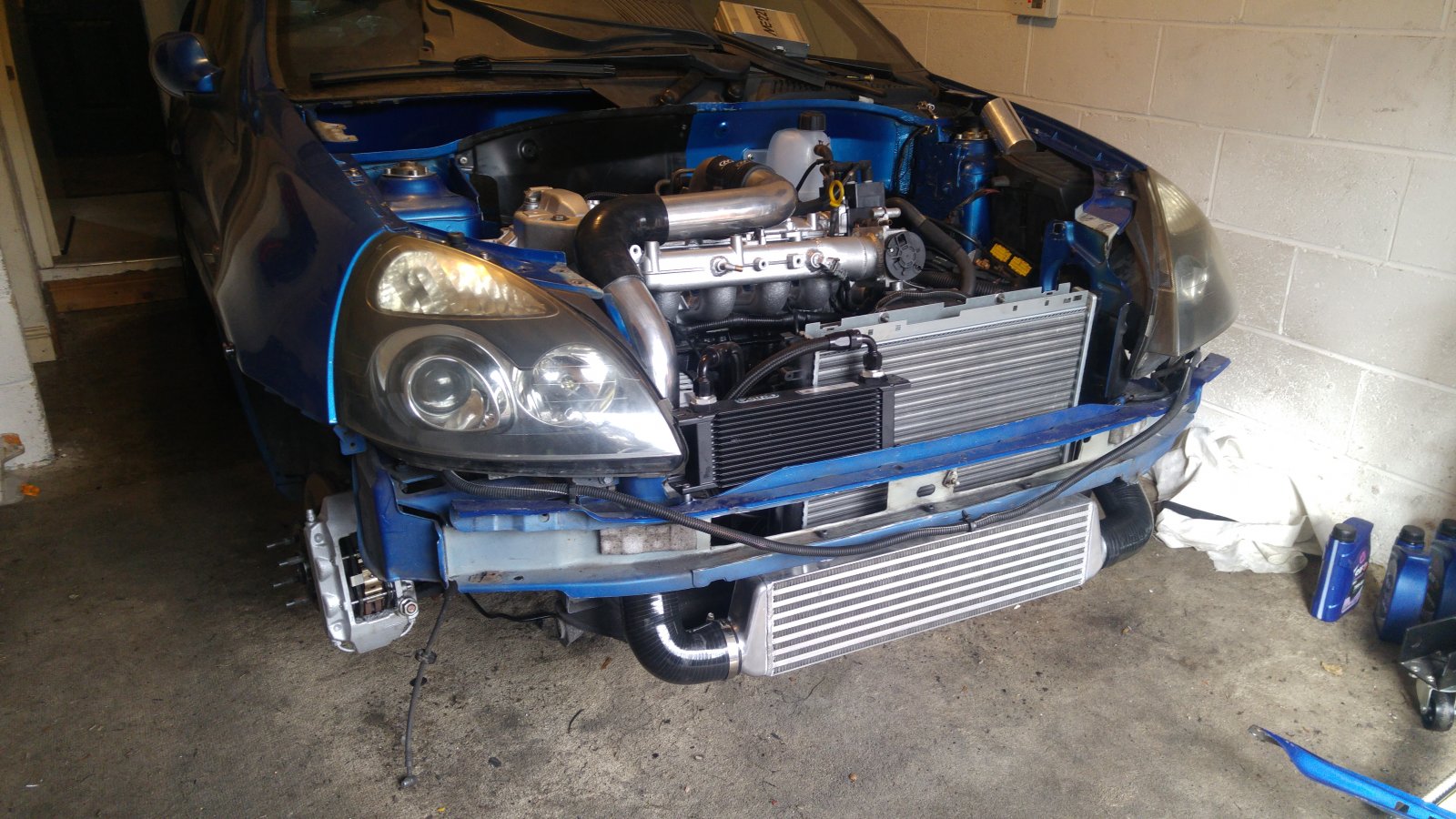

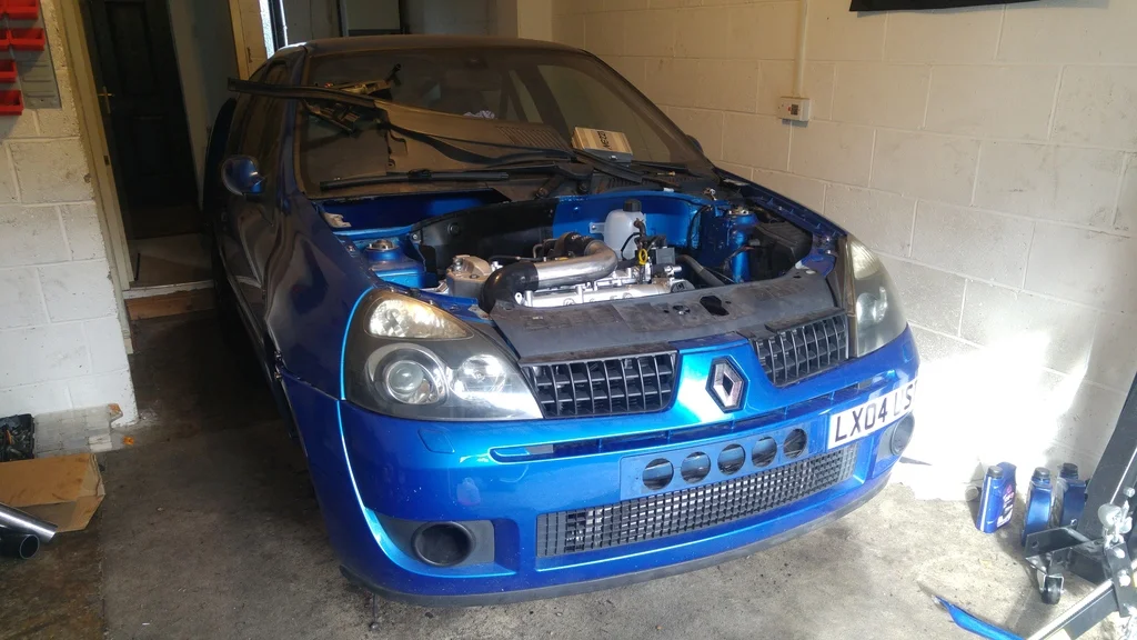

Was going to ask if your keeping the FMIC silver or stealth?
Maybe me, but im not a lover of the side plate. Buts that's me being picky. You'll probably be going too fast round track for me to notice!
Thanks sexy. Im probably keeping it silver yeah, as much as I don't want to. As LEEDS9697505594 said, it would just chip and look s**t I reckon.
Haha yeah its more of function over form on that respect. Most likely going to get a smaller one to replace it as it looks a bit silly big. I want one the same size as @Chambers_RS ideally but it's deffo asking for trouble with the popo

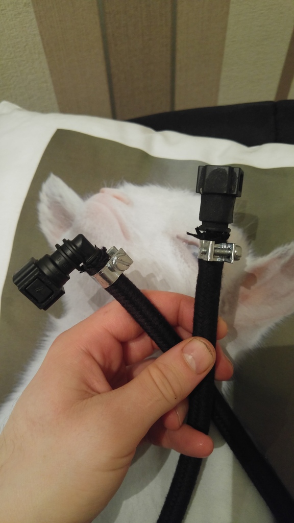

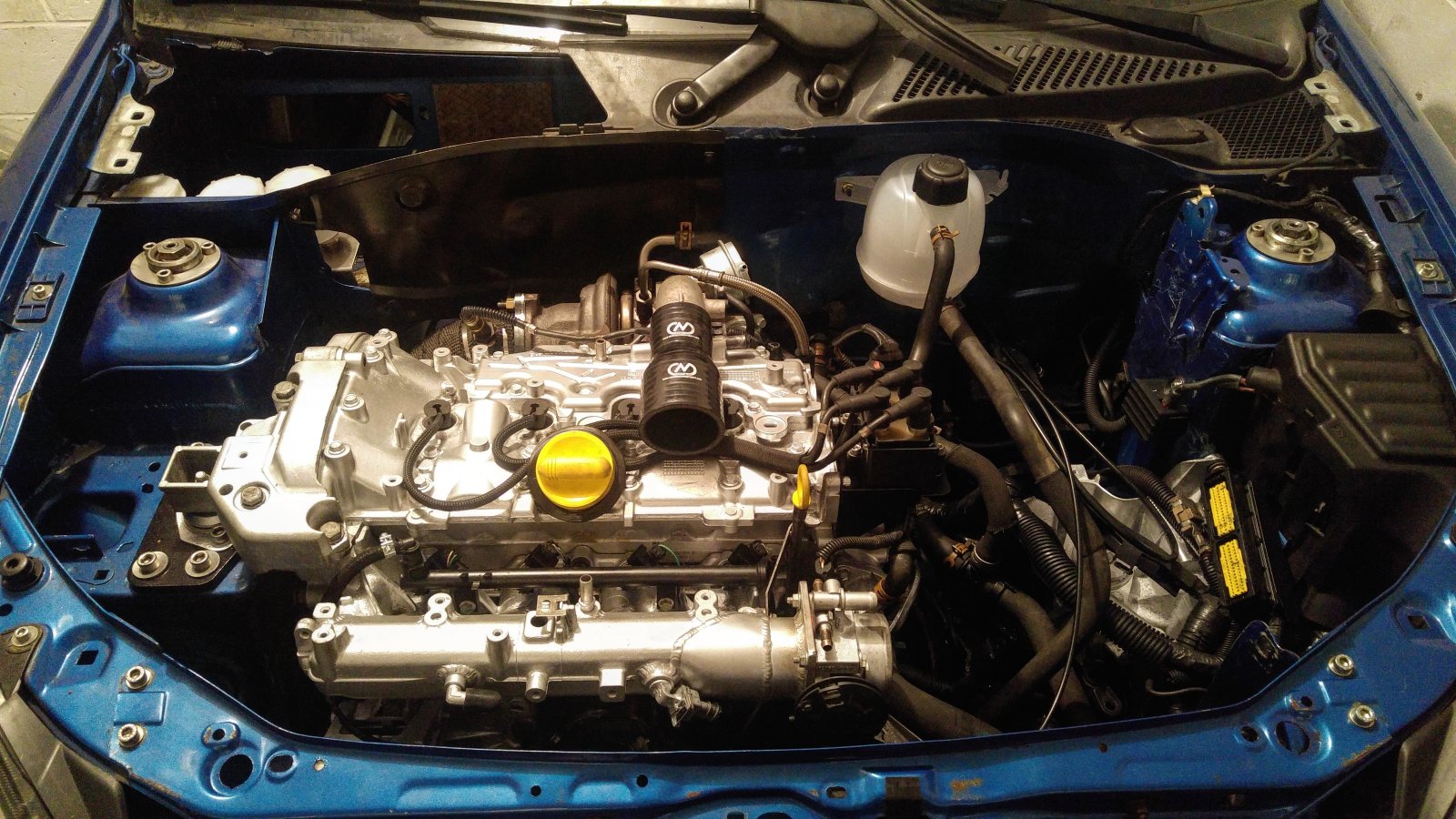

Fuel line parts from the injectors to car chassis pipe has arrived so made that.
Original clio wouldn't push on nicely so got my own pipe and clips.

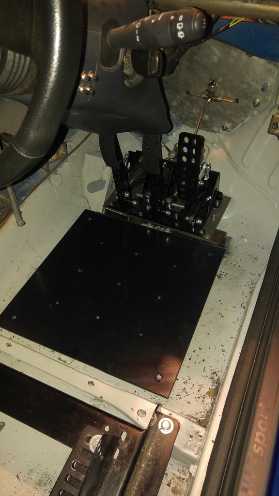

False floor mocked up
And finally the above final piece has arrived so that I can actually try and fire it today. See if it turns over and fires. Really nervous and excited at the same time. Will film and see what happens...

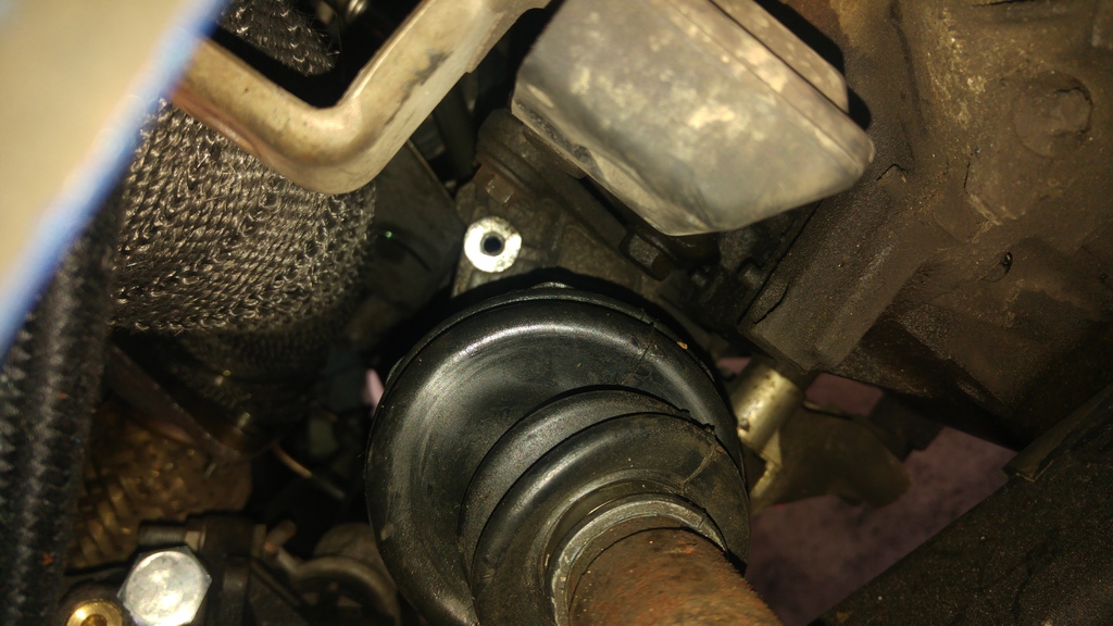

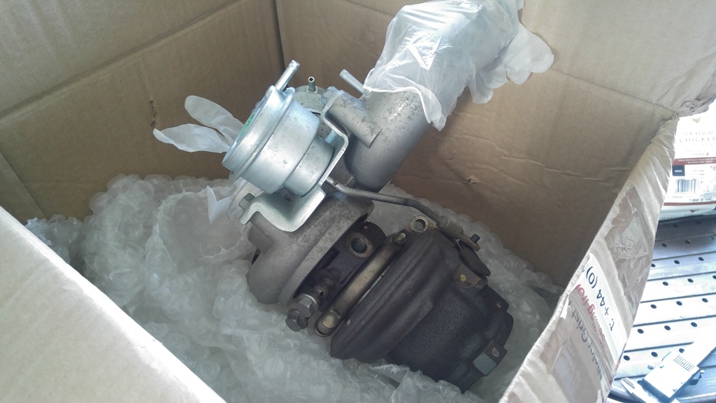

Cheers all for the comments! Downside is before I started it I felt in/out play with the turbo. Bloody hell.
More expense... So I'm looking for a meg 250 turbo if anyone can keep their eyes out.
  Clio 182
Send the turbo to A.R turbo engineering. Alan and Rob are great. They can test it and repair. We use them at work they always come back spot on. You will be surprised on the cost of it.
As noothloop said the oil pressure will take up any slack. There should be a very small amount of play.
But if you are worried give them a call.
dann2707
Well, after about a day of some hard-core man maths, convincing myself and thinking about the fact that I'd rather run a bigger turbo with less strain than a smaller turbo at its limit I just came home today with this...
Megane 250 turbo :smiley:

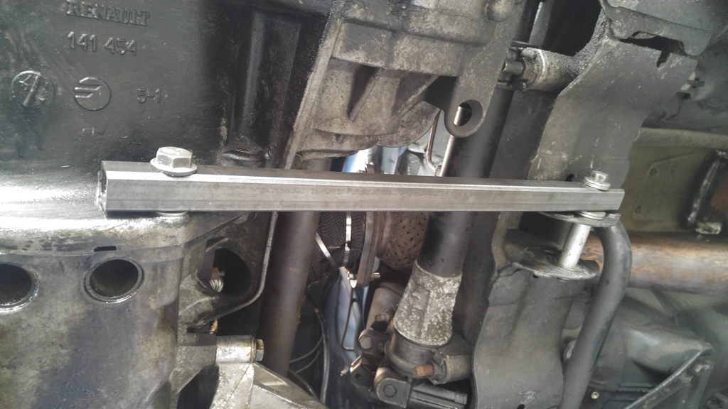

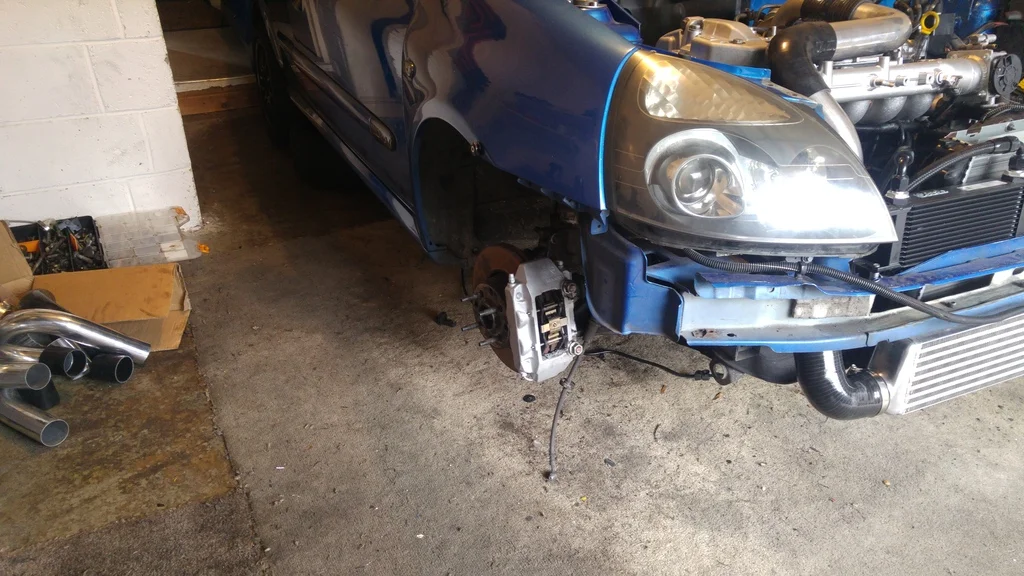

Made a dogbone courtesy of @Matt555 's idea however I'm going to look at getting something a little less harsh. Well aware of the Meganes sump cracking issue so will be adding some vibration dampening to it. Got a friend who says he will make me a dogbone mount for free out of the one that @JP83 kindly sent me . Thank you mate.

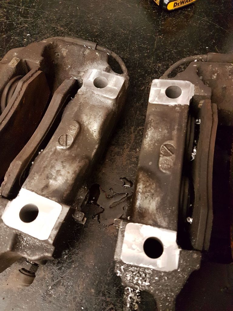

Dropped my brembos off at a new contact i have made in Derby, he machines at home, has his own cnc milling machine and knows his stuff as he works for rolls Royce r and D. He's definitely inspired me with confidence and would recommend him. Sent me photos earlier on of his work.
So I can now refurb them when I collect tomorrow.
Got the OS driveshaft in but require the bearing retaining bracket, does anyone have one lying around please?

Would recommend you take the pins out of the calipers before you paint them, from just looking at the calipers I think you may have a challenge. A suitable punch and a big hammer (@jaswalker24 - what hammer would you advise 😂😂) should do it. You can get cheap brake pad fitting kits from euros etc.
.Joe
Excellent progress being made.
Angle grinder and 10 ton press worked for me, also fit mr pinks pin kit will save any hassle in future :)

It's getting there[emoji106]. Was that 5mm off the calipers? Maybe I should offer my services to do that!
Yes it was mate. Guys done that and changed my front wheel bearing for £40 so I can't complain there.
Cheers mate. I have a selection of punches so will get them out tonight!

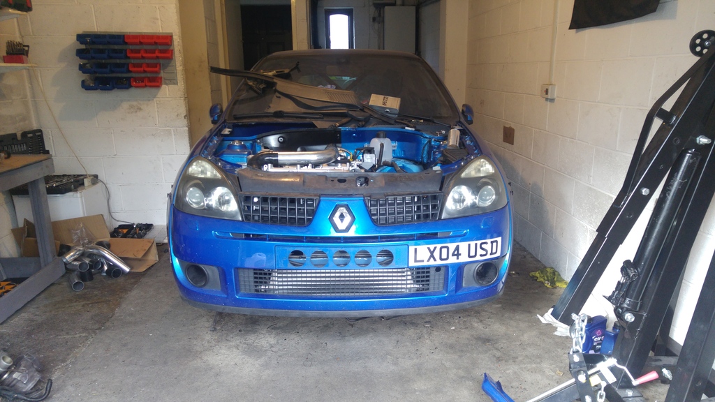

Ordered the few final parts require now such as some random boost pipes, connector for the blow off valve etc. Should be able to make some hefty progress this week.
I'm in Ireland next Sunday for a week with work so won't be able to make any progress then sadly.

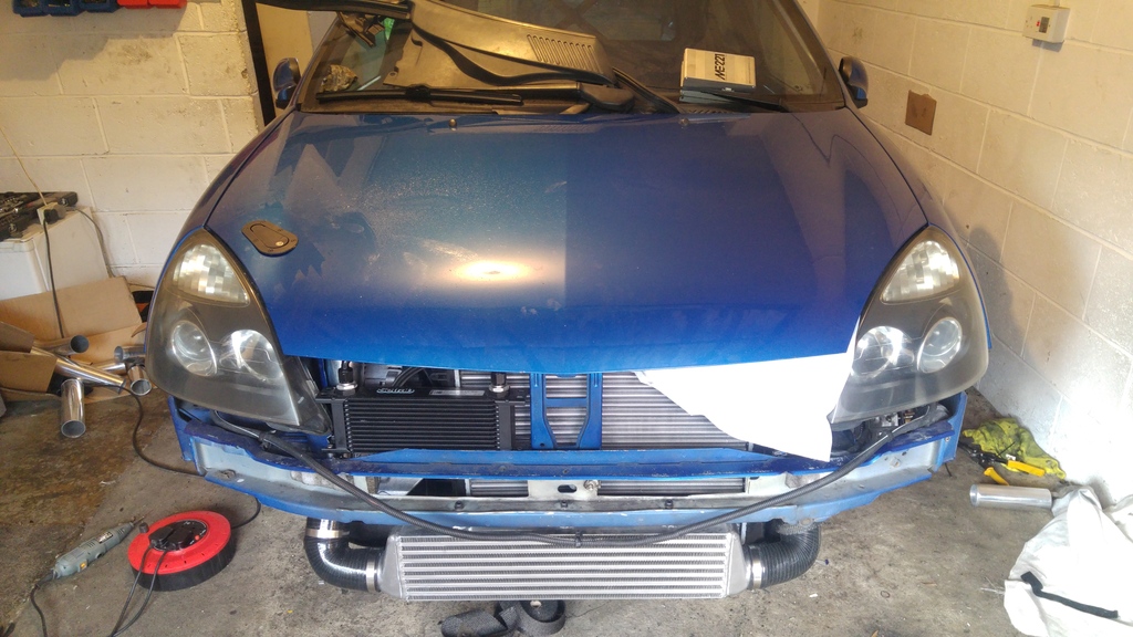

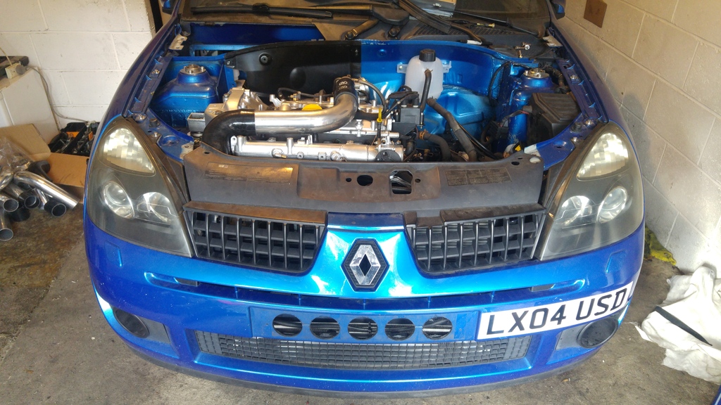

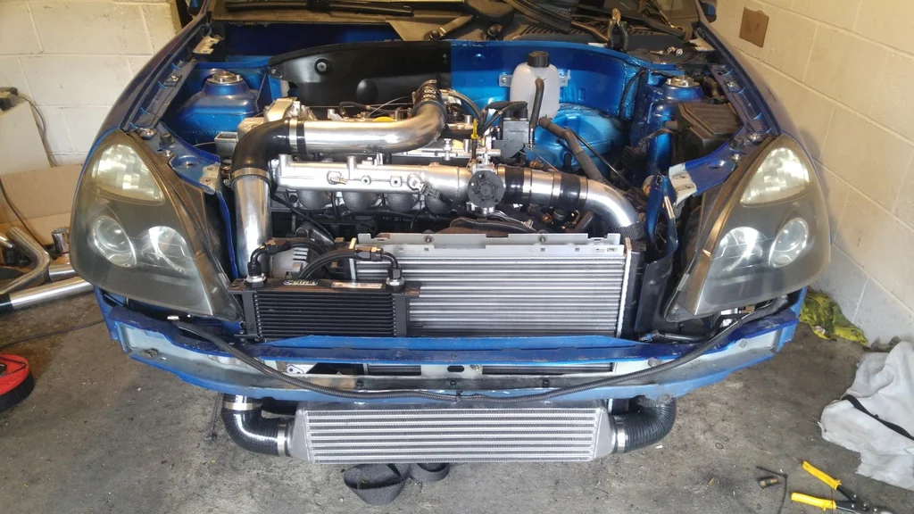

Okay, so slightly bigger update whilst waiting for tea to cook!
Will start from the beginning as above was just a sort of finished pic.

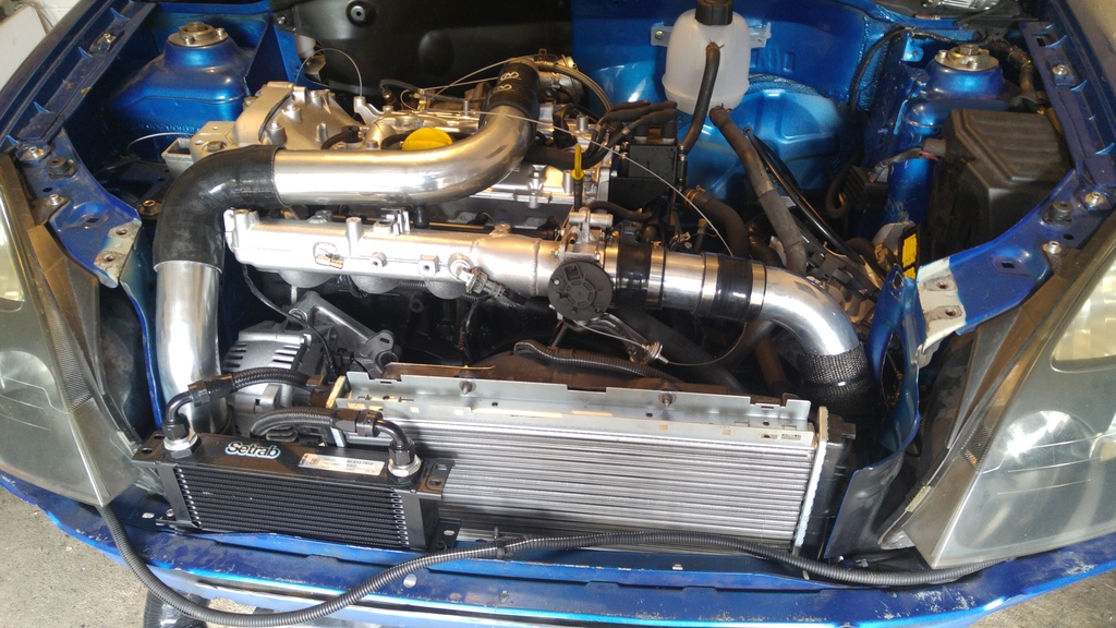

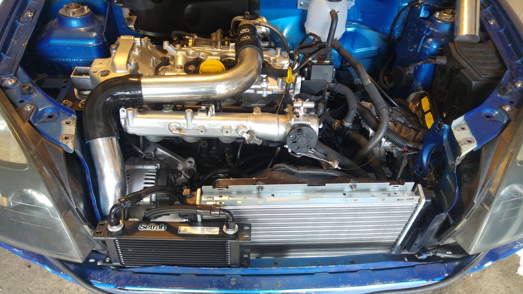

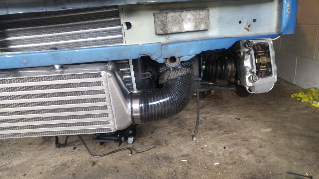

Started mocking up the boost pipes

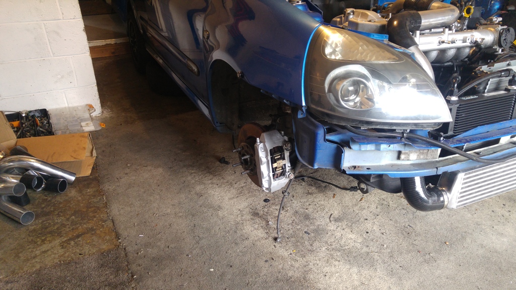

Brembos are fitted too, just running standard pads for now until payday then i'll upgrade
Bumper on just to see what it looks like
Then went for tea and to the comedy night with the mrs!
Had to get in the middle of this (not literally sadly)
Went to nandos for the first time with the girlfriend and nearly died trying this. Got used to it and doused my whole meal in it hahah, lovely stuff

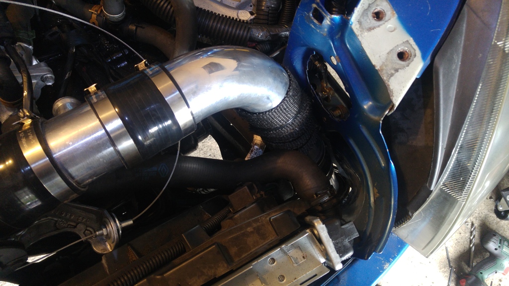

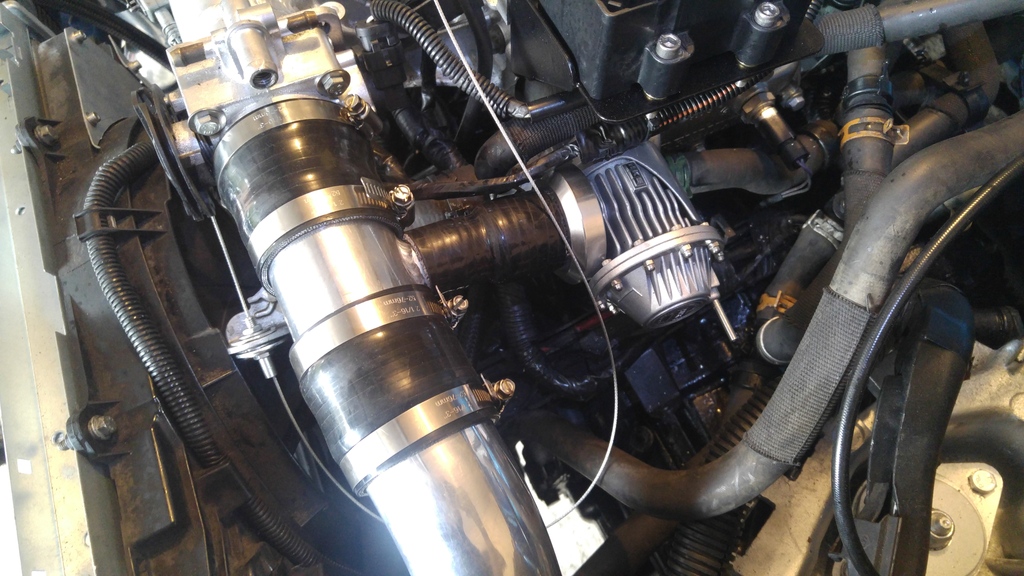

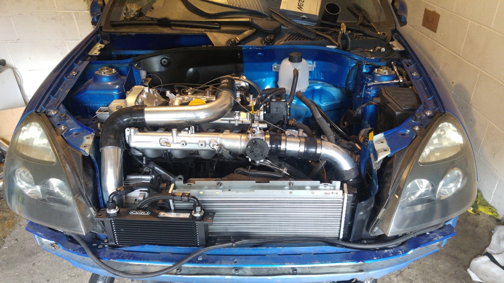

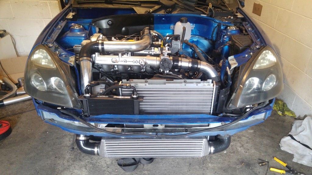

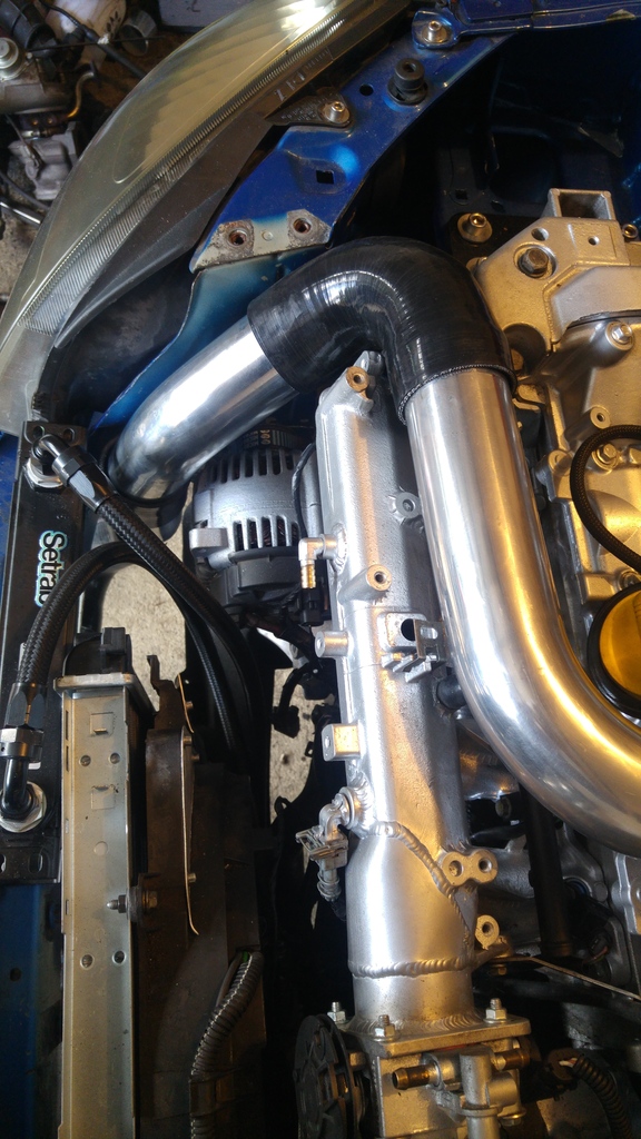

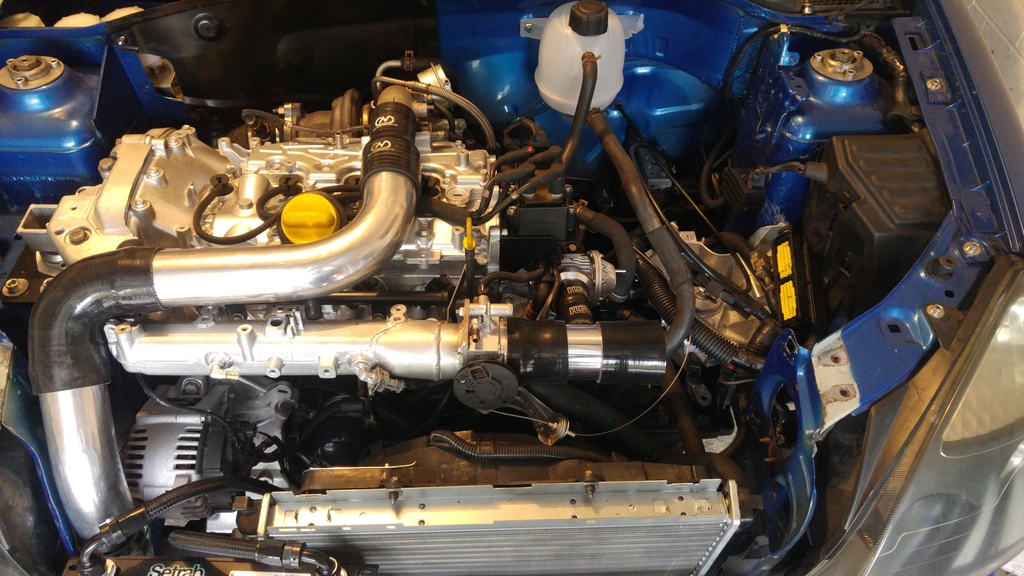

Today involved finishing the boost pipes and aerocatches so first things first, drive to the post office to collect some goodies

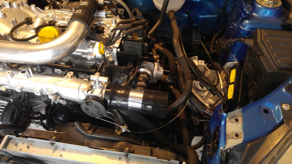

Fitted the BOV adapter

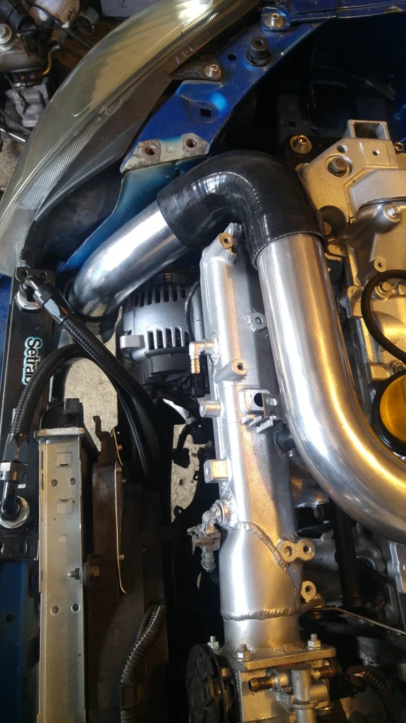

Then started on the pipework
Fitted the lower pipe and protected it with some heat wrap just for fretting reasons
Same with the top. Pikey? maybe. Protected? yesssssssssssssssssssss
BOV fitted, just need some jubilees to sort it
Slam panel fitted with a bit of modifying for the boost pipe. Just a bit of angle grinding action
Then made a start with the aerocatches
One done, was really easy. Took about 15 mins
Both done

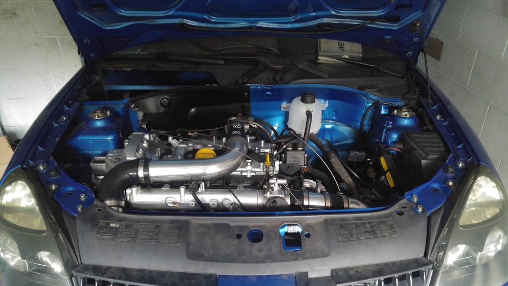

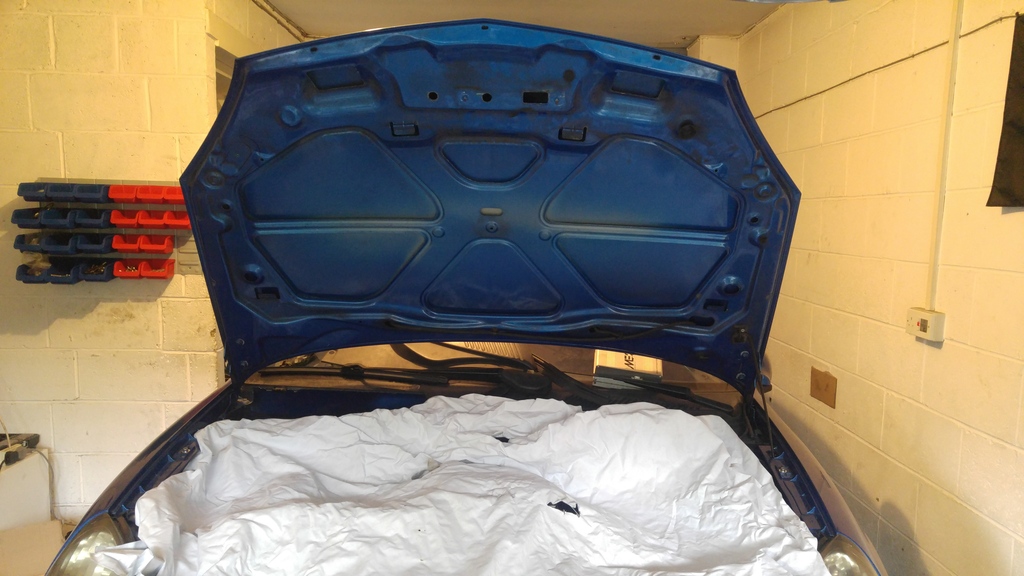

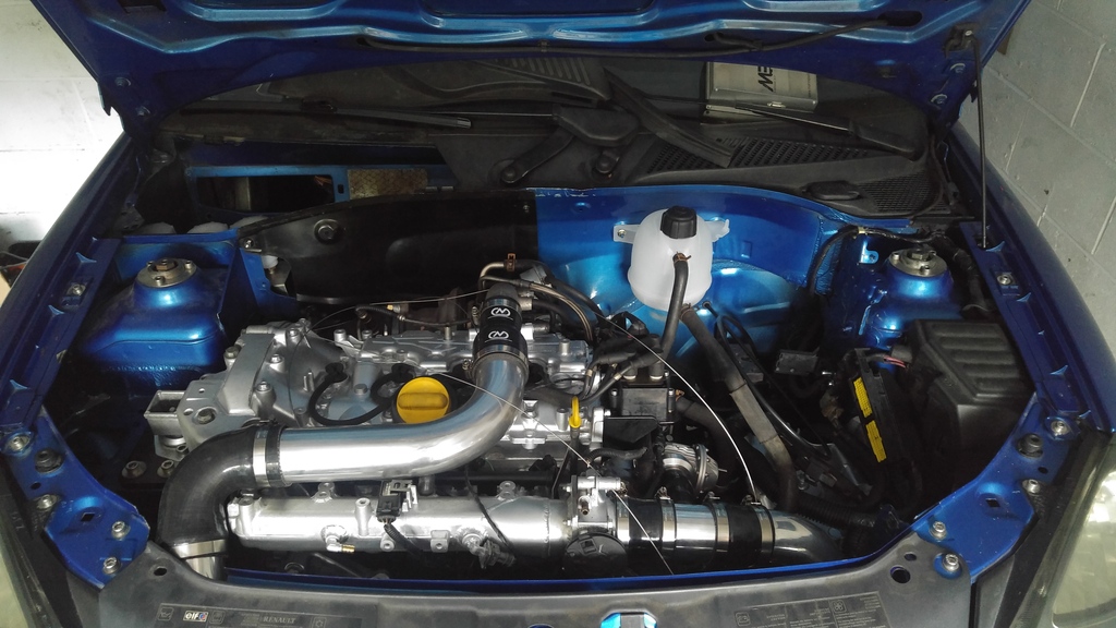

Then the engine bay with the bonnet open :smiley:
Needless to say i'm rather happy with the progress today and yesterday, still got a few little bits and bobs to do now like fit EPAS, sort out a proper dogbone, bleed brakes and clutch and sort out the accelerator pedal but it's all fairly easy stuff. Got a fire extinguisher to affix somewhere too.
