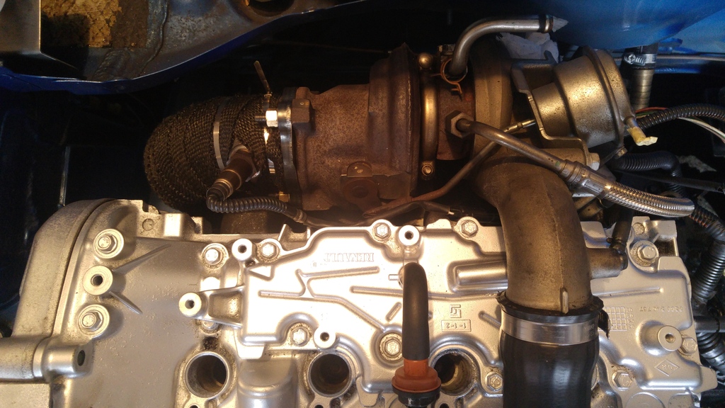

Where'd you get the heat wrap from dude? Need to pick some up for my new DP when I finally get it welded up and want to avoid paying over the odds, but refuse to buy the cheap nasty Chinese stuff some folk go for.
dann2707
It was just one of the first ones I saw on ebay luke, was around £9 delivered. Probably flammable..

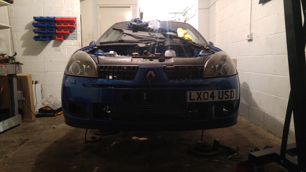

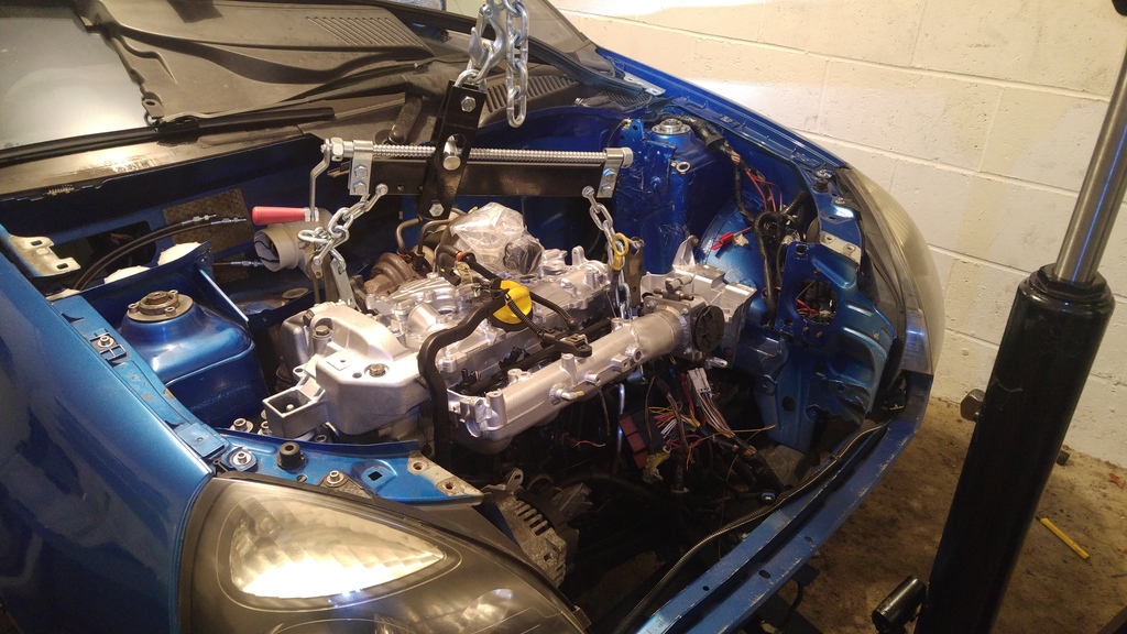

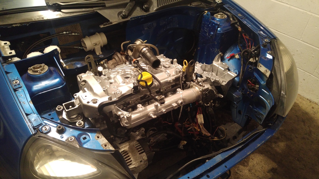

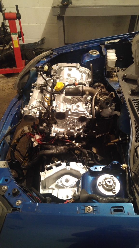

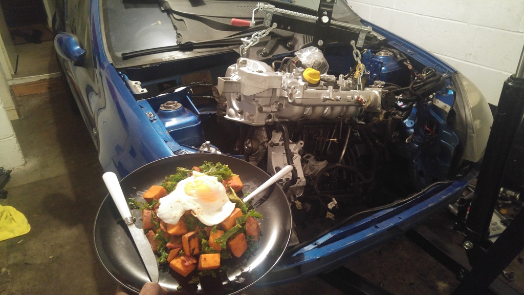

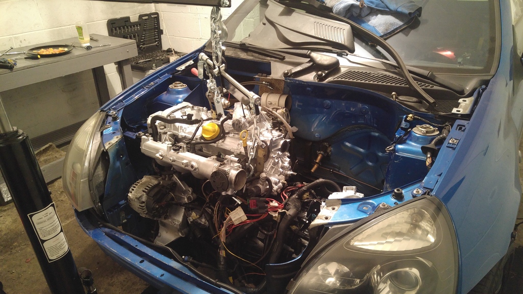

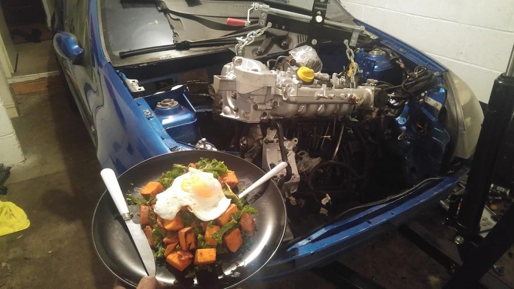

Good news, the engine is nearly in. Got to nock the chassis in a tad bit more but it's mega close. Had to lift the engine back out as I need to fit the alternator. Thought I'd be able to do it in situ. Took the opportunity to spray the gearbox mount whilst it's out.
Was in the garage all night so the girlfriend brought me tea down. What a hero. She's a goodn

With regards to the heat wrap, let me know how you get on. Mixed reviews of the cheaper stuff so it seems a bit of a lottery, fingers crossed! Don't be too alarmed if it's particularly smoky the first few times it gets hot, just keep an eye on it.
Mr Trailer Man
Strong progress Dan, won't be long now!
Don't buy the cheap stuff. Get this from Demon Tweeks/JJC, you get 5 stainless steel ties with it for free too.
http://www.ebay.co.uk/itm/2-x-25-51mm-x-7-5-Metres-Volcano-Exhaust-Heat-Wrap-Chopper-Bobber/361195630508?_trksid=p2047675.c100005.m1851&_trkparms=aid=222007&algo=SIC.MBE&ao=2&asc=41434&meid=14620dd1b9dc44bab7c16d75d7b65e74&pid=100005&rk=3&rkt=4&sd=141551577012
You may need more or less, but they do several sizes.

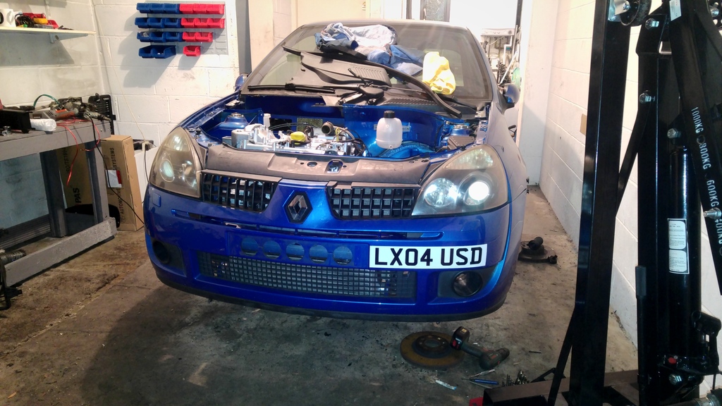

Today was a good day.

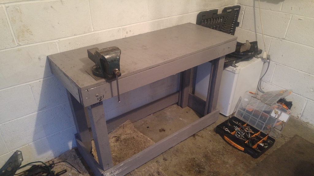

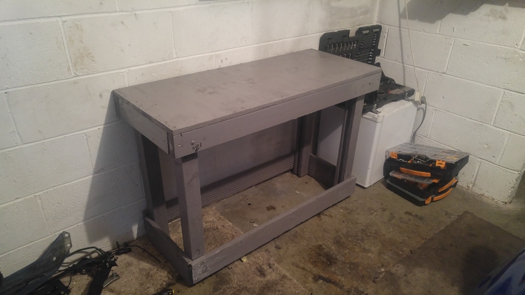

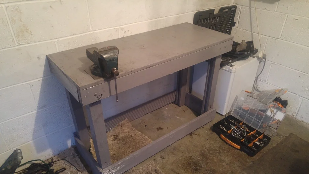

Went straight after work to go collect a work bench
And installed a vice onto it.
Weird how it's made things so much easier already, it sounds stupid but even just leaving sockets on there whilst I get something.

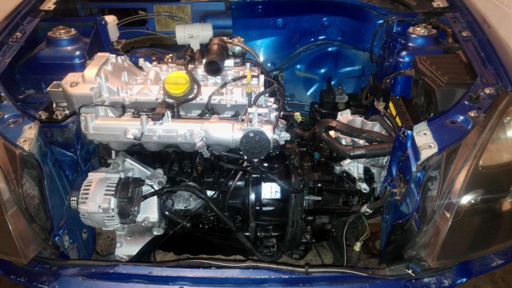

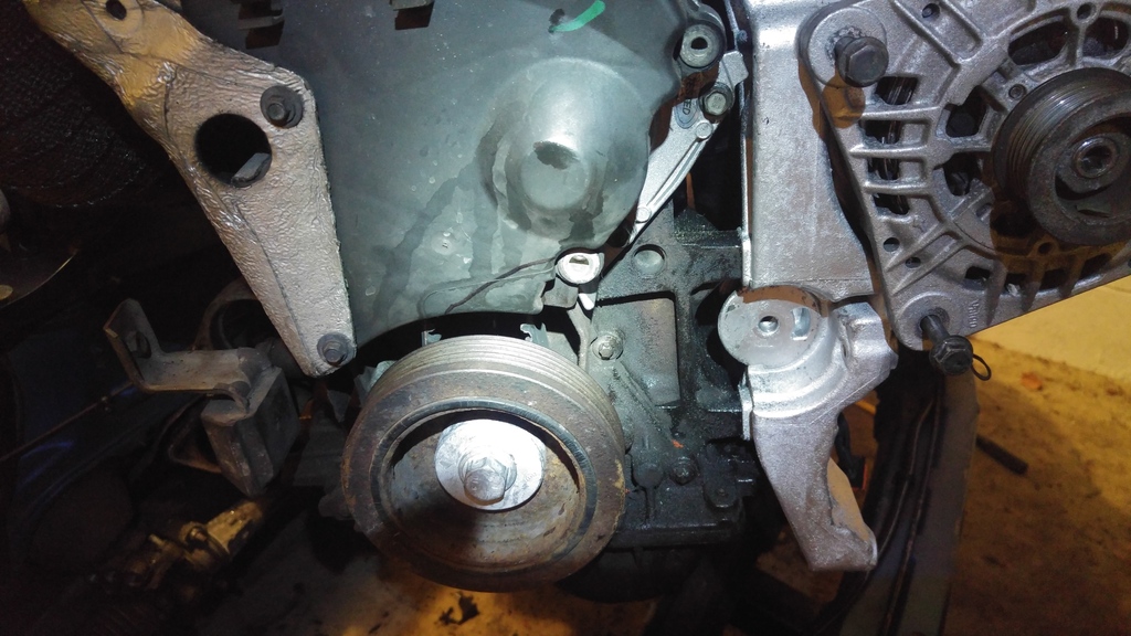

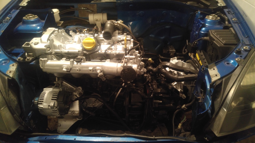

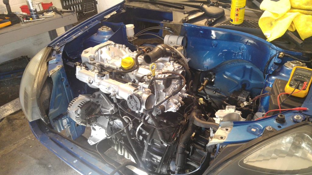

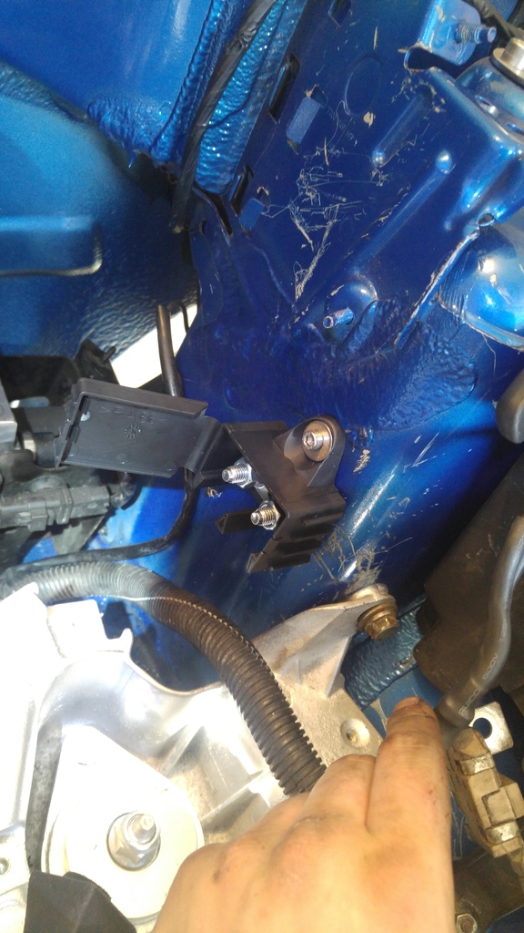

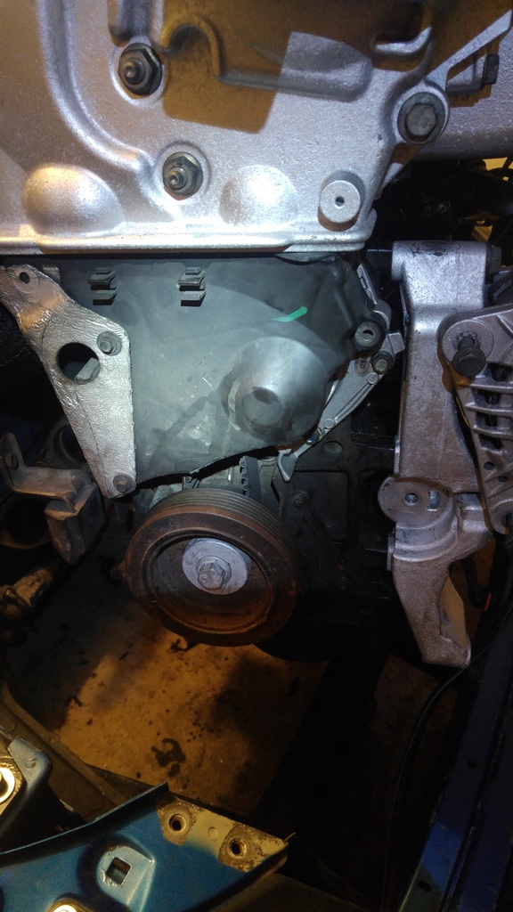

Marked where I am to cut the cambelt cover

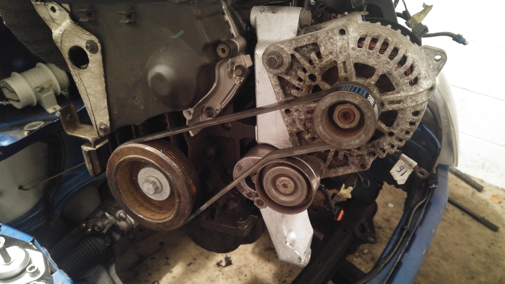

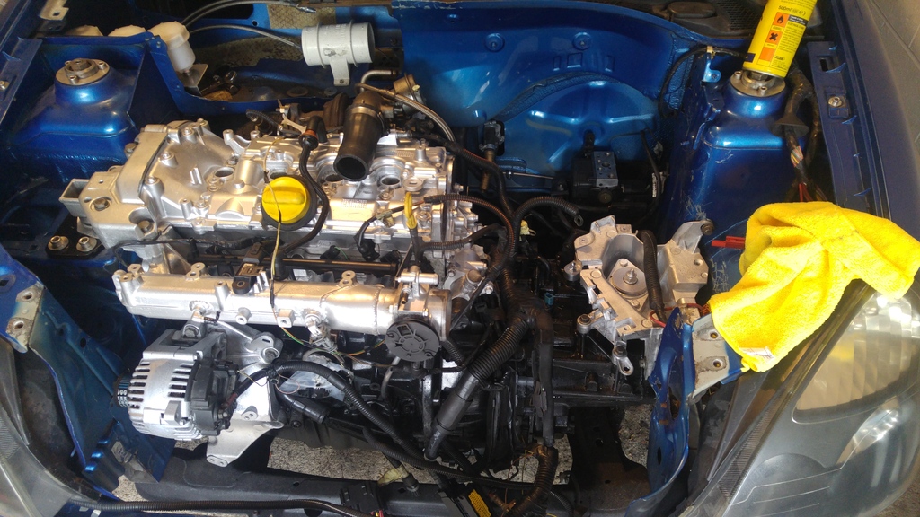

Then a mate dropped me an alternator off as mine was siezed up. Fitted that along with the stretch belt and tensioner.

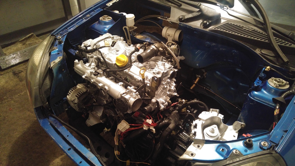

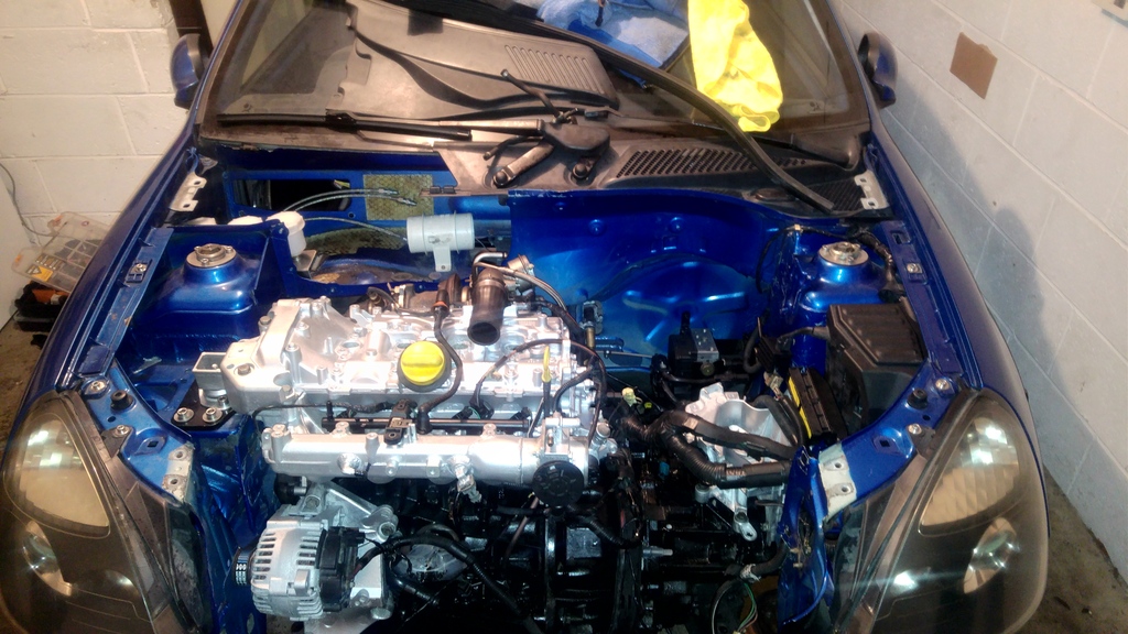

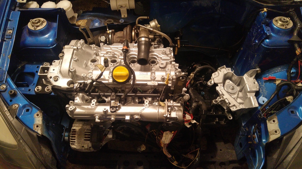

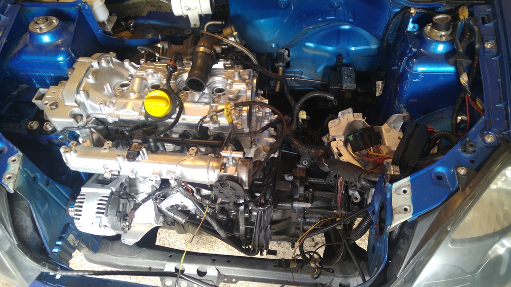

Then fitted the engine. Didn't take too long at all really. Just a bit of persuasion of the chassis with a hammer

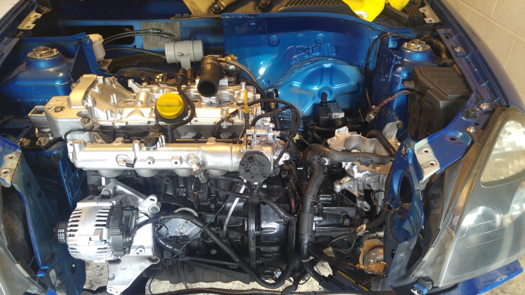

Then the final product..
Finally I painted the alternator after those pics and called it a night. All the little things can come together now.

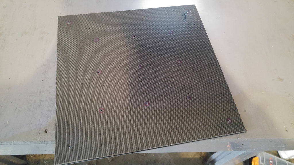

I got my false floor yesterday so started drilling that. It's not real carbon as you can tell but it actually looks quite decent in person. I'm raising that up with lots of alu spacers i've got.

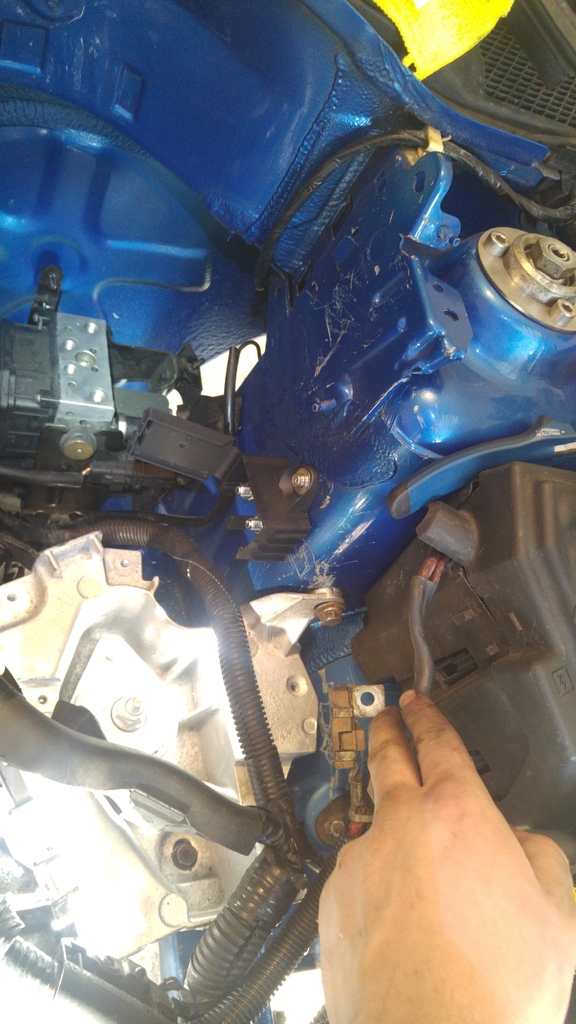

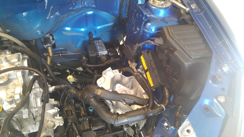

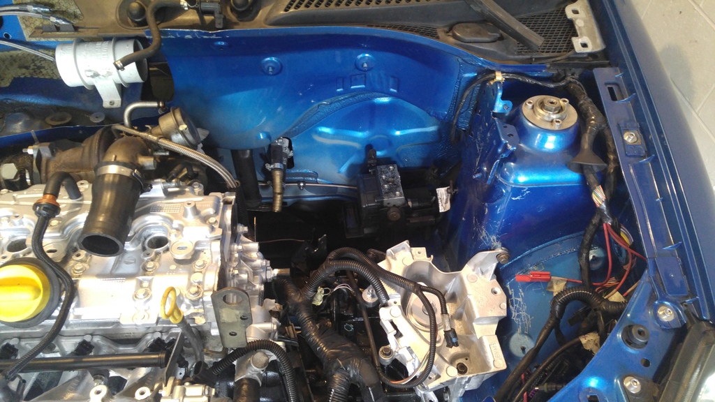

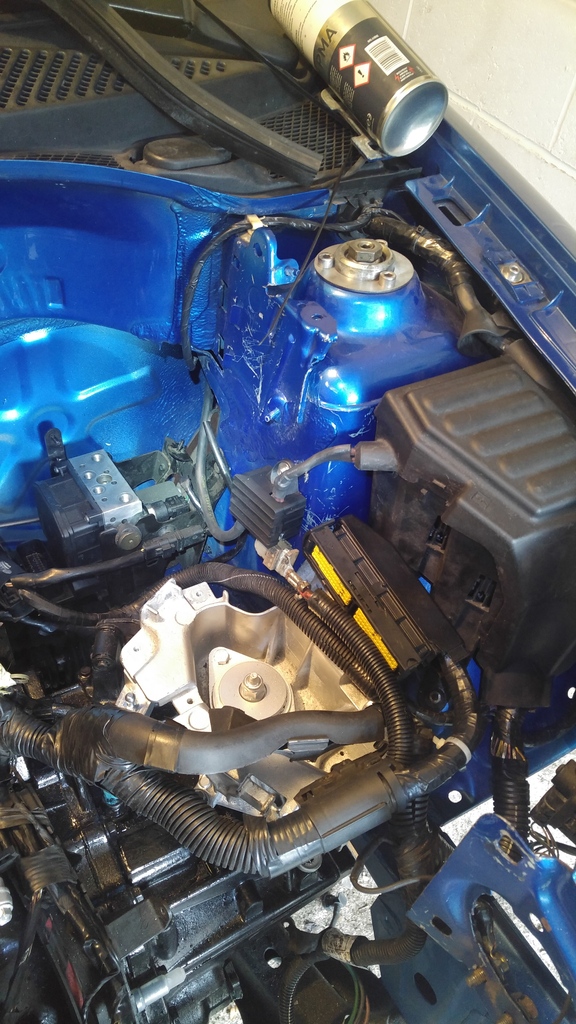

Today I did quite a lot in terms of wiring prep and other bits and bobs...

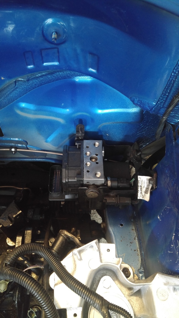

Fitted the ABS pump. For those who may have missed it - i'm using this as a speedo pick up
Become a bit of a tart lately and you've got to do things right, got the wire brush wheel on the drill to tidy it up on top as it had corrosion
Then fitted the lambda

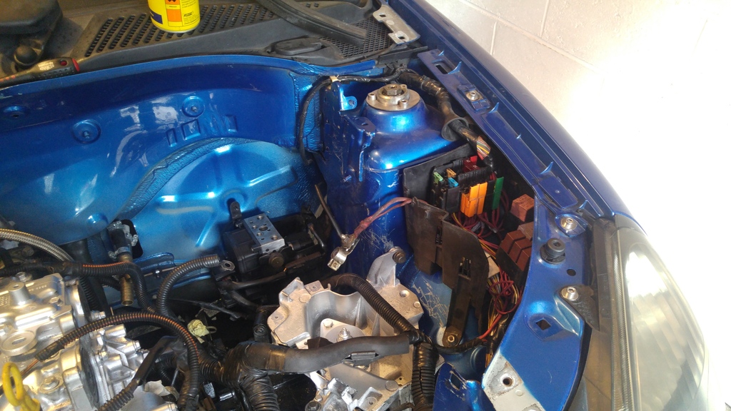

Started on the loom properly, had to source the carbon canister wiring and connect a connector and wiring to that for the N75
Tidier? maybe, can't remember why I took this pic hahah
Fitted the fuse box, connected that up

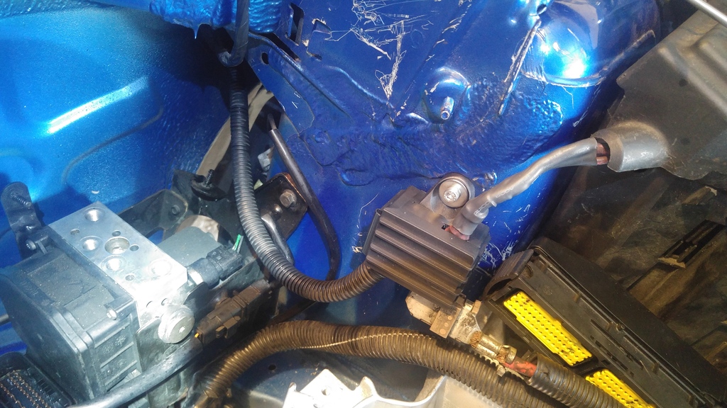

Then installed the battery junction box and fitted the right ring terminal on the +ve
Excuse the horrible scratches, must have been from taking the engine out before. I will get them touched up
Taped up some wires some more as not keen on the coloured wires showing
Next plan is to fit the oil cooler, coilpack and plugs from @optical , top up with oil and see if it fires up!
So excited now as it's so close.

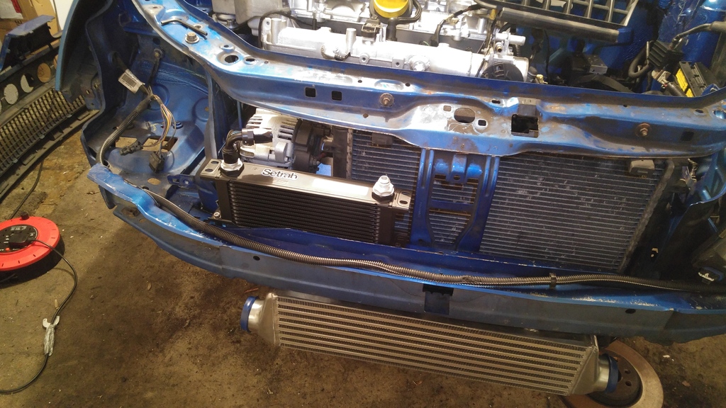

Bought decent oil tonight along with a new radiator. Not uprating the rad just buying a new one as mine is smashed to f**k so that won't help with cooling. The oil cooler will help massively.

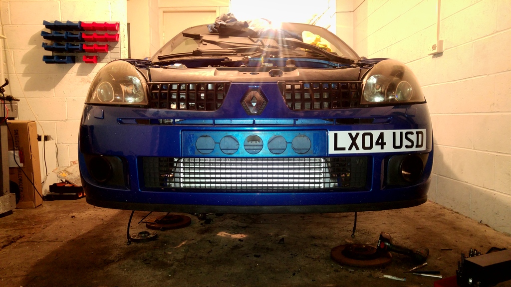

Was going to ask if your keeping the FMIC silver or stealth?
Maybe me, but im not a lover of the side plate. Buts that's me being picky. You'll probably be going too fast round track for me to notice!
I said that about the intercooler as I thought it'd look loads better black and stealthy. He had a good point about it chipping though which i hadn't thought about.
