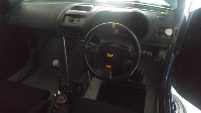

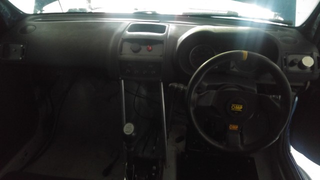

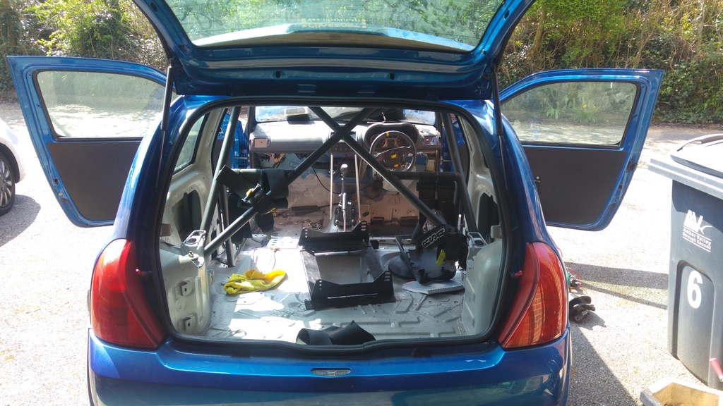

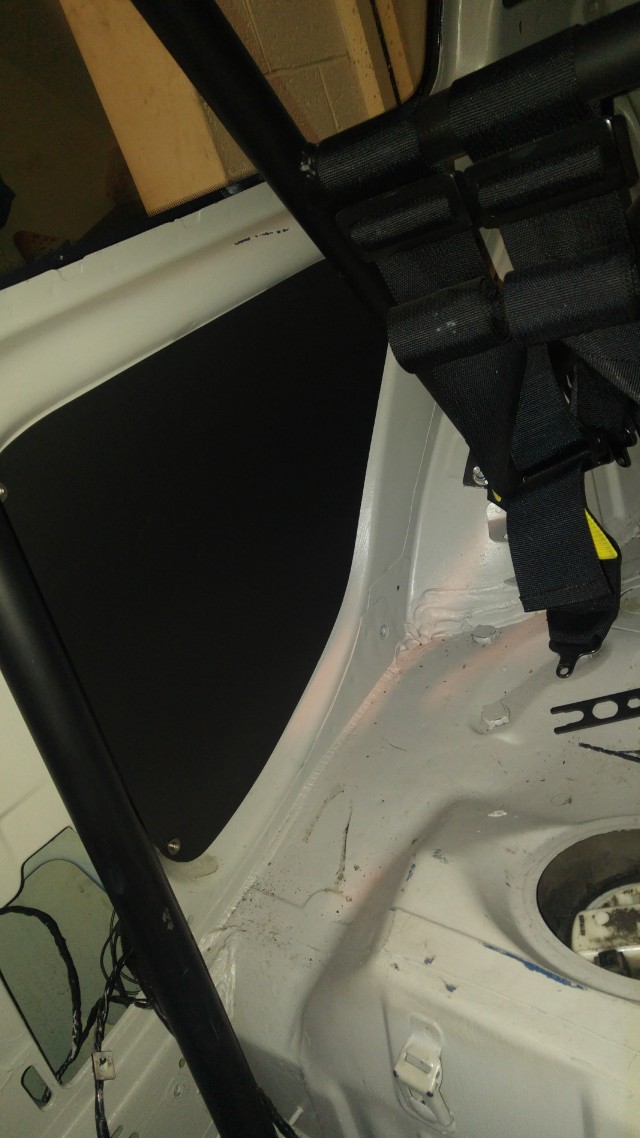

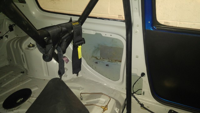

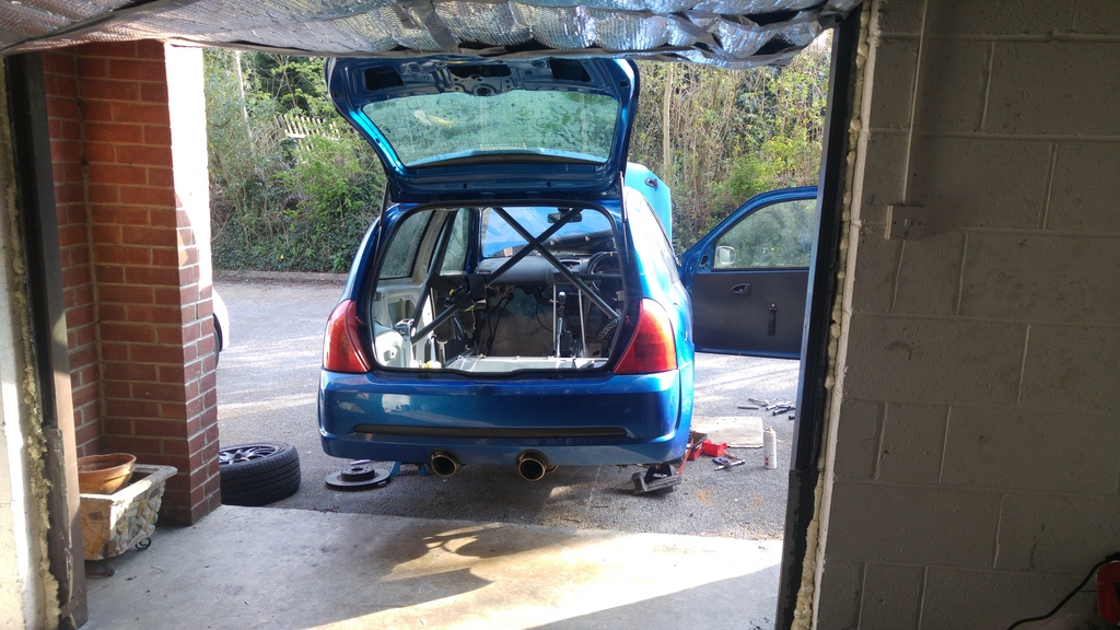

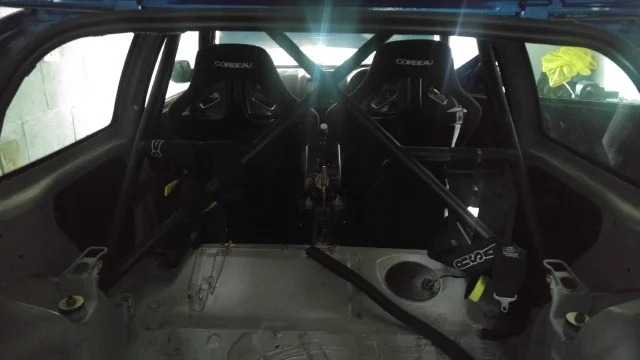

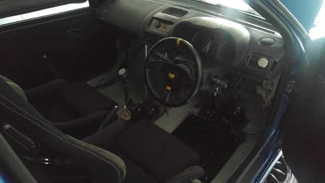

I've fitted the interior, along with the false floor which is a bit bent but it's worked a treat. Fire extinguisher is fixed infront of passenger seat too. I then fitted my rear door cards from CM composite. They were fitted by 3 x M4 rivnuts in each corner. Ideally another one would be spot on but there is no metal behind them, they are very secure though.
No door card
After
Interior pics as it stands!
Black strip is for the scuttle when finished bleeding the brakes

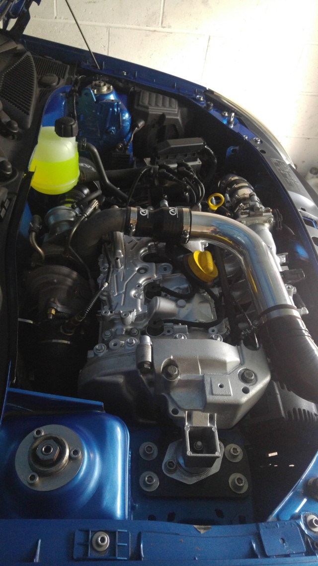

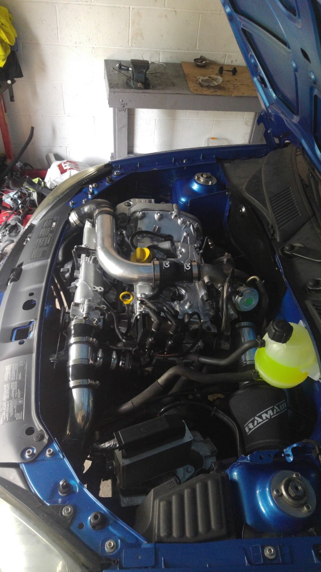

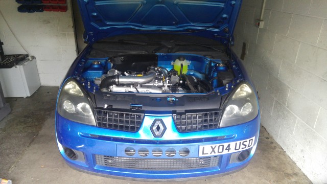

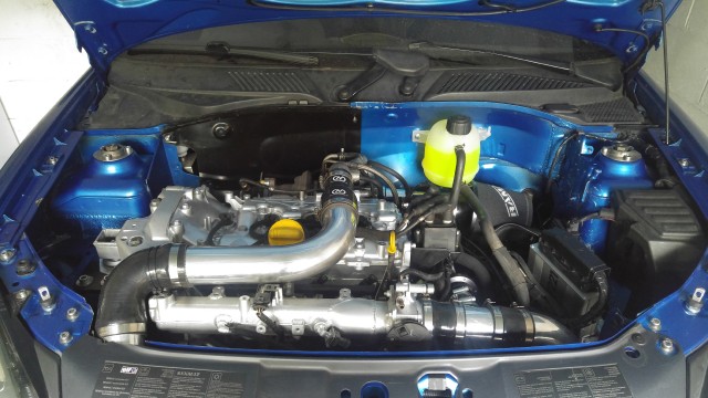

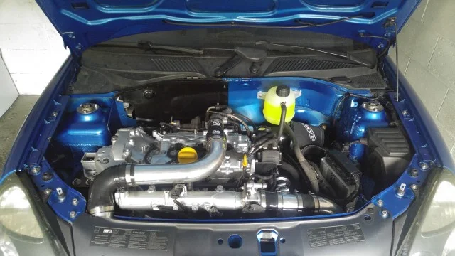

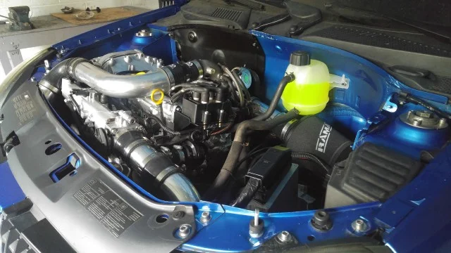

The car now has coolant in and the turbo intake is fitted using a ramair filter. Used ducting from the intercooler pipework and it fitted spot on.

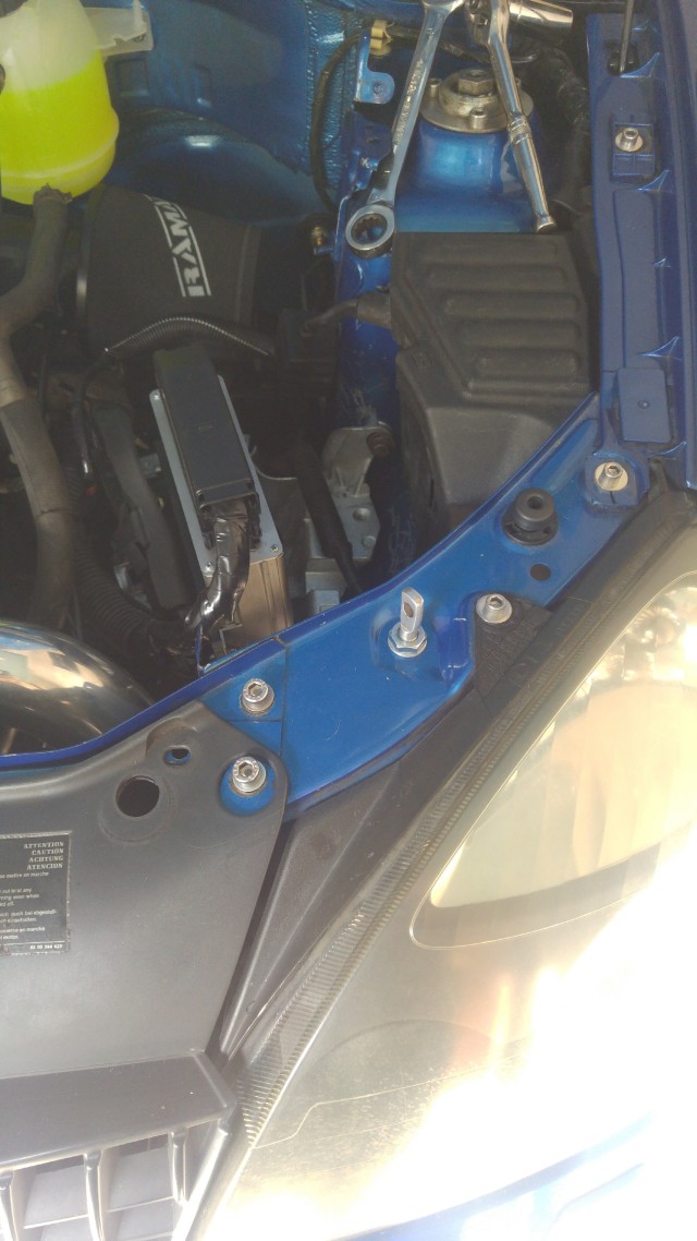

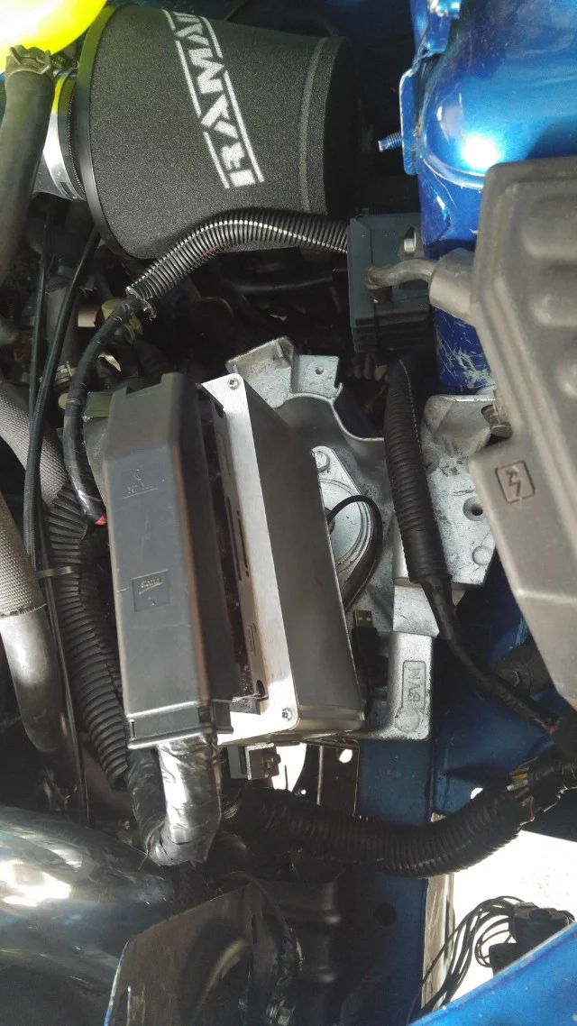

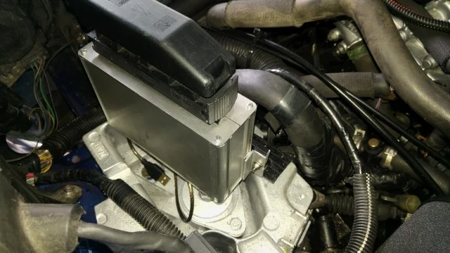

I've also secured the ecu upright using brackets from an oil cooler I bought from
@optical . That has been cushioned with some rubber just to reduce residual vibrations.

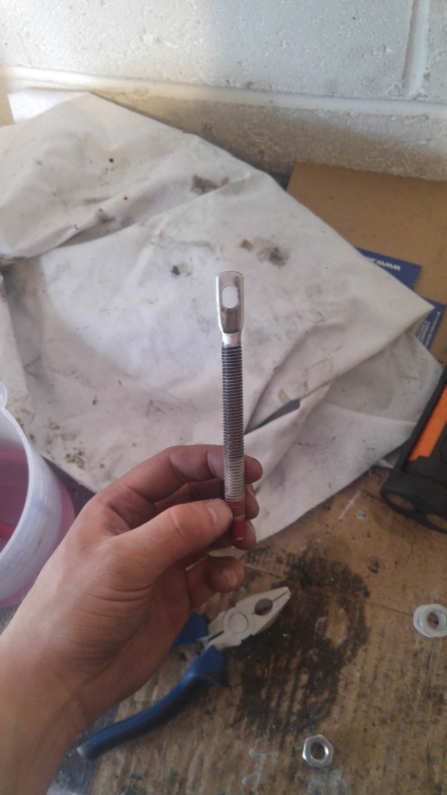

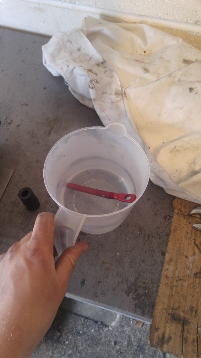

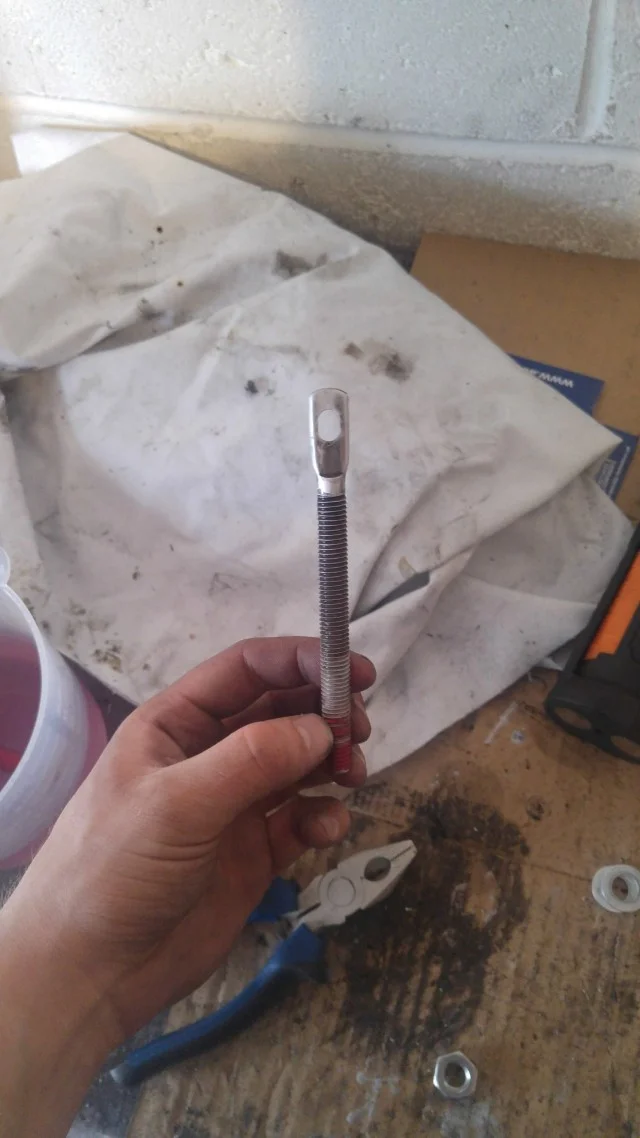

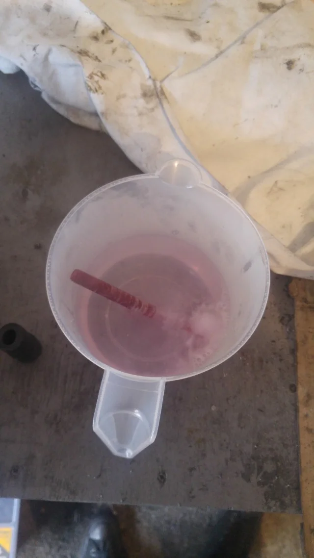

I also got sick of the pink aerocatches (god knows why they come that colour, it's absolutely dire). So with some caustic soda I removed the anodising and then trimmed them down as they were too long. I will do the rears at one point when i've got time.

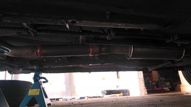

I've sorted the exhaust too, i'm using the megane 225 link pipe from the de-cat and it needs to mate up to my original exhaust and luckily cutting a section from my clio 182 decat allows it to join up perfectly. I got some clamps on there today btw. I will be getting a full 3" system at one point then getting the map tweaked but for now it will be fine.

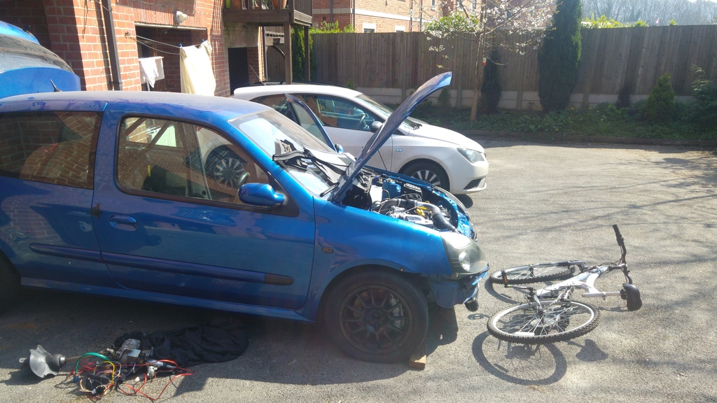

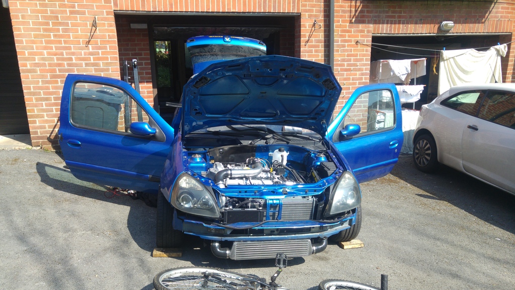

To finish here are lots and lots of engine bay pics as i'm over the moon with it..
