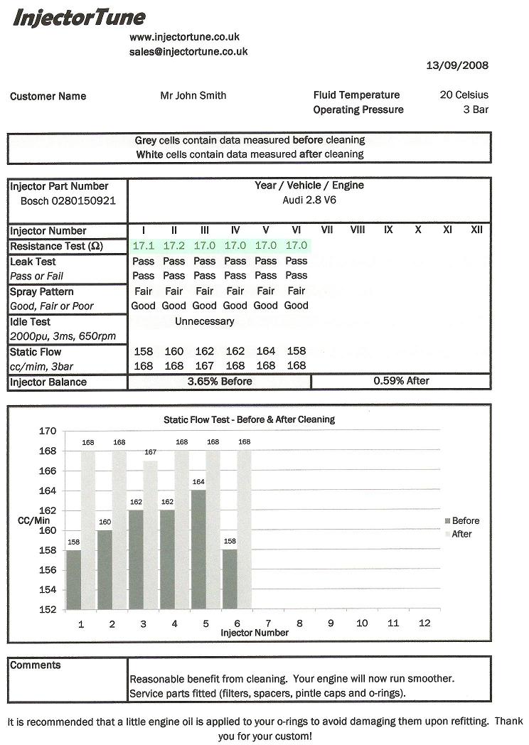

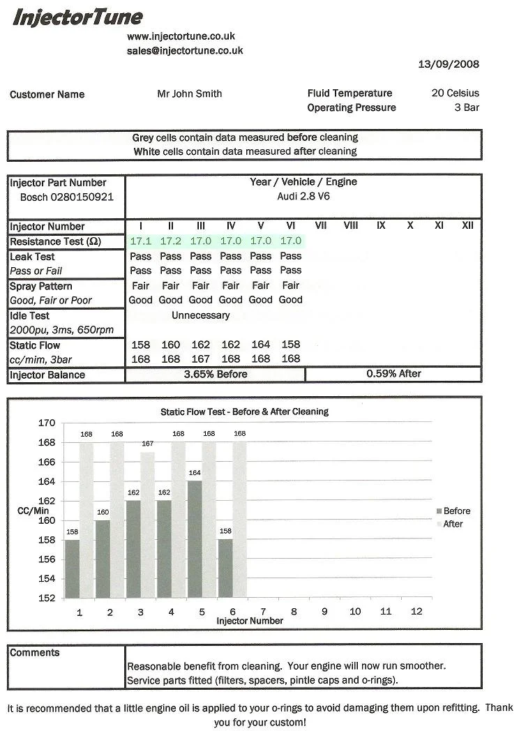

Was just reading this, just food for thought.
