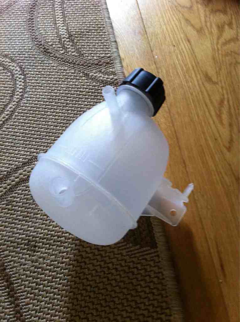

New coolant expansion bottle arrived today.
Renault wanted over £40 for this and I got this for £10 off eBay. Compared it to the original and there is no difference except a couple of markings and I'll get to see that lovely coolant colour through it :)

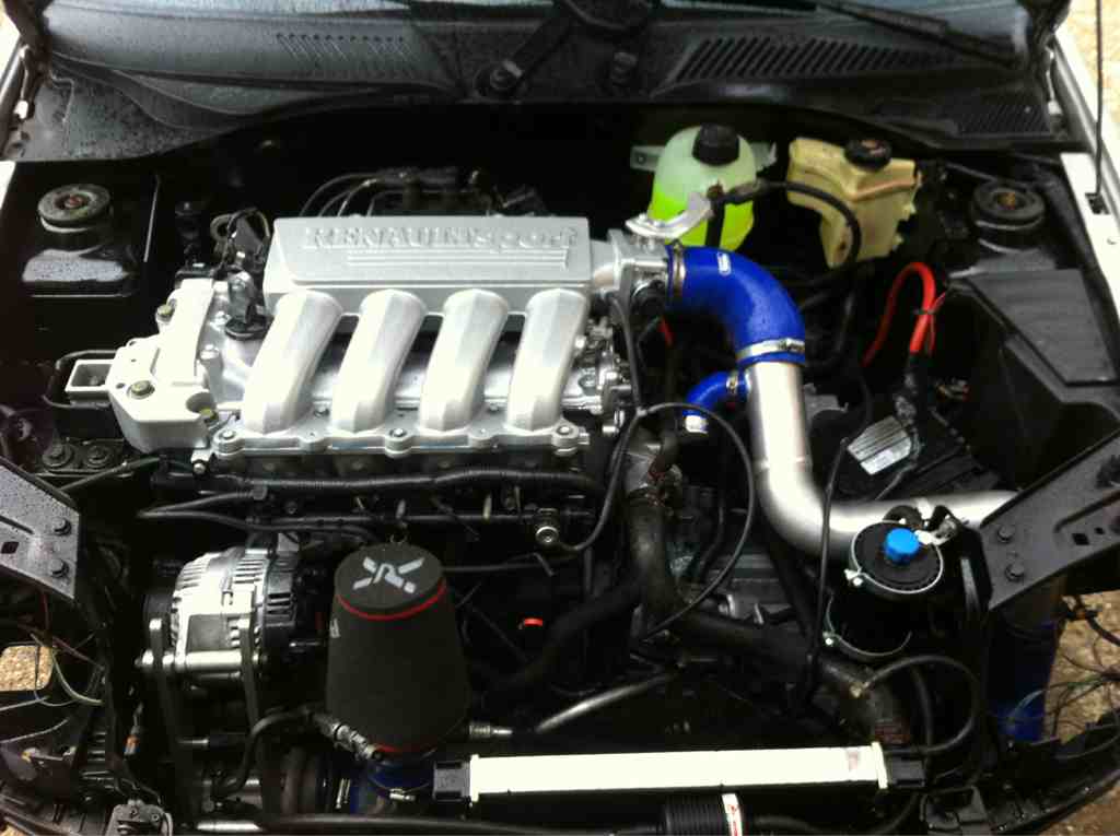

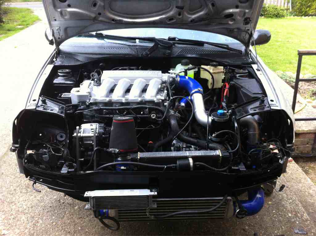

So started at 9 this morning and engine was in by 1230. After getting some manifold bolts on and getting the loom all on we lowered it in fairly simply.

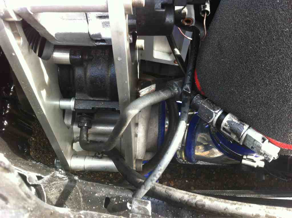

Then started plumbing everything in that was there originally. The PAS extension pipe that came with the kit didn't fit so we modified the standard bits ever so slightly and it all fit fine.
So everything in we then started from the supercharger to the inlet, got the intercooler mounted up and the rest was a couple of jubilee clips.
Put my old supercharged ECU on and turned ignition on, immobiliser light went out so was fairly chuffed, the thing didn't start though :( so tomorrow morning standard injectors are going in and I will be seeing if it starts. If it doesnt I know there is a wiring fault somewhere, if it does then I can't use my old ECU :(

That's strange the pas pipe not fitting
Looks good mate, I could never get mine running till I was at TDF with it :(
  SQ5
Yea the flared end was nothing like the fitting in the adaptor pipe but the standard pipe just needed a little bending and was near perfect!

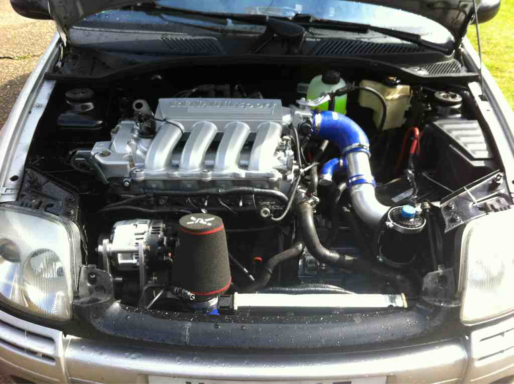

Standard ECU and injectors in and started first time :) speedo didn't work but that was about it!
Unsure yet if the fan is working but it won't really be getting sat and running.
So it's running the charger and standard management at the moment but it pulls well just tickling the throttle. Mates coming over with his wideband kit in a bit so we can see how it's fuelling.
My theory is if running lean then put the Megane injectors in and see how it runs.
My understanding is that the MAP and ATS are basically telling the injectors what amount of fuel it needs? This could be massively wrong but with a large percent of more air going in its going to need a late percent more of fuel? So it may work out similar?

Just found the problem, the one part of the line is missing. This probably got forgotten when I removed it from the car, whoops
  SQ5
Shh Lewis ;) that EC1 is a bit of a **** :p
Yea it's standard Airbox and standard injectors, just struggles to pull as hard!
That would be the bit thats missing! Got it to fit anyway so not too bad, just the PAS switch in a funny place!
