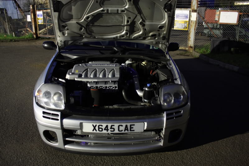

I sourced it from the guy that bought it off bomber.
Well I've had a new restrictor made for it which is 33mm, 1mm bigger than your first (last was 35mm) and it runs 7 PSI which is about 0.5/5 bar, it seems every extra mm runs and extra 0.1 bar.

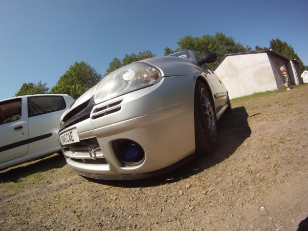

  Clio 172

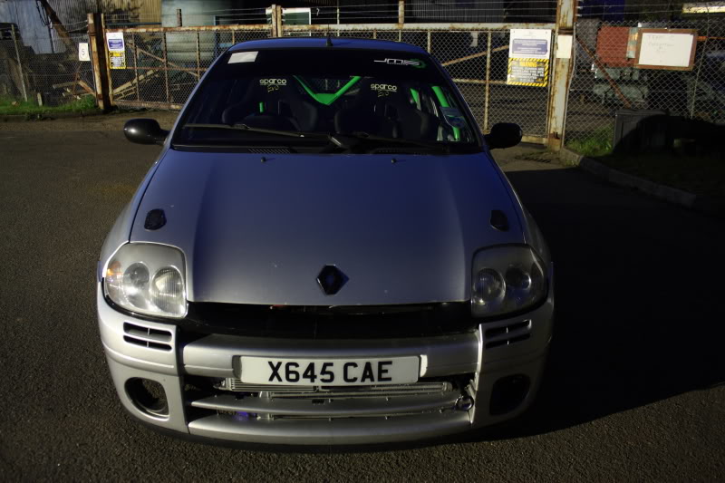

Looking very mean and moody. Do the rear bumper holes make alot of diffference? I appreciate the concept of less drag but is it more psychological or does it actually work?
  182, SQ7, Trafic
I have no idea as the wheel well is right behind there anyway, I "thought" it felt more stable but like you say very psychological.

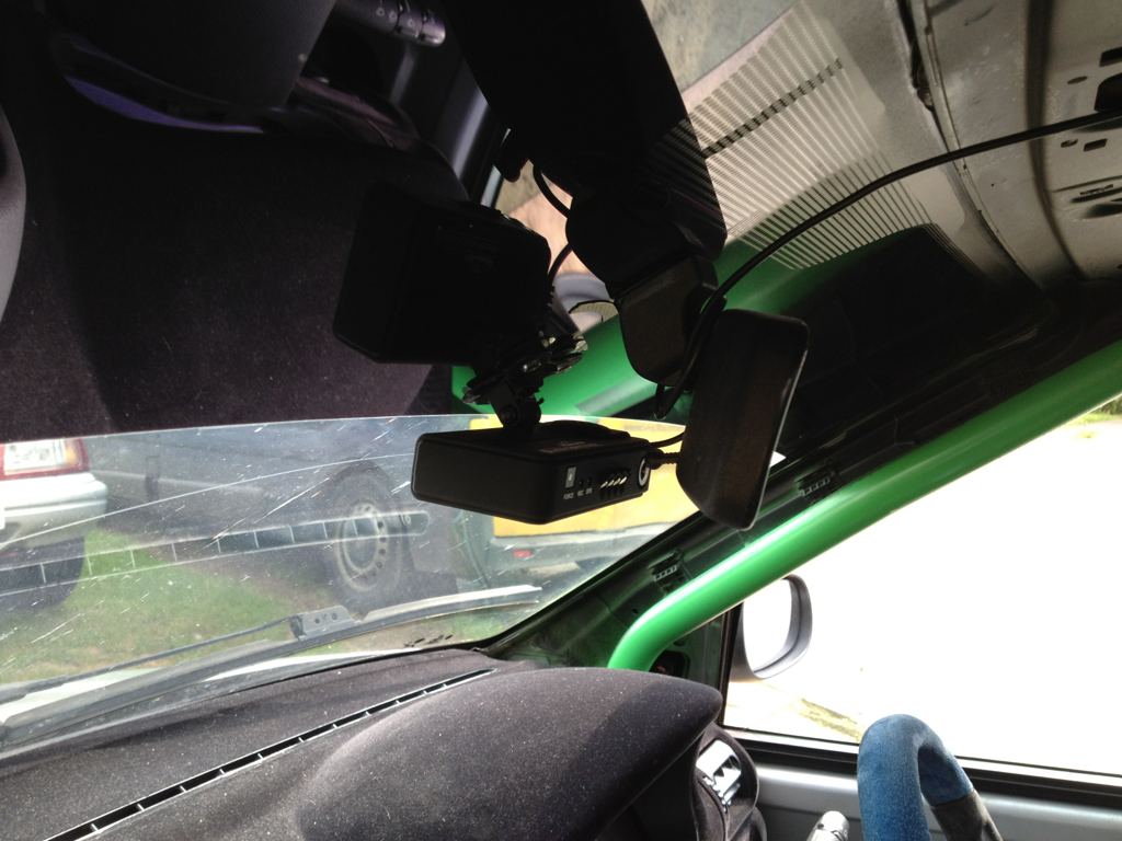

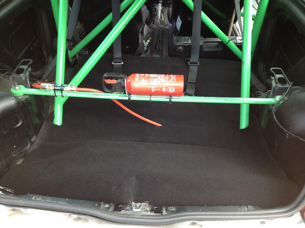

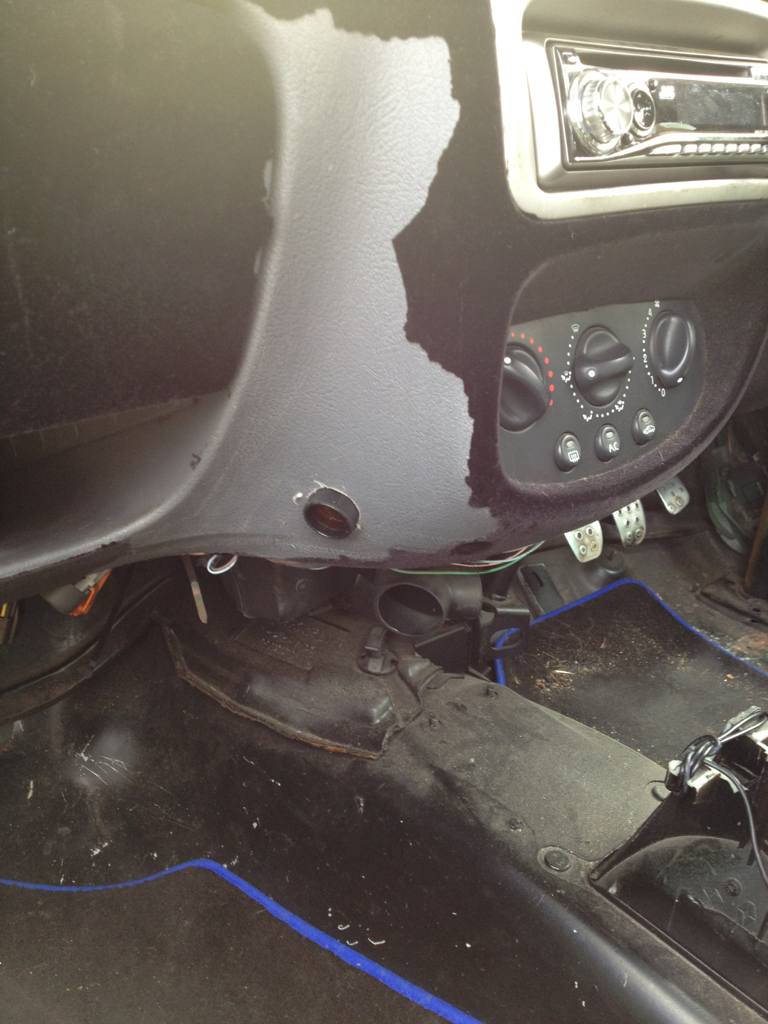

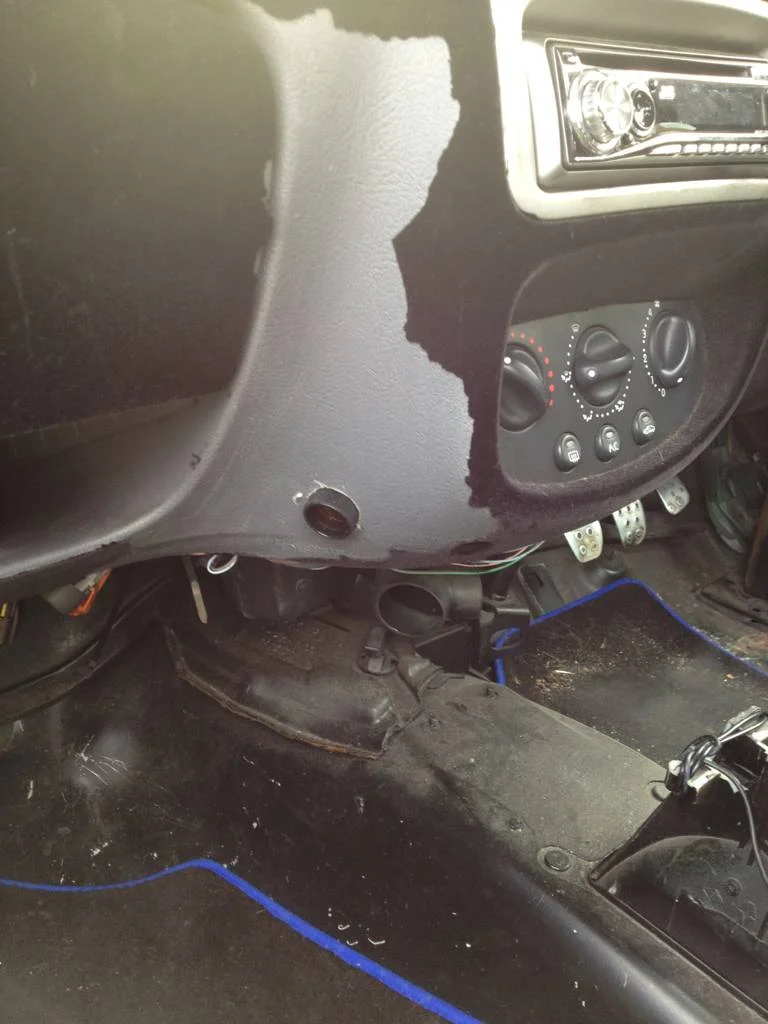

Also today I fitted a camera we had a work for ages, is a two way camera with GPS and G sensor. I fitted it an tested and quality is loads better than I thought
Also fitted a 12v socket as the camera needs this but mainly for charging phones on the way to Germany.
Excuse the flocking, whoever done it clearly didn't know how to properly! It's all getting sorted when I get back with a ph2 dash!
I also need to sort out a boot carpet and a mate had some old stuff from something and it fitted almost perfectly so got that roughly in, unsure if it deadens any sound yet!

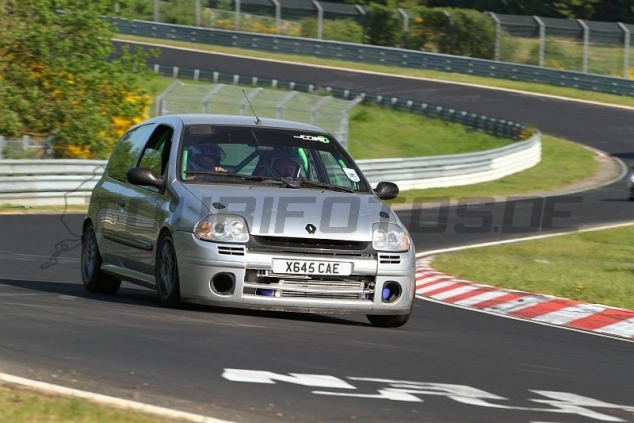

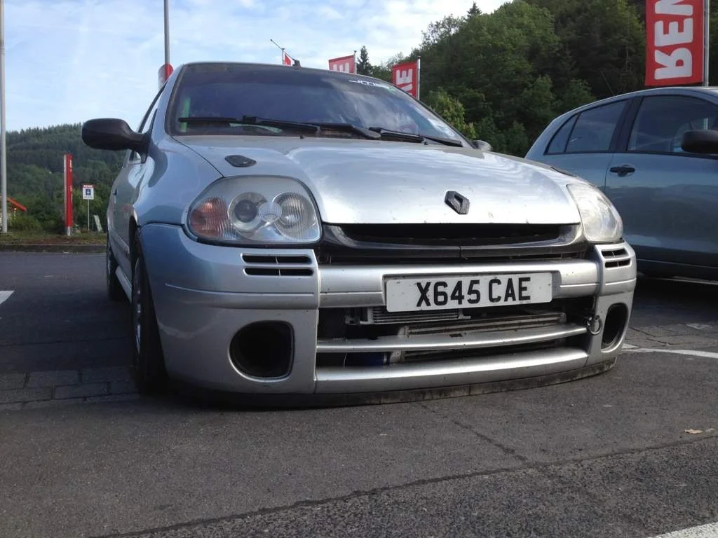

Well as everyone else is doing a post Ring update I suppose I'd best do it too!
I definitely think I was the most nervous doing this as the car had only done a thousand miles before having to do another thousand around the worlds most dangerous track and also across the water on the continent. In the end I ended up having the most reliable and one of the most economical!
I did have to change my pads on the way but I knew these were low and only bought 6 hours before leaving home so I did these on one of our stops, 20 minutes and both sides were done!
Having arrived at the Nurburgring and setting up we went up the to a viewing point we found, this was one of the fastest dangerous corners on the track which got me having second thoughts! I was having second thoughts! After having a sleep after near 24 hours of being awake I was seeing clearer and bought a lap knowing I'd use it.
I ended up doing two very steady laps not worrying about times or anything, out broke myself once and was happy I'd been around.
Knowing that I got home with no problems I would of definitely gone around more times, but doing the trip on a small budget meant I had to think about getting it home!
I had some fun and even more fun on the roads around and just taking it all in, atmosphere of the place is great, and not just in one place the whole area is just buzzing, genuinely missing the place and I will definitely be back later this year!

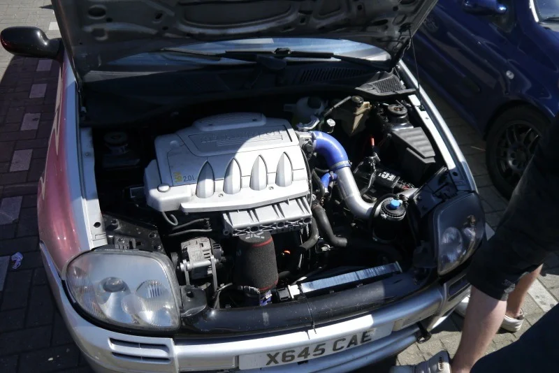

Hi Dave, thanks for the comments.
I'm using completely standard internals from the F4R, nothing internally has been changed, except running a Megane keywayed crank sprocket.
Using a C30-94 Rotrex Supercharger
Car weighs about 1050kg I imagine.
Never had any problems with 25mm spacers on any car.
ECU needs to be mapped, but I'm running a TDF EC1 ECU.
Not a clue on how much power it makes, it goes well and I'm not chasing figures. At a guess 260bhp

Well I don't think they'd see past 280. The thing with the supercharger is that the engine is using say 40bhp just to turn it. So your pistons will see an extra 40bhp in theory that the crank won't of that makes sense? So really mine runs 300 odd at the pistons but only 260 at the flywheel.
I haven't lowered the compression ratio, it's not needed running minimal boost ~6psi.
The crank as standard is keywayed but the pulley isn't, it was common for a standard 172 that had been supercharged to slip the belt. I've done it twice before. And or the sake of £40 it's worth fitting.
The car is fully mapped as the ECU came with the conversion I bought, it's mapped for higher boost but it works very well with a little bit less!
