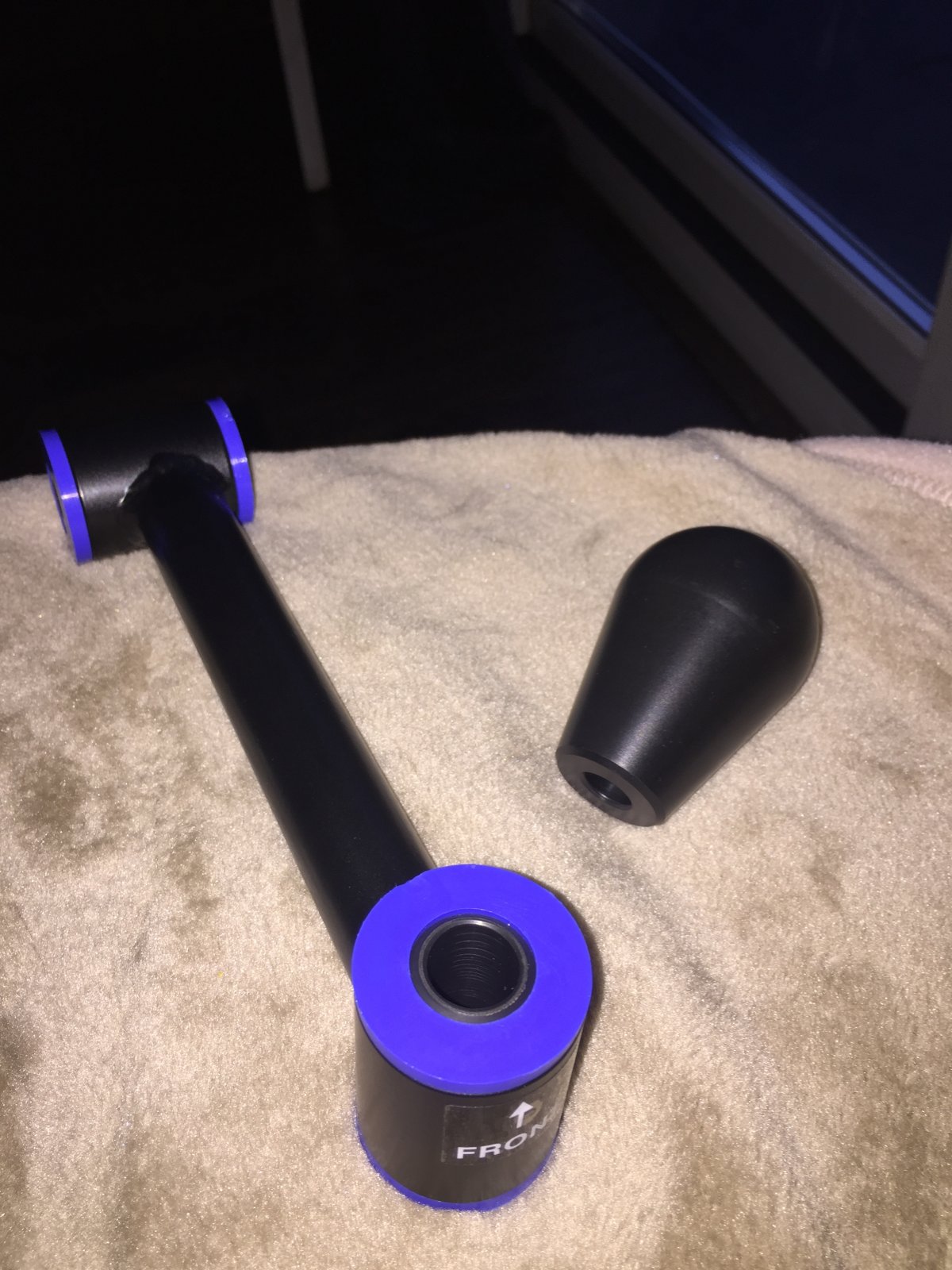

Good stuff.Hahah, exactly that mate. Probably going to get Rentech to fit the shifter and have a look over the earths in the new year. The cup spoiler is booked in to be resprayed end of Jan too.

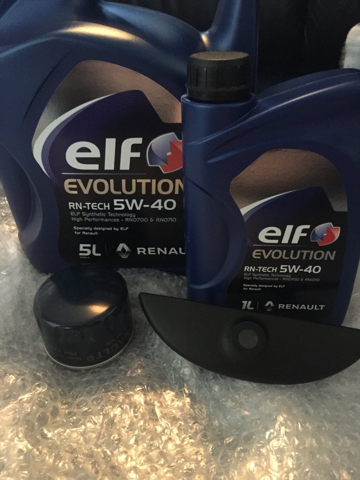

Ive only ever been able to remove 1 in tactOil and filter time on Sunday if i'm not too hungover. Also bought the rear wiper surround as mine is faded and past saving. Not looking forward to fitting it, apparently removing the rear wiper is extremely difficult!
Don't go replacing the oil with the coolant if you're still hungoverOil and filter time on Sunday if i'm not too hungover. Also bought the rear wiper surround as mine is faded and past saving. Not looking forward to fitting it, apparently removing the rear wiper is extremely difficult!
When I had the front wipers off my car I bought a '4" reversible gear puller' from screwfix for about a tenner, did the trick without causing any damage, guess it'd be the same on the rear, bitta wd40 first will always help tooOil and filter time on Sunday if i'm not too hungover. Also bought the rear wiper surround as mine is faded and past saving. Not looking forward to fitting it, apparently removing the rear wiper is extremely difficult!
Get a tool from Halfords, think its £11, well worth getting! Forgot what its called though [emoji849]
Good dose of wd40 over a couple of days then pull and a slight up and down movement its how i tend to do it always works on frontsAnd you know what youre doing haha! Any tips?
http://www.halfords.com/workshop-tools/tools/hand-tools/laser-ball-joint-separator-cup - Worked a charm!
Also, I tried the 17mm and 13mm spanner trick, didn't work [emoji20]
Exactly mate [emoji16]Looks good mate, thanks. So, put the spanner end bit around the wiper bit (against window) and twist the screw until it seperates?

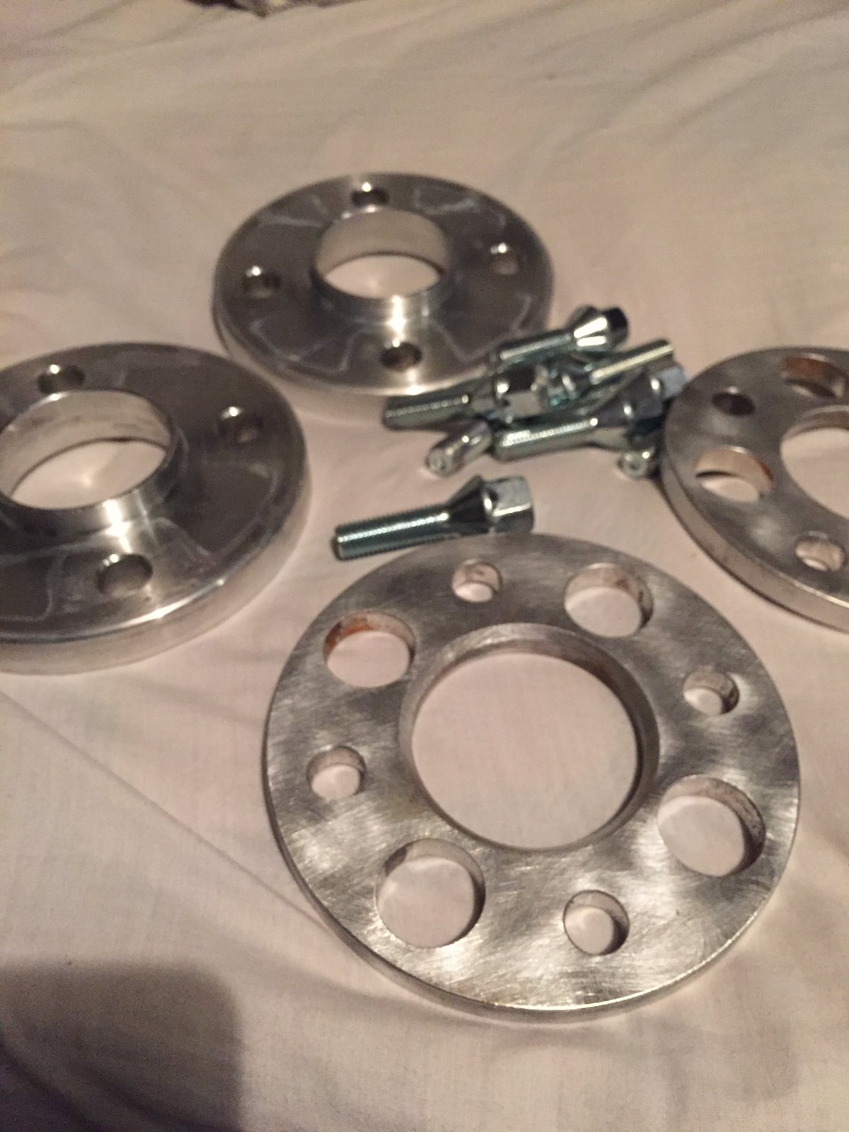

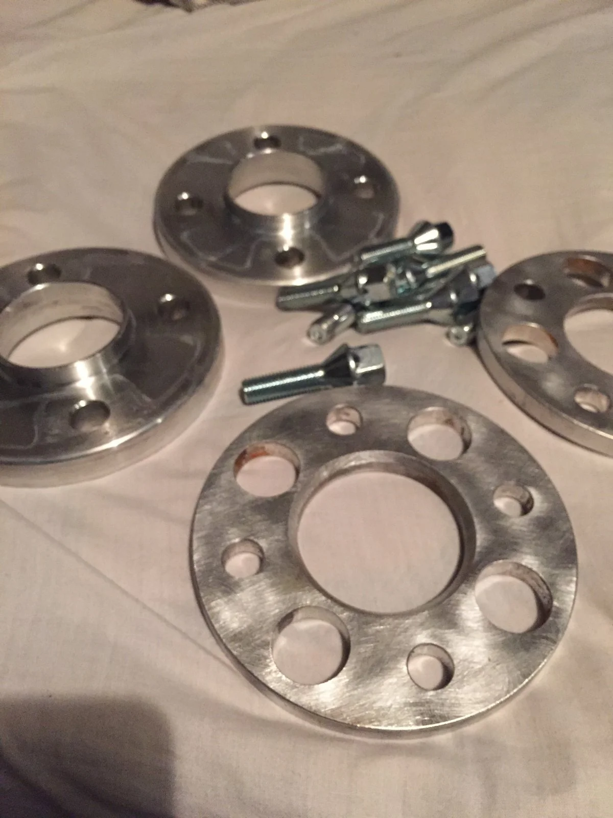

Where did you get the extended wheel bolts mate ?
A little tip mate, when you do the rear spacers. Wire brush and wd40 the nuts as they can be an absolute b*****d to remove which usually ends up in rounded Torx fastener heads. Which is never good!
No worries fella. Also three bolts are the same size and one is smaller.
Yeh great advice there plenty of gt85 and undo from the bolts dont try to screw the torx bolts as they are like chesse
Use the torq side to hold the bolt use the rear bolt side to turn the nut. Hope that makes sense lolConfused now. Am I being simple..
Any quick how to fit guide?
use 50/50 atf and acetone as penetrating fluid.
Just get on with it loluwotm8??
Just looked back lol sorry read fail. Most rear spacers go behind the stub axle. Yours dont same as the fronts mate!The fronts, just a case of..?
- wheel off
- clean surface of hub
- spacer over hub
- put wheel on through spacer, job jobbed?
Rears different?
