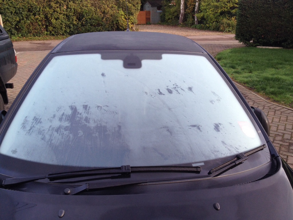

The G1 experienced, What is wrong here?
Poor prep?
Poor application?
Poor removal?
Water beads off nicely but I notice these weird marks and are very obvious when condensation is there, It was my first time using it and I seem to have done something slightly wrong :(

I went over it with Crystal as I thought that may be the case but I now have a bottle of Eraser so should I give it a wipe over with that?

Really need panel wipe/IPA to remove the rest....maybe some Vodka! ;)

Also looks like some of that condensation is inside?
I can't say condensation is too bad on this car, Definitely better than my Clio was... Did give the inside a very quick wipe over with Crystal yesterday so may be a little smeary.
  Not a 320d
If you had 3M or AF Glass cleaner you could use that as both are IPA based. Always give my G1 a wipe over after application for this reason.

Just gave it a wipe over with Eraser so will see if that makes a difference, If not may have to strip it back and reapply and immediately after application give it an IPA wipe over rather than weeks after initial application.
