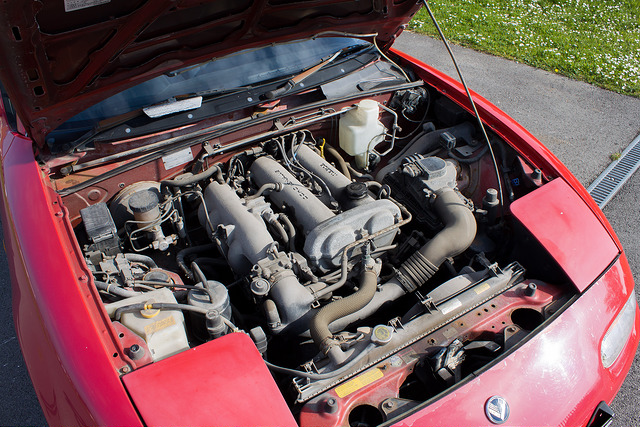

Right chaps engine bays....how on earth do I tackle this:
IMG_3758 by theycallmepaul, on Flickr
I have never had to do an engine bay that is so dusty before (it's 10x worse in person), I'm assuming degreaser on the block and G101 on the tubes etc maybe? rinse off with the pressure washer on the 'rain' setting.
As stated I have never attempted this before so I will gladly take on any advice and if the idea above is just plain stupid please tell me so.

Paul.M I still don't like the idea of any hose or washer on the engine bay. Use some old MF that can go in the bin afterwards, soak them in warm G101 and start wiping it down once rung out.

Spray the whole engine bay with degreaser/ G101 or whatever your choice is. Pressure wash it all off.
Just don't aim the water at the spark plugs, ecu etc.
You'll be fine.

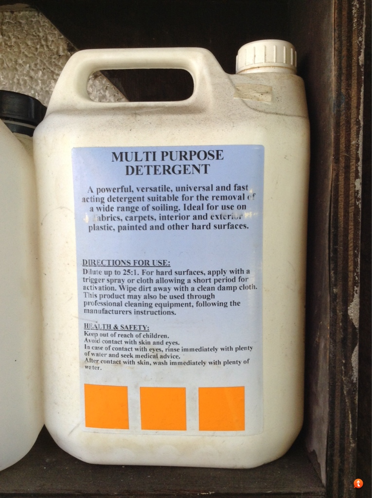

Dan did you have an amazing gunk/grease remover? I could have sworn you mentioned it before. I'm finding g101 weak again proper greasy stuff, white grease etc. Like a gunk remover.
Daniel
  Whichever has fuel
Yes mate, it's superb!
It's by Trafalgar and called multi purpose detergent.
I use power max TFR mostly (Autoglym) but for white grease, and cv grease, I use the Trafalgar stuff. It dilutes really well too.
Gally
I need to try some. G101 even neat wasn't touching some of the grease I see!
Do you still use a brush to agitate? Available online?

Thanks for the help as usual guys, that's my job when I get some spare time this weekend.
I'm quite enjoying being able to give it all a proper deep clean, it's turning around quite nicely so far.

You can agitate it to speed things up, but I usually soak the area, go ahead and wash all the wheels, arches etc, then just pressure wash it off 30 minutes after applying it.
This is the stuff.

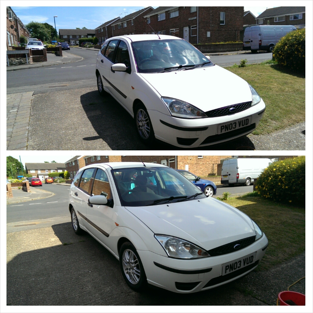

Did my first white car on Sunday with the Da, brother turned up with his new runabout...a £250 focus with the dullest paint I've seen and it looked like a cheap respray job (overspray everywhere). Before and after doesn't do it justice but he was shocked how it came up.
