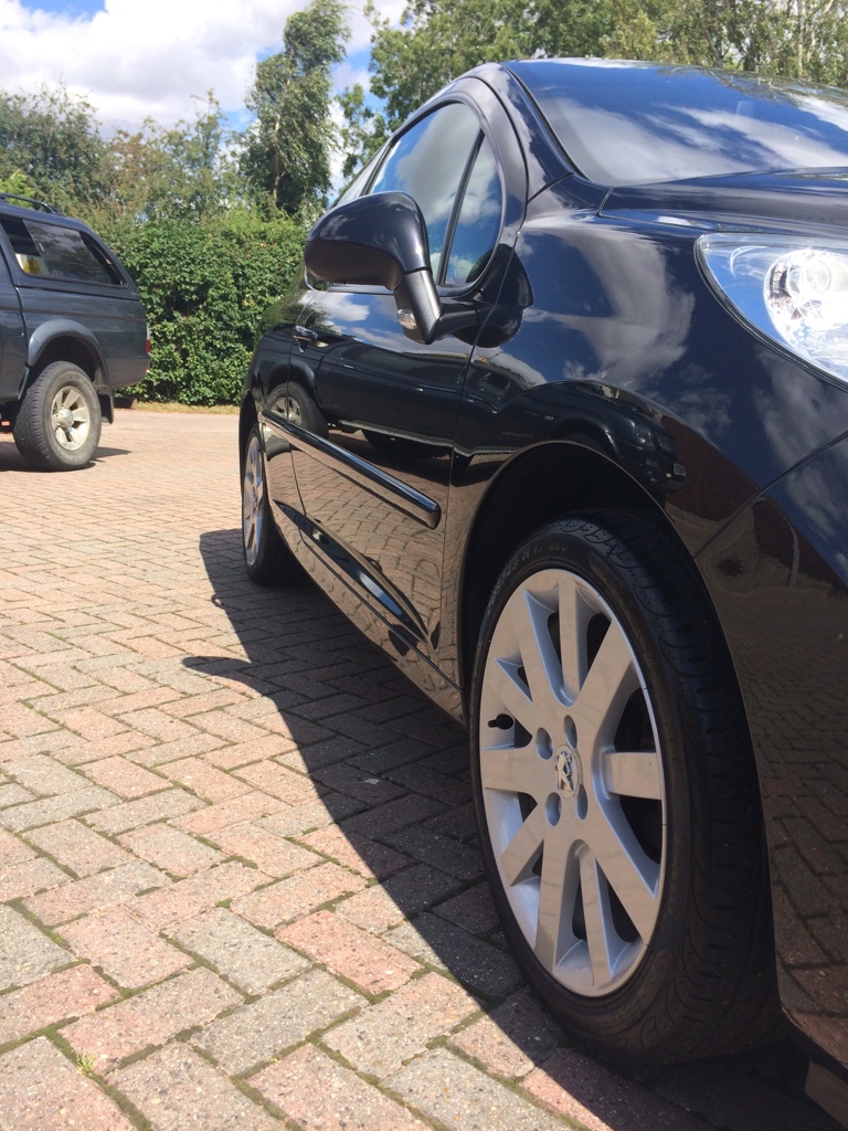

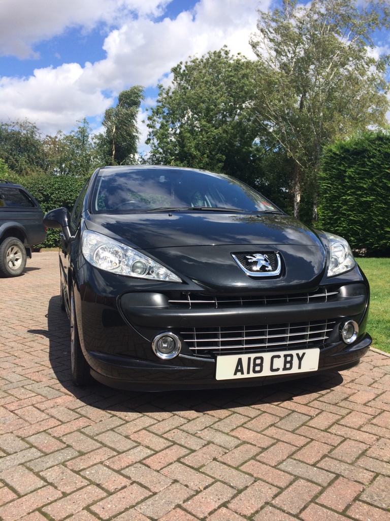

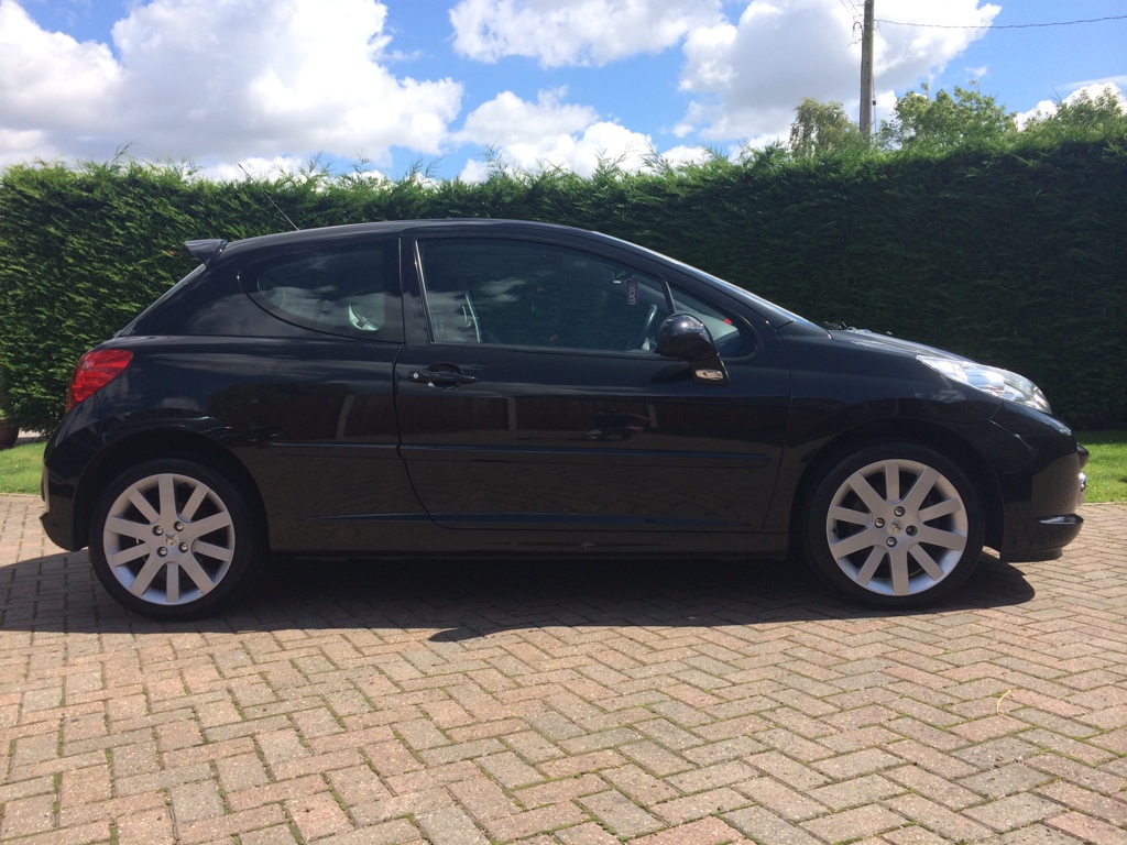

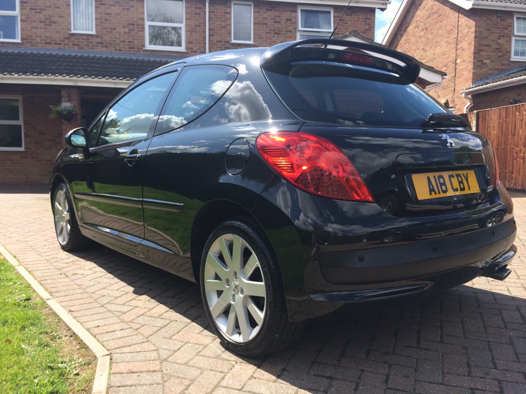

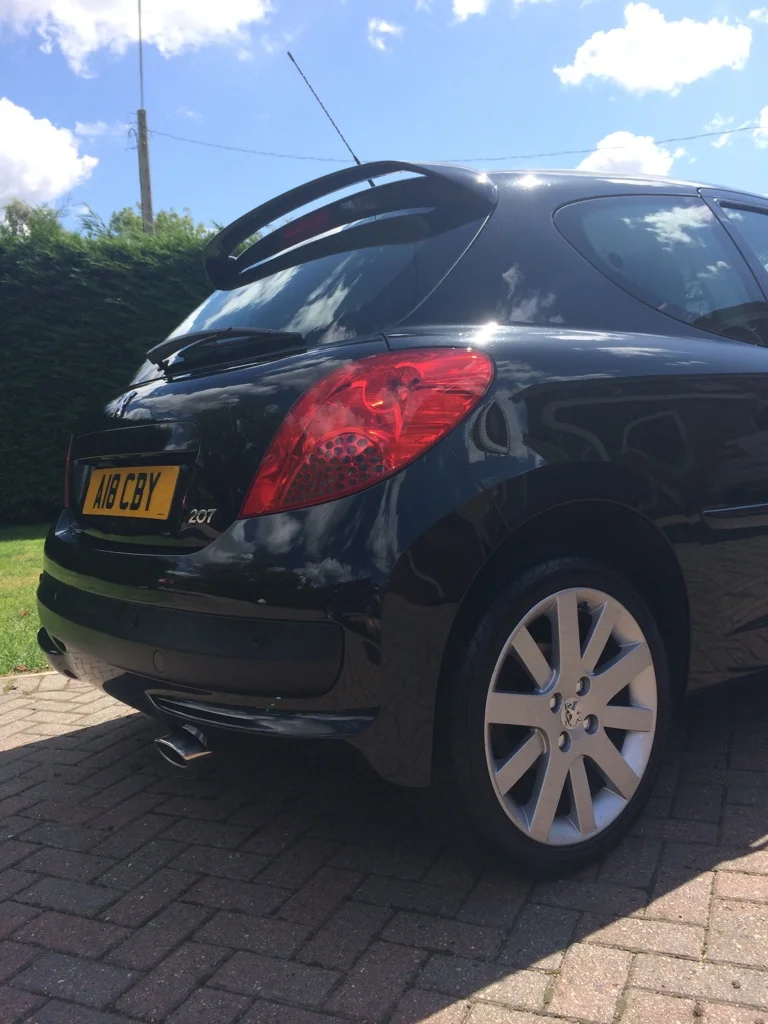

Persevered with the UG, Thinking maybe using Rejuvenate first may have already masked some of the swirls? as I wasn't getting much to show from 50/50's :(
Anyway.
Paintwork - AF Lather, Autosmart Tardis, AF Iron Out, Farcela Clay Mitt, AF Rejuvenate, AF Ultra Glaze, DJ Purple Haze Pro, AF Finale.
Wheels + Tyres - Megs Endurance and AF Tough Coat.
Glass - AF Crystal
Plastics - AF Revive
Quick iPhone pics so a bit s**t sorry.
