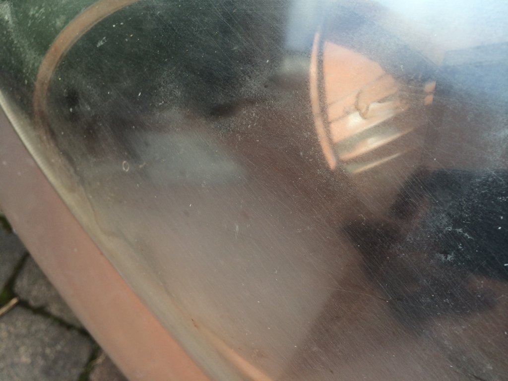

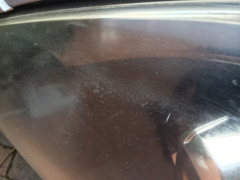

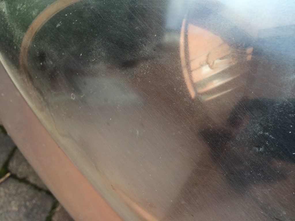

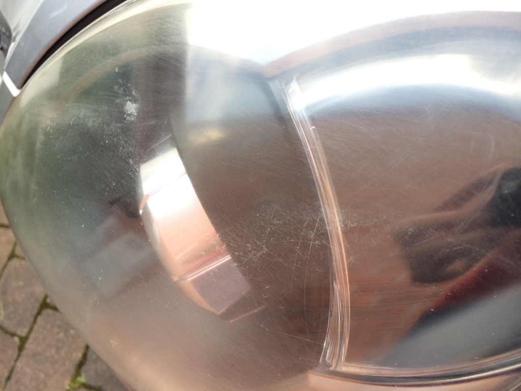

Tried doing my headlight with 1200 it still doesn't look right. I used Megs Plast X to sort it out after. Any tips
You haven't worked hard enough!
That's a poor effort mate. You need to keep sanding until the finish is uniform over the entire light. The bits that are on your light now are bits that you haven't sanded properly.
Basically, you've done a s**t job.
Coby.
  XC60-R.......V40-R
As Dan said you needed to spend more time on the sanding and making sure all the haziness and spiders webs are gone, I'd be working up the grades a bit aswell, It'll make the polishing stages easier.
  Golf GT & A4 Avant
You certainly don't need 1200 grit for those headlights. Use a milder sand paper and put more effort in

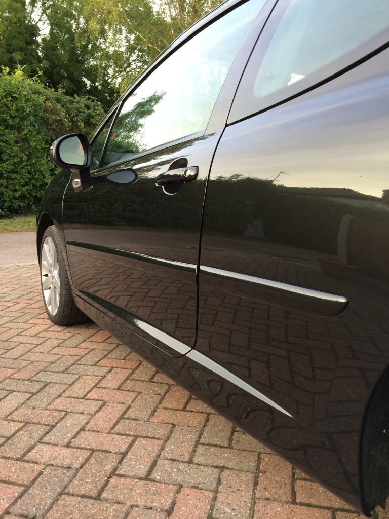

Called it a night at about halfway around, Put a layer of DJ Purple Haze Pro over the areas I'd Glazed just in case the weather turns overnight.
Doesn't seem to be filling many light swirls but nevermind, I'll actually get round to correcting it fully one day.
Progress pic -
