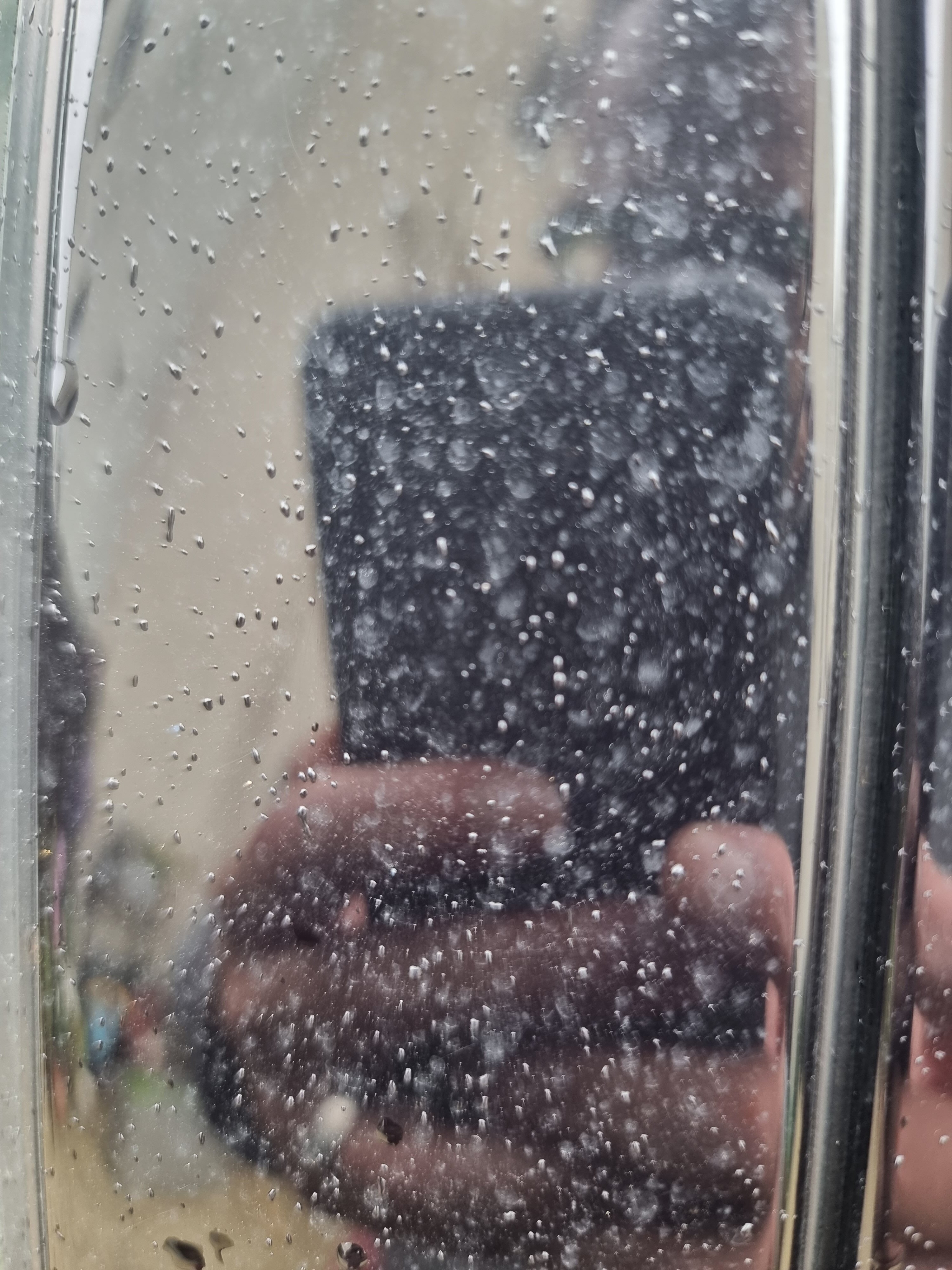

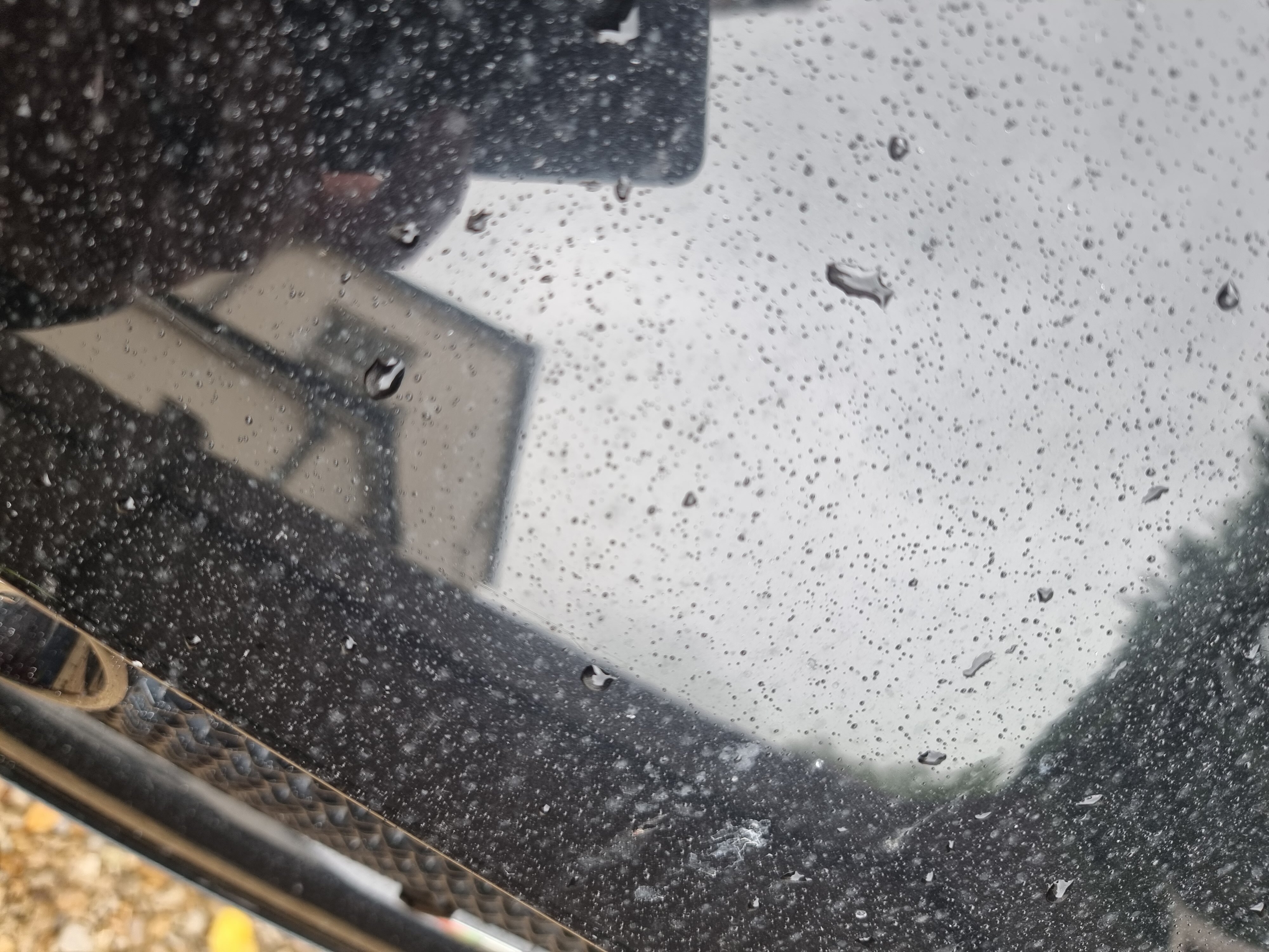

I think I need to get a hardness meter.
I still seem to be getting waterspots?
To be honest , I don't think i let it flow enough after I used the hose for washing the wheels without the DI maybe?

With this di vessel, I'm nearly there!!
My hose is pretty long so there is residual water left before I change over to the di vessel.
I also turned the tap down ,maybe if it's too powerful from the tap it hasn't got enough time through the vessel?
Whilst the car has suds should I just rinse those off with Di water? Or should I use normal water and then rinse that off with DI water? Just thinking about water pressure...

No I haven't got one of the bucket things, was just saying they look alright 😅
When I tested my DI vessel I had the tap fully open and it was reading 0ppm. Would probably be better running it a bit slower though if you have good water pressure where you are.
I'm not sure how they work exactly, I 'believe' the water goes in and down through that tube to the bottom and the water filters up through the resin and out the outlet. So it the water should be getting enough contact time... Anyone know how they work?
Edit: It's the opposite of what I said 😂
It goes down through the resin and up the tube.

I guess it depends how warm/sunny it is outside. If its mega hot (not ideal washing weather anyway) then I would go straight in with the pure water. If its cloudy, or more suitable washing weather (yes, im that sad) then I would blast with my PW first and then go in with pure water. Its just because my hose pressure isnt the highest and so it struggles to get suds out of the nooks :) HTH

Don't use 115 if you're at 300ppm mate.
200 and over use 151.
The ready filled kits will likely have been 115, plus the fact you got it 2nd hand will be why it went so quickly.

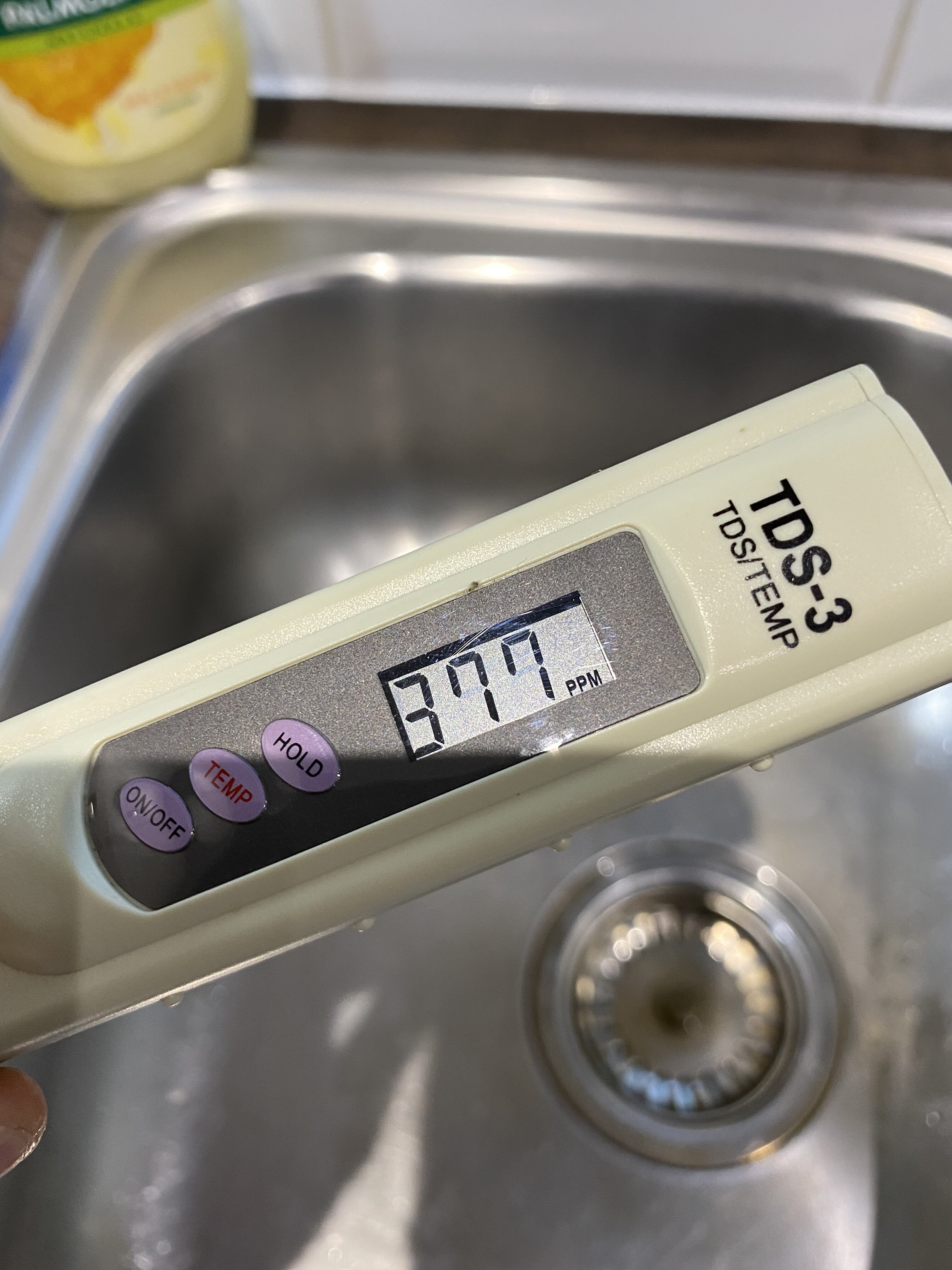

Been a while since I measured my water. Thought I was over egging it after I commented.
Only just remembered to test it today and, yeh…. 😂
Switched up the store layout and gone for a theme that fits with the product labels more... What do you think?
Fawk 😅
Double what mine is 😳
Aye it’s mad.
I’d love a water softener in the house as the chrome taps, sink, showers etc look s**t and water spotted unless they’re constantly being wiped.
I’ll have to look for the 151resin for my vessel after all.

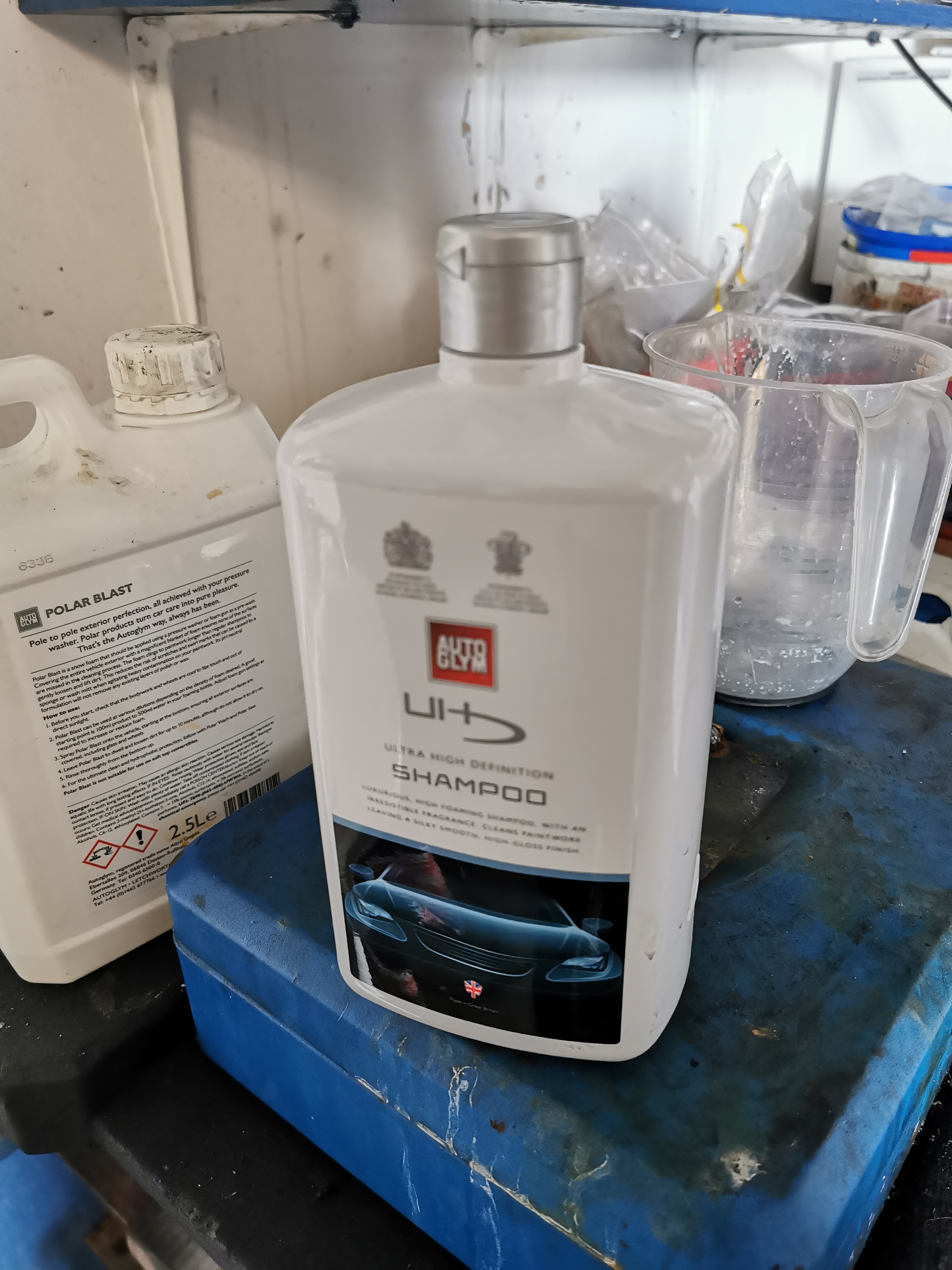

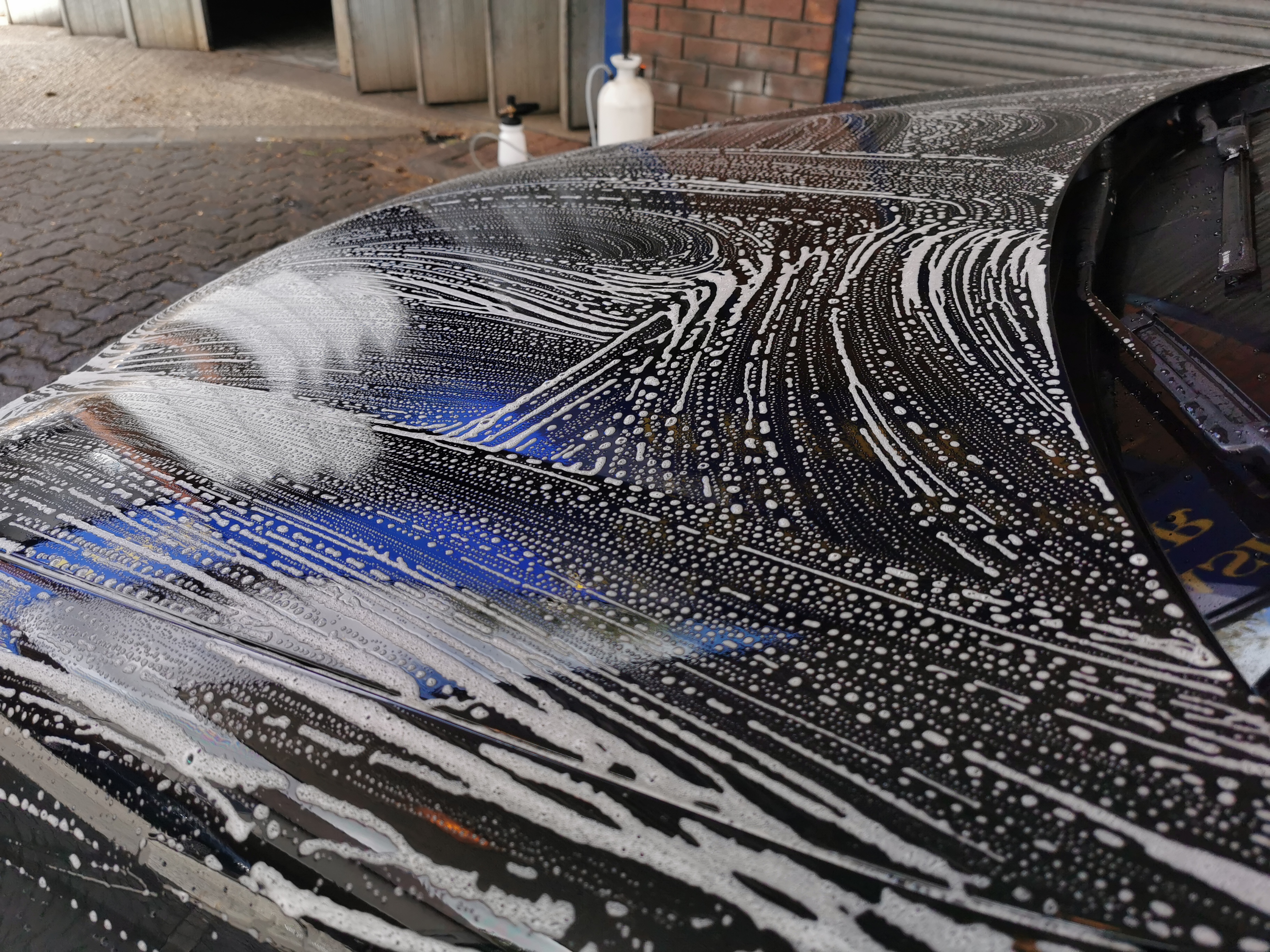

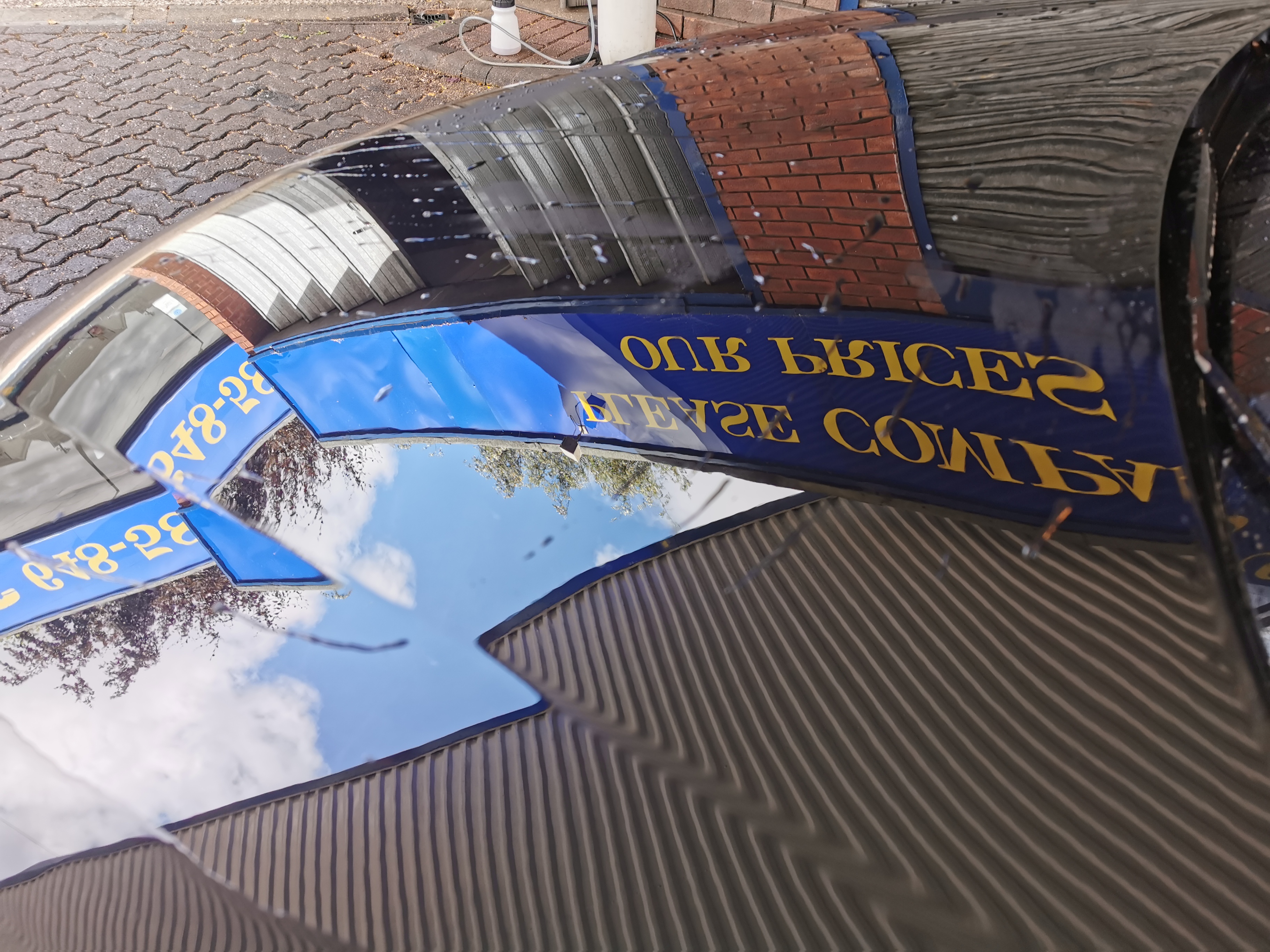

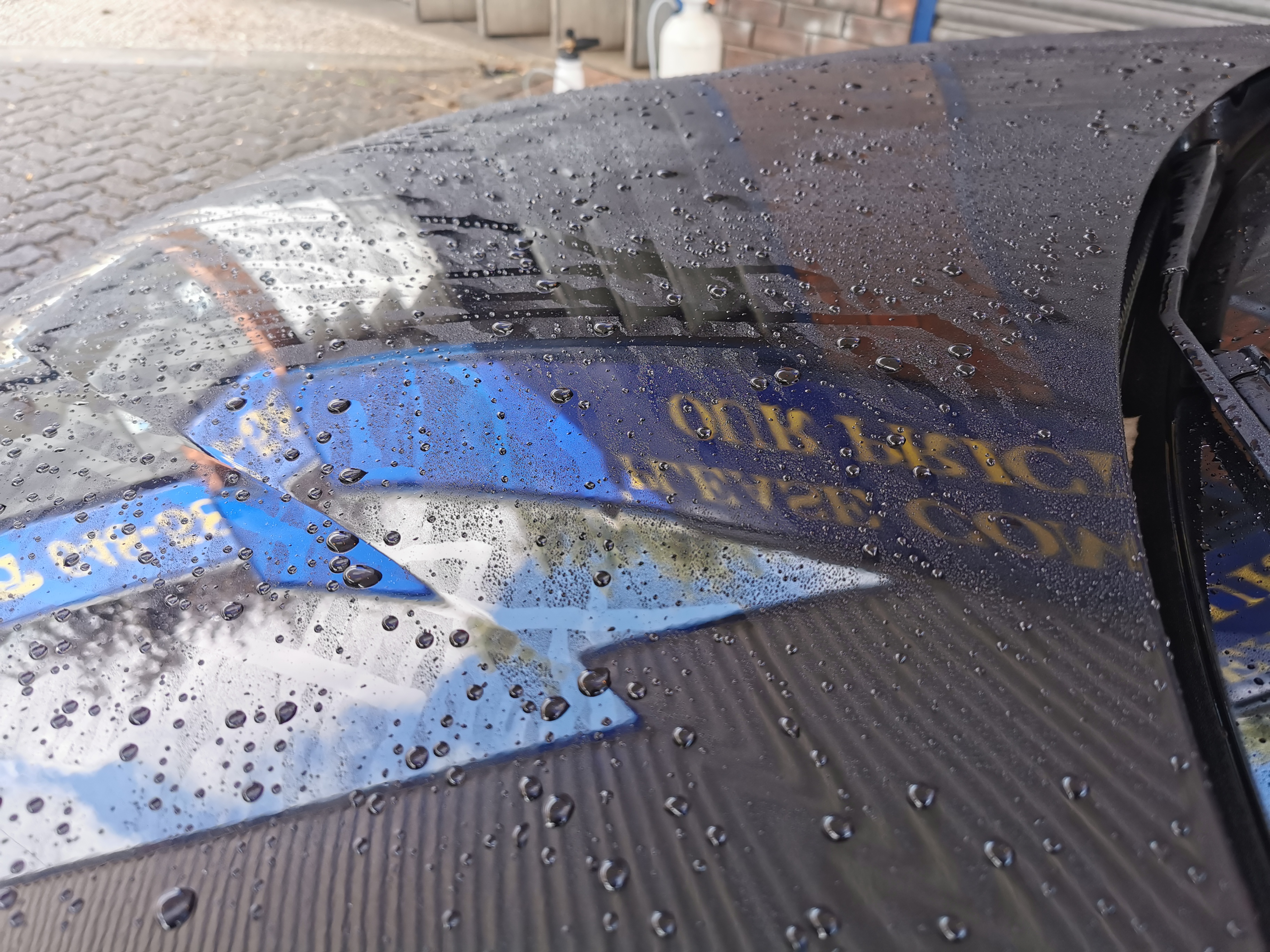

Wanted to remove the recent autoglym hd wax, 3 weeks old.
Two goes with garage therapy decon and the later and better megs wash plus.
Garage
That was twice. 80ml and 400ml warm water.
Really nice shampoo.
Then wash plus. I wouldnt buy gt again tbh.
Beading had gone and the paint looked nice.
