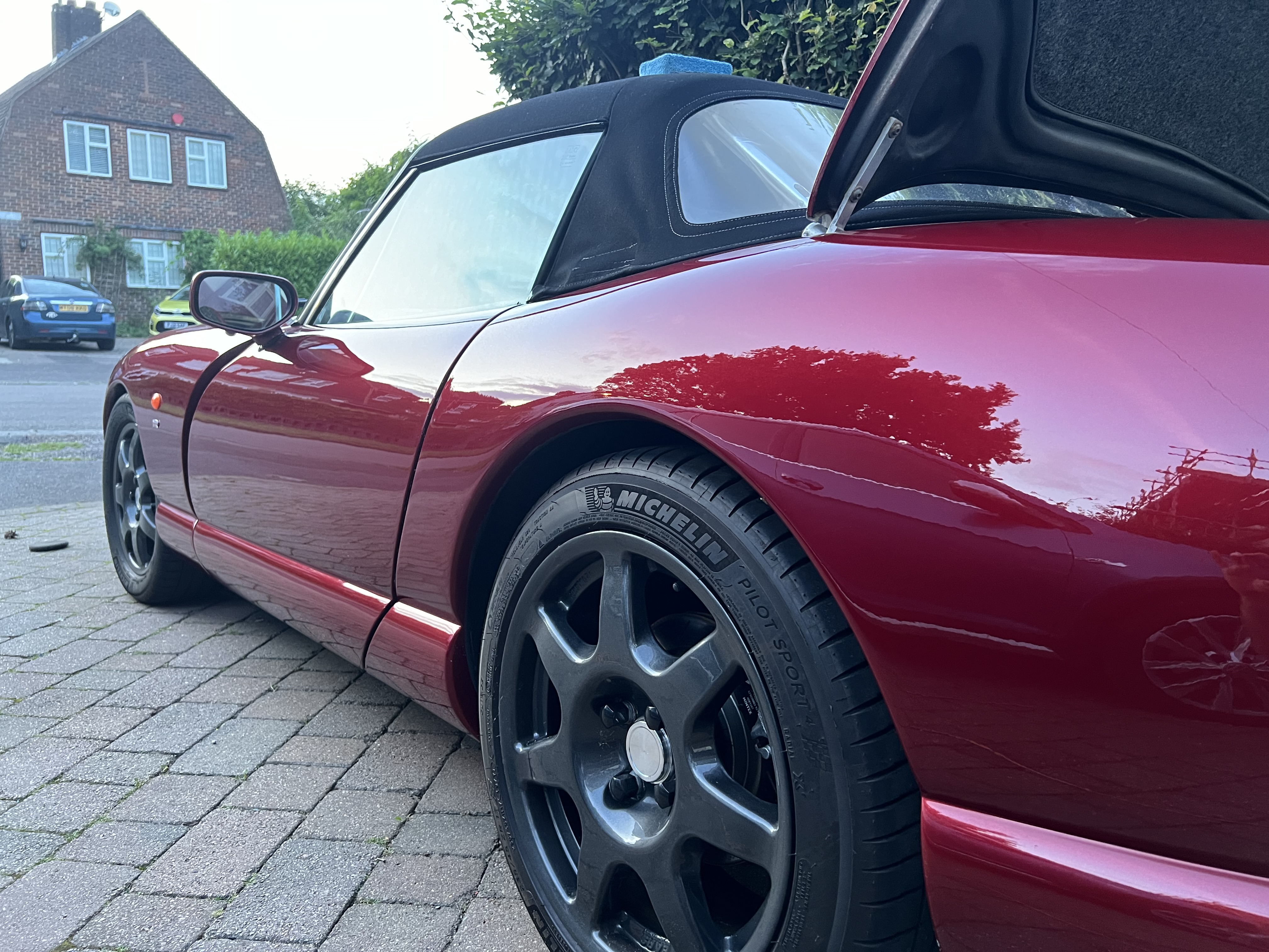

If it turns out anything like this I will be more than happy.
Just done this incl paint. Key point - prep. If the paint doesn’t stick it’ll just come out so make sure you rub down with 2,000 grit, then panel wipe, then paint. Also makes it easier to see the scratch and how much you’ve filled/how level it is.Will report back lol
