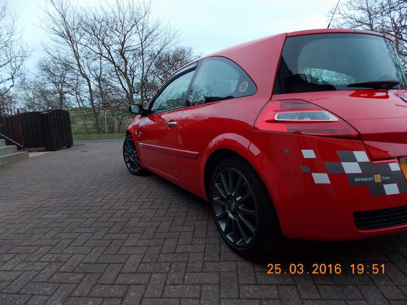

£350?! That's a bargain mate! Shame you've not actually uploaded any pictures of the car..

F1 Stickers
Cup Wheels
Cup Wing Mirrors
Cup Springs (which we found today)
All i need to do is add the recaro seats and sort front discs , pads & brembos out and do the brembos red and it will be a cheeky wee fake

Won't have came with the stickers from the factory.

My brother had a bog standard UR 197 and it was spec'd from RUK with stickers all round apart from the roof and it had recaro seats.
I've heard of RUK doing that before yeah.
What I mean is it wouldn't have came as a selected option as a newly bought car by joe bloggs.

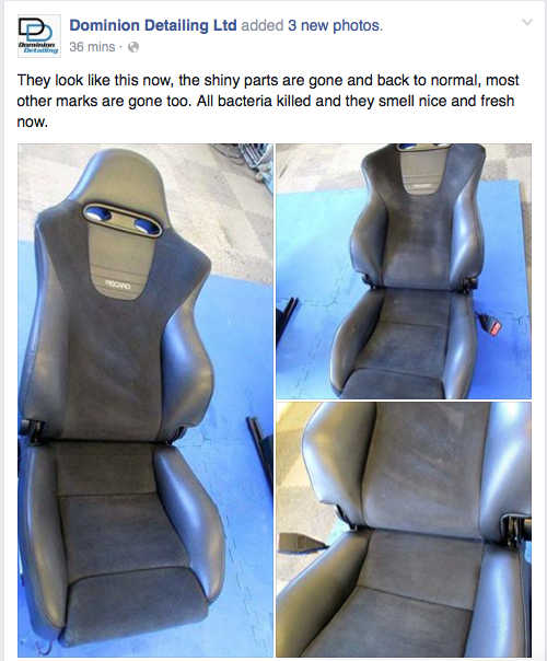

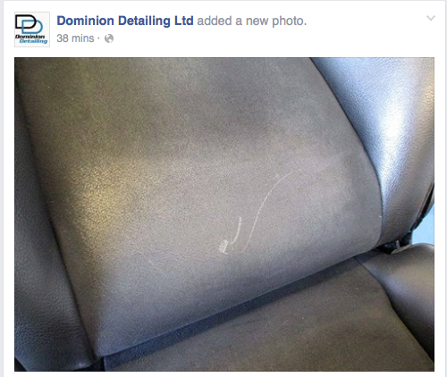

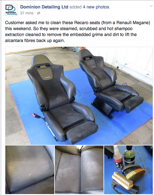

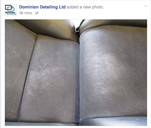

Small Update on the seats.
Sent them away to a local detailer who has produced some stunning work so asked if he could try and clean up my seats.
I will now have to find someone local who can do my seats. They look spot on.

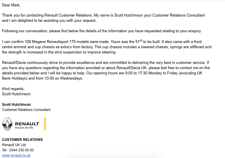

Also found out that my 175 dCi came from factory with both "Cup Packs" along with a few other extras and RenaultUk claim that there was only 108 Cups made and mine was the 51st to be built so went and got these made up.

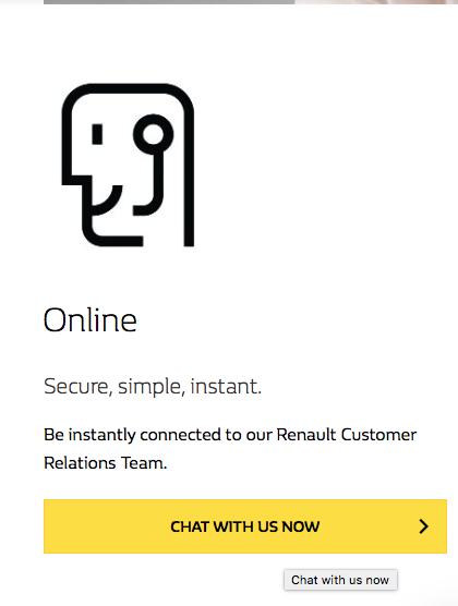

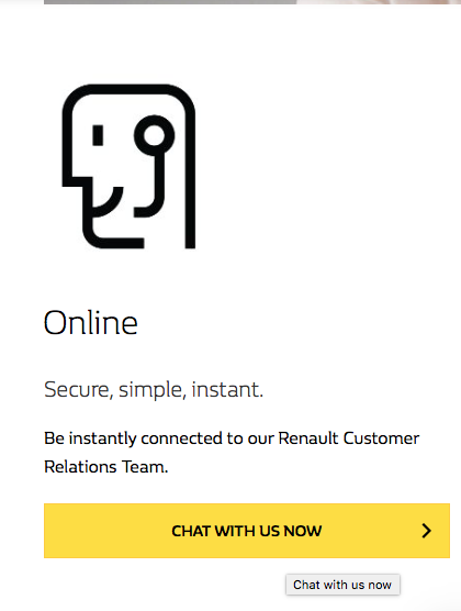

That takes ages.
Go to there site (www.renault.co.uk) and then "contact us" and you can online chat with them.
Its much quicker and easier than waiting on e-mails and also staying on hold for an hour when on the phone.
They will ask you why you want this information and what the information is being used for.
Just out of interest what did you say to them regarding what the information was used for etc?
Well as its a 175 dCi there is very very little press about them and not much info.
I explained that i had just bought one and was looking for information it along with what recalls it has had.
I went on to say that i could not find any manuals or booklets on the 175dCi and that i wanted to know what extras mine came with from factory.
