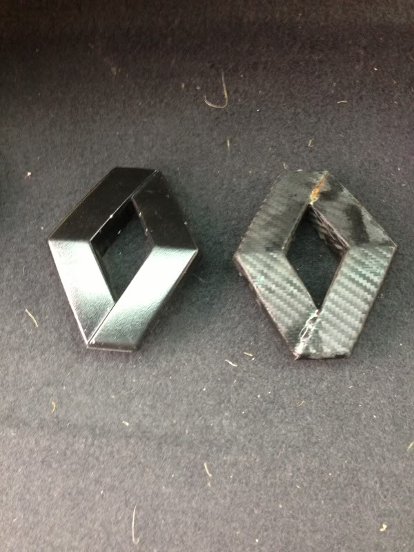

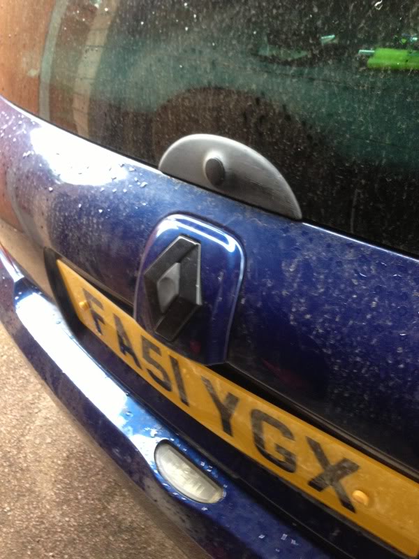

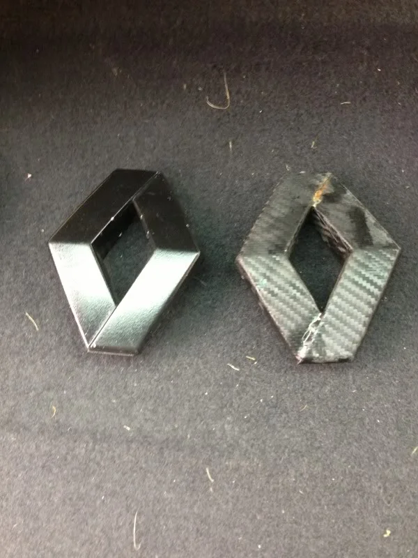

Replacement badge from nick172cup, shouldve of resprayed it but i cant be bothered ha.
Carbon wrapped one is the old one.

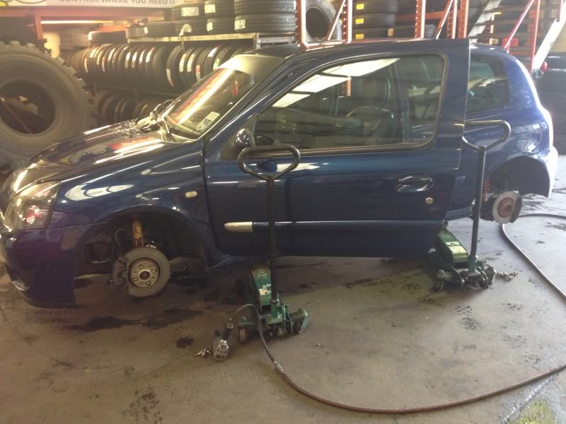

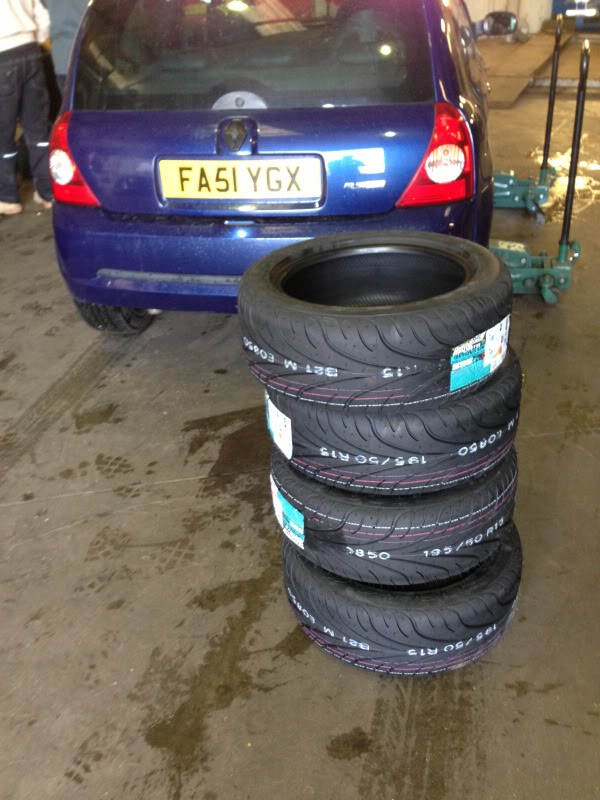

Then my federal 595 rs-r's turned up, total cost one fitted was under £270 so not bad :)
Floating car.
Old hankook v12's which ill be selling once i find my tread depth gauge.
White line is now on the softer setting also, need to raise the rear 5mm also due to slight scrubbing.

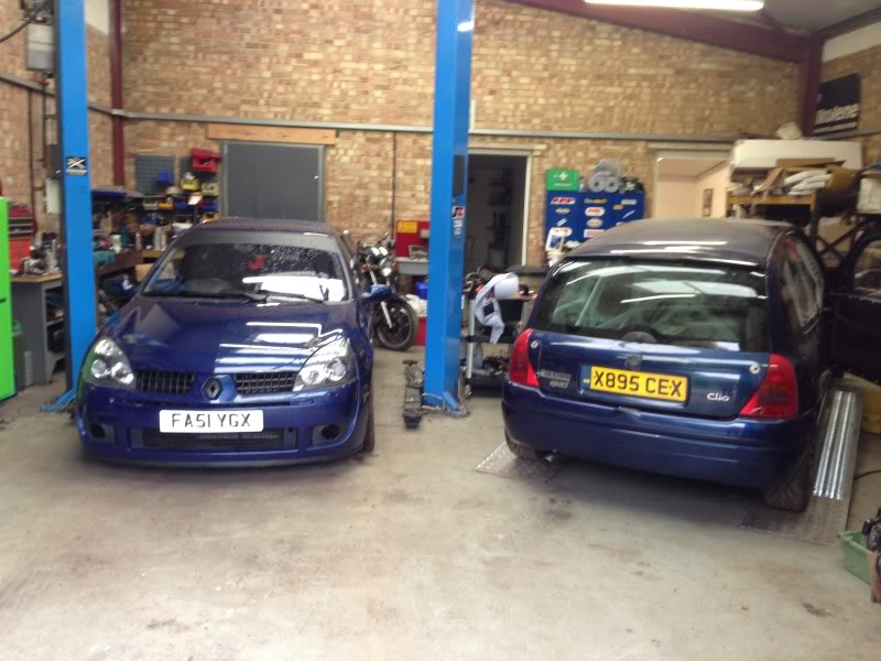

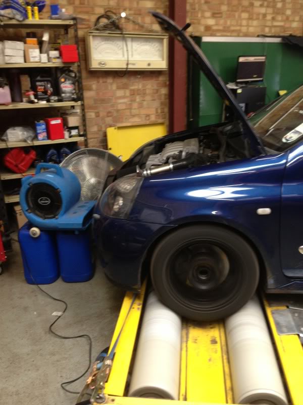

Took the car to 519 yesterday 'on the way' to london.
Jobs were;
geo setup
new speed sensor
dyno run to check everything is healthy.
Dan cracked on and get the geo which was all over the place with nearly a degree different camber one side to the other. Car now drives superbly and in a straight line which is always good!
Then he did the speedo sensor in a matter of seconds.

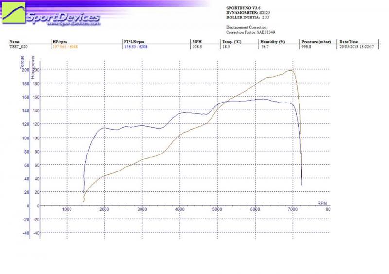

Then onto the dyno. This is where we hit a problem, the car was only making 180bhp. Dan was reading all sorts of figures and stuff that i dont understand, he then mentioned the map needed some adjusting. So I left Dans for london and returned this morning, straight onto the rollers and he set about sorting it.
Few hours later it was back to full health and Dan had a big smile on his face as the car was putting out some very good figures.
Anyway a few random pics,

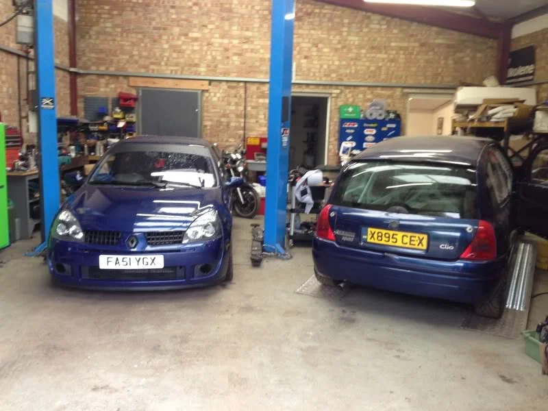

My car on the left, Rhys Beal's epic ph1 on the right.
Car made 197.965bhp & 156.35ftlb
Video on the dyno.

pretty similar peak figures to mine, you have better mid-range and seems to hold the torque better towards the very end, good to see it's back to full health
  172
Re: dmallett's 421'd monaco
mine is abit of a freak tho to be fair, know how well mine goes so yours should go like stink with the extra mid-range and with how it holds on at the top end

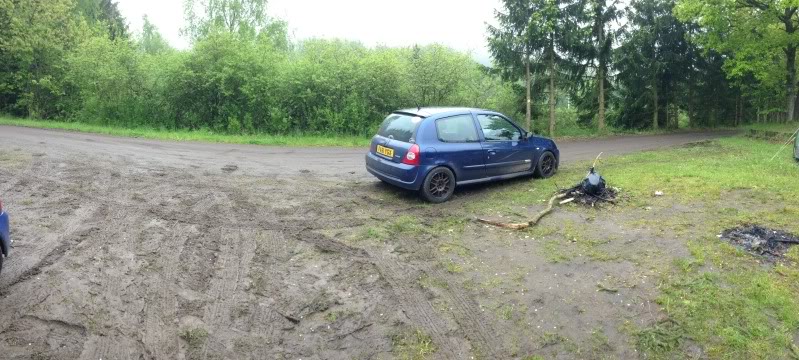

On a very muddy campsite

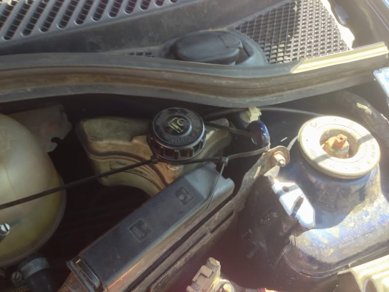

Brackets on the PAS fluid bottle broke, so i fixed that ;)

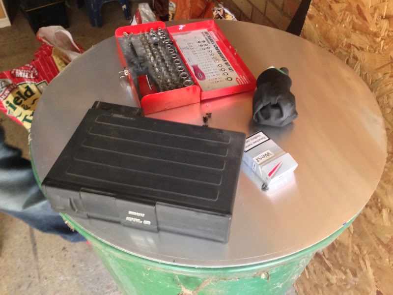

Also lost some weight of the CD changer ha,
