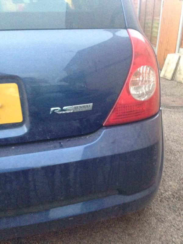

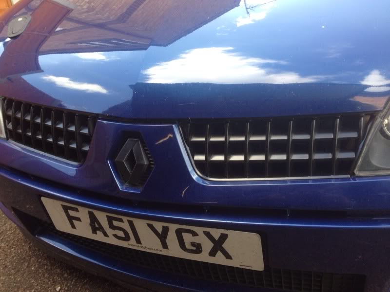

Got a reanult sport badge off here for £15!, so i cleaned just the area where it was going.
Put it on and it looks much better, but I wasnt happy with how it was holding on with some extra sticky double sided tape/foam so ive removed it untill I find something better.

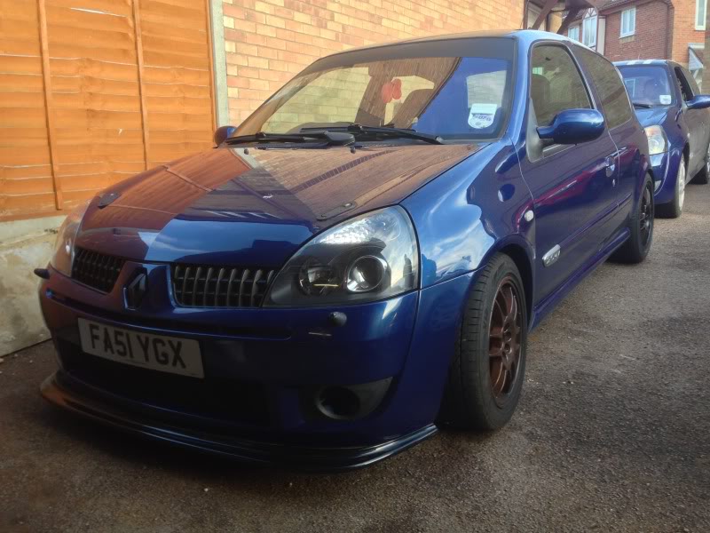

Standard plate back on after getting a £60 fine for the 3/4 plate :(

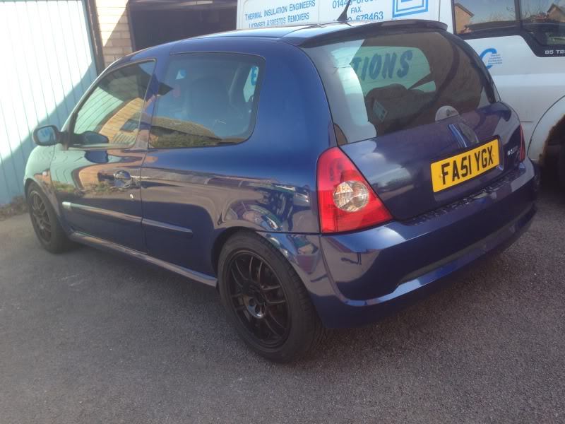

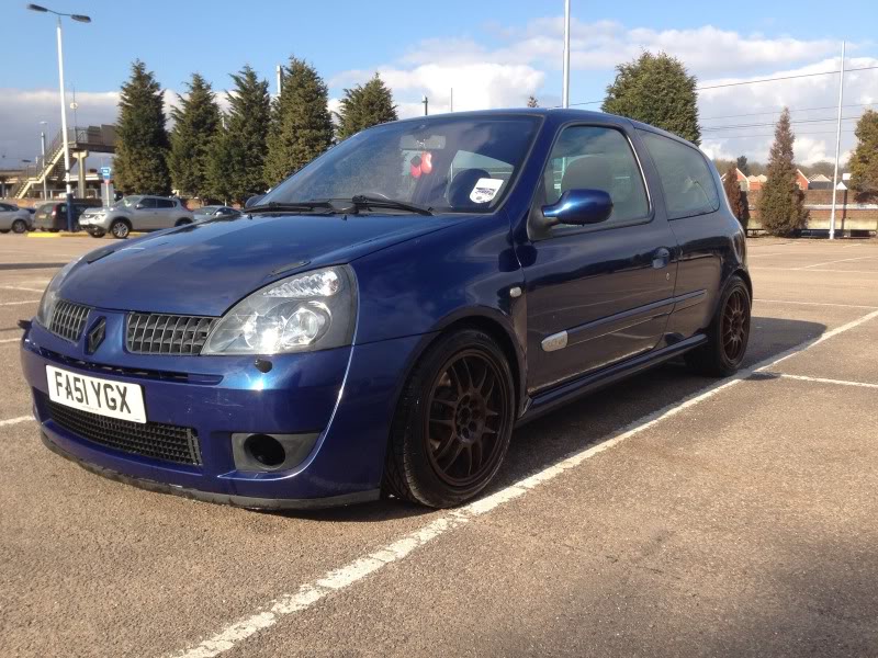

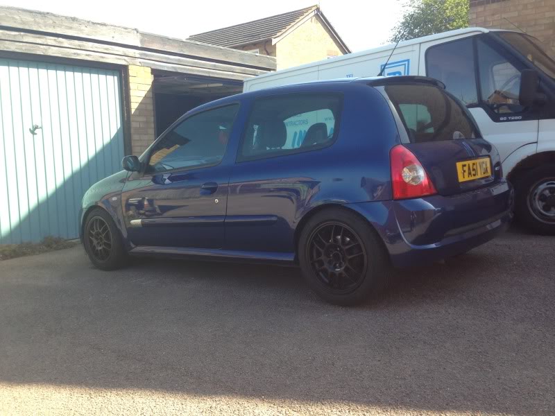

The car is also 13mm lower at the front than when last pictured, and 7mm at the rear to give it more rake. Ive been playing with the rebound adjusters also and i think i am now happy with how the car is setup, feels so firm and planted. Awful picture of the car, it looks clean in daylight i promise ;)
last picture is pointless as my drive isnt level lol

First clean of the year! Doesnt scrub up to badly, the car has its fair share of imperfections but it serves its purpose much better than looking pretty :p

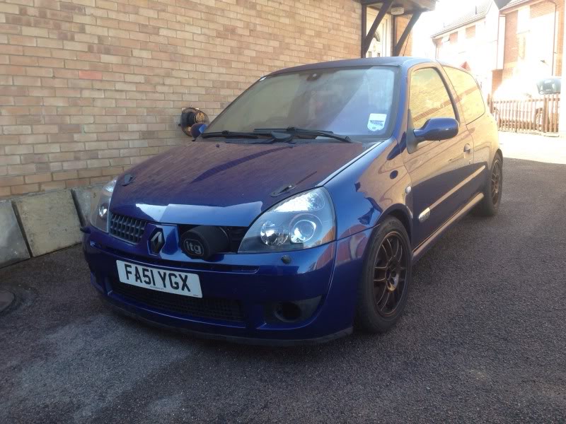

New filter setup, just need to adjust it so its alittle less squished, certainly seems to pull well just need to overcome the the issue of it getting soaking wet ;)
Re: dmallett's 421'd monaco
This is its permanent summer setup now as it just makes it pull so hard obviously from the extra length of pipe before the throttle body.
Hopefully it will be sunny at CSS so everyone can admire the brilliance of this filter.

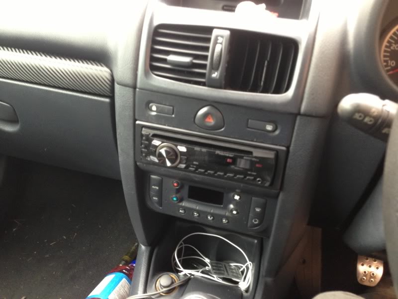

New headunit fitted, cheapest one i could find of course with aux. Nice to have a flush fitting radio which works!

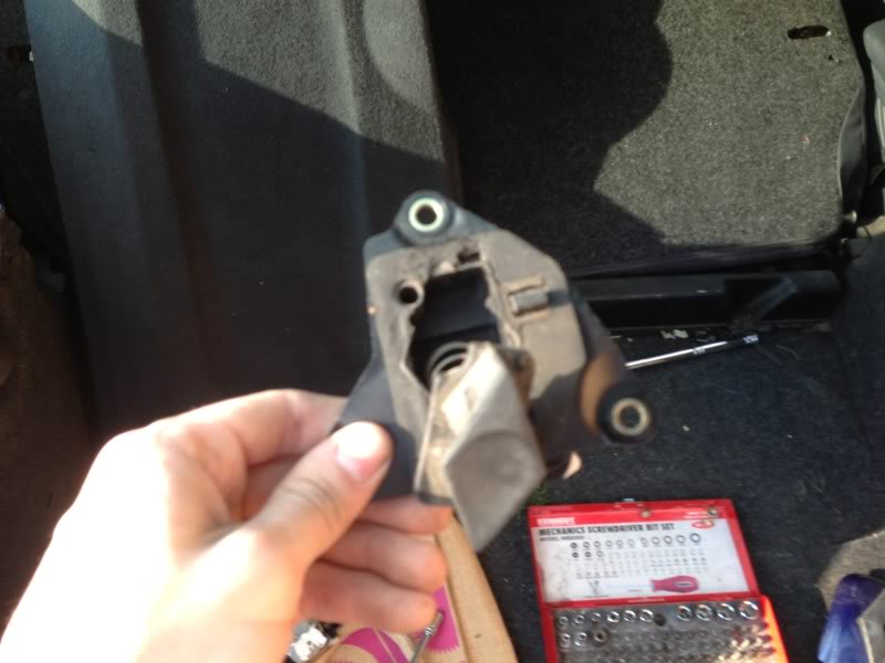

Replaced the boot lock mechanism due it not locking for past 3 months! nice simple fix consisting of 3 bolts :)

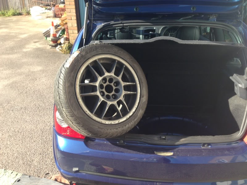

Then i took a trip to see Rhys Beal to pick up my old spare wheel that he has had sitting in my garage since breaking the ph1. It doesnt match the rest at all but im not bothered if it gets me out of the s**t.

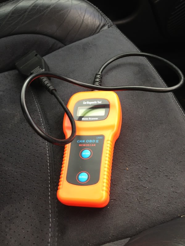

Then after a light night thrashing of the car i had a engine management light on. After about a month of this i decided to buy a cheap code reader for £15 off ebay. Error was the lambda sensor so i reset it and it hasnt appeared since. Guessing it doesnt need changing as its still getting decent MPG.

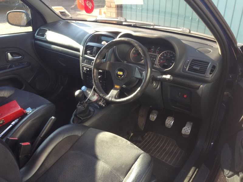

Spotted an OMP trecento wheel for sale on here so snapped that up. Its 300mm so rediculously small but exactly the same as what I ran in the PH1, all ive done since having a car with standard wheel/seats is moan that I cant get the position right for me so hopefully problem solved.

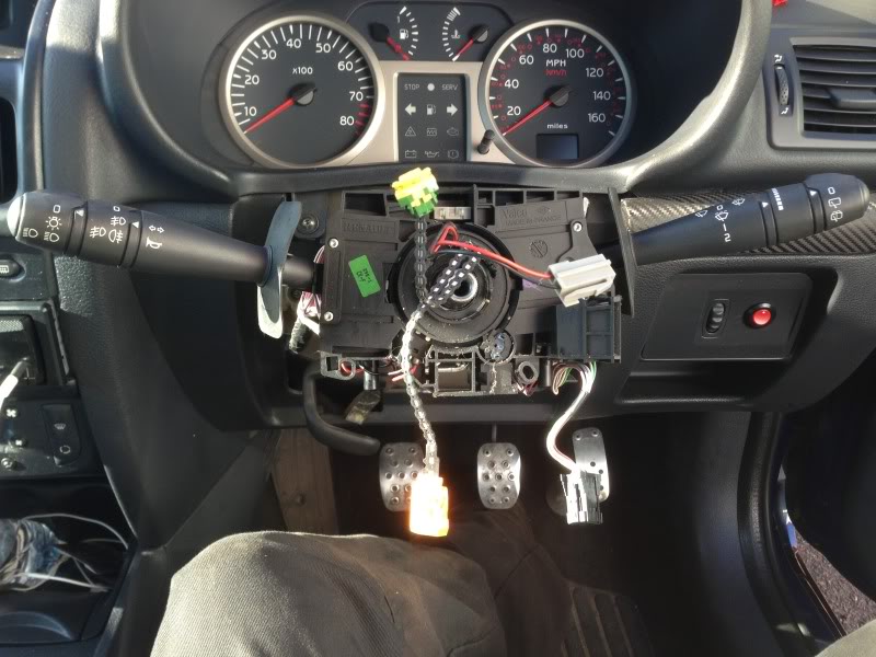

Ph1 stalk fitted courtesy of Rhys so I have a working horn.
Fitted with an OMP boss, much better IMO.

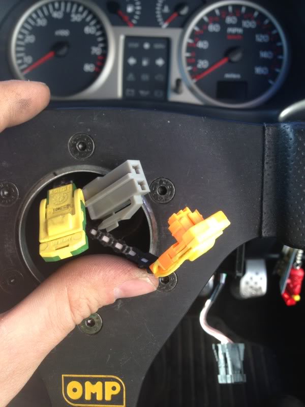

Which plug am i fitting the resistor too? Stumped by this as only one plug on the ph1s.

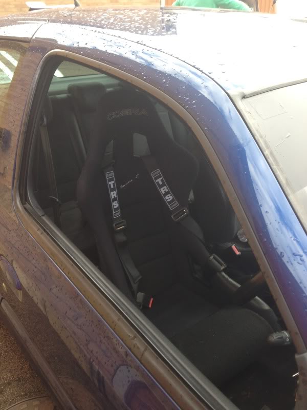

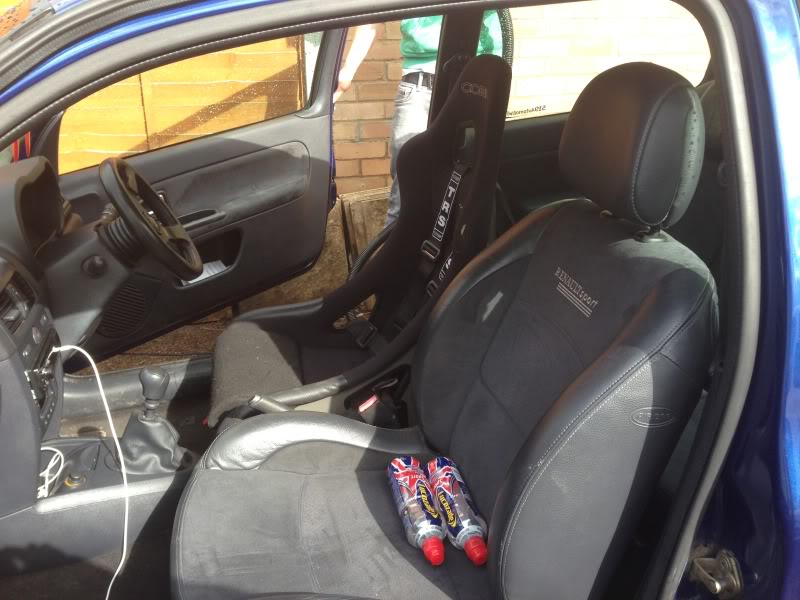

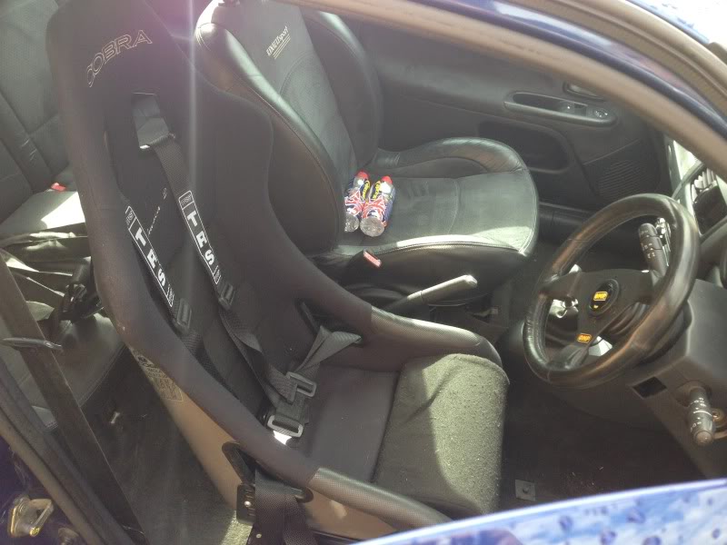

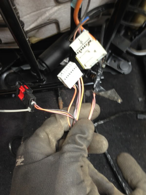

Today i fitted my bucket seat, first off greeted by this abortion of wiring.
No pics in the process, finished product.

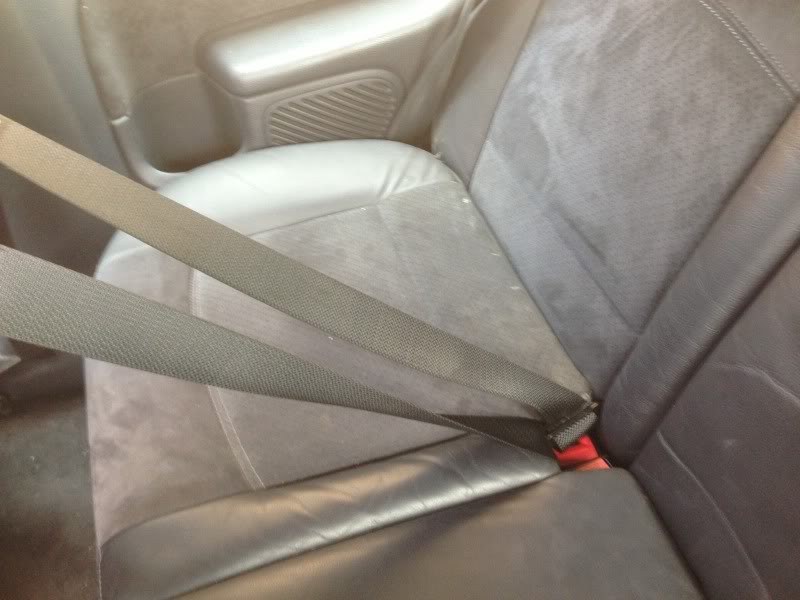

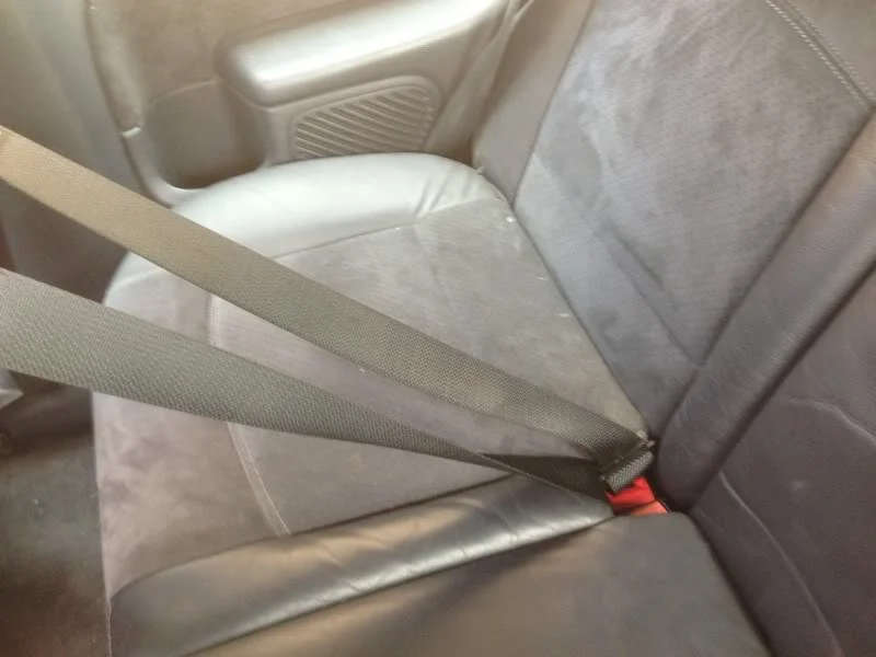

Kept all the seats in so used a eye bolt through the original rear seat belt bolt in the back. Probably not the best way but its where ive mounted them previously just i removed the seats last time.

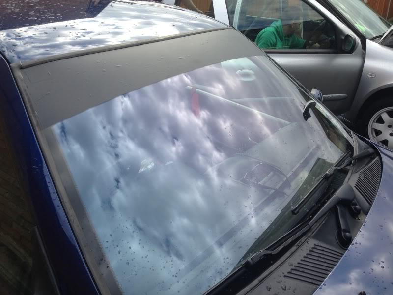

Sunstrip just for the ring trip, so many bubbles for under £2 worth it for the drive imo although majorly try hard/chavy.

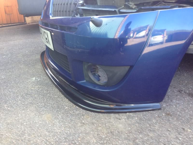

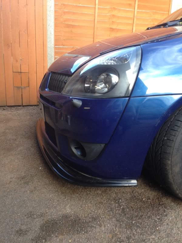

Then a mate came round and asked me to remove his splitter off his zetec s, me being me decided to fit it to my car. Such a bad fit but pretty funny looking, sure its good for down force/ripped my bumper off. This will stay until my skoda splitter comes in.
So the car is even closer to being ready for the ring now, new driving position is so much better. Makes the car perfect to drive now imo.

Is that the Triple R splitter?
Can't say I'm a fan of it on a clio, however, I am a fan of you not missing the opportunity to try it. Haha.
No idea what it is, he hated it so we were bored and stuck it on.
It won't be staying, that's for sure. Looks such a chav wagon right now.
It doesnt fit well at all IMO, has a lip sticking out where it shouldnt do and falls short about an inch.
Its off a zetec s no idea what it is, managed to scrape alot with it last night driving about 20miles so after that pic its been taken off again.
Though im sure you could manipulate the bumper to fit on it properly with a bit of work, would fit on a ph1 i reckon as the bumpers are so bendy in comparison to the ph2.

Also just taken the car shopping, and even more in love with the driving position. Gear stick for me is actually in a decent place now and about the right level, i know i must be the one of few that gets on with it. From a few metres away you cant really notice the bucket seat which is a plus. So the car still looks kind of normal minus the poo brown wheels :)

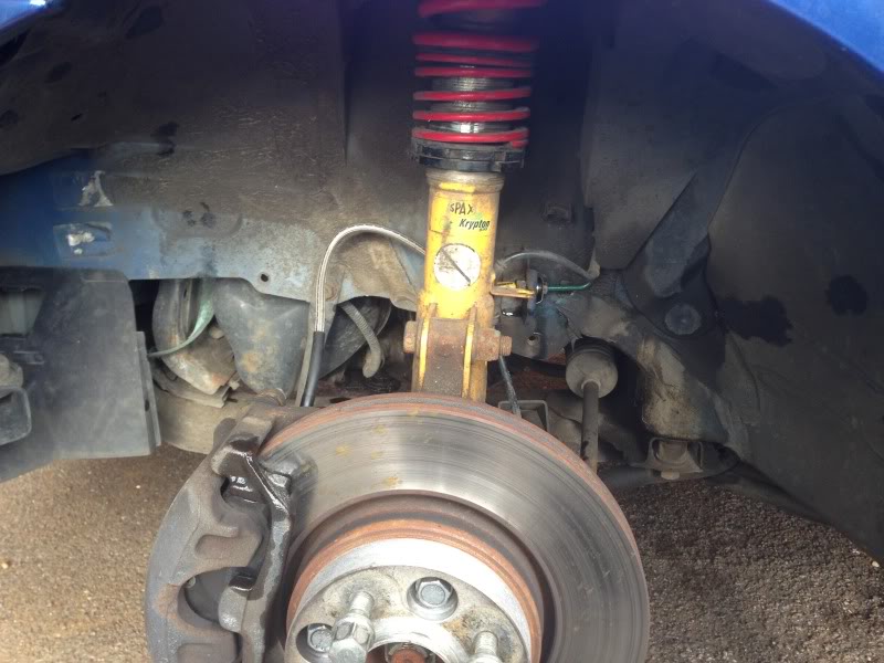

Braided lines fitted, what a doddle that was. Will bleed them later with ATE super blue when my mate finishes work.
