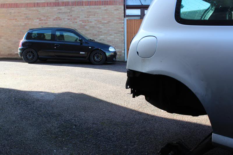

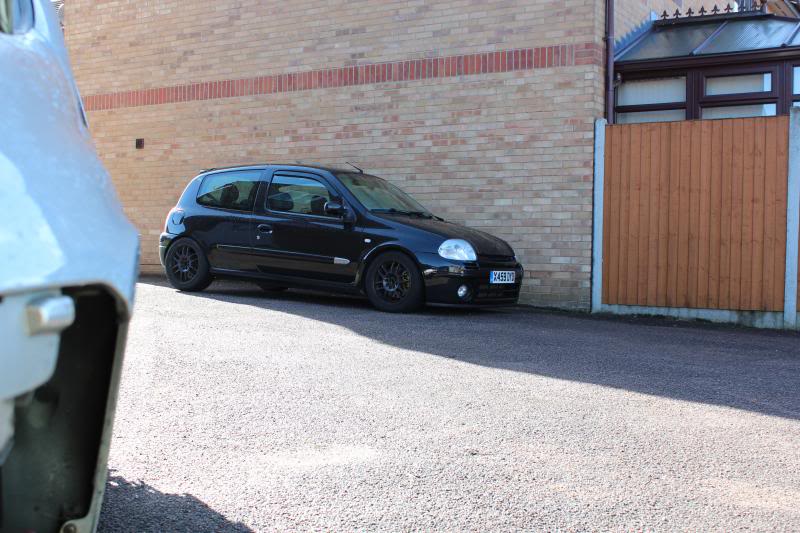

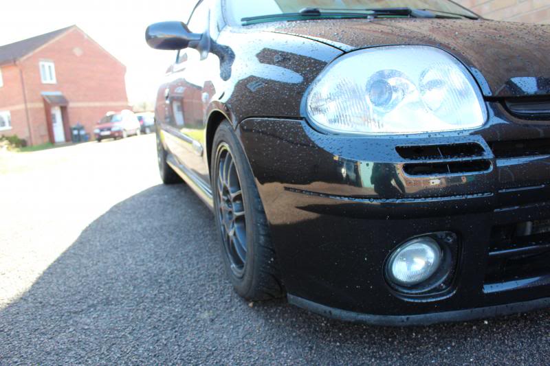

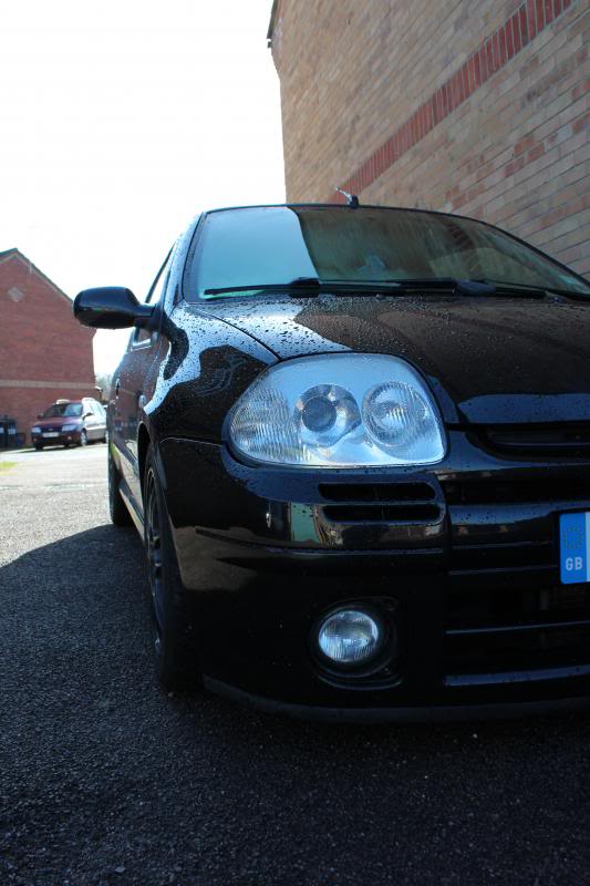

Today I was supposed to be sleeping/resting before I fly to France tonight for a week on the slopes.

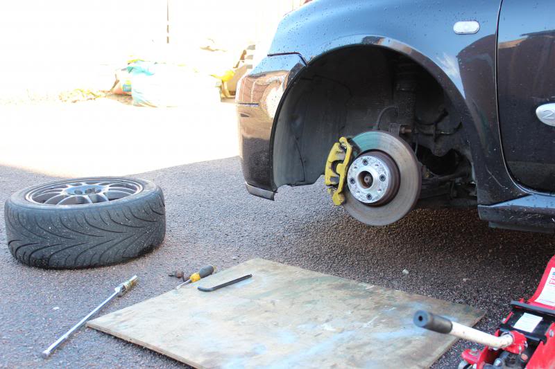

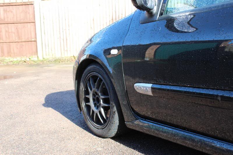

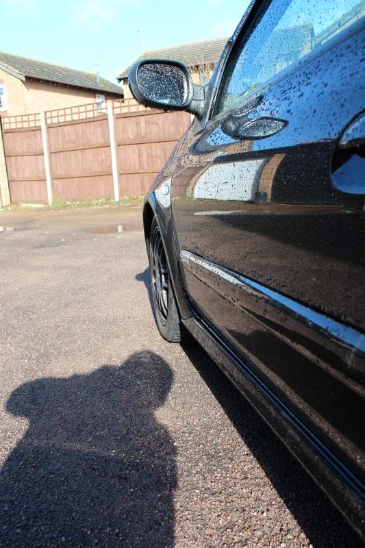

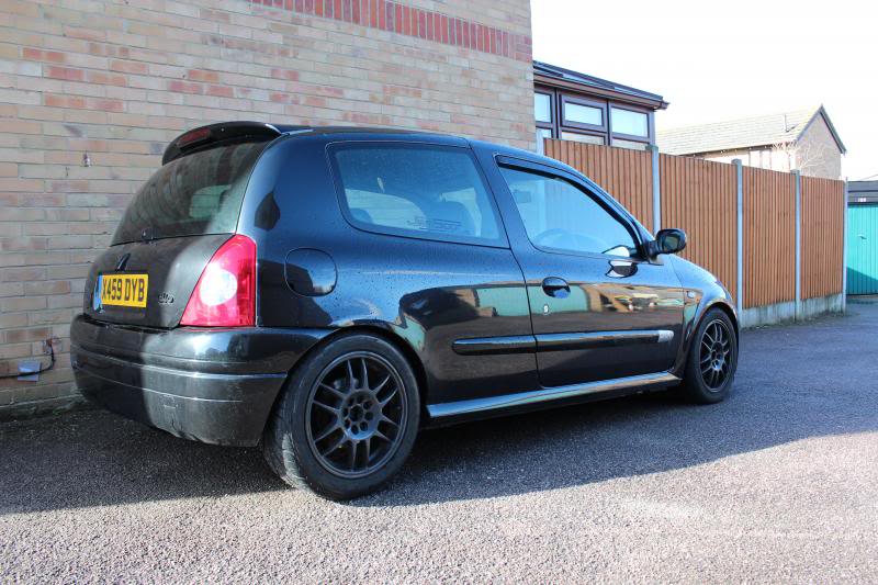

Instead I pottered about playing with cars, got some 20mm M.A.D spacers from someone Russ Rallye. I didnt really want them as you I read you couldnt use the standard wheel bolts but after nothing else came up I ended up buying them. Im too tight to buy them new these days!
Before
Fitted. One of my next jobs is to change the discs to some brembo HC, fit my mintex m1155 pads, fit my black calipers and braided lines. But that can wait.
Much better after being fitted, has to be said I cant tell the difference to the 25mm spacers Ive had previously but Im glad I jumped on Dr Jekyll 's 20mm spacer band wagon ;)
I also raised the back up 5mm more again.
Then I got carried away playing with the camera.

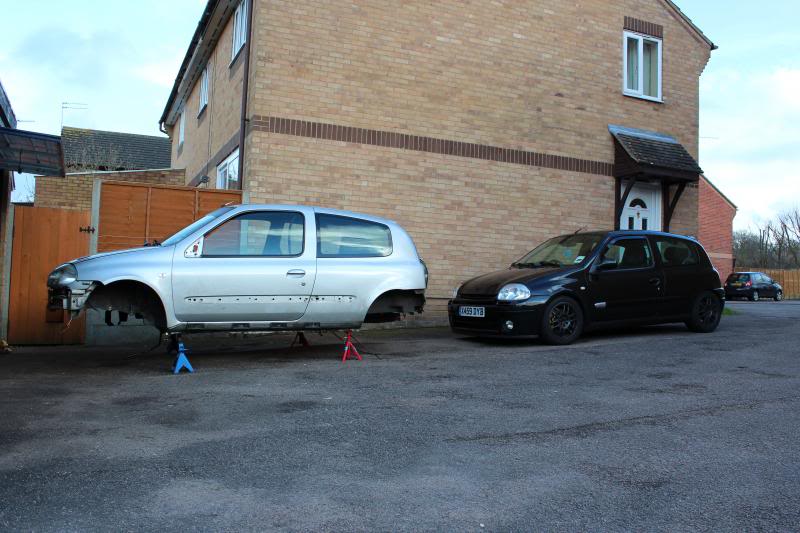

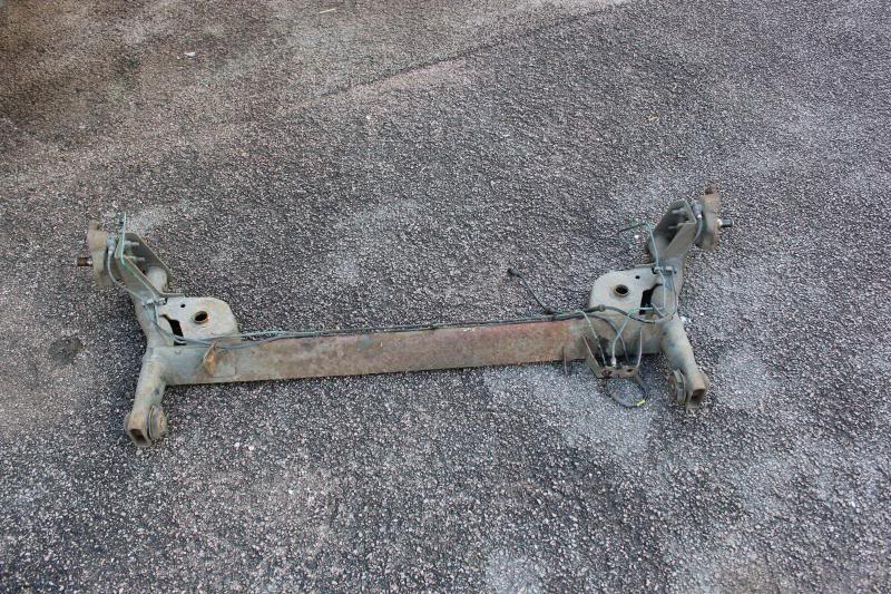

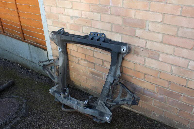

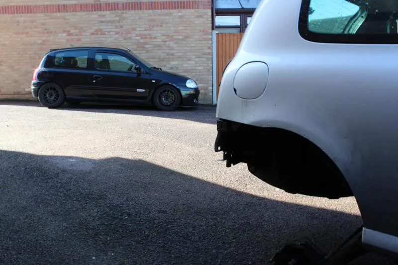

I then started pulling a few bits off the silver ph1 that I wanted to keep,
Rear Beam
Subframe

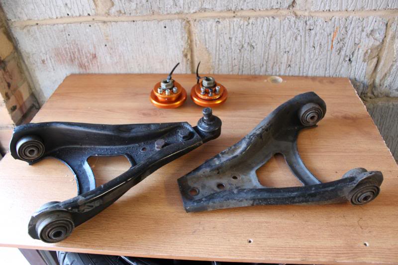

I also got some more parts, AST top mounts and cup wishbones. Going to add a bit of castor up front!!
And finally the silver car is ready to be scrapped, Ive removed pretty much everything of value from the car now. Needless to say the black ph1 doesnt owe me much money now ;) This has been the easiest car to break yet, I havent even done a breaking thread!
After talking to AlexW recently Ive decided to go down the route of converting to EPAS. So the plan will be fit new rack to spare subframe, powerflex bush's all round on the subframe, fit cup wishbones to subframe. All new inner/outer tie rods and rack bushes (unsure how the DCI rack is mounted).
Im conisidering getting the PMS stiffener kit and welding that on to the rear beam and refreshing the bushes whilst im there.
Im tempted to get the subframe/rear beam powder coated too, unsure if thats a step to far for me!

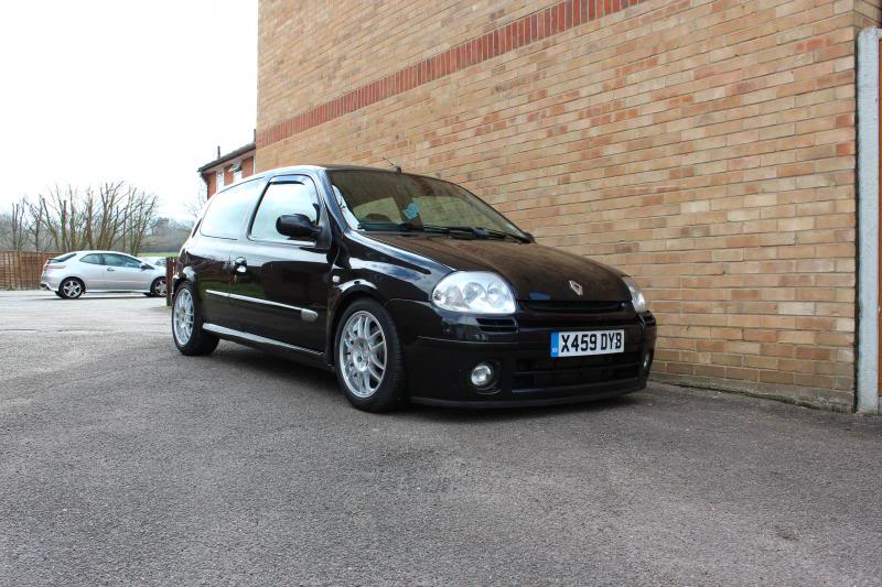

It looks spot on mate. OEM+ ftw. The 20mm spacers have a little tuck which looks like it should do as standard whereas the 25mm look to flush with the bumper an a bit too much. So have you got shorter wheel bolts for the fronts?
Silver wheels will looks smart too :)
  A special one.
Re: dmallett's indecisive clio thread! Monaco ph2 pg1+, Titanium ph1 pg31+, PB ph1 pg
20mm spacers ftw. :D
cheers! I agree with that. Nope I'm using the hex bolts that come with the spacers, then standard bolts into that!
Ideally I'd like to fit a stud kit to it as the bolts look s**t & I like studs.
Should look rather oem with silver wheels & badges on it, still an utter shed though :eek:

With the spacers, can find they hit the hub before going fully tight. Way to test is to remove wheel and spacer, and then bolt the wheel to the spacer, tight and see if the bolts stick through the spacers at all.
  A special one.
Get a new throttle cable for the sticky throttle, Marks is brilliant now compared to what it was!
Mine hit the hub but only on two bolts per wheel, when i did my wheel bolts up they just didn't feel right.
I took my bolts to work and took about 2mm off of each bolt on the lathe, felt rock solid after that when doing them up.

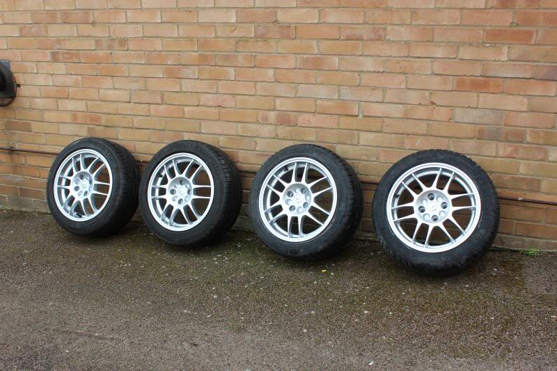

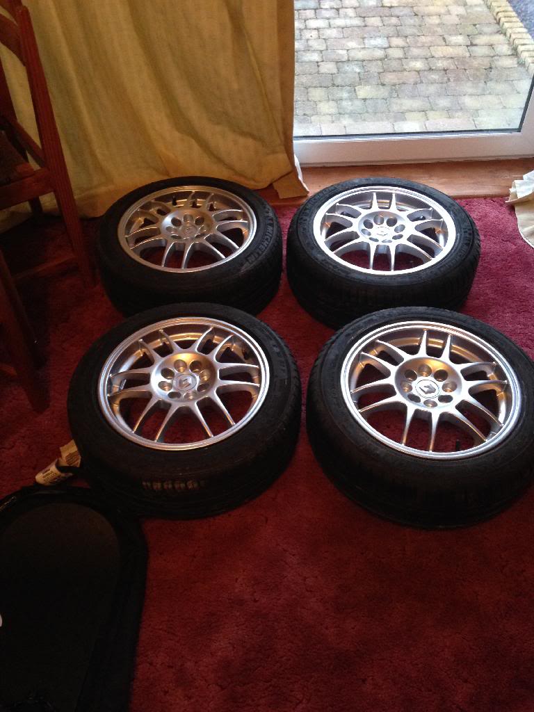

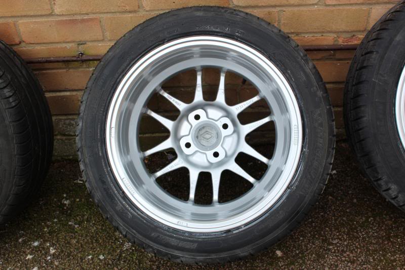

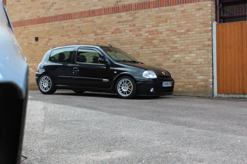

Picked my wheels up from Tom-173 today, they look amazingly fresh! Weather permitting they will be going on the car tomorrow.
  Many.
They look fresh!
I need to meet up with Tom sometime, lacking time!
Doing well son! Better than me anyway!
Im im blessed to be called your son, even when I've been away for the past few weeks I make progress ;)
any snow up there?
They look fresh!
you can't knock Tom's work & he's generally a top bloke!
So fresh and so clean, Outkast style.
Cheers! Fingers crossed for fitted pictures tomorrow :)
its strange me doing stuff to make a car look standard! Just gota keep them clean as they are like factory Fresh right now
