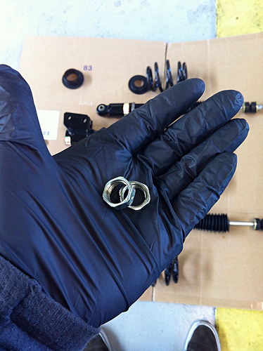

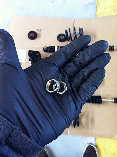

Got a PM from @Weeksy on Friday night saying that he had some nuts that I needed after I put up a wanted thread. Brilliant as he is fairly local and I was going to fit them Saturday morning, so I shot up to he's place on the morning to collect them. Top bloke and very passionate. Was nice to meet you mate :)
Slim nut by Dr-Jekyll, on Flickr
Slim nuts by Dr-Jekyll, on Flickr

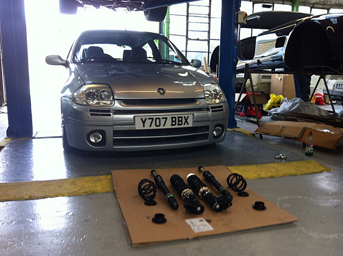

Coilovers at the ready by Dr-Jekyll, on Flickr

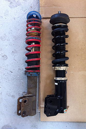

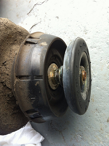

Got the Robs Vmaxx fronts off
Old Vmaxx Vs new BC coilovers by Dr-Jekyll, on Flickr

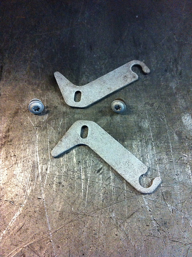

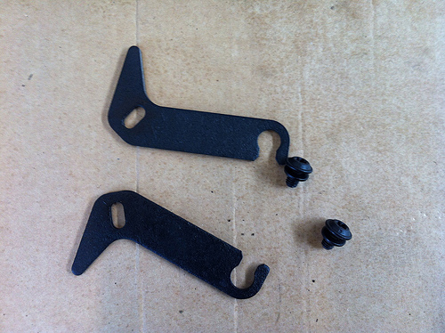

I kept my old ABS bracket off my old coilovers so I gave them a quick shot blasting and a lick of paint to protect them
Sandblasted ABS bracket by Dr-Jekyll, on Flickr
Painted ABS bracket by Dr-Jekyll, on Flickr

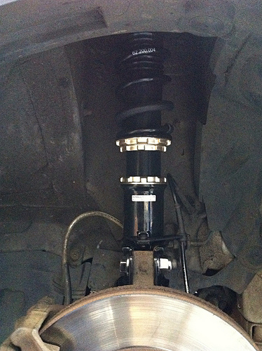

Got the fronts BC's on
Front BC coilovers fitted by Dr-Jekyll, on Flickr

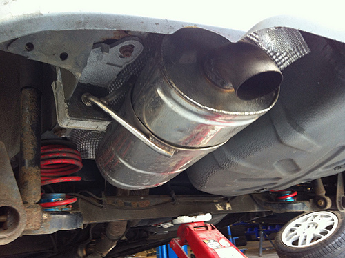

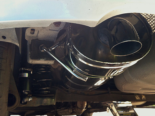

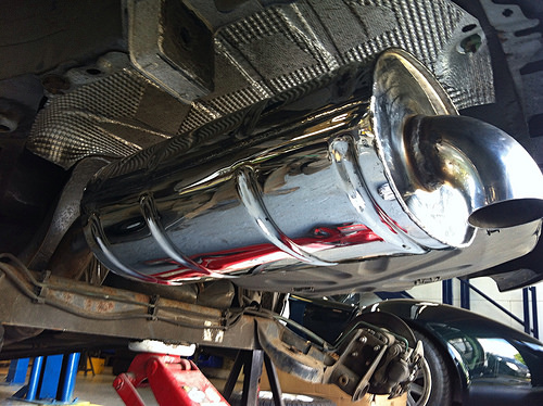

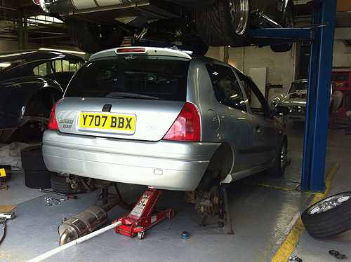

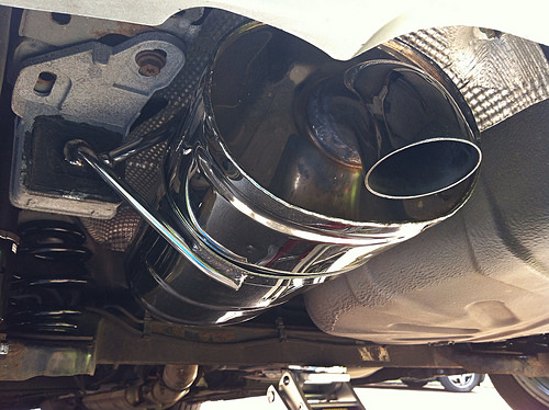

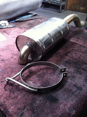

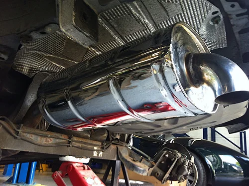

Then I moved to the rears and decided I would polish up the can of the stealth box on the buffing wheel. I didn't bother going crazy as it's got quite a few scuffs on it, I just wanted it to have a bit of a shine. Plus these are heavy when holding it up against a polishing wheel! The wheel could only get in so many areas but I knew I could tackle the rest with some autosol.
Old Vmaxx and dirty stealth box by Dr-Jekyll, on Flickr
Old Vmaxx and stealth box off by Dr-Jekyll, on Flickr
Stealth box removed by Dr-Jekyll, on Flickr
Polished stealth can by Dr-Jekyll, on Flickr
Put it all back together along with the BC rears but forgot to get some pics but I wanted adjust the height which I did today.
Adjusting by Dr-Jekyll, on Flickr

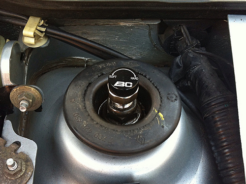

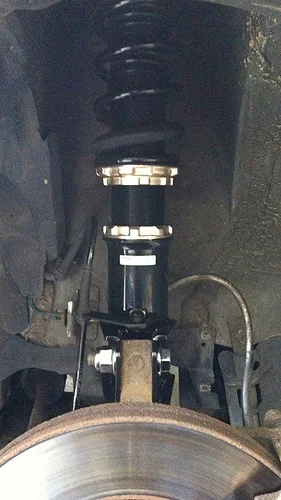

I wound the front coilover bodies down until the base was flush with the base of the strut and set the damping to 10 clicks from the softest setting
Front BC coilover damping adjuster by Dr-Jekyll, on Flickr
Gave the back box a going over with the autosol
Polished stealth by Dr-Jekyll, on Flickr

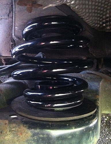

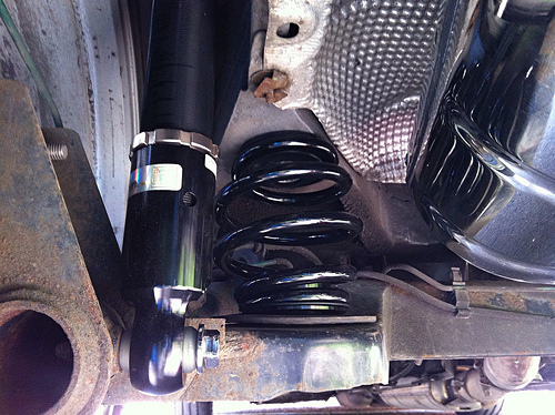

Pics of the rear coilovers
BC rear coilovers by Dr-Jekyll, on Flickr
All cleaned by Dr-Jekyll, on Flickr

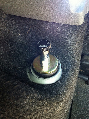

Set the rears to match the front on the damping: 10 clicks from the softest setting
BC rear coilover damping adjuster by Dr-Jekyll, on Flickr

So far I'm impressed. They are much better than the Vmaxx. I took it up the road yesterday and they felt pretty decent holding the roads. They've settled a bit and they rub so I'm going to raise it up a tad but I'm glad I got them. AlexW came round last night and had a drive so I'm sure he'll give he's review too.

Got out this morning I adjust the height again. I've raised the coils 1.5 turns and raised the damper 10mm up from the strut. I also decided to shave the seats this morning to remove some bobbling, this time without cutting the leather :eek:

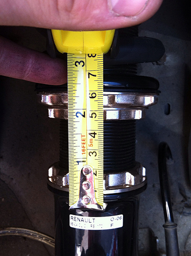

Height as it currently is. It was hard to pic the tape measure but it is 60mm from the base of each end gold collar.
BC front coilover setting by Dr-Jekyll, on Flickr

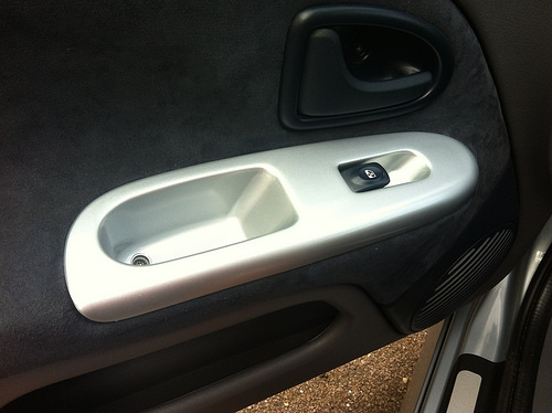

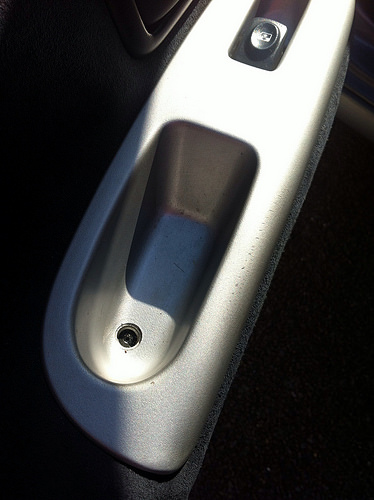

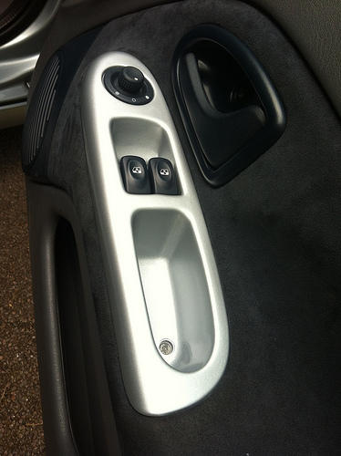

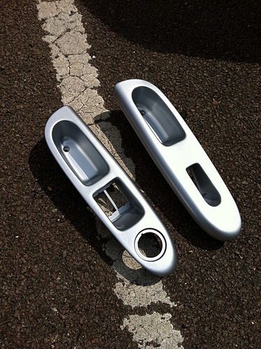

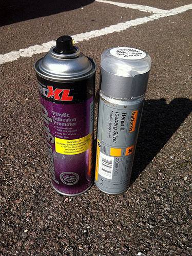

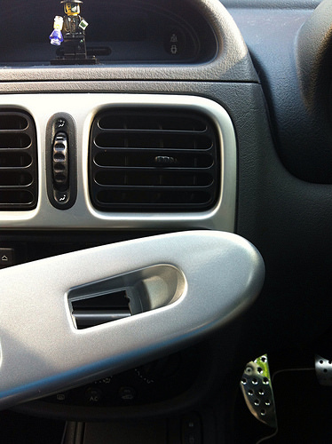

And painted handles. Not perfect but I'm happy with them. They look better than the scuffed looked but they are much brighter than the center console. It also is not a colour match for iceberg, it looks more like titanium! I will eventual get new ones but I had some paint so it hasn't cost me any money for the time being :)
Grab handles before painting by Dr-Jekyll, on Flickr
Paint for grab handles by Dr-Jekyll, on Flickr
Slightly brighter by Dr-Jekyll, on Flickr
Grab handles painted by Dr-Jekyll, on Flickr
Grab handles painted and fitted by Dr-Jekyll, on Flickr

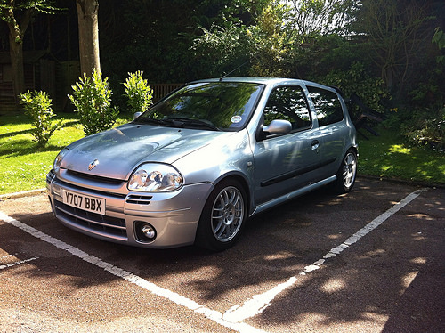

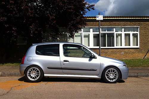

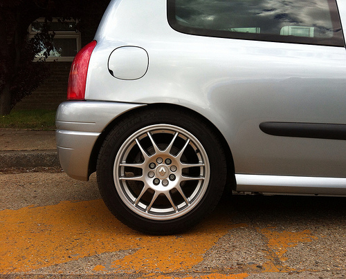

Ive just taken this so here's a pic on how it sits atm:
Side view by Dr-Jekyll, on Flickr
:cool:
