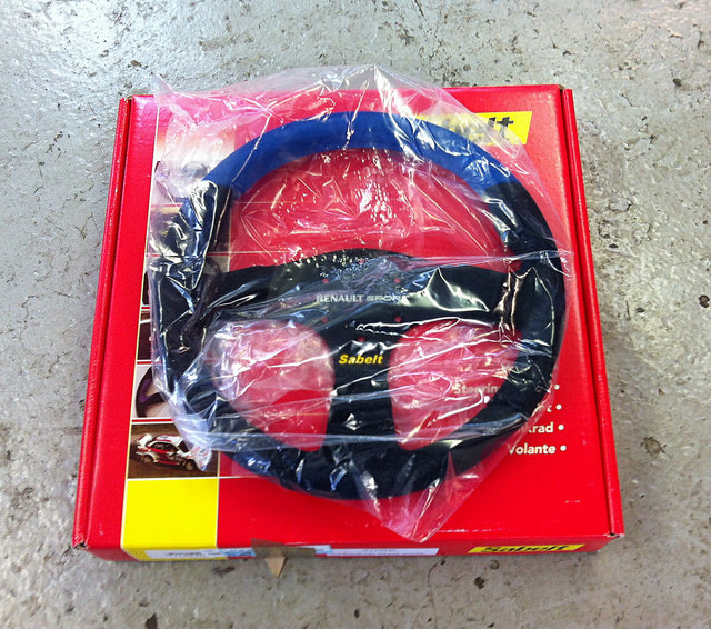

My girlfriend had been promising to get one of these since the Surrey rolling road day in feb as she knew how much i wanted one and liked them. A few months past then this week we ordered the bits. Phone Larkspeed and ordered a Momo boss and spoke to Adam @ Renault Wolverhampton and ordered a Renault sport Sabelt wheel. Great service from both on both parts arriving promptly.
@Timmsy She kept to her word ;)

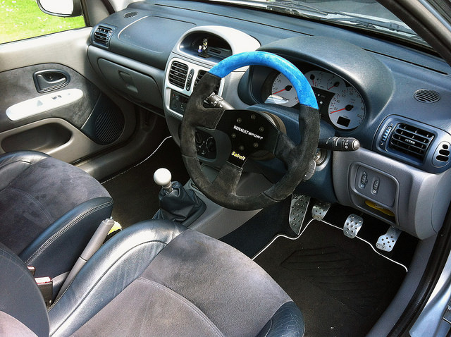

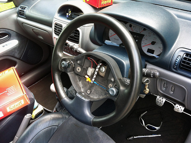

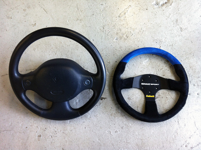

So i got them fitted
The ph1 wheel looks massive in comparison in this pic. It is bigger but here its only due to the Sabelt being flat and the ph1 wheel at an angle.

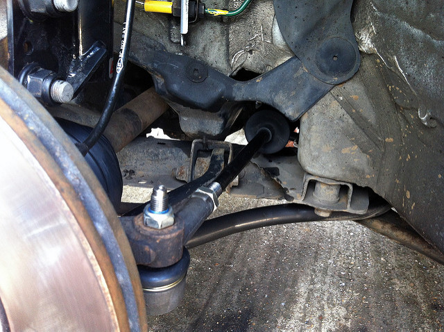

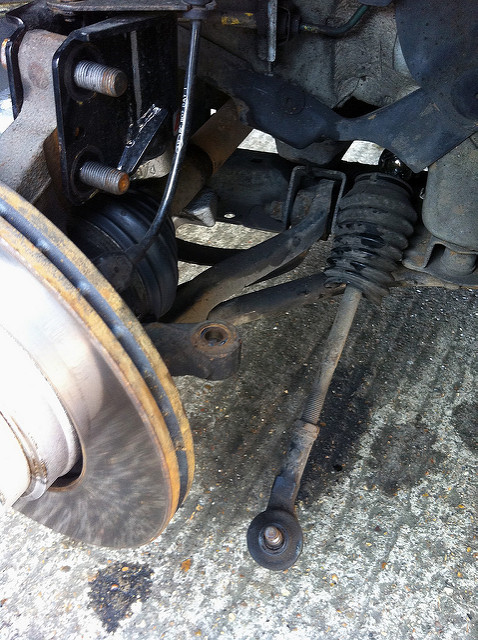

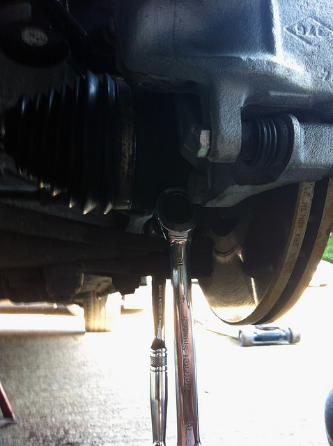

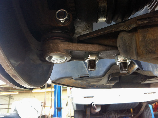

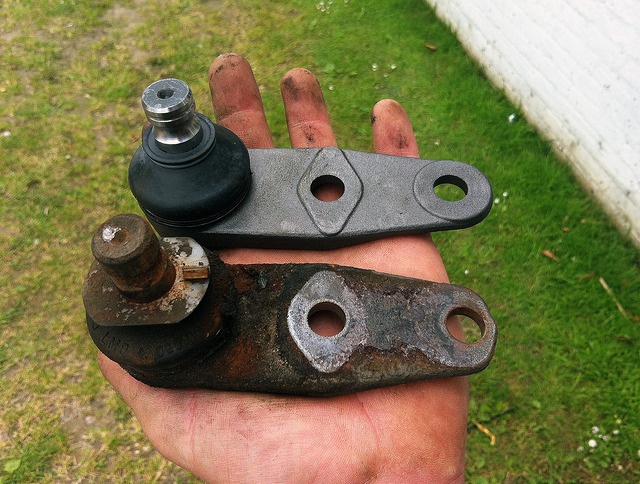

I was back in the morning with @AlexW as he gave me a hand fitting some lower ball joints as mine were making a noise. After realising that we couldn't get the ball joint splinter in (the one at work is bigger) and knowing that there was a tad bit of play in the inner track rod, we decided to remove the hub for ease and buy new inner and out track rod ends.
We shot down our local GSF car parts and picked up a pair of inner and outer track rod ends and shot to halfords to get a viscous fan spanner to do the job. Not sure what was more of a ball ache, getting tongue tied trying to say viscous fan spanner or using it on the inner track rods!
http://www.halfords.com/webapp/wcs/..._productId_214258_langId_-1_categoryId_165469

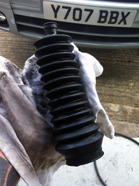

Gave the rubber a clean up before putting the new inner on

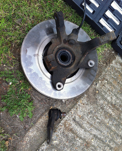

Got the inner and outer track rod ends fitted and then removed the lower ball joint from the hub and got the new one fitted and fitted it all back up

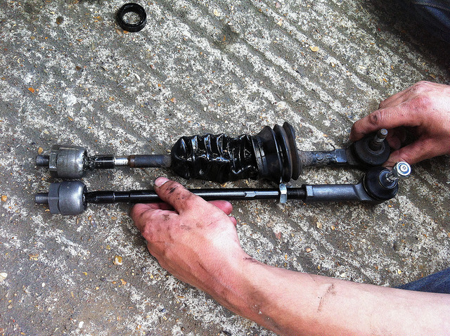

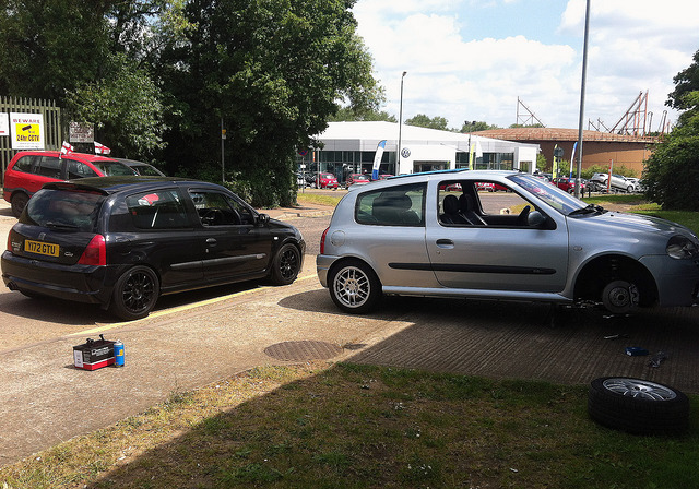

We took a little break and i took a few pics which might interest @DaveDreads

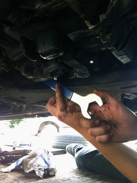

Once we scoffed the '99 we went onto the drivers side and repeated the process, which came off a lot quicker than the passenger side :) Fitted the new inner and outer track rod ends along with the new lower ball joint and put it all back together. On the passenger side, the driveshaft thread was a little knackered and we had trouble putting the hub nut on, but the drivers side went on with ease. Alex said he had some spare at home and that we'd come back later on to refit a new one on. With that we drove the car on the ramps and sorted out the tracking.
We then went home and came back later in the evening to refit the new driveshaft nut and Alex also bought round he's laptop in which he kindly turned off my airbag light, due to the Sabelt. We then went to put the new nut on and it still wouldn't have it so we took the hub all back off so we could thread file the end. Luckily because it had been replaced earlier, it came off a piece of p*ss. After many attempts and filing and still with no luck we just though f*ck it and we took a disc cutter to the shaft and cut off 2mm off the end. After that the nut fitted a treat so we put it all back together!

It feels much nicer to drive. I didn't have a problem with the original but it would seem massive now! I do think this size (330mm) is perfect. Anything less is too small for daily driving, but i guess its personal preference. When i felt yours i did think it was too small.
