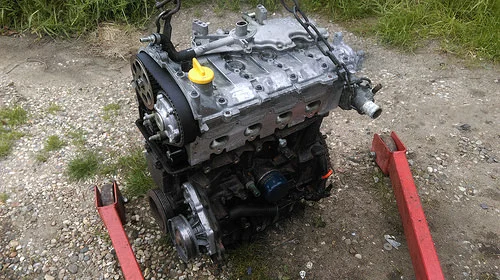

Dr Jekyll's Ph1 172 Progress Thread

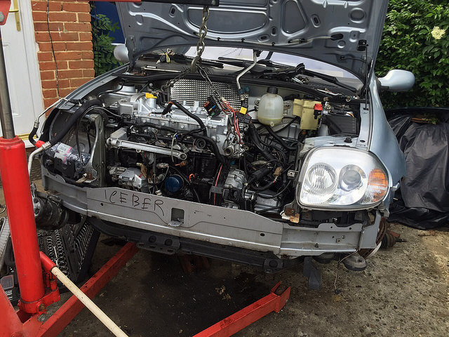

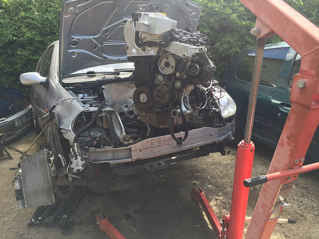

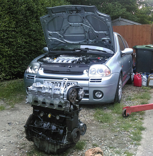

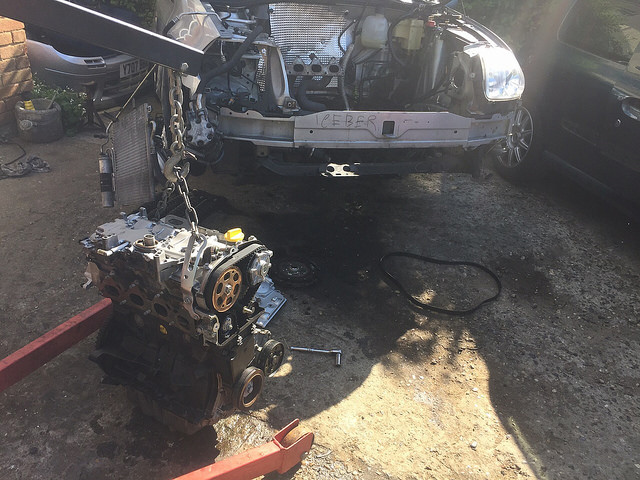

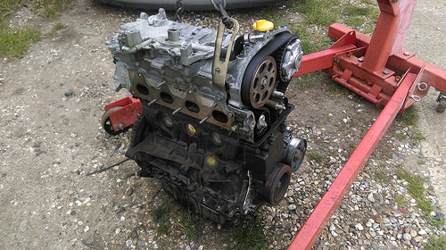

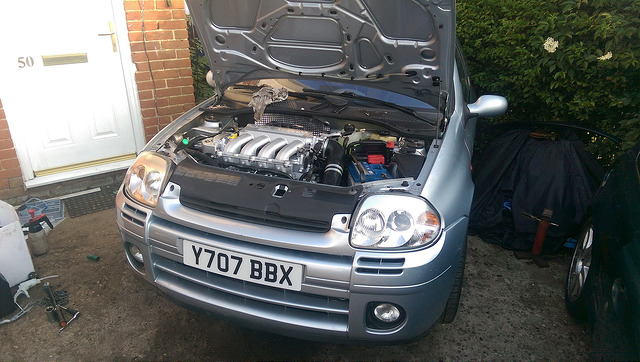

Exclusive engine out

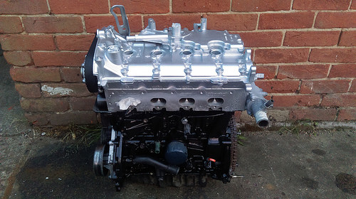

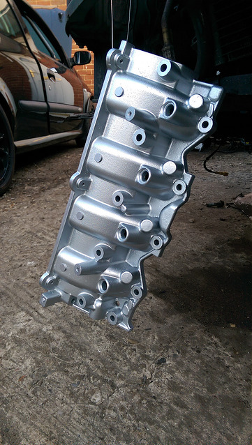

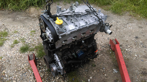

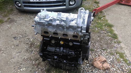

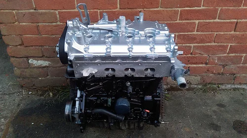

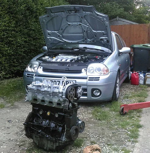

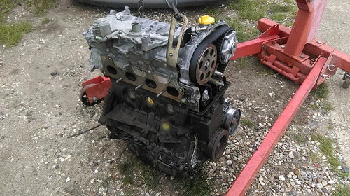

And cleaned/painted
Have given it another coat of silver and black since these pics. Also it looks like its had a new head at some point too. More soon....

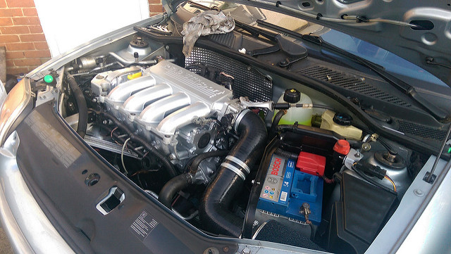

Good progress, I hope for an EXTREMELY clean bay after all this!
Car is very clean, but it is quite a repair bill to fix it, and because there was an insurance delay, well, the courtsey car cost about 6 grand, plus the 2 grand car storage fees... So in effect, paying out the less than 2k, was tiny.
Still got some bits from it/whole shell still atm(!) if you want any bits?
Also, bay was as clean before, so shouldn't make any difference, as we're not realy doing anything extra

I have no idea!! Even @AlexW said there was so much crap everywhere it was hard to tell.

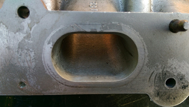

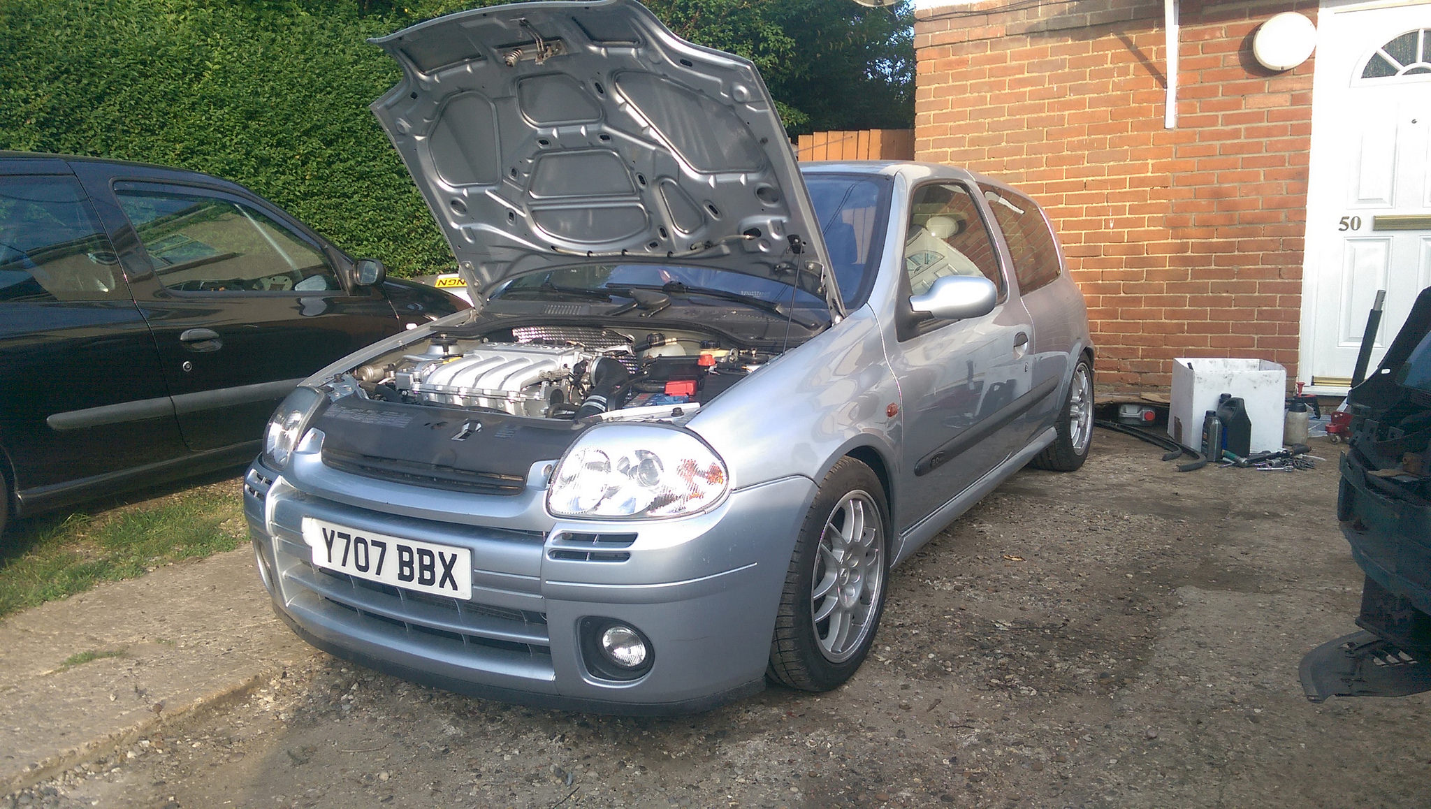

These pics were sent to me, I haven seen it yet. Going over there tomorrow to paint the lower inlet.

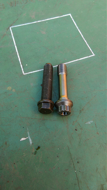

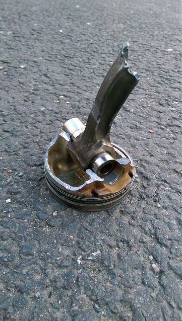

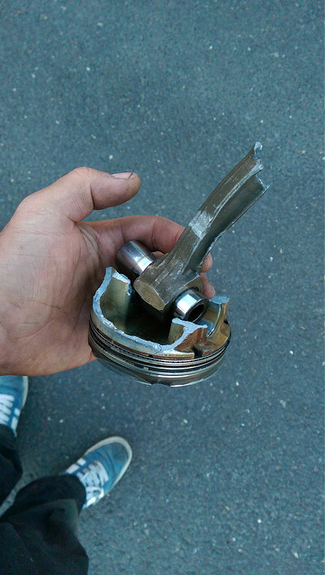

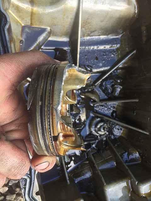

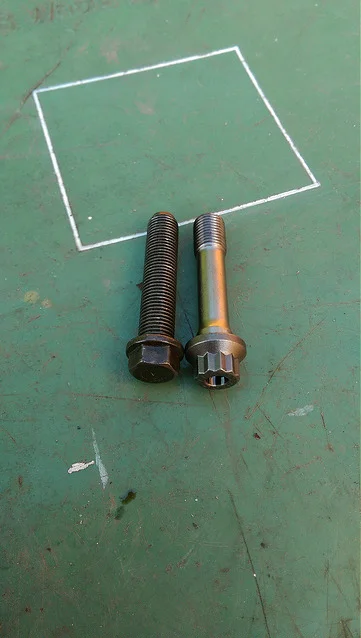

They also look like quite slim conrods. I didn't realise till I took them to work and a few guys showed me some that they have from other cars and these look a fair bit slimmer.
  Many.
I guess I either didn't say to you Mark, or put it on here.

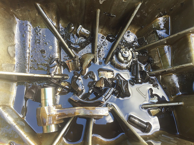

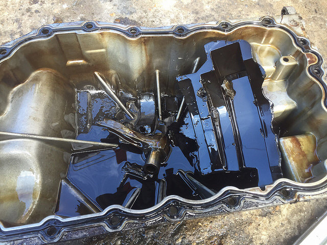

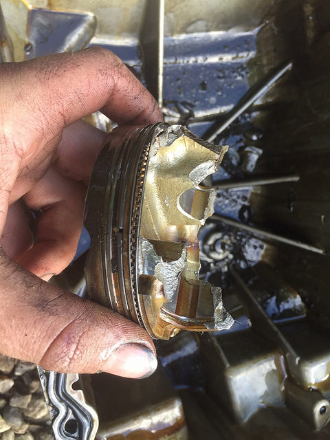

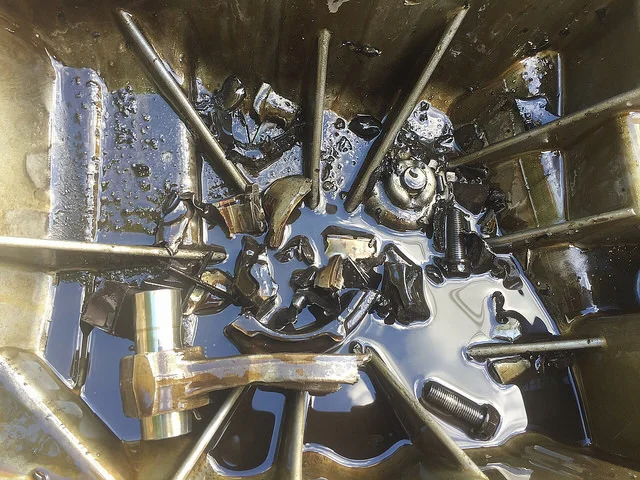

I dont think it was rod bolt fail at all, which were my first thoughts. I do believe its probably had a lack of oil, or just not been up to temp properly and its been its final time and couldn't take it anymore.
I dont have any pics of the lower half of conrod, because its in tiny tiny pieces, well what I can find anyway. Biggest bit was where one of the conrod bolts threaded in.

I doubt it would be oil temp, most of mine have been thrashed from cold and I've easily done 200k+ in 172's and with rare oil changes too! Lol!
  Many.
The point is, its not bolt failure (which I thought before I even saw the car), and the bearing is truely a mess. Unfortunately its impossibe to tell, mostly because the engine kept rotating, so thus theres crap all round the engine.
