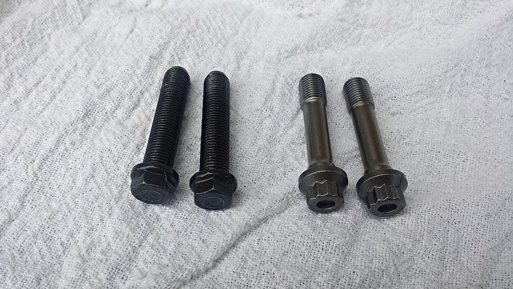

The Renault ones are threaded all of the way up so will stretch.

Hmm, perhaps I'll make a little purchase then if it helps. Don't really want it going bang again.
Might as well while the engine is out, easy job
My PH1 will happy rev to 7400 off the limiter, no problems.
Renault bolts are proper s**t.

Scott is right, whilst putting the new engine in I'd throw some ARP's in. Not too pricey and worth it. I put a set in when I charged it but should have done before really.

I'd would definitely fit a set of arp's mate. It's added security and peace of mind, plus it's much easier to do when the engine is out of the car.
I'm just a bell end mate. That's why I never bothered fitting any in my standard engine.
  Many.
I'm going to look into why Marks engine failed before I say fit ARP's. I know of plenty of engines that are fine without, and I suspect its not a bolt failure on Marks, but I shall see before I commite.

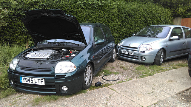

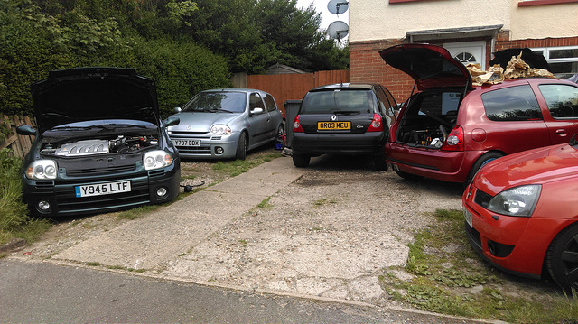

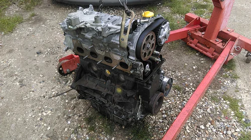

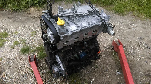

Went to see Alex recently as i dropped off some bits to him. As mentioned, the doner 172 is now on the drive:
Along with a few others:
First time ive had a look over the Exclusive and the engine looks in decent condition. Going to take a few bits off the doner 172 as they are in better condition than my current ones or spares that i want to paint. They are:

ARP rod bolts

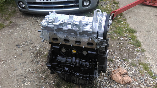

New engine, with belts, pulley and water pump all done last year.

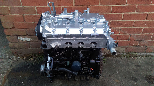

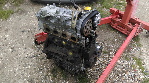

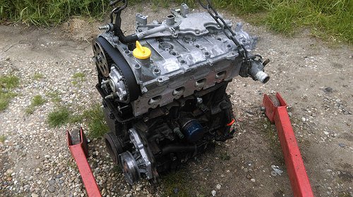

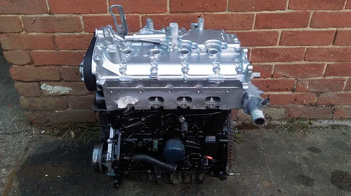

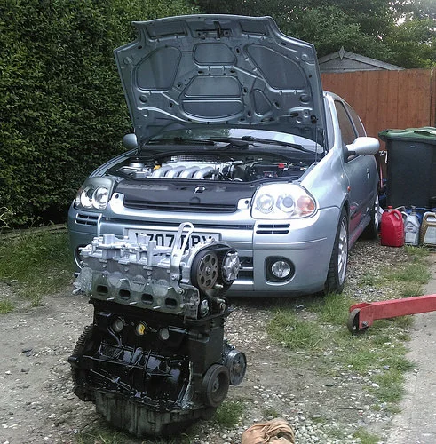

Exclusive engine out
And cleaned/painted
Have given it another coat of silver and black since these pics. Also it looks like its had a new head at some point too. More soon....
