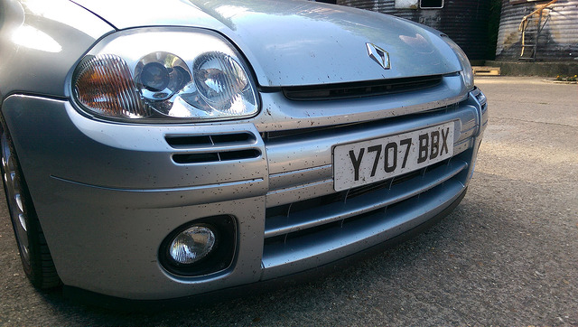

Some t***s opened their door on mine today :( I noticed a dent in the correct light.
Yes Tom it is. Big thanks to the kid for the work on it! :up:
Not good about the door dent though mate. Get it sorted as it'll bug you. Can't imagine it'll be much to repair.
I've got loads, as well as scratches. Ideally id like it to have a full respray as the bodywork needs work but that wont be for a long time so that's why Im not bothering with dent removals. The body work does annoy me on this car though 😧

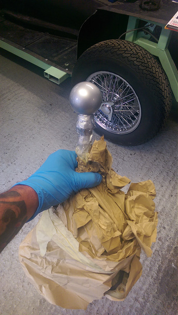

Had my Ph1 gear knob painted:

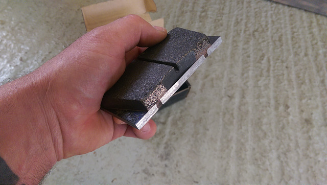

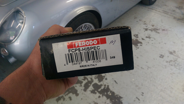

Ad have just ordered some DS2500's for my Hi-Specs. Tried getting them off @George@RTR_Parts but he was unable to get them as i needed to go direct to Hi-Spec. Top service from George as always, offering me lots of info and options. For future info for people that are running/thinking of getting these calipers on the standard 280mm discs, you have to go to Hi-Spec direct as Ferodo make these pads only for Hi-Spec. Its due to the pad sitting in a different position on the backing plate as the "normal" ones sit higher/lower (i cant remember which)
Another nail in the coffin for Hi-specs imo.
But annoying as I thought they used the Volvo 240 pads but these are obviously modified. Luckily they offered me my old Dax discount and invoiced Evanta so they claim the VAT back so I got them for just under £80 instead of £137.
I like your knob.
You dirty devil :wink: Once it's fitted I'll even let you my knob!

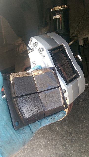

Changed the pads today. Such a massive improvement over the EBC road pads. I love the bite that the DS2500's have.
NSF:
OSF:
As everything was greased up on the original fitting it all came off easy. Greased it all back up before refitting. Probably the easiest job that's been done on these brakes!

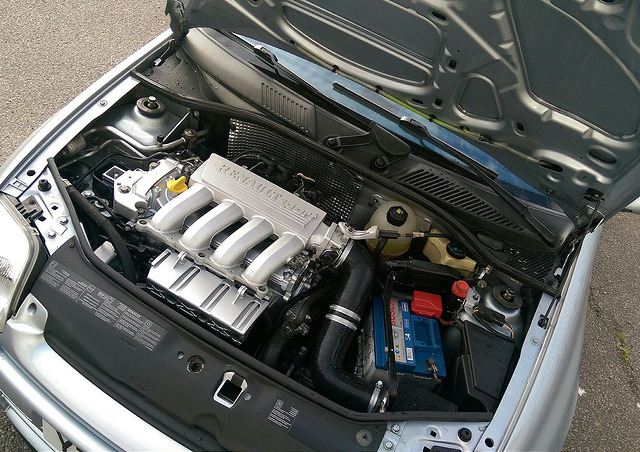

Not sure exactly Chris, but it did leave a big hole in the block! Luckily enough we found another ph1 that had a recent belt/service done and was on similar mileage (actually 3k less than the old/f*cked engine) and that was written off due to being rear ended. Together me and Alex had the car and sorted out a deal and i kept the engine and a few various small parts and Alex fitted it for me :)
The pictures the ph1 look a lot better! You cant see the scratches, dents, scuffs, chips, etc in the pics!! I've said for a long time that i want to get it mechanically sound before i look into the body work.
It was mechanically perfect until soembody threw the rod.

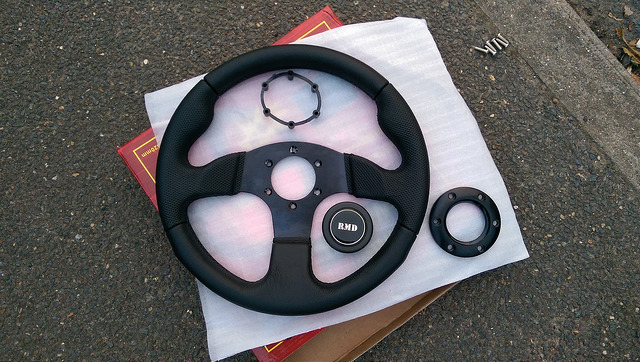

New steering wheel came the other day. At first it felt great, but after driving with it i realised that i dont like it.

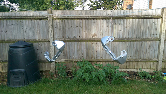

Got the typical ph1 sticky throttle now! I decided to paint my rear caliper carriers so they looked fresh again:
Then once all fitted i took some pics:
