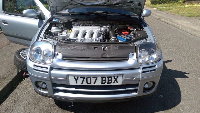

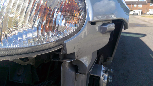

My damage is:
F*cked front bumper
Broken headlight brackets (glass is intact but the headlight wobbles)
Grill pushed back
Slight crease in bonnet
Small crack on wing

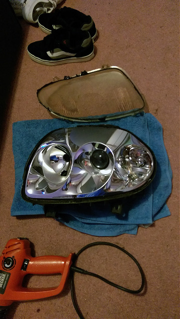

Got my headlights home and i decided that they would need a lot of work t clean them up. With that i decided to remove the lens with my original one and swap them over. Got my heat gun out and heated up the lens then removed it.
I got a bit of glue on the "chrome" so i took a wipe to it...... that was was bad idea. it went black. Unfortunately the chrome the other one was cracked so i just tried neatening out this one. I think i went too far!

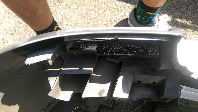

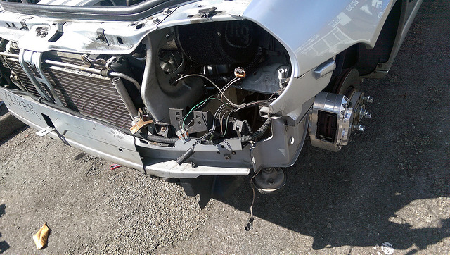

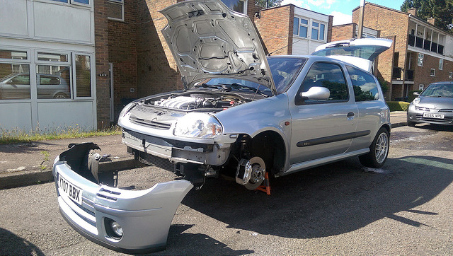

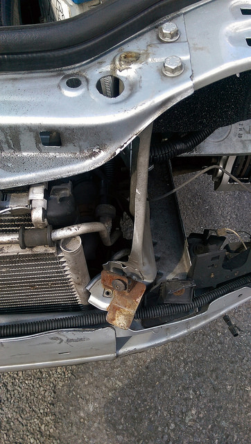

Of course i had to remove the bumper and grill to get to the headlight. This was good as i could see the damage behind the bumper. Luckily its virtually zero.
Bumper protection pad got cracked. Nice socks too!

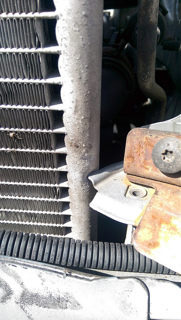

Bent bumper bracket
Bent it back with some pliers and all is good. Slight wing damage too but all repairable :smile:

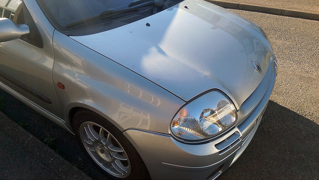

Here's how it looks on the front end.

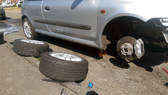

I also had my AD08r's fitted too. Will get the car geometry check next weekend.

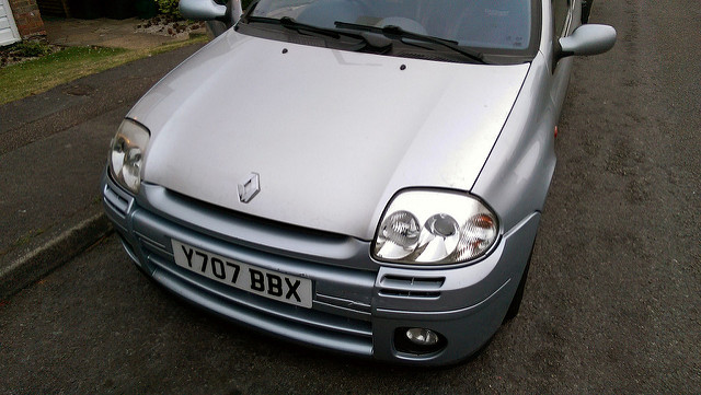

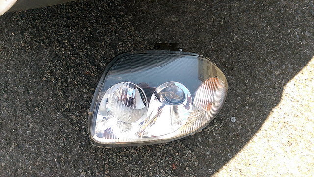

For now i've fitted up the headlights again until i get all my body panels and insurance cheque come through then i'll look into getting it painted. I believe Renault sell the headlights new for £80ish so im thinking of getting them from them. I only need the passengers side and my drivers is in great condition so pointless buying a set. I also keep looking at Momo Team 300mm wheels. My one is crap so i may make another purchase.

You will end up replacing both lights mate.
I thought my old units where mint until i bought my new ones, if you fit 1 new and keep the old one it will look odd and end up pissing you off.
