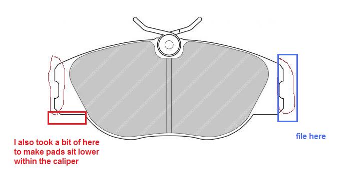

Recently bought some DS2500s and Brembo HC discs. Went to put these in over the weekend and hot a bit of a problem. I can get the pads into the carrier fine (nobbles filed down as per the advice on here), but when I put the caliper back into postiion, I can only secure it at the top or the bottom. Its as if the calliper wont go quite far enough into place. The pads look right (profile of the pads is in line with the profile of the discs)
Any ideas on what Im doing wrong? Had a mate pushing the caliper forwards while I tried to get the 13mm bolt in but could quite get it into position...

hi mate done mine the other week i had the same problem. I filed down (i used a grinder) the edges which are just under the bobbles .The horizontal edge each side if that makes any sense. So that the pads sit lower in the calipers.
^yep fine, just make sure the spring is seated correctly and the piston is all the way in
you did remove the shims yes?
No grinder, so Ill just have to crack on with the file!!
Fred, do you mean the steel things top and bottom of the caliper? If so, they went on the last change...
you must remove the pad shims, i'll post pics of a 6month old DS2500 pad that was fitted with the shims still in place and NO grinding done to the back plate
