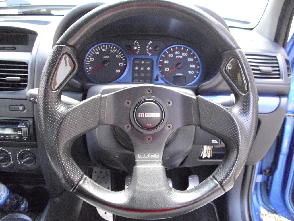

Crazy what an improvement it makes. I still to this day can't understand why Renault didn't fit a smaller one as standard, the OEM one is colossal.
I know. It's one of the best things I've done to the car.
I drove the works van the other week which has the same size wheel as the Clio and it was ridiculous. How I drove round like that for 3 years I'll never know lol.
Nice looking car and the steering wheel looks good too! Makes me want o fit a smaller one to mine.

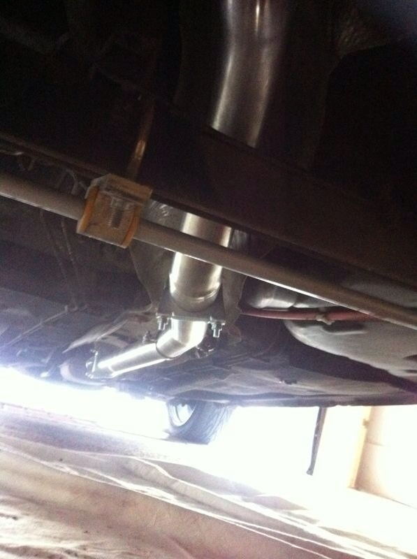

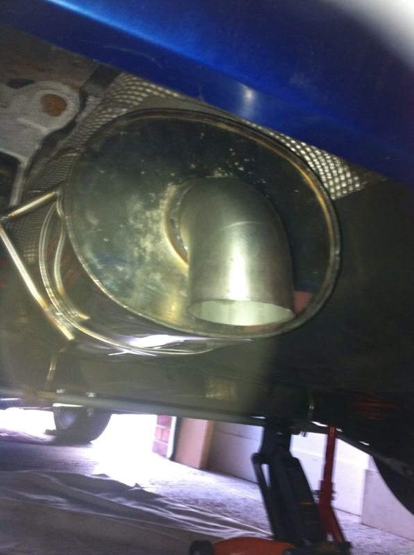

I think the exhaust is alright really, as long as it was re mounted perhaps. After you redo the calipers I reckon you should leave them alone to save any future hassle :p.
Thumbs up.
As long as this paint I bought is up to the job and doesn't melt they will be left alone.

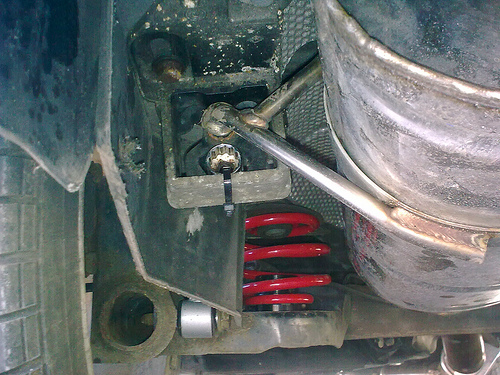

Llandow yeh I seriously need to look into a new mount. The exhaust place I took it too on,y remounted it with a brand new mount 2 months ago maybe and it's failed already. Not good.
Sheila’s’ Wheels’
  Whichever has fuel
Lay under the car (or me?) and push the exhaust up as high as you can.
Get the biggest socket you can in the mount. I used an old spark plug socket. Cable tie the socket in place.
Works a treat and won't fail like the rubber crap.

Im not sure how lying under you would help me get my exhaust straight lol.
Both ways you'll end up with hot useless gas fired in your general direction. Stick with the car at least that wont drop semen and sweat on you too.

thats what i thought but i thought id double check. im also guessing its the 320mm and not the 350mm? was it hard to fit with the boss and how did you get pass the airbag light?
cheers, mark
Err, I'm not sure on size or how hard it was to fit the boss as Si did it for me.
It looked pretty simple though. Theres a couple of resistors put in two of the plugs to stop the airbag light coming on.

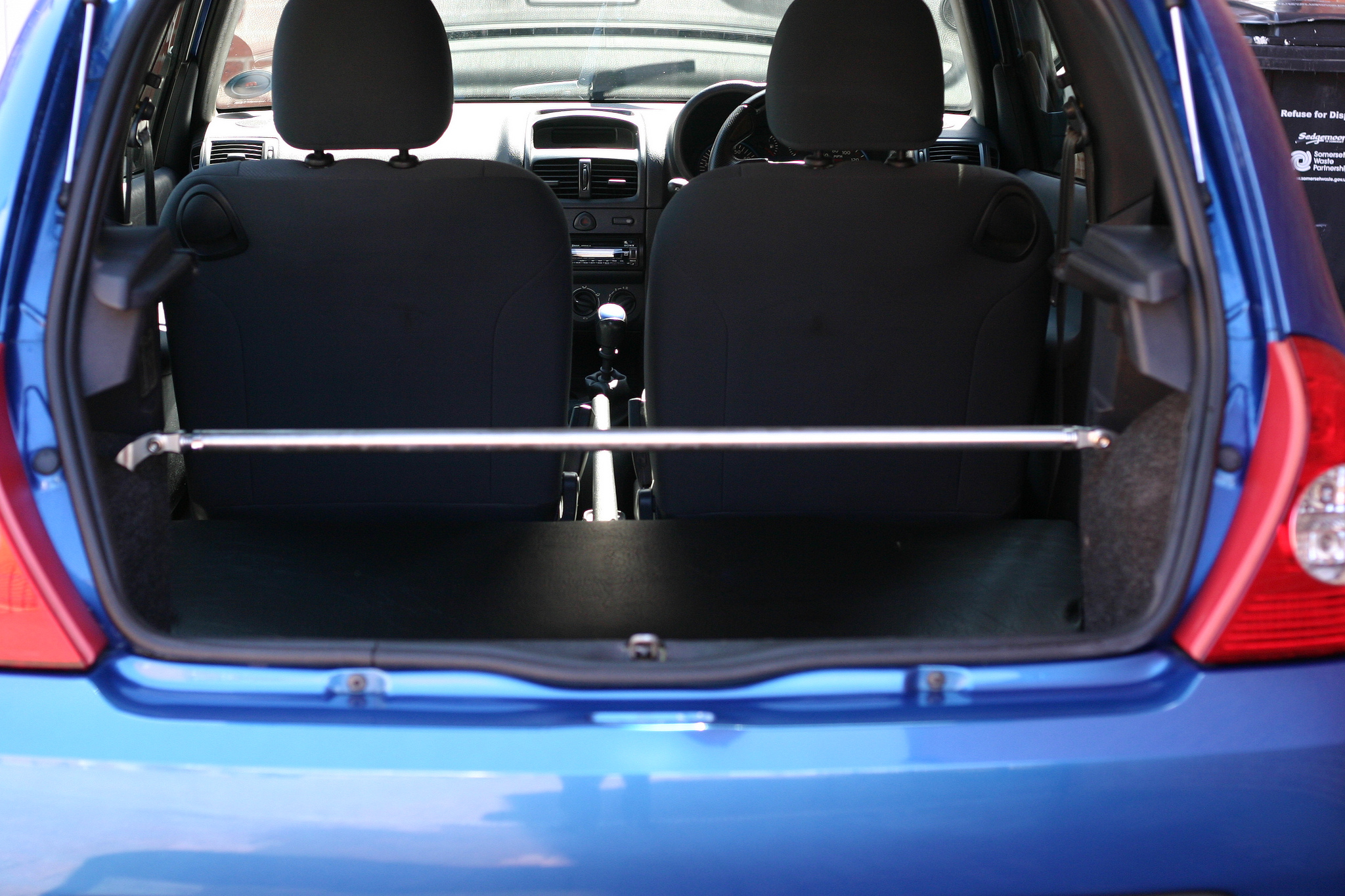

Nice write up and good pictures, close call at Oulton Park I nearly lost it at the same bend two weeks back just came in far too fast and nearly lost it going in. Personally if your going to do alot of track days I'd bin off the sub and rear bench and save the weight as you'll find the car will handle better. Just one question have you noticed alot of difference with the rear arb and what setting do you have it on?
The sub and rear seats come out on trackways anyway. I would be a bit of a lemon if I didn't take the sub out for trackdays really ;). Plus I need the room for my wheels and tools etc.
The arb is probably one of the best things I've put on the car. Especially on the track the car is a lot less lairy on the back end. I've only got it on the softer setting and yet to try the harder setting as yet buy I think it still makes a lot of difference on the softer setting.

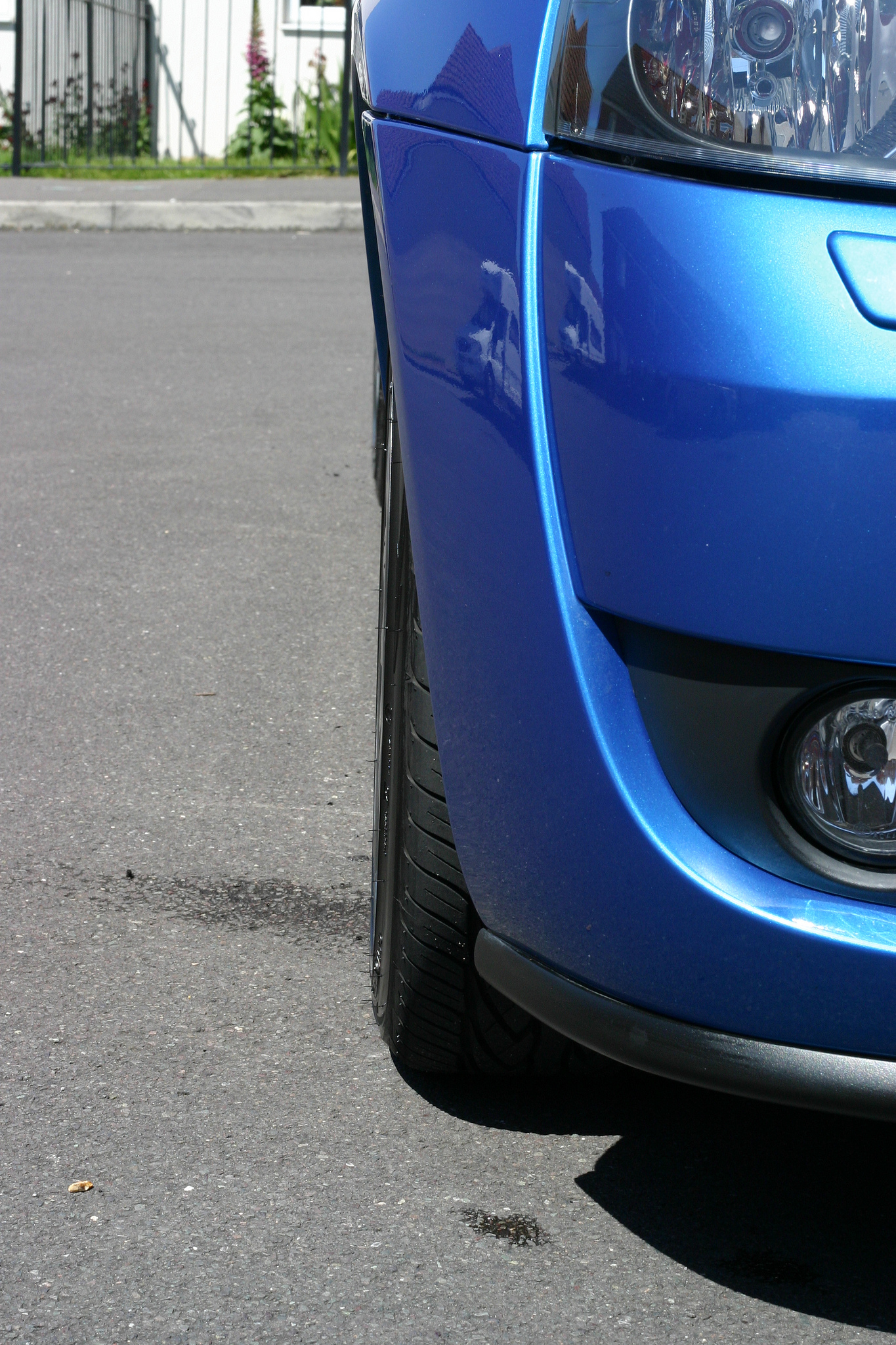

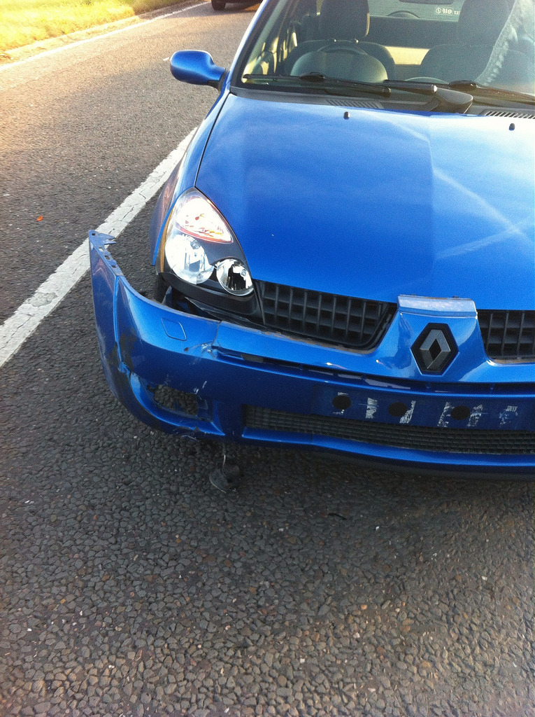

Untitled by Emma_Williams, on Flickr
I had a slight incident with a motorbike. Its safe to say I was gutted and I expected it to be written off. But thankfully £2400 of repairs later I got it back.
It needed and new bumper, headlight, foglight, splitter, arch liner,wing respray, and slam panel.

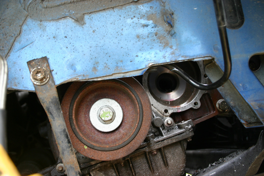

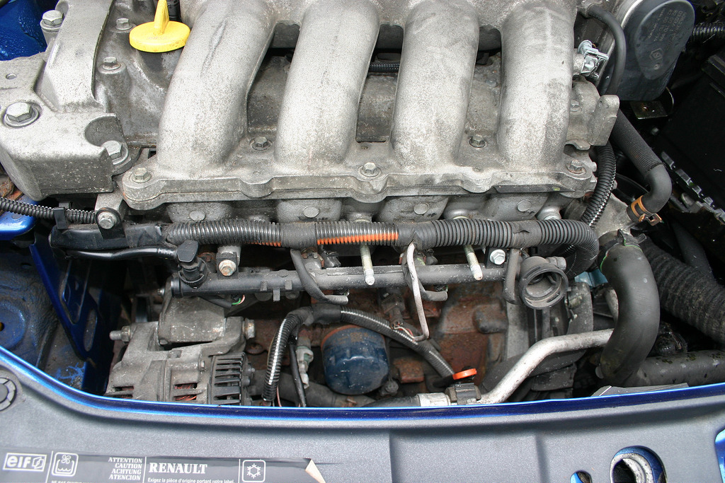

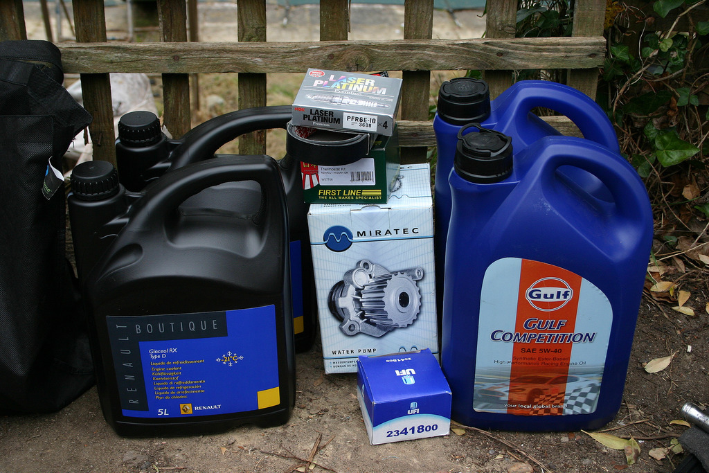

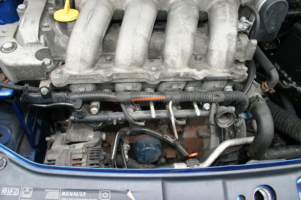

Next on the list was a service. So I treated the Cup to new front tyres, new oil, new spark plugs, new coolant and a new water pump.
IMG_0049 by Emma_Williams, on Flickr
Water pump out
IMG_0050 by Emma_Williams, on Flickr
New coolant
IMG_0057 by Emma_Williams, on Flickr
Access to oil filter
IMG_0055 by Emma_Williams, on Flickr

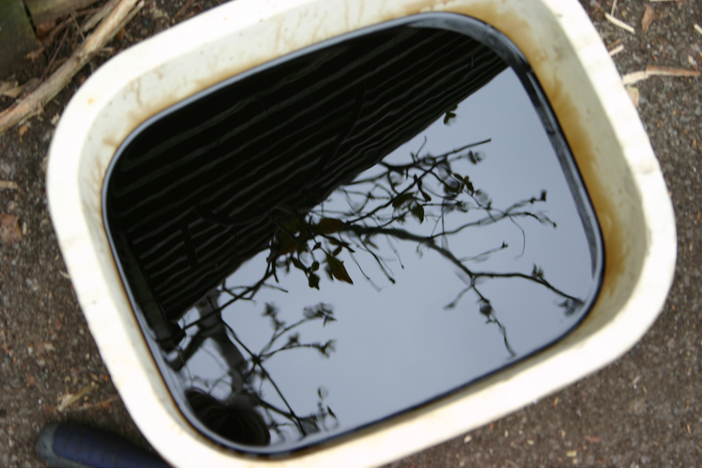

Some lovely used oil
IMG_0058 by Emma_Williams, on Flickr
The car run much smoother after the spark plug change, and my old waterpump was on its way out so a much needed service was done.

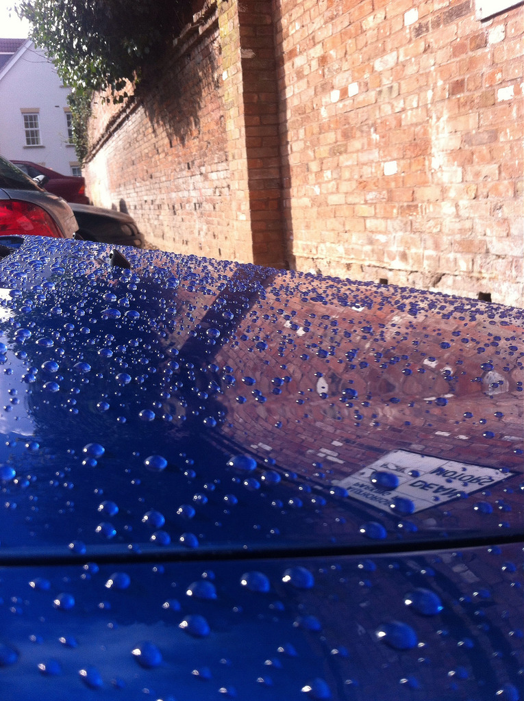

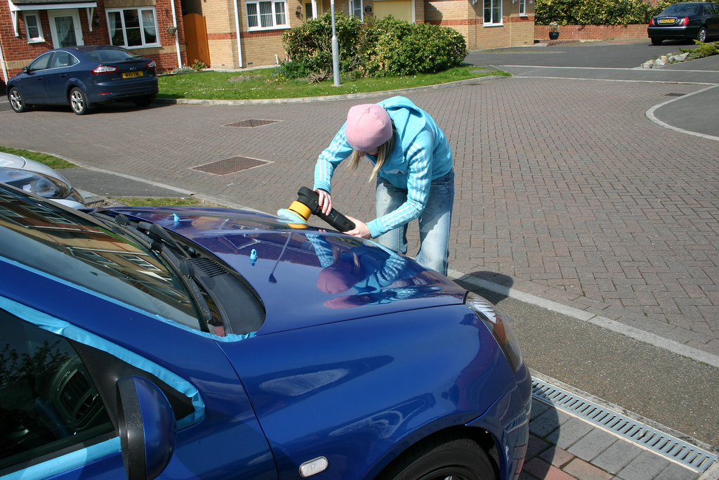

Next was detailing time, I was in a piss that morning, so there is a significant lack of photos lol
Me hard at work
IMG_0063 by Emma_Williams, on Flickr
IMG_0064 by Emma_Williams, on Flickr

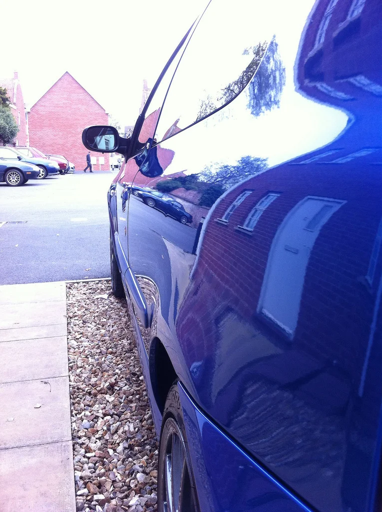

Some lovely early morning beading

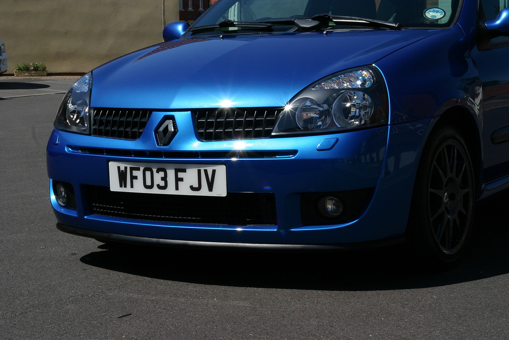

So as some may of spotted

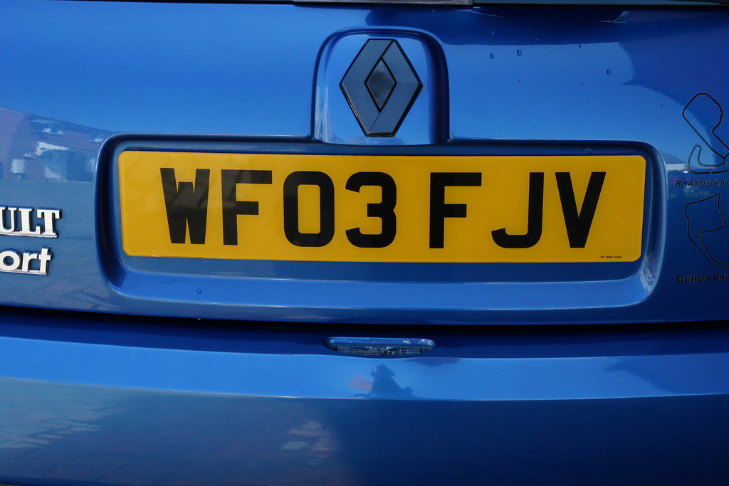

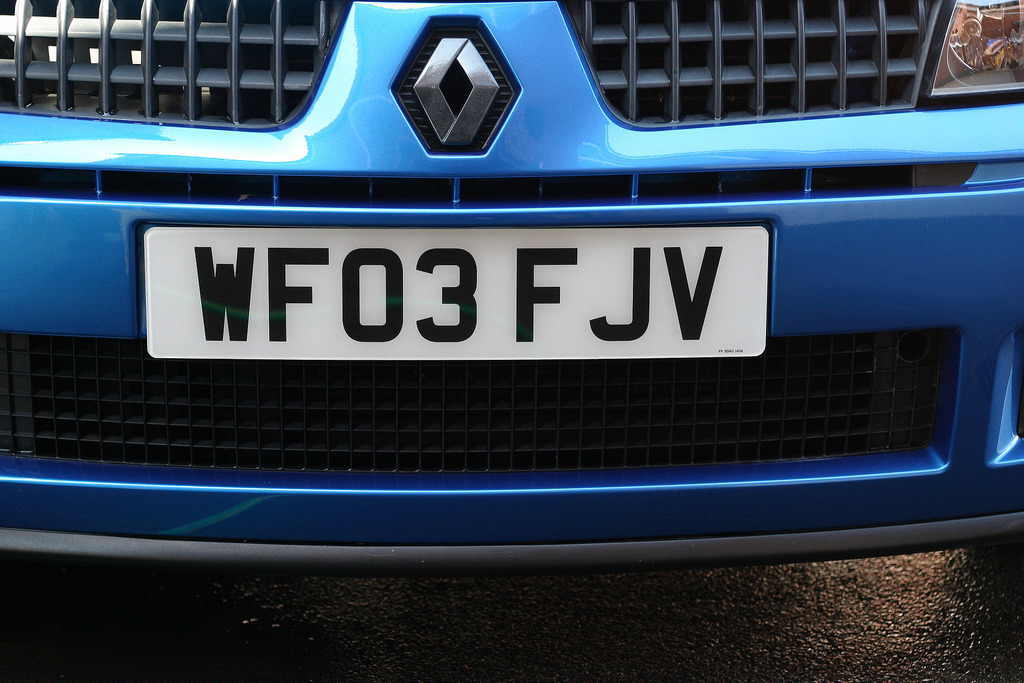

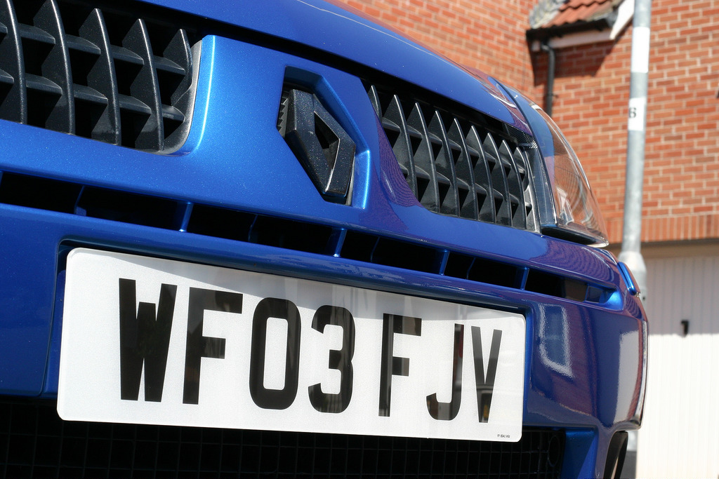

New Plates
IMG_0022 by Emma_Williams, on Flickr
IMG_0024 by Emma_Williams, on Flickr
My old plates had to be replaced as the front one had cracked during the accident and water had started to get in, so on went CS approved plates.

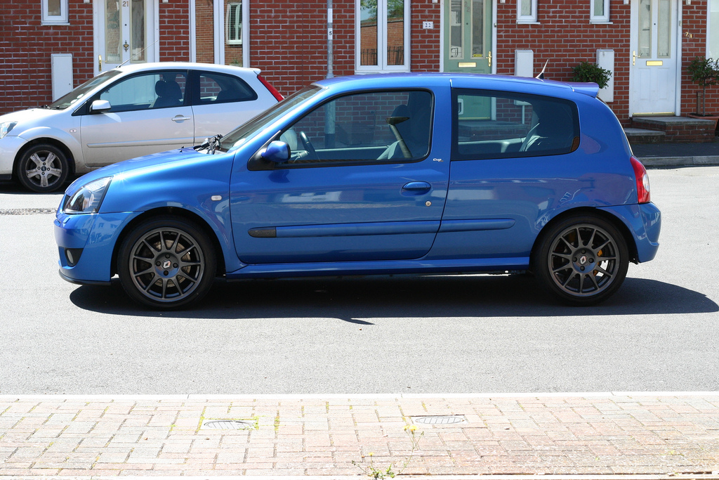

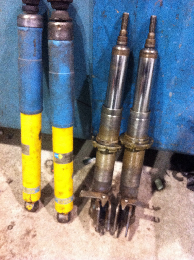

Bilstein B14's
Oh my god they are absolutely awesome. I think the first time I gave them some stick actually said to myself wow.

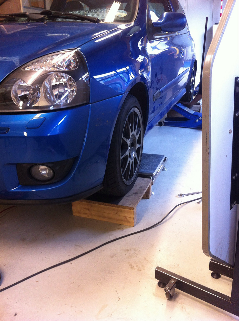

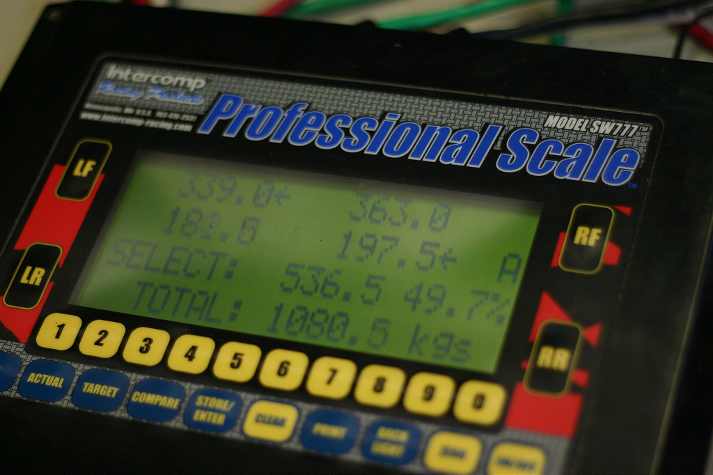

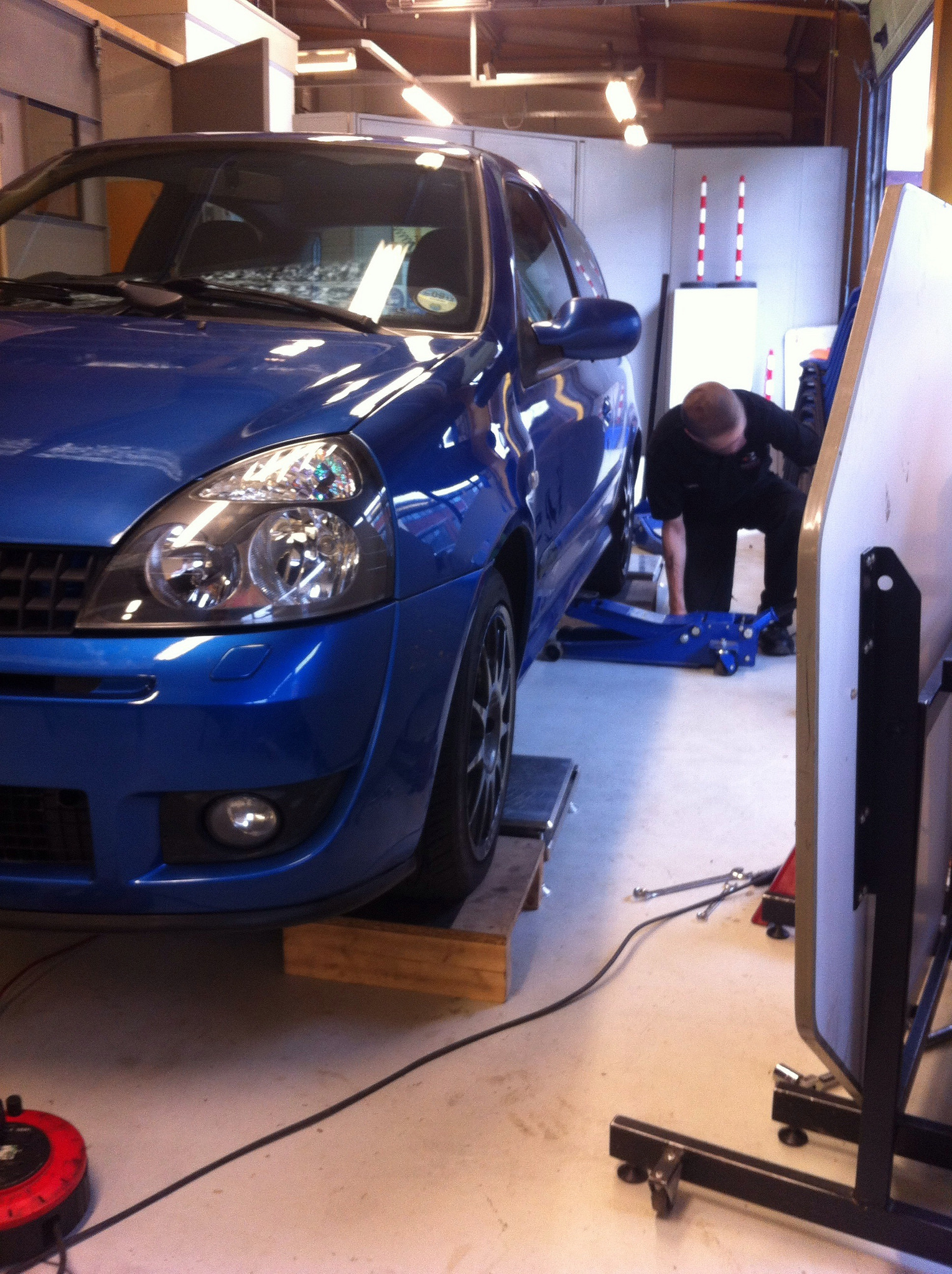

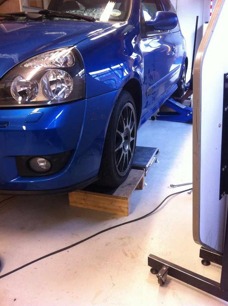

Also had the car corner weighted and set up properly by the motorsport division of Bridgwater College.
So now it's running negative 1.8 of camber on the front
3.5 toe out at the front, 2.5 toe in at the rear
Ride heights are
Front offside - 616mm
Rear offside - 604mm
Front nearside - 620mm
Rear nearside - 598mm
Weights
Front offside - 363kg
Rear offside - 197.5kg
Front nearside - 339kg
Rear nearside - 181.5kg
Basically the car is only out by 0.3%.
Total weight of the car with me inside (56kg) and half a tank of fuel was 1080.5kg so I'm not far off the 1 tonne mark really.

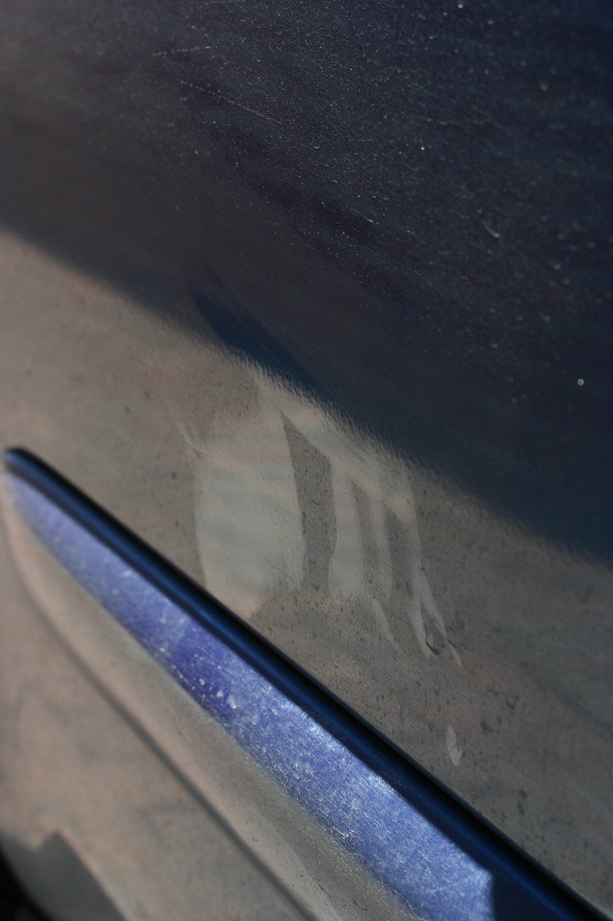

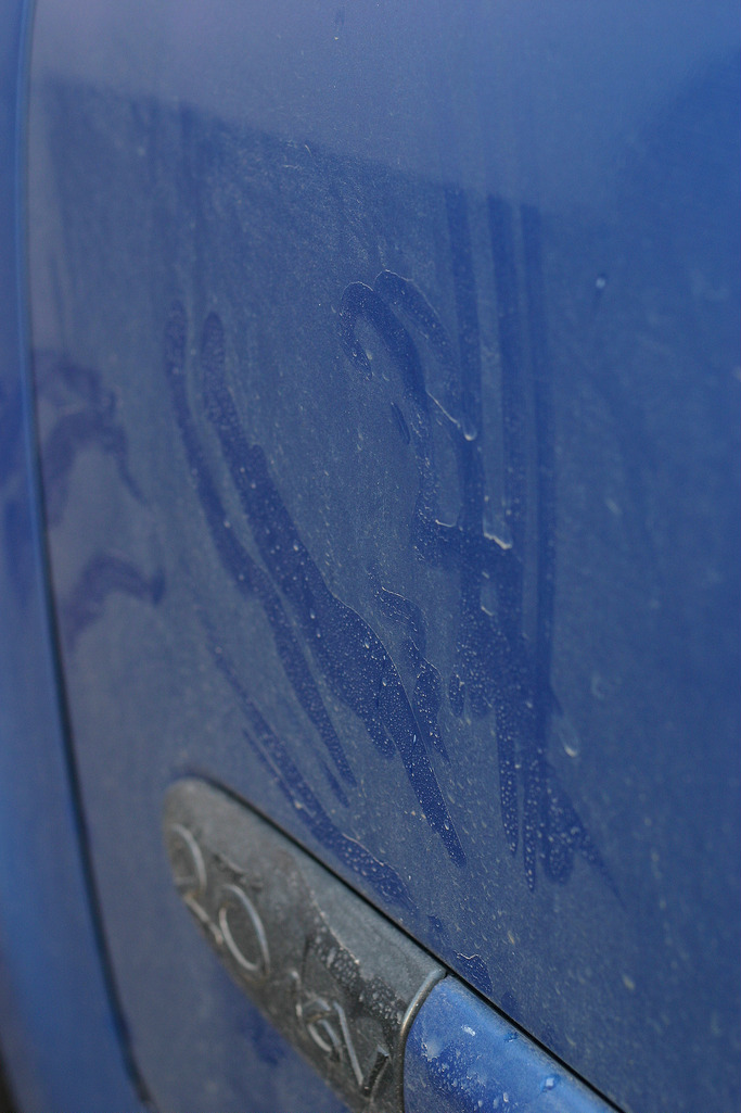

So as the sun was out yesterday I thought I'd give the car a good clean
Before pics
IMG_0015 by Emma_Williams, on Flickr
IMG_0014 by Emma_Williams, on Flickr
IMG_0013 by Emma_Williams, on Flickr
IMG_0012 by Emma_Williams, on Flickr
IMG_0011 by Emma_Williams, on Flickr
IMG_0010 by Emma_Williams, on Flickr
IMG_0008 by Emma_Williams, on Flickr
IMG_0007 by Emma_Williams, on Flickr
IMG_0006 by Emma_Williams, on Flickr
IMG_0005 by Emma_Williams, on Flickr
Basically the car was minging. Hasn't been washed since it was detailed due to weather.
