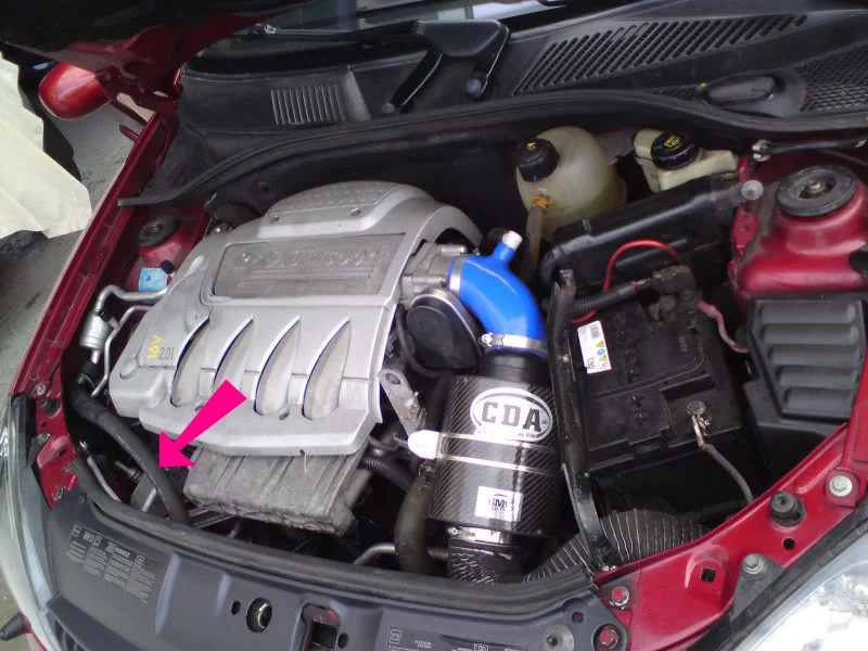

Cheers Mark123, I will try this tonight and let you know how I get on, also get some photo's on here may help people understand
I have an engine bay pic on here and been able to highlight the pip im trying to describe, it goes down the front ofthe grill as a metal pipe
I thought it was, it sparked when you try and put it back where should be. So I need a new one of these as the pipe has snapped at join but now it doesnt spark but also the engine doesnt turn over, so maybe its blown something somewhere.
I have a Ac pipe on its way so should have that fitted in a few days. If before I disconnected the battery and just placed this where it should be and got the engine to start sont it now. Is it earthing, Any ideas on what to do to eliminate now. Have power, xenons work etc.
