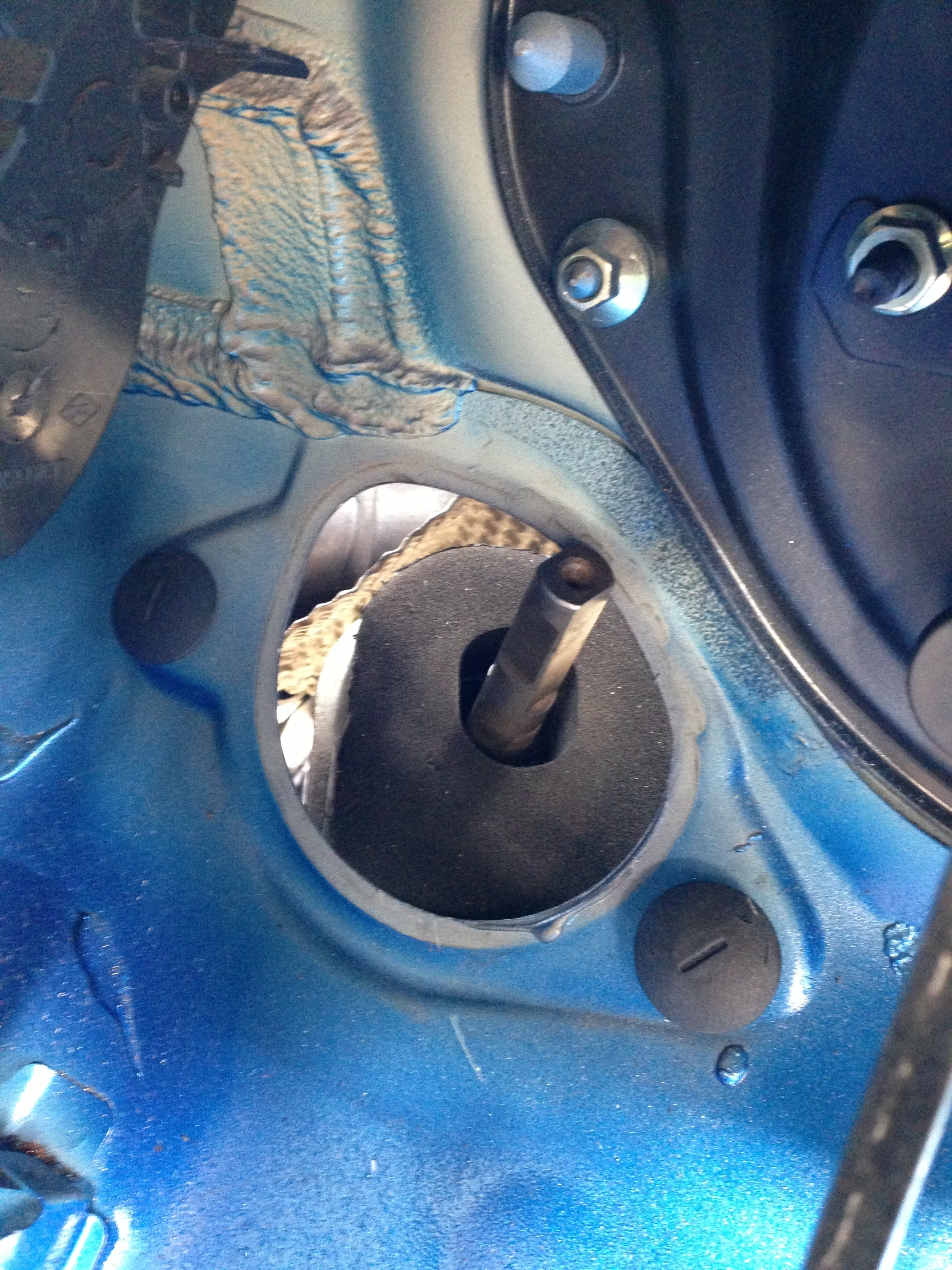

Phil you have removed the metal rack mounts that go to the subframe from the std rack haven't you? The twingo rack should bolt straight to the subframe. Where doesn't it fit? :)
It does bolt straight to the subframe but the pinion comes through virtually touching the top of the metal hole in the bulkhead
I'd have to grind an inch or two out the top of it for clearance
Also the steering column is about 3-4" too long to connect to the pinion and despite it looking telescopic I can't shorten it at all :(

The problem is that it doesn't push up against the bulkhead so the rubber doesn't seal the gap
You can't use the rubber gaiter on the bottom of the steering column either because the pinion doesn't sit in the middle of the hole in the bulkhead
I'm also not sure you can just make the hole bigger because the section above seems to be double skinned
It looks a mile out to me. You'd have to make the hole much bigger in the bulkhead and then no idea how to seal it - you'd probably have to make a blanking plate or you'd have road crap coming up at your feet.

Is the pinion at a completely different angle or something? otherwise everything should work even if you have to chop and sleeve the steering column but I can't see it been needed given that its a collapsable column. Sealing it isn't a big problem, might not look pretty but who's looking!!
It'll fit, just stop being soft!!
LOL
Really?
  Cup In bits
All your needing is some angled shims to bolt in between the rack and subframe by the looks of it. It might be too much work for yourself but looks more than possible if the pinion connection types and the rack mountings are the same which was my worry before.
Once you fit shims it will bring the pinion more central to the bulkhead hole and then you can use a piece of 3mm rubber with a hole for the pinion and then screw it to the bulkhead?!?

What's the best way to seal the hole I now have where the column goes through?
Would a 3mm bit of rubber with a hole cut in the middle work or is that likely to squeek and crack and split?
Do I need to make a metal plate with some sort of bush or something in the middle?
NorthloopCup
You just use the original rubber boot that comes with an epas column?? Or am I missing something here?
Oh yeah I could just buy an entire column with the rubber on again lol DOH

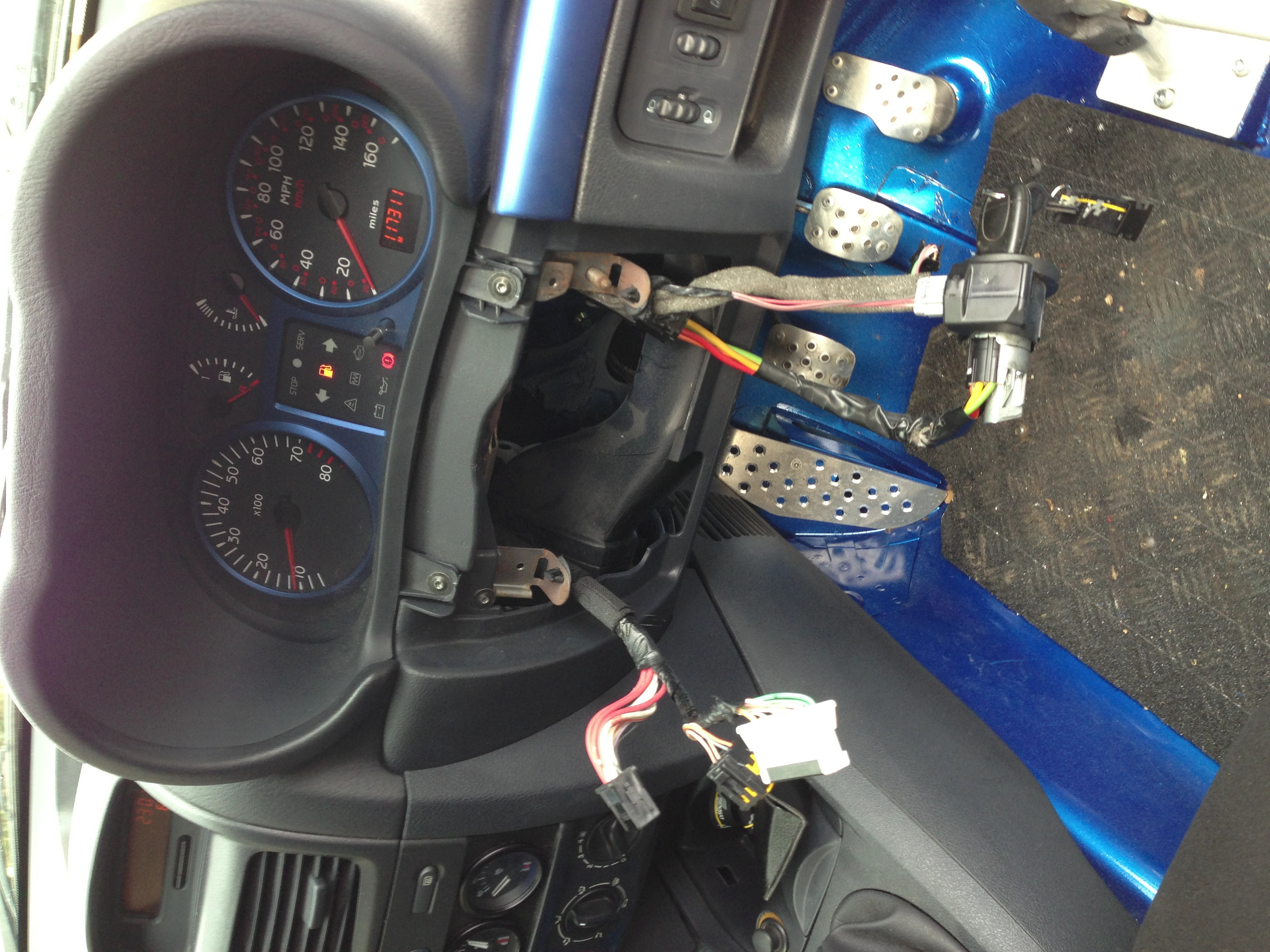

I was thinking I was just buying the top part - but I think now I'm gonna have to remove the whole dash and fit the entire column/shaft/rubber etc..
Found an epas column (full) with rubber gaitor, and ecu for £50 in Doncaster
Renparts seems to have a load of 1.2/dci racks in stock for around £30 and they're near doncaster
So gonna go do a run out tomorrow morning and try to get all the bits in one go :)
NorthloopCup
Make sure you definitely buy a complete column and lower shaft mate!! You can't split the original non epas column lower shaft. I made this mistake but luckily for me I found a lower shaft on eBay for £10!
Epas column splits in 2 btw, so you put the lower half in first, then the top half. That's how I did mine.
Ahhhhhhhh thanks mate
I assumed the lower part of the shaft would split from the upper - so was just going to buy an upper section
So you undo the bolts on the top part of the column and then pull the entire column/shaft/gaitor the lot up through the dash?
Spot on!!!
5 minutes, 5 bolts - and it's out haha

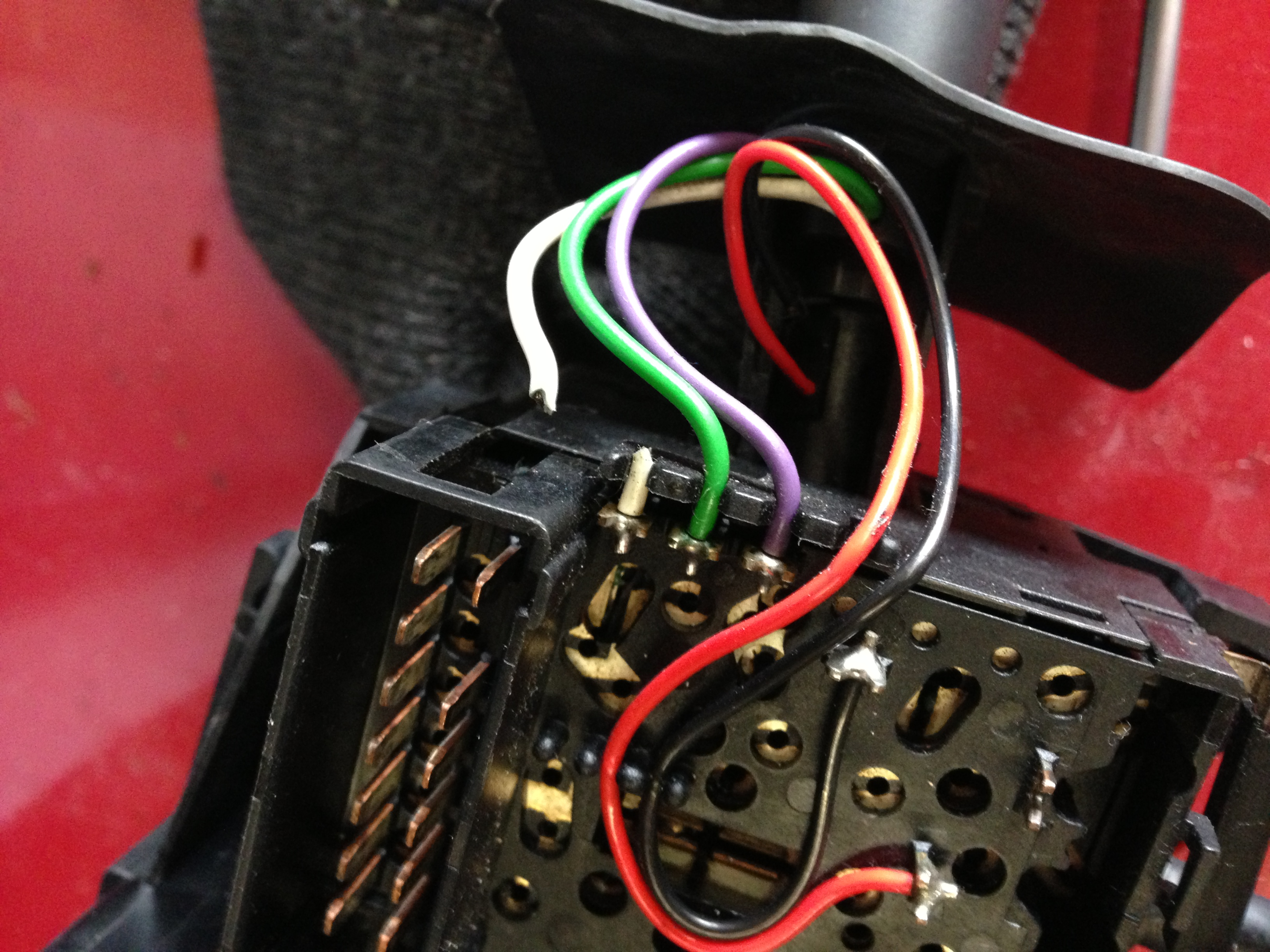

Also does anyone know what the white wire on a ph1 light/horn stalk does?
Mine appears to have snapped but I hadn't noticed anything not working so wondering if it's front fogs or something I haven't got
I have absolutely no idea LOL so many conflicting threads on here

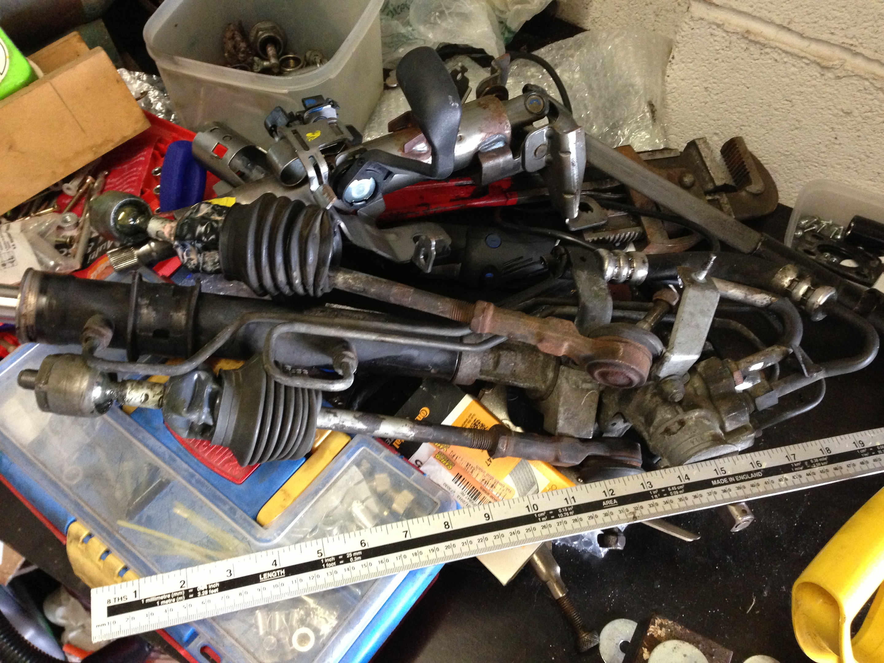

But I'm gonna go try it at renparts - at least I can get a few racks out and try turning them all
I read a thread on here from 2009 where a guy insisted that the 1.2/dci racks that use EPAS as standard are still only 3 turns lock-to-lock, it's the manual non-PAS racks that are longer - I personallydoubt this - I'm sure the cup rack will be quicker just purely due to it being a sportier model.
BUT the Clio rack won't go back on without re-dropping the subframe which is a nightmare, the basic racks like the twingo/dci ones just slide in from the side as they are much smaller/lighter - and I read a lot of people using DCi racks on their track cars a few years back including markcup etc... (http://www.cliosport.net/forum/showthread.php?358181-Clio-dci-steering-rack-for-Cup-what-year-make) so it must be ok on track..
Markcup even ran his without any assistance at all (manly arms)
So I figure i'll give it a go :)
