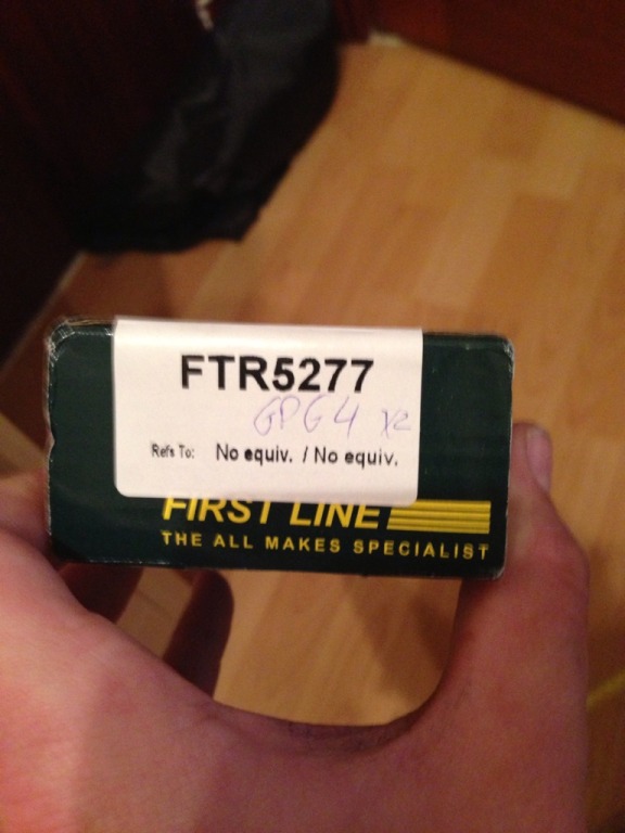

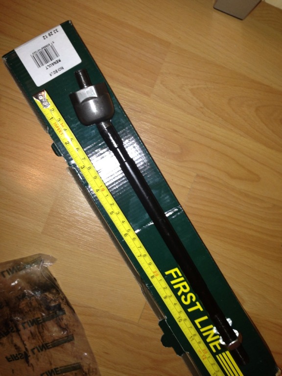

Got this tie rod in front of me, perfect copy part for the 172 cup. Not the best make being Firstline but okay for iirc £13 from micksgarage.com

Thanks for the part number - I can't make my mind up whether to fit some cheap pattern inner tie rods considering how much of an ass they are to replace or whether to just bite the bullet and get renault ones from wests...
