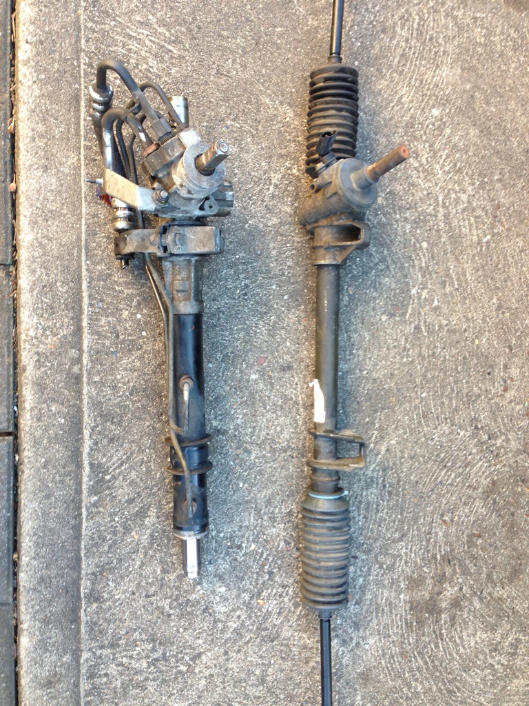

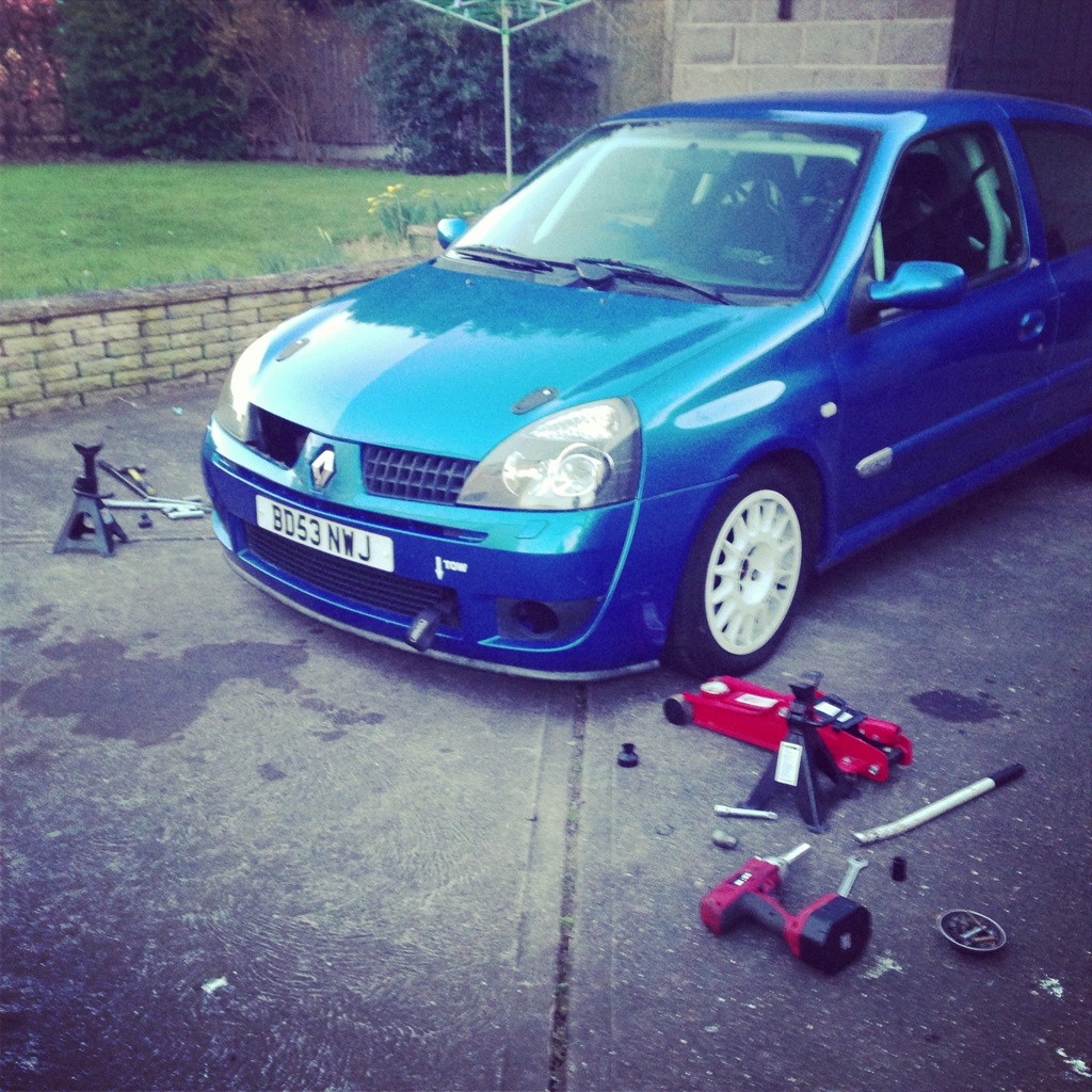

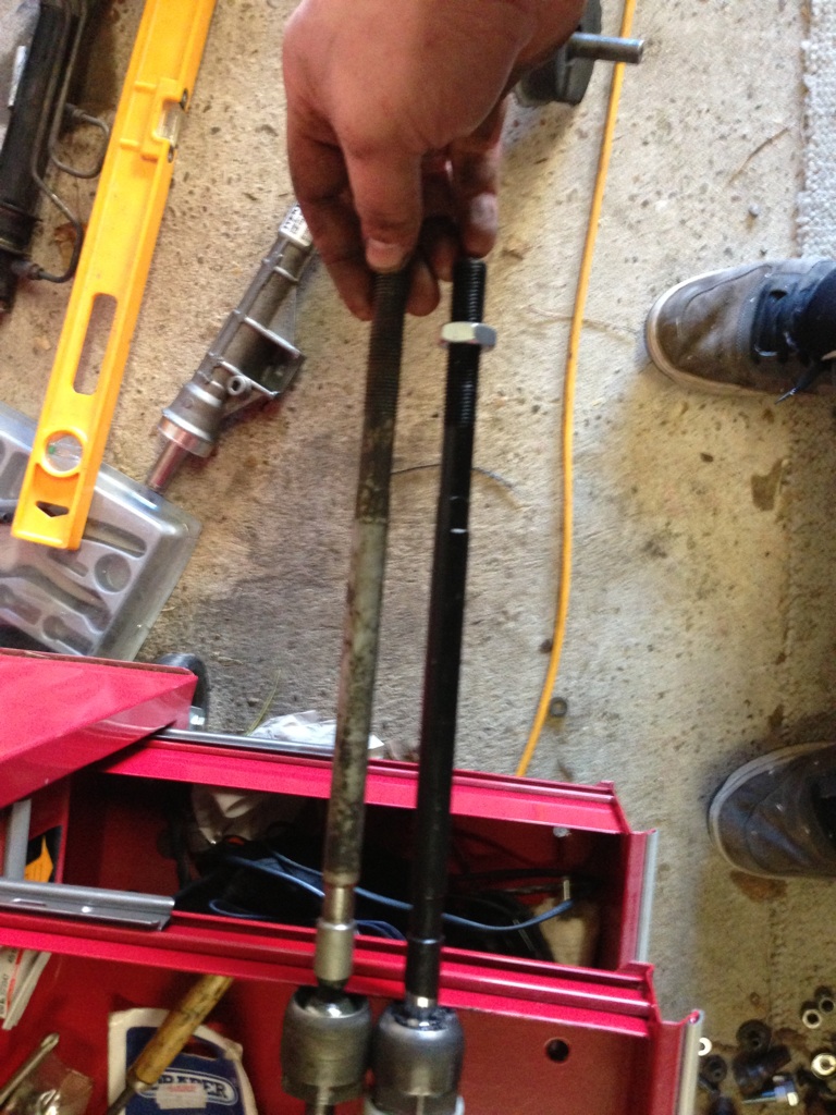

GSF got the right tie rods in for me - and thanks to Swede Cup on CS they're exactly right for the cup

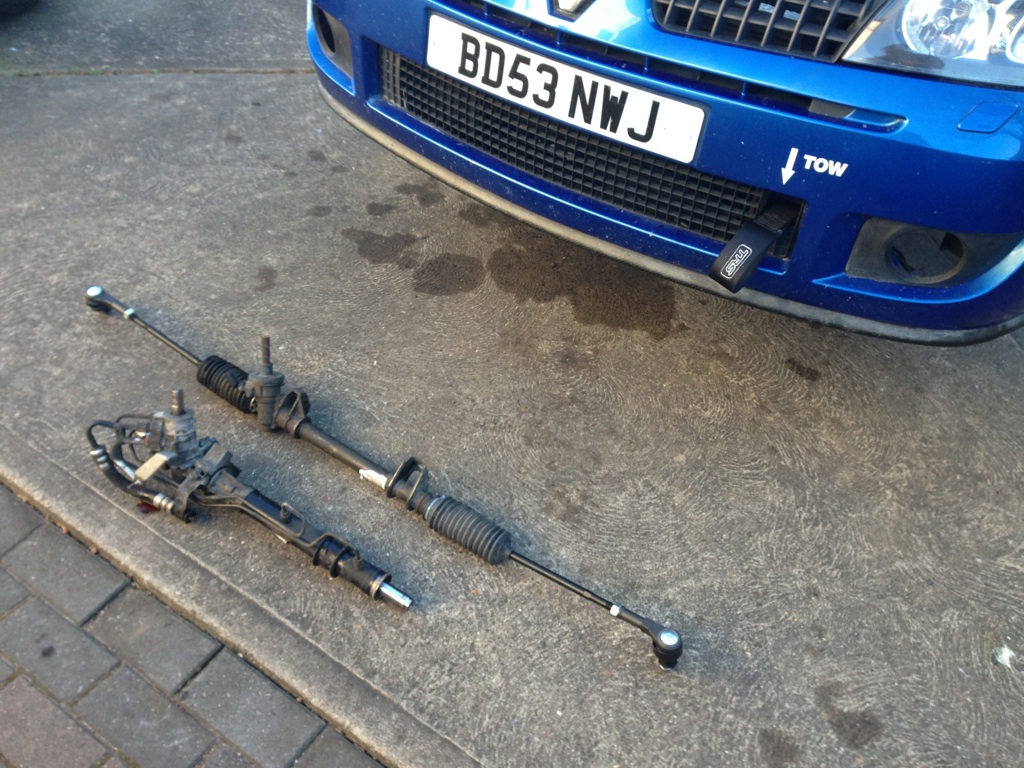

Fitted those to the rack last night, fitted the new track rod ends to the same position as on the old rack so hopefully that'll be "ok" to get me going until I can get the geometry setup properly
Rack fitted to the car, lengthened the column as it was a bit short for some reason, connected it all up, re-torqued the subframe and engine/gearbox mounts etc.. all back up and jobs a good un
Pushed the car back into the garage with Leah trying to steer and my god it's hard to turn at walking pace LOL
Best news is though the clonking noise I had when you wiggle the steering wheel left and right while parked up is completely gone - so job well done in my books :D
Few crappy phone pictures...

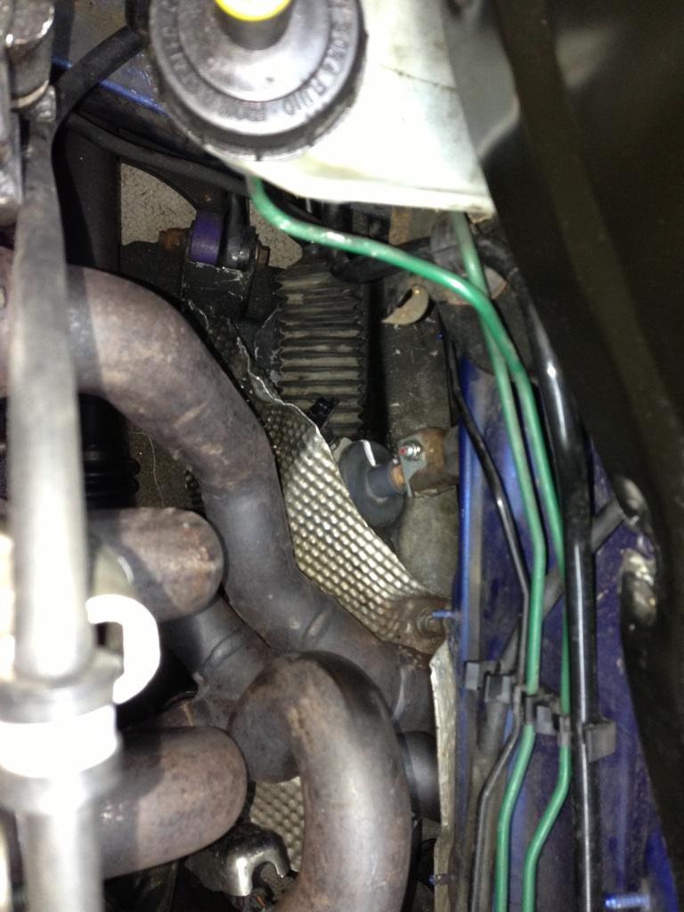

The hardest work is removing the standard 172 rack - the PAS pipes are bolted to the block all over the place and are very difficult to get out
I ended up just cutting them into pieces as I knew I wasn't going back to the old PAS system lol

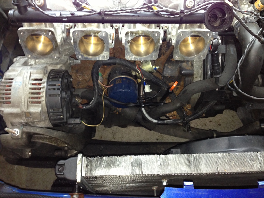

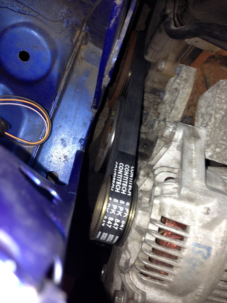

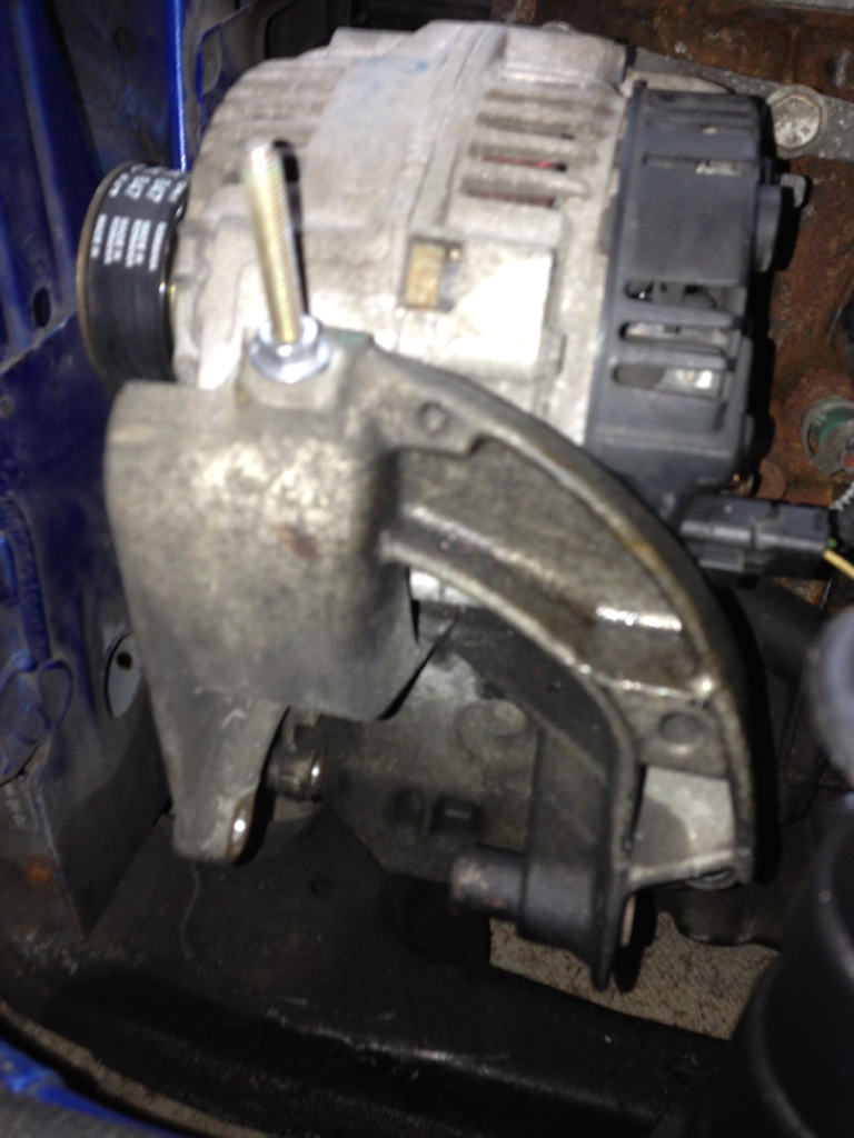

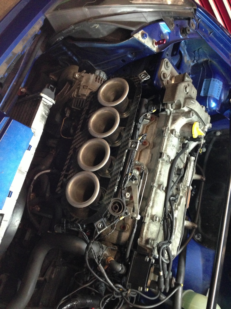

I got a replacement tensioner bolt for my alternator last night (mine snapped while I was trying to tension it) so got the engine all back together and running.
Took a few iPhone pics
New shorter alternator belt (thanks James/Northloop for the part number :D) -
Bye bye PAS pump -
No more pipework means oil filter changes are gonna be much easier LOL -

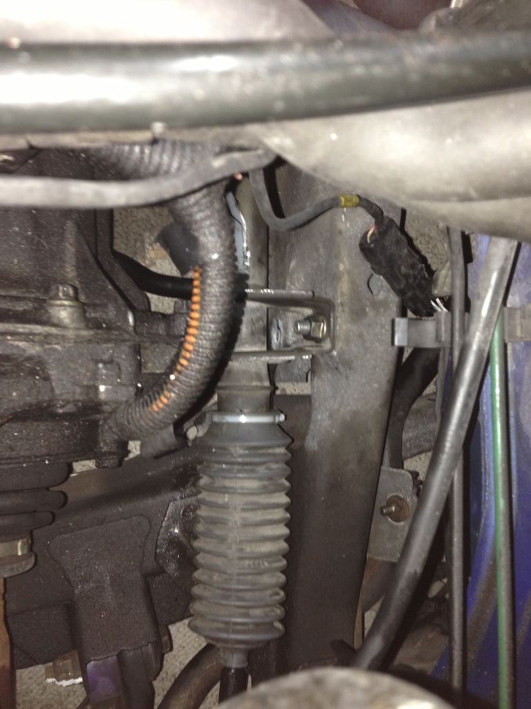

Terrible pictures of how the new rack mounts -
And all back up and running :D
