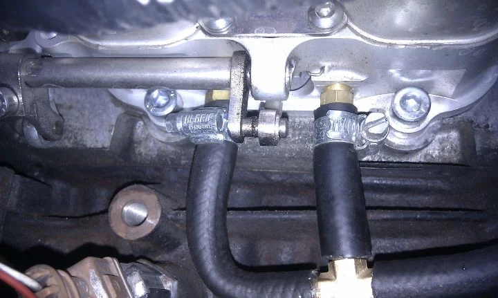

worst linkages known to man, which get in the way of absolutely every bolt during fitting, making them un-necessarily difficult to use. They're also exceptionally hard to balance, the screws are inaccesible
They're badly thought out, the ports are smaller than the standard port, and the material is very thin, so highly restrict any further port work.
injectors are too close to the head, and the longest available runners are still too short, and too narrow. The butterfly is also only equivalent to a 40mm round one on cross sectional area.
  DON'T SEND ME PM'S!!
oh and almost impossible to add good brake servo vacuum take-offs without restricting throttle movement. I bet you have a bit of fuel hose lashed on like this....

All of which resulted to 207bhp on the dyno up from pre fitted 178bhp. Most of what you described relates to fitting and setting the kit up, unless the chap in question plans to do the job himself this is why he'll pay good money for a professional to do the work. They'll still work and perform just as good for the customer, anyone who wishes to test their crudentials is more than welcome to a passenger ride, then you can see they are far from 'horrible'.
