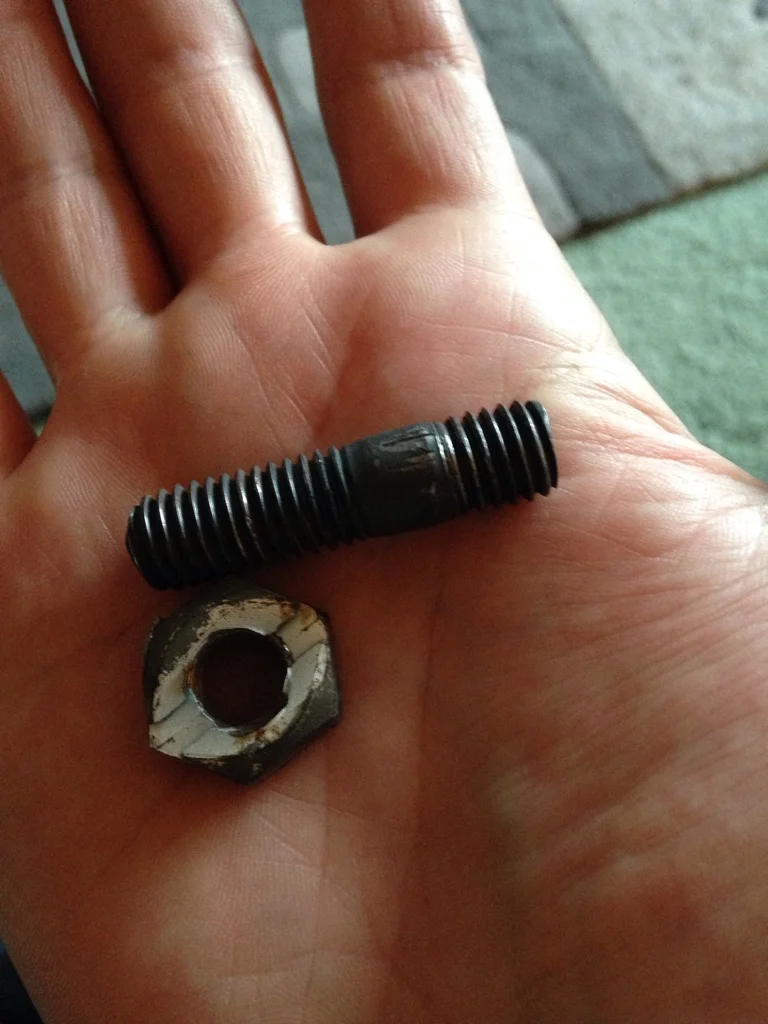

I've emailed him [emoji5]️ the other bits I could get done local at a push. Will see what Chris can do though, need help with the studs if possible mate [emoji85] they keep coming loose, got the right nuts now. But ideally need some tomorrow as I'm carless now.
These look alright? Shake when in the manifold so should I just get the same but better quality?

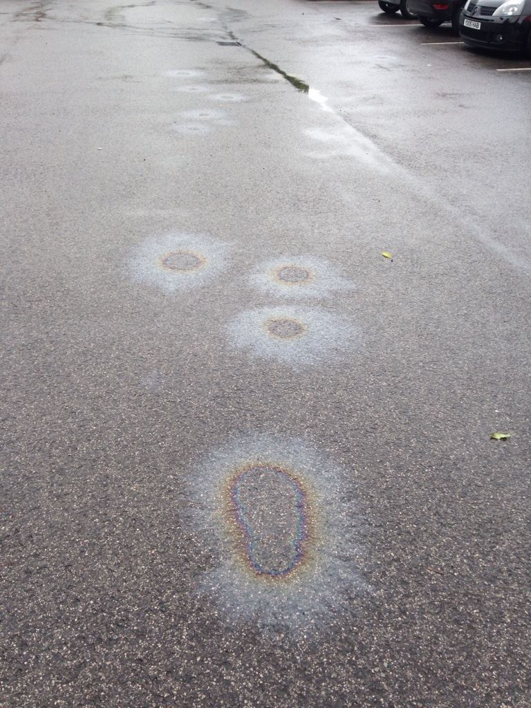

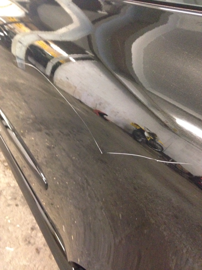

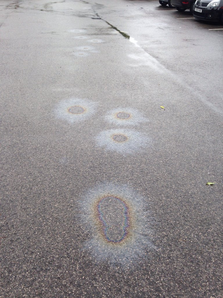

So pissed off of recent, seems like I can't get anything sorted with the car! Had it in for the oil leak and guess what's still here! Can't be hard surely to sort a decent oil return. And some fecker keyed my car too! And still trying to sort other things [emoji30] anyone want to buy it? Ha

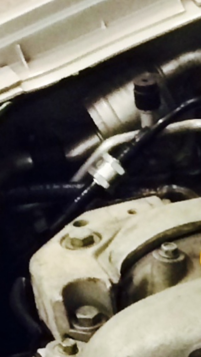

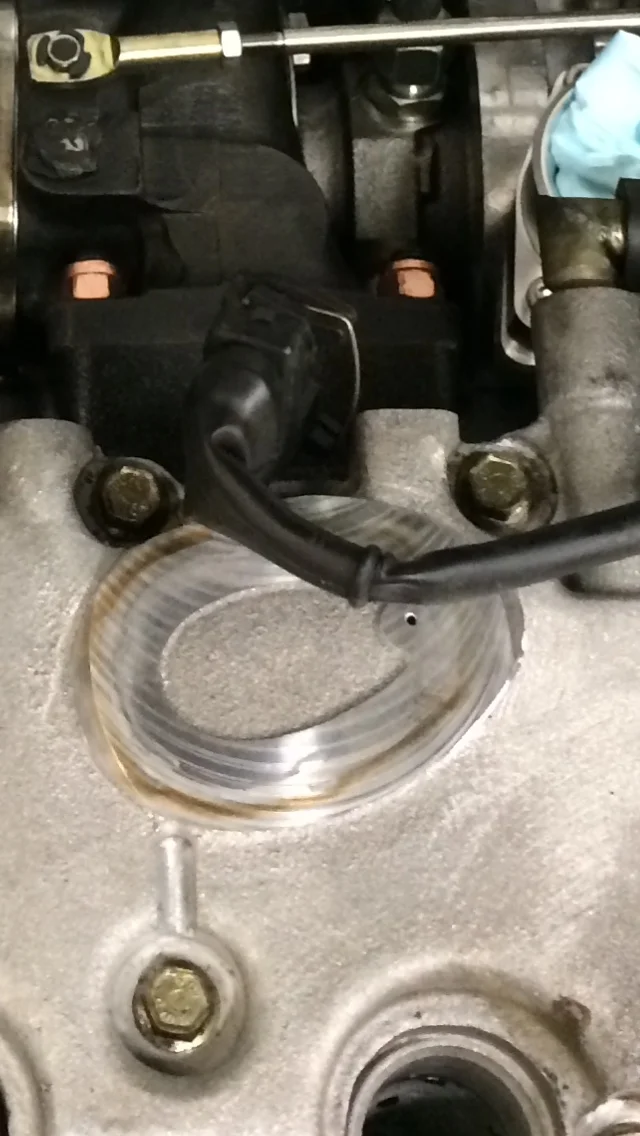

Can't play your vid all the way for some reason, got as far as the air duct pipe for inlet pipe and it stops [emoji23] have you got a one way valve on the carbon canister vacuum pipe? Also under the inlet manifold there is a tiny bleed hole into the cam cover that should be blocked to stop boost getting in the breather system..
Hmm strange plays the full 30 secs for me. I have no idea mate [emoji85] would that be what the bit if tube with a bolt in the end is for? And I can only assume that the bleed hole would still be open. I can't see things being done as they should. Guess it was the first 183 they had done [emoji15]

Sounds like you have had some ups and dpwns, and some people are just.... for keying your car, looking good apart from that though, glad your not letting all the bad things put you off your clio :)
