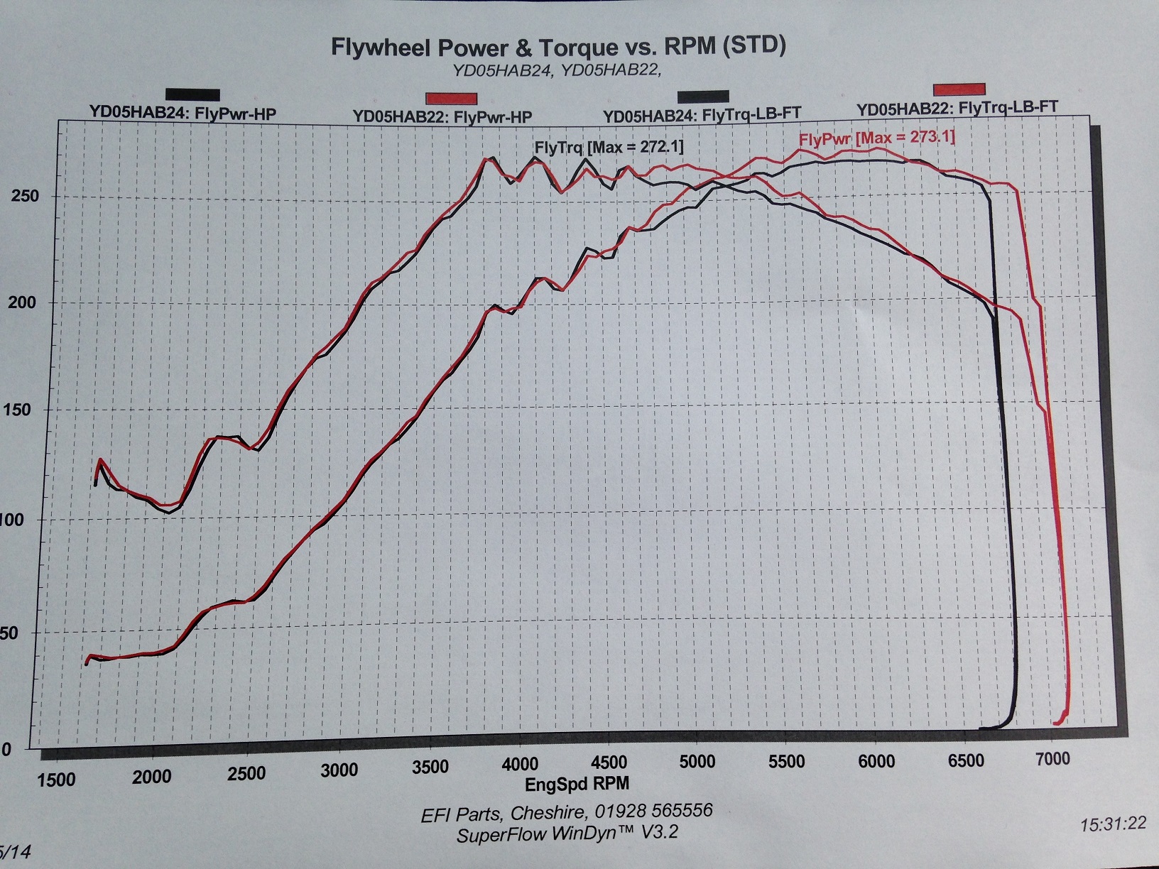

Well today was mapping day! I went to EFI really fed up with the car, oil leaks and noises still lingering and just not enjoying driving the car at all really.
Things didn't go so smoothly but I didn't think they would with the luck I've had. Getting the electronic boost solenoid to work with the GEN90 was a no, need to try and obtain a wiring diagram from ktec to show which pin is used. So having to stick to manual boost for now, Chris quickly sorted out the map as it was running far to lean, lets just say I'm lucky my engine is still in one piece :/
It quickly came apparent there was a boost drop off of which id always know but assumed it was down to mapping, Chris swapped a few things round and it showed it was on the boost pipes at only being 2", he welded in a tap after the the intercooler, before the throttle body and supplied some control there so add to the boost restriction. to my surprise 273bhp! Made me smile as I didn't expect that at all.
Chris really did a fantastic job and didn't let the issues stop him from making power, I'm so grateful and the car is far better!

May have missed a few bits, but attached a graph!

2.5" is not needed we make over 320bhp with 2.25"

Pin 88 on gen90 and you need the latest firmware. If cliosport worked yesterday you could of messaged me... Still not the worst result in the world - bags of torque!! Make sure you block that little hole in the breather plate too mate (if it's not already done) you don't want to be blowing out the new crank seal :)
Thanks Andy, just knew they where bigger than 2" and remember seeing a five along the way :)
Cheers Chris, we tried to get on here to find out, down at the wrong time ha. I know at one point I thought 220bhp was to be the max, really chuffed with 273bhp after all its just a GT25 :p
