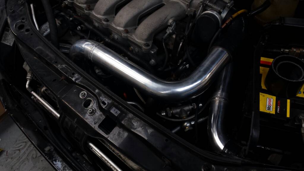

@incy-spider Haha yeh Chris I believed they knew what they was doing 😂 Have some more picture which I feel obliged to share.
@Ade182 Yeh mate it's that company, have a big list off things that were done s**t. and a yes to the Adaptronic too can't wait to use cruise control :) Andy has committed a lot of time and hard work to making sure my car is how it should be, how he hasn't given up and sent it back I don't know but I know he's doing a sterling job and I owe him big time!
Go on, could do with a laugh!!
There's some shocking things
Clutch cable melted due to poor heat shielding!
No auxiliary belt idler and loose tensioner bolt.
Kinks in cooling pipes.
Valeo clutch when paid for an organic!!
182 box replaced with a 172 box with damaged casing.
Spring found in oil filter!
Crank seal covered in red s**t.
Block not tapped properly.
Rocker cover breather hole not blocked.
So many things!!
I know very hard to believe that this standard of work can be taken out in this day and age, but sadly it has!
I'm sure it was laughing followed by crying, maybe he will move on to German cars now 😂

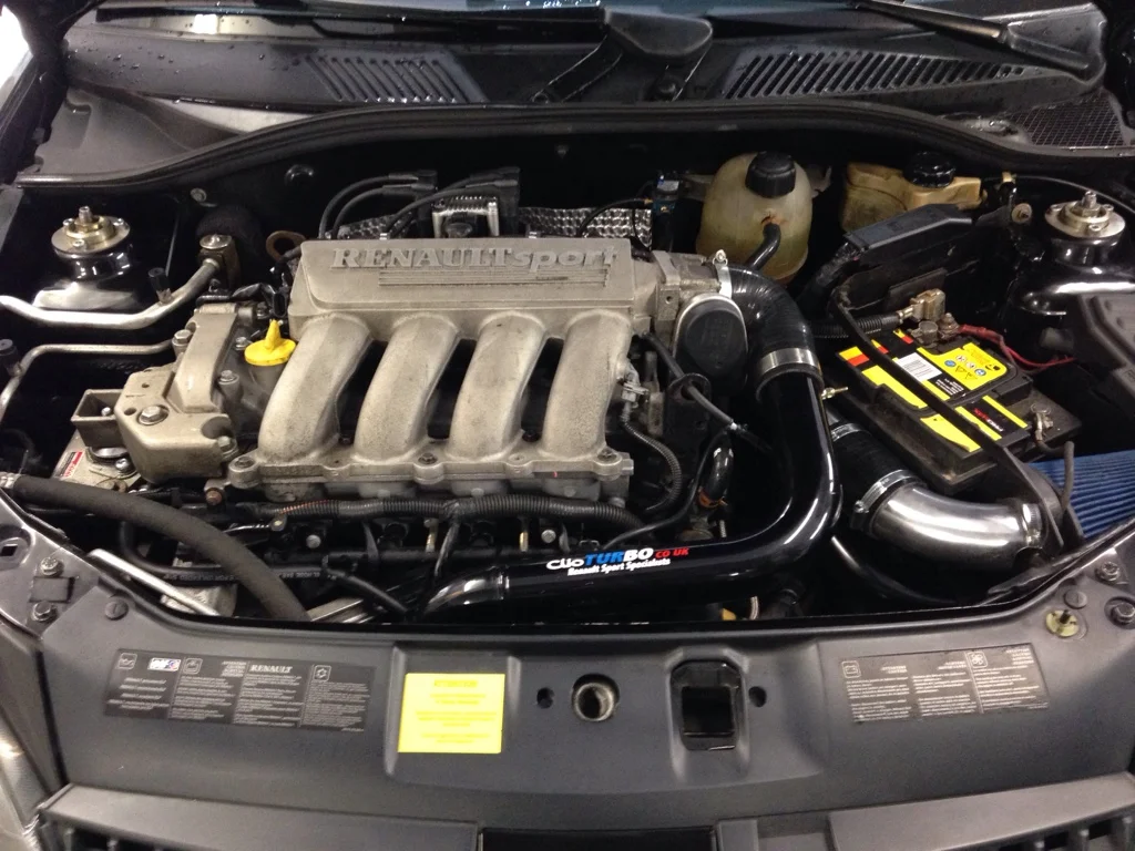

Anyway some good news is new bits fitted:
Adaptronic 420D ECU
Adaptronic coil pack
Nimbus heat shield
Modified fuel pump with fuel return and regulator.
Replacement actuator
Full auxiliary belt kit
Boost pipe kit
Helix organic clutch
This one is my favourite....NO s**t WORK OR OIL LEAKS!!!! :smile:

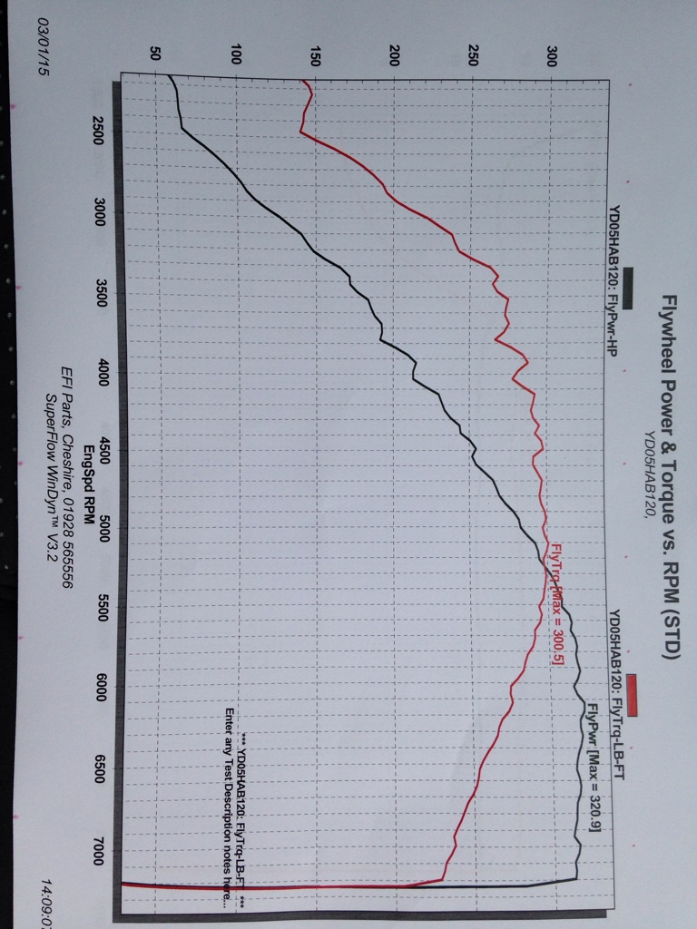

Went for mapping again today after the adaptronic. Got 273bhp last time so only expected to squeeze a few more out maybe 285bhp. Anyway today went extremely well and can only thank both Andrew and Chris for their amazing work [emoji106] the new numbers are more than enough to put a smile on my face [emoji4] I'll let the graph do the talking.
The results was great today, Car pulls like a train now! Thanks a lot for today! Defiantly made my mind up to want my Clio to be turbo.
I'm running the gt 2560(aka gt28r) not the rs disco potato, I'm running 279 bhp iirc, so I only need forge pistons and rods and I could run this power :)
