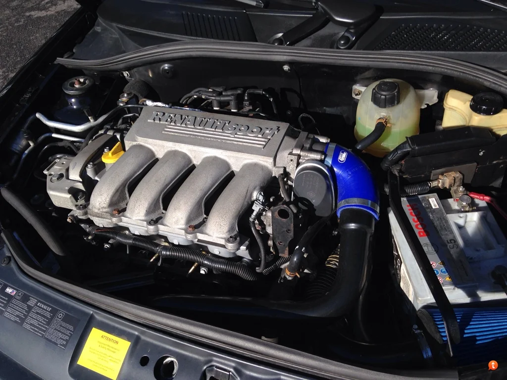

List of to do's:
Boost leak - Turbo to manifold. have ordered some Cosworth lock nuts.
Oil Leak - Looks to be from oil return.
Forge actuator - GT25 one won't hold more than 0.6 bar.
Air conditioning seal and re-gas
Nimbus heat shield
Solid top mounts
MAC valve
Remap
Also have some knocking / vibrating which only happened at motorway speeds.
Really just want it all sorted now :cry:

Thanks Chris, I could probably get away with the 4500mm x 5000mm heat shield. but doing it myself just incurs more costs. Also looking at your oil return, seems to be one black pipe from the turbo, mine seems to be a megane oil return pipe split in the middle then joined by some pipe and two jubilee clips. this is where it leaks from!

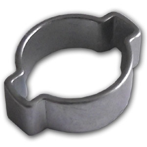

Where does the pipe tap into? Your block somewhere or sump? Also these kind of clips are the daddy's when crushed with the correct tool, proper seal!
I'm sure it's the block, can't remember it's just the pipes joined together with a bit if tubing and jubilee clips that's the issue. Sure the ktec return fees pipe would have been better [emoji85]
