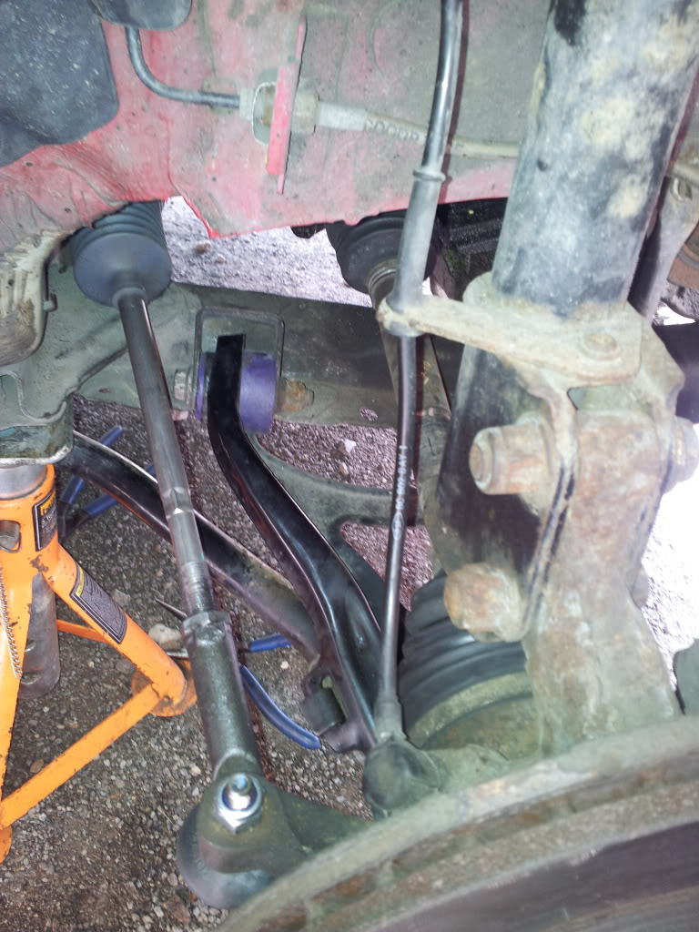

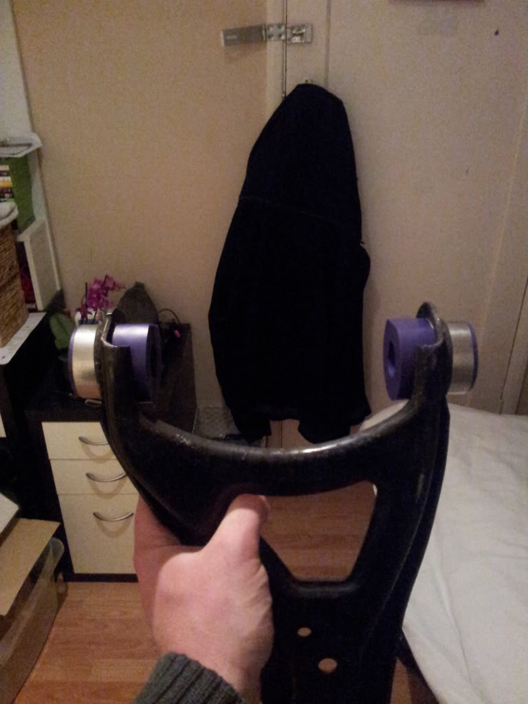

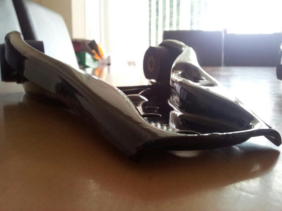

Well all the wishbones are prepped and ready for welding, heres a quick picture mock up of the bushes fitted.
Heres one showing the bushe pertruding

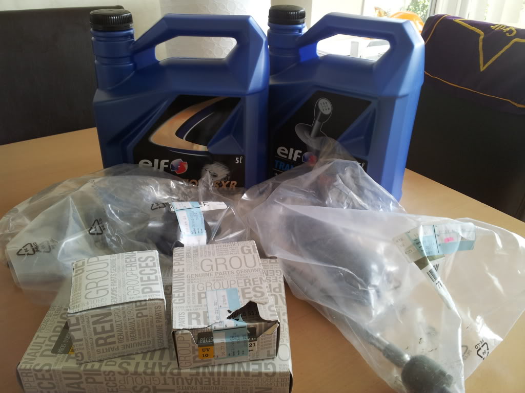

Well this morning I got up and shot over to Wilenhall Autoworld Renault trade parts to grab me bits off Adam and pay up!
So I got: 2 x Inner track rods (drumsticks)
A set of steering rack mounts
5 litres of gearbox oil
5 litres of engine oil and a oil filter
A set of spark plugs
A pollen filter
Also dropped me wisbones off to have the sleeves welded up. Due to time its going to have to wait for a week until I get time to fit them all to the car as yet again I've got other peoples cars to do at the weekend and the missus is wanting me to go shopping for stuff for our new house we've bought.
  Megane r26
Well just collected my lower arms from fred at BTM, dropped them in as I was in the area. He's kindly tacked the powerflex sleeves in place to prevent them from twisting and moving.
Going to drop them off with me friend at the weekend who is going to powder coat them for me.

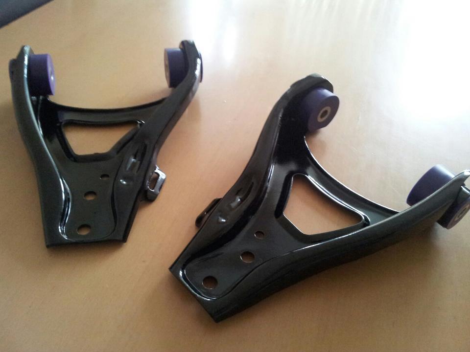

Well nothing to exciting for now down to the s**t weather and a hangover, but I'm off all week thanks to me shift pattern so they'll be plenty of action this week hopefully.
I did however collect me wishbones from the powder coaters :)
All welded, powder coated and powerflex fiited :)

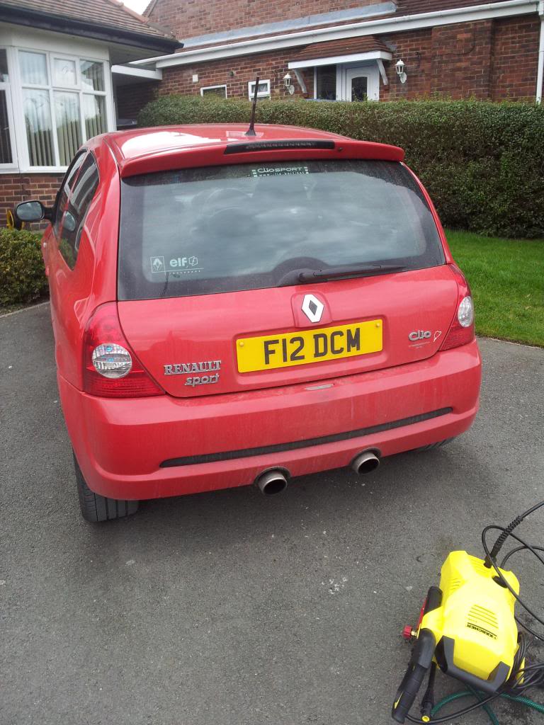

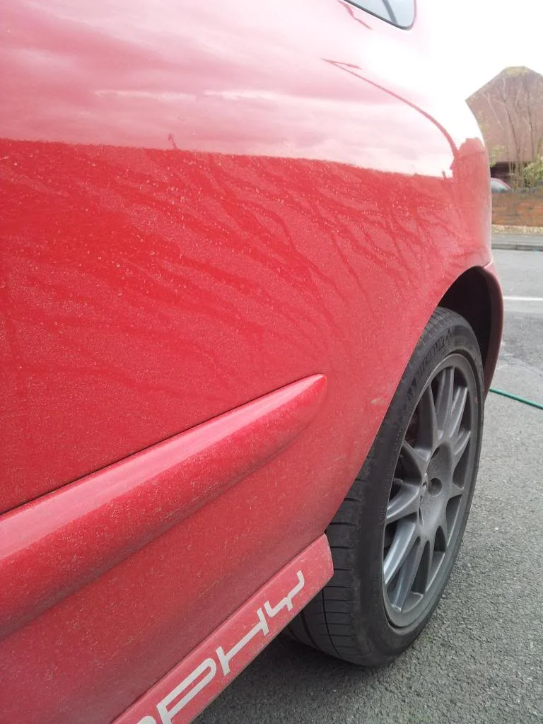

Well bit of a let down this week, was hoping to get all my goodies popped on this week. Long story but I'll tell it anyway, the missus owns a 107. The clutch had started to slipped so checked all adjustments with manufactures spec and still slipping so I thought not to worry I'll grab a clutch and pop it in, job done only take me a few hours. Well on close inspection there was a small oil leak (looked like engine oil) from bell housing so I grabbed a rear main seal. Once the car was stripped it was apparent that the oil was infact gearbox oil leaking from the input shaft seal. Also looked like to replace requires a box strip, I'm a mechanic but only ever stripped one box and as we need the car asap I dropped the box off with fred at btm to sort.

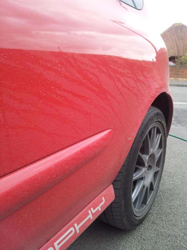

So thanks to that I've been having to ferry her to and from work until its back together so times been rather short. Did manage a quick clean as it at least deserved that thanks to all the mileage its been racking up this week so heres a few pics.
Before
During
After
This was only a quick clean

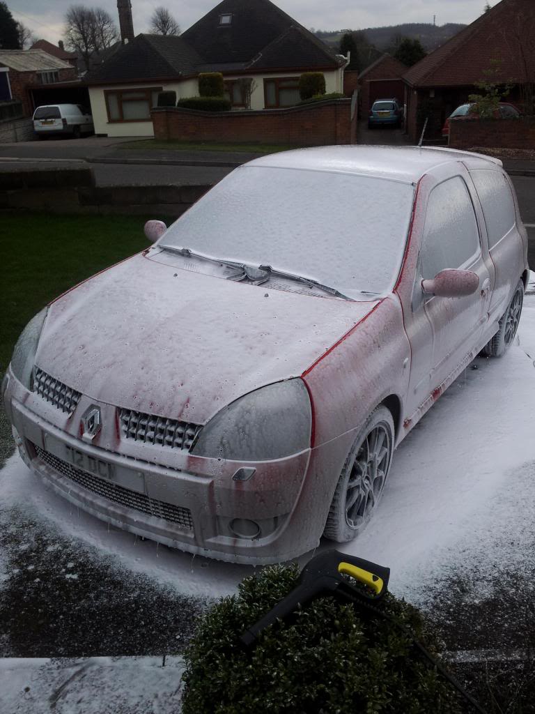

Pre Jet wash
Snow foam
Wash (2 bucket)
Dry (drying towel and M/F Cloth
AG paint sealant
AG trim gel
Megs tyre gel

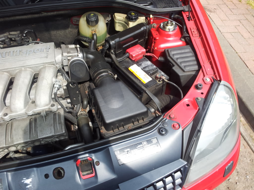

To begin with I finally got round to getting it serviced. So that included oil and filter, spark plugs, pollen filter, panel filter recharge and gearbox oil change.
So I got all me bits off Adam (t21 ads) at Autoworld renault, always friendly and helpful and very competive.
Car before we started
Engine bay snap (and yes I know it needs a clean, its on the long list)
Inlet off for spark plug change
New and old
Then pollen filter change

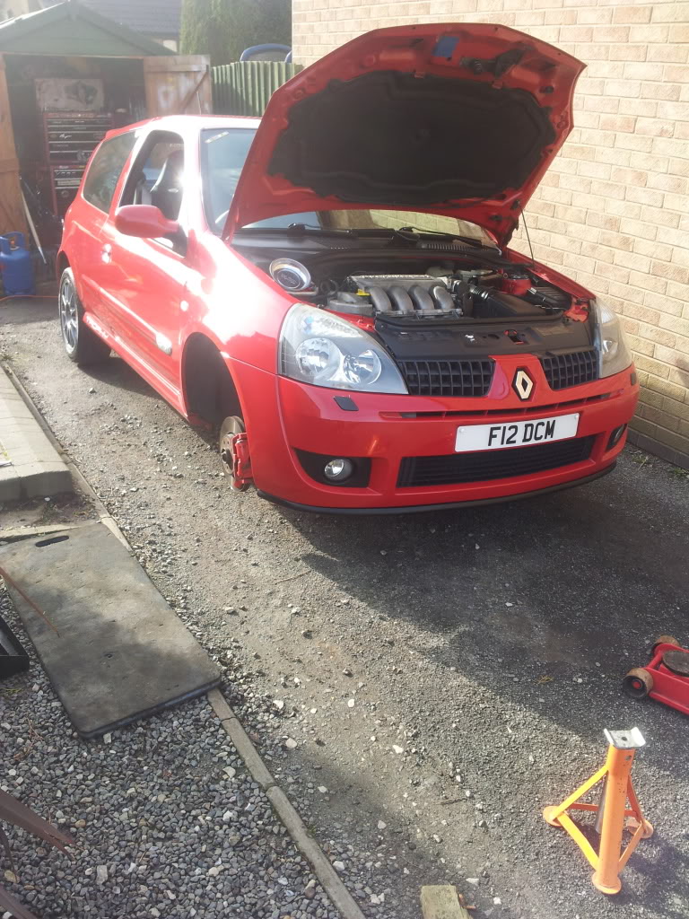

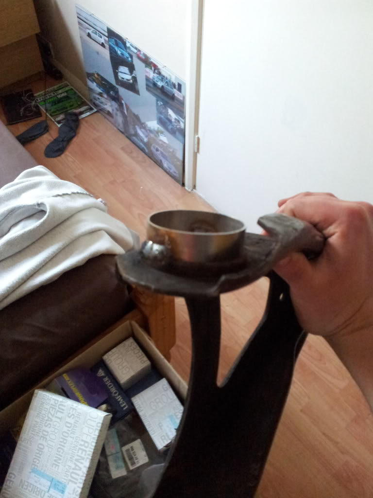

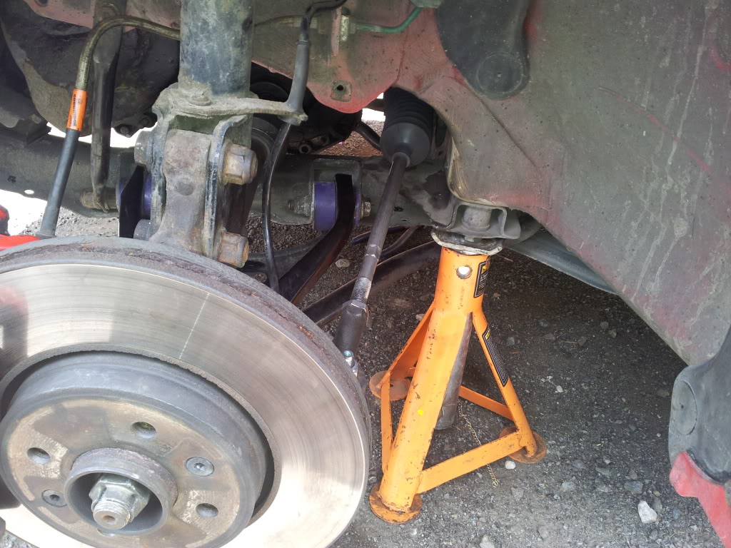

Then I finally fitted my freshly powder coated and polybushed "cup" wishbones which my car already had and have now been sold on. I fitted these to new lemforder balljoints too.
Haven't got many pics as I got pretty stuck in due to the fact most of the bolts were seized a treat.
One of the old balljoints
And me tidy as ever
Must say these have tightend up the front a treat and still got me inner and outer track rods and rack bushes to replace this week so looking forward to that. Then on friday I'm going to take a trip up to harrogate to drop me sachs of at Cornering Force for rebuild, de-pinning and powder coating, then I'm going to order my mark fish springs and pure top mounts and strut brace. So it will hopefully be handling like a goodun. Then I'm going to chuck some revalved koni's on the rear and corner a weight at me mates workshop.

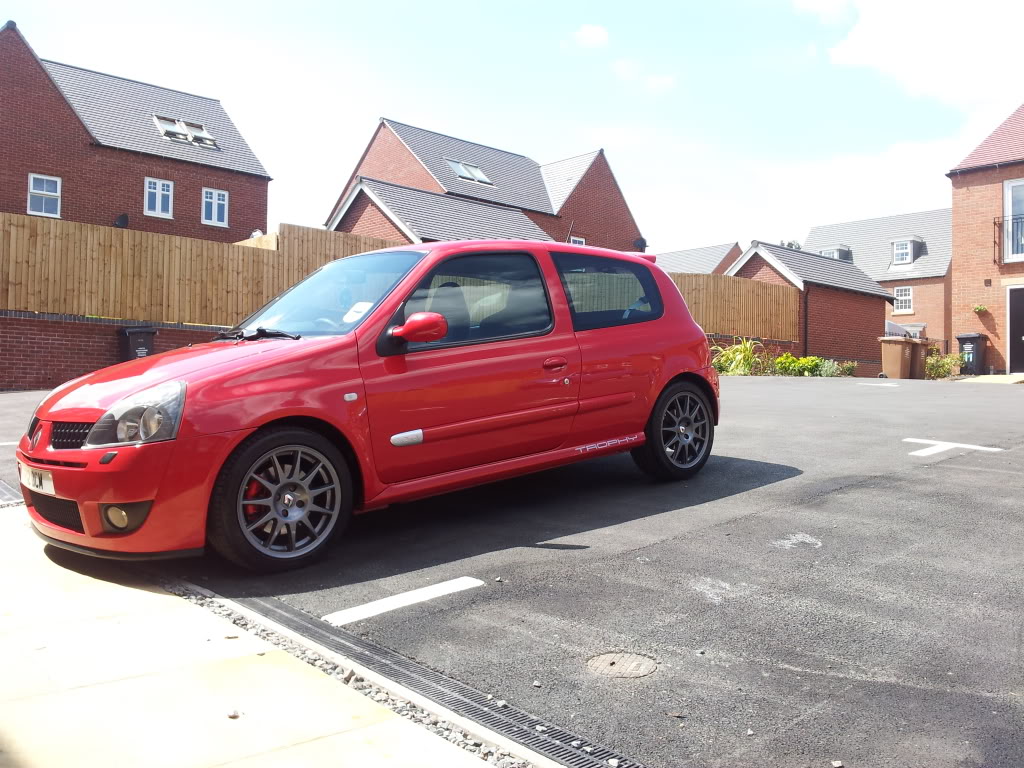

Heres a quick pic of it outside the new place
Cheers for looking!

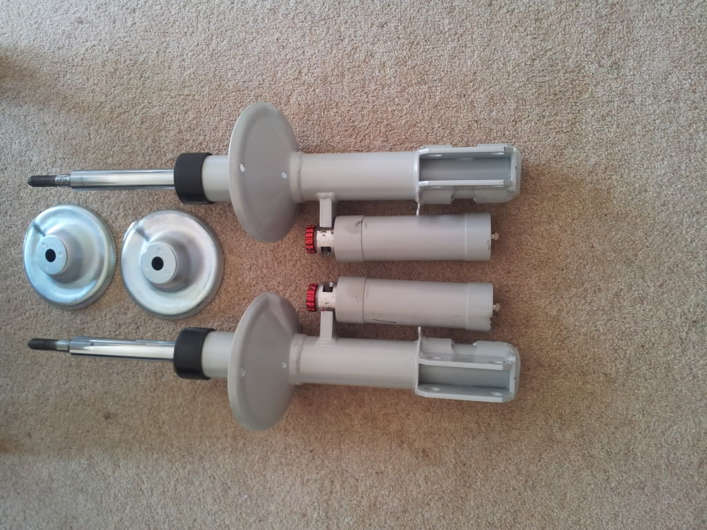

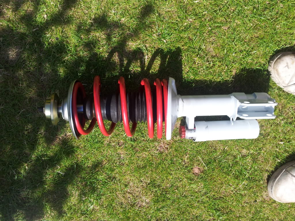

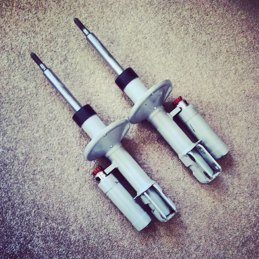

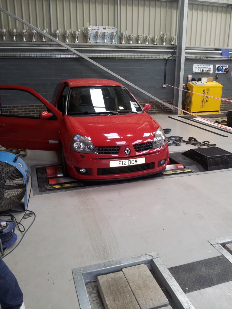

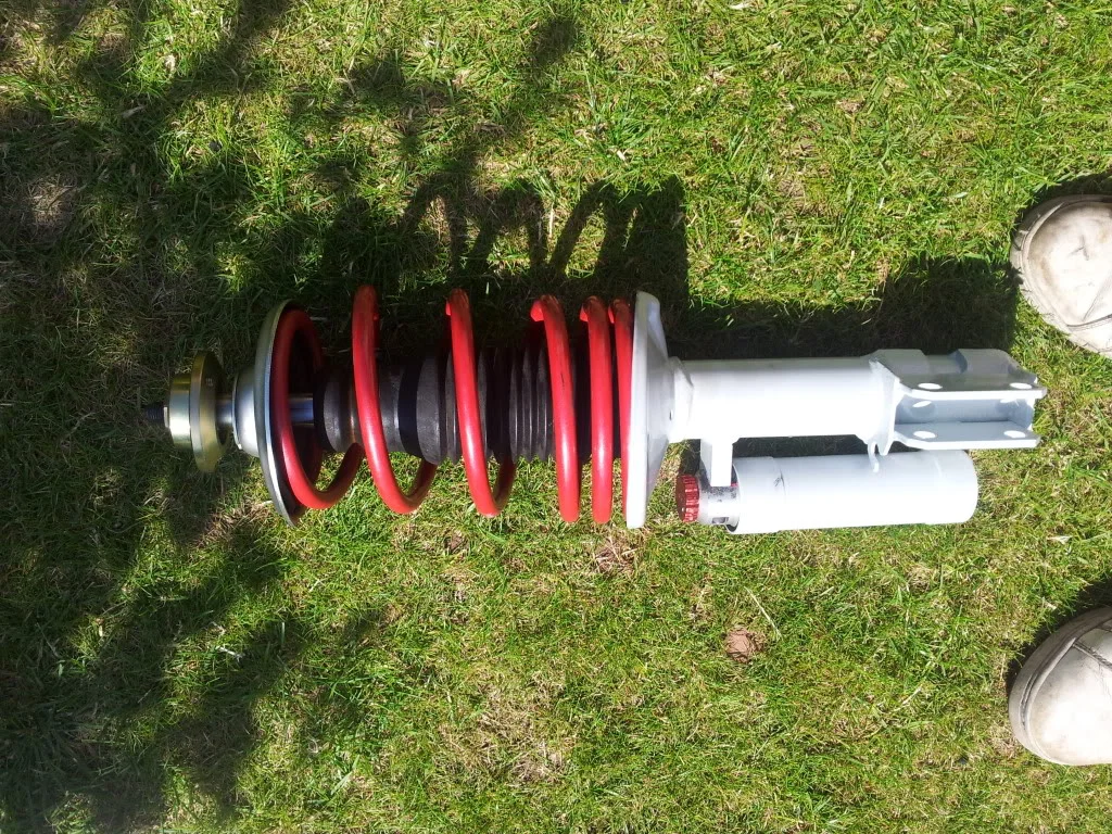

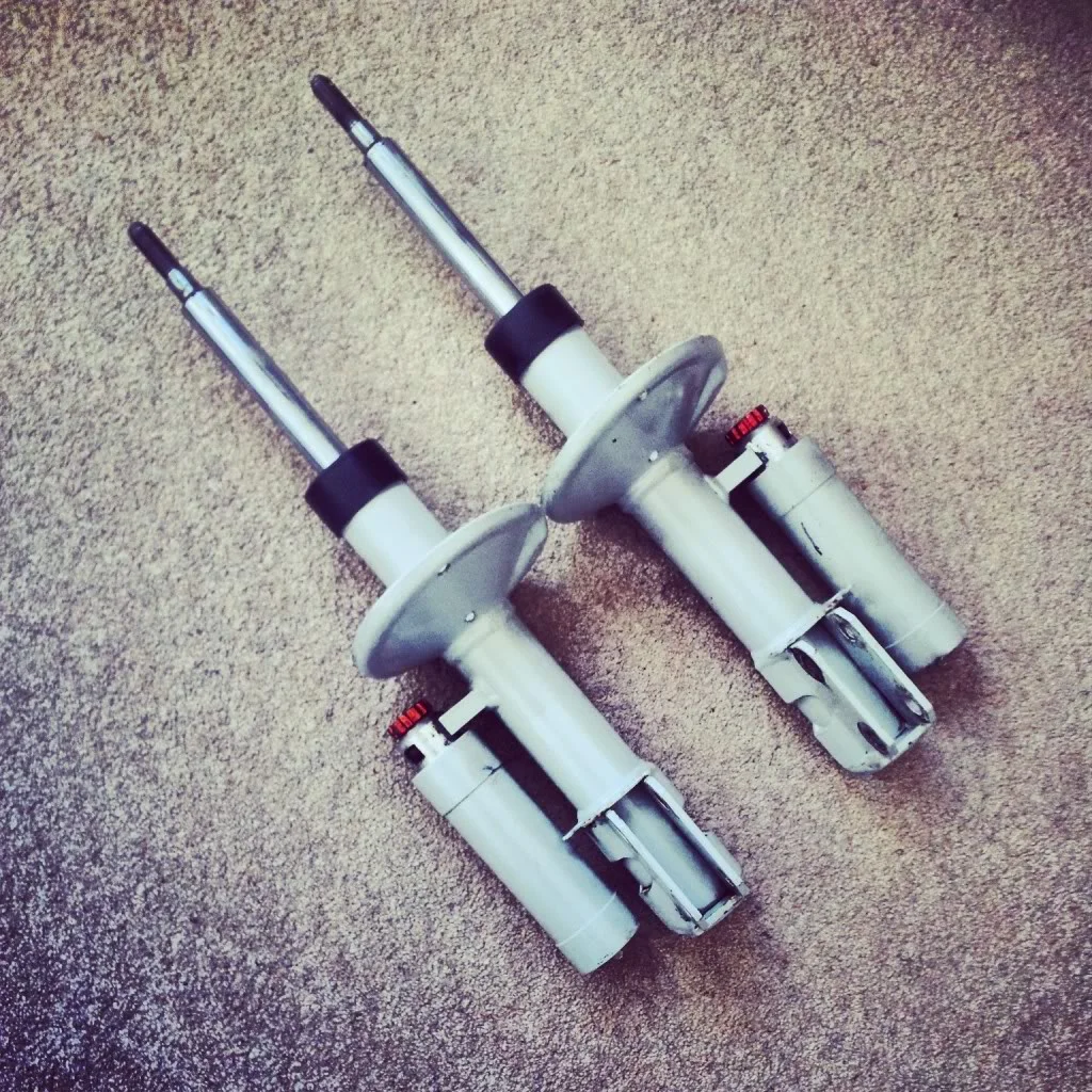

Well made the most of having the missus's 107 today and drove 100 mile to see Simon at cornering force to drop my Sachs dampers with him.
What a great place he's got and quite a nice countryside backdrop. What a top guy to really took the time to explain what's involved and and the common faults he has seen on the dampers. Gone for full overhaul and powder coating so they should look fresh when I get them back.
  Megane r26
Well its been a long time coming just down to the fact I've been rather busy with the house, work and other peoples cars! Always the way I guess.

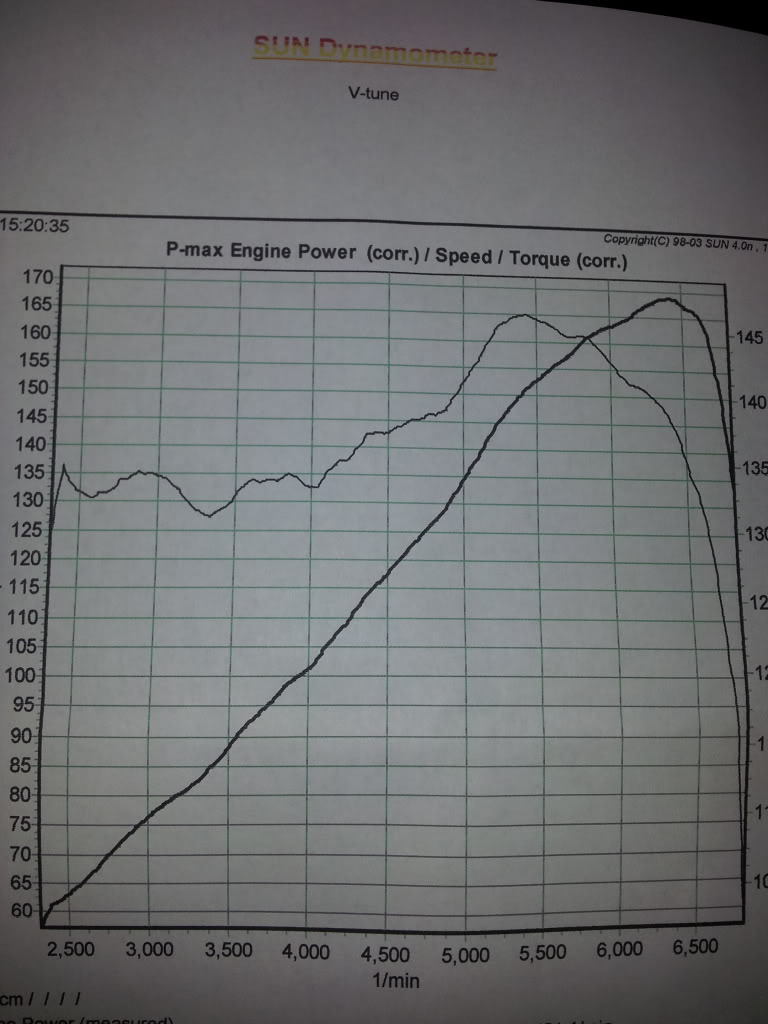

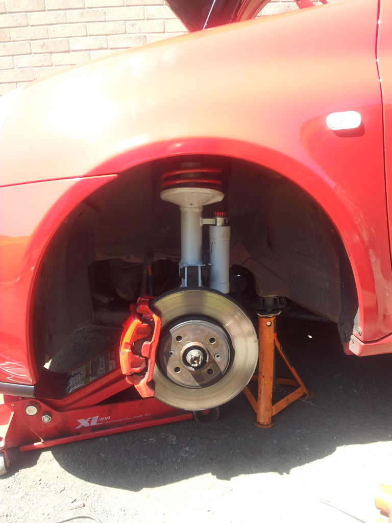

Anyways a lot has gone on since the last update so lets start with some nice pictures of some shiney bits. If you remember last time I had took my Sachs dampers to Simon at CF for a full rebuild, de-pinning and powder coating.
So heres the results, must say I was very happy with the results ans Simon commented how well they tested on the dyno!

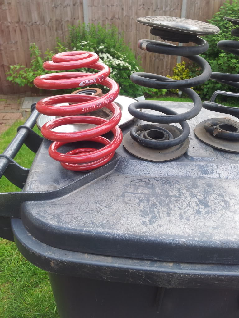

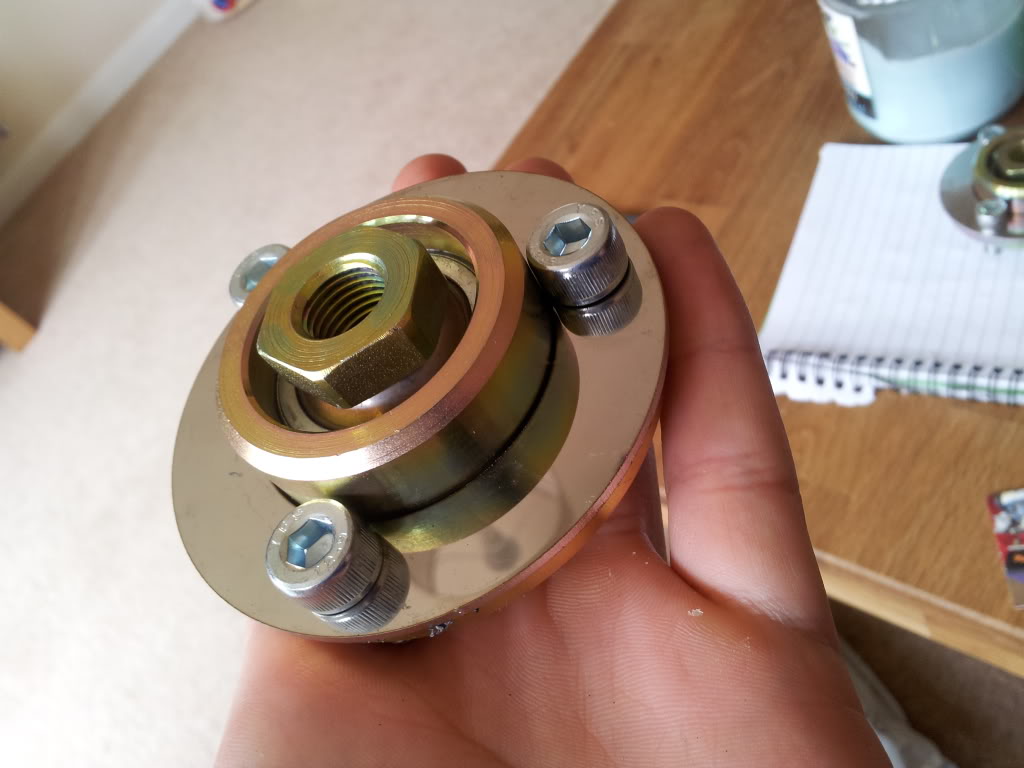

I then coupled them with some nice Pure motorsport top mounts Eibach sportlines which I got at a very discounted price :)

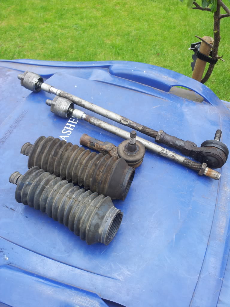

Next up I replaced both inner and outer track rods, not many pics here as I got well stuck in!
Old stuff
New stuff

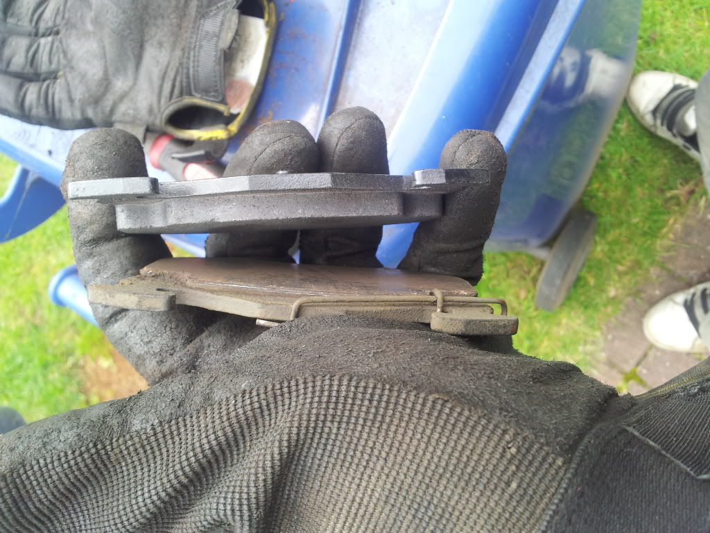

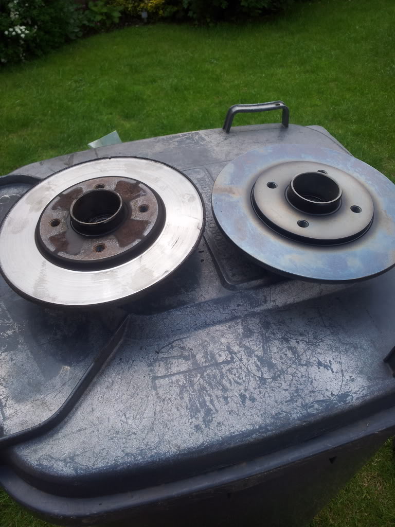

Also fitted some new rear brakes as pads were very low and discs had seen better days so got some rear pads and discs and bearings off t21 ads
Got me moneys worth?

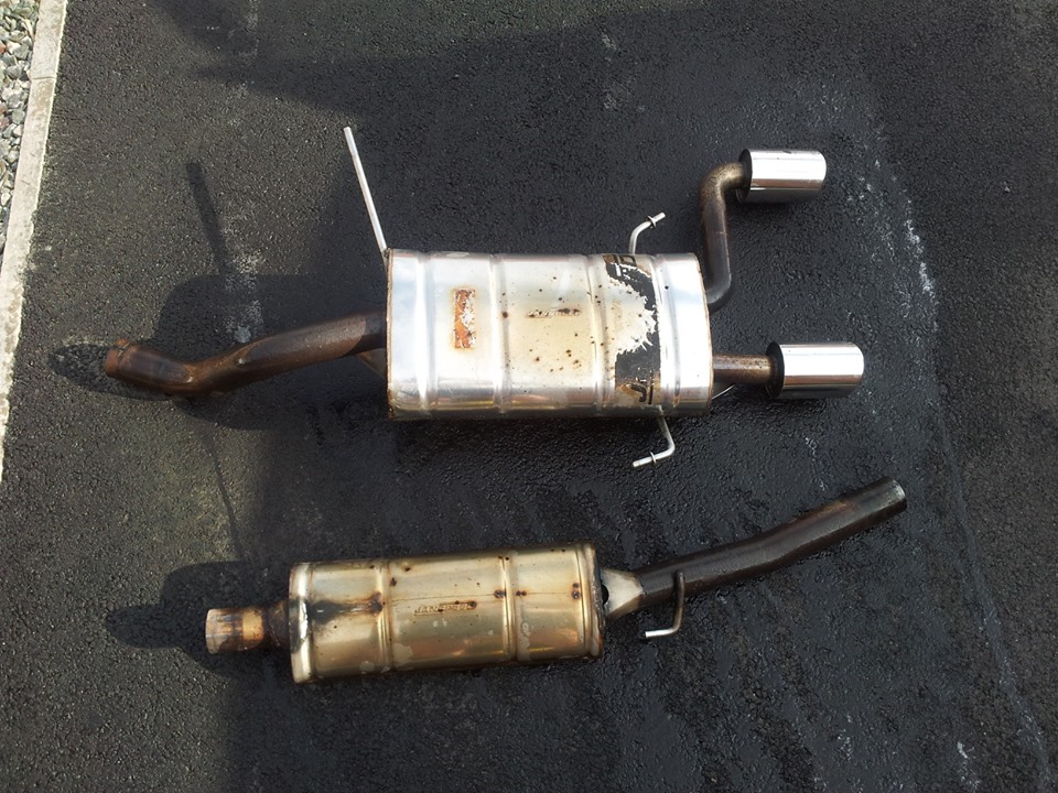

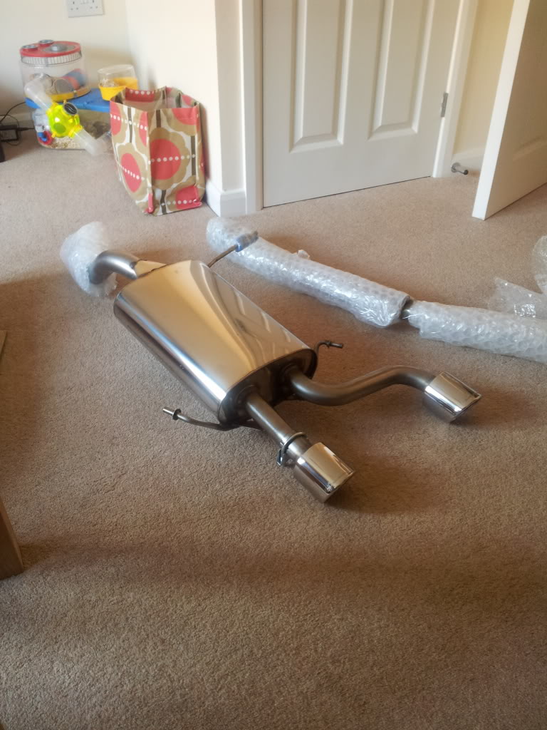

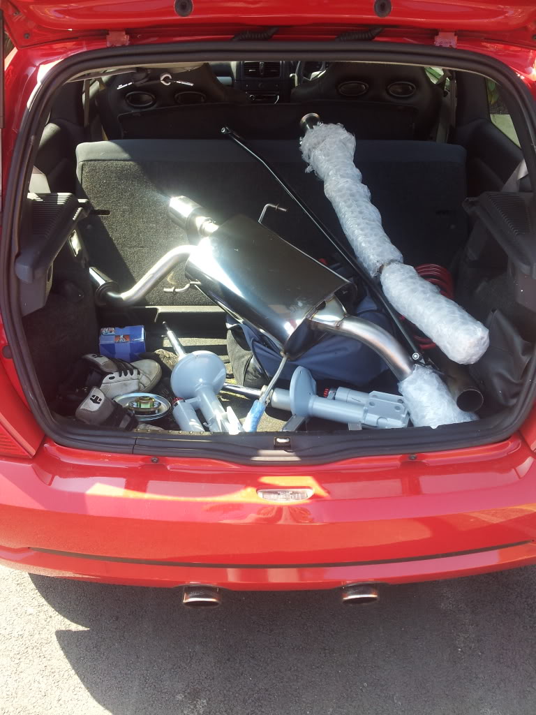

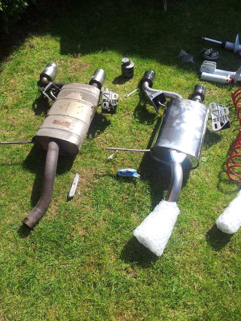

Next I treated it to a new exhaust, old janspeed was a little tired and had been chopped about a little so I replaced it with yet another janspeed but this time with a decat and straight through centre and new mounts :)
Old system
Old vs New
Sounds great and nice and quiet whilst on the motorway
Boot full of bits :)

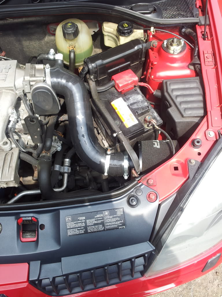

Also picked up a second hand ktec induction kit
old airbox
new ktr kit
Sounds great and little tight fit but proof will be in the pudding when I put it back on me mates R/R

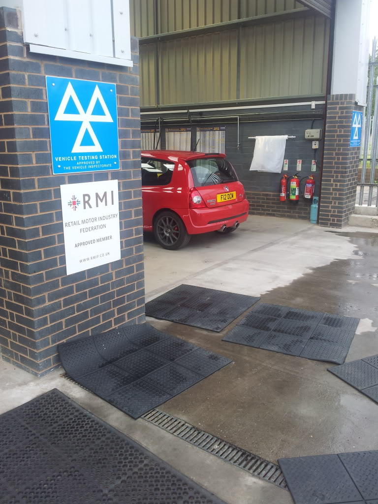

Passed its MOT with flying colours
Next up some pics of it on the RR before its new exhaust and induction, pretty standard tbh.
The results, fairly happy tbh for a standard car with a blowing exhaust
Fairly happy for a standard car with a blowing exhaust.

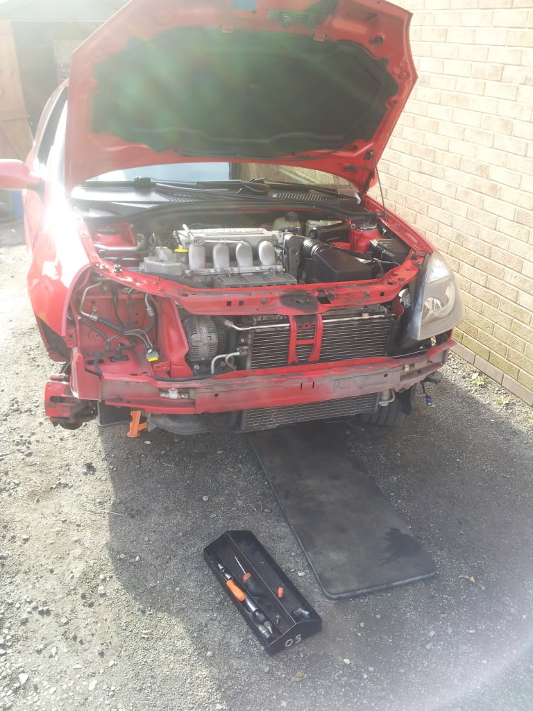

Next up I changed the aux belt as it was due so here's some pics
And refitted in reverse order ;) fairly straight forward job, I've done enough bits again courtesy of t21 ads.

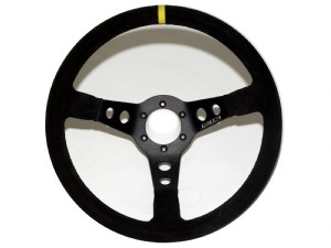

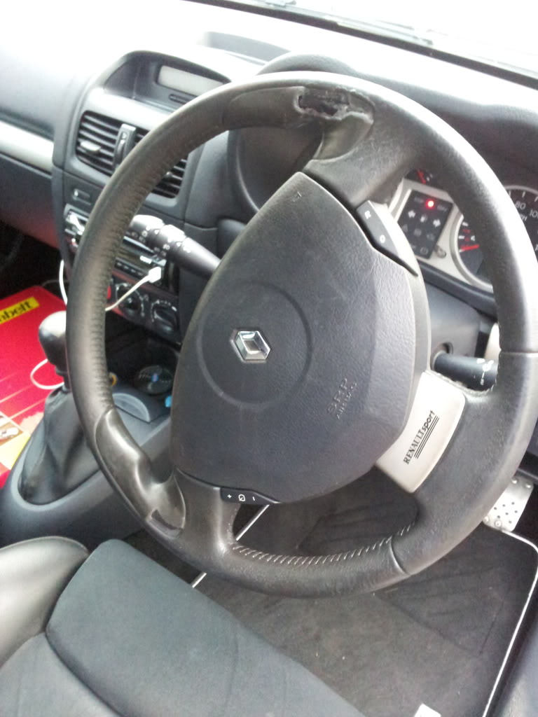

Well been looking at a few steering wheels for a few reasons, first of the original is melted as per renault spec, its also too big and I'm going to do my best on improving the clio driving position.
So heres the first choice
Its a flat oreca suede wheel ranging from 300mm, 330mm to 350mm not sure on best diameters so advice welcome.
Second choice is
Is the dished oreca suede option it only comes in 350mm but has a choice between 70mm and 90mm dish. I am basically after advice and benefits between to two different styles of wheel.

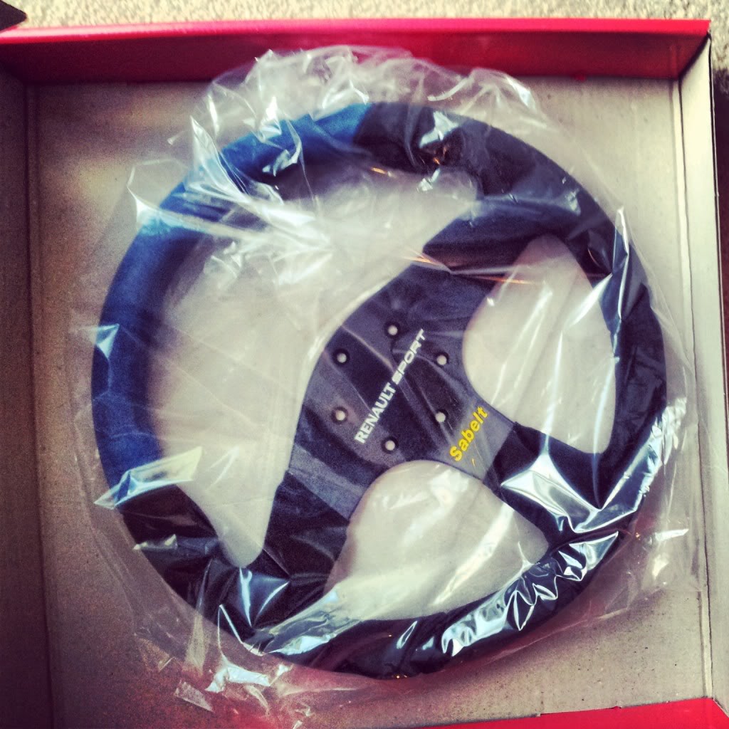

Not yet mate, may go for the oreca one or even the salbelt Renault sport one, missus is buying it now for xmas lol
Tim.

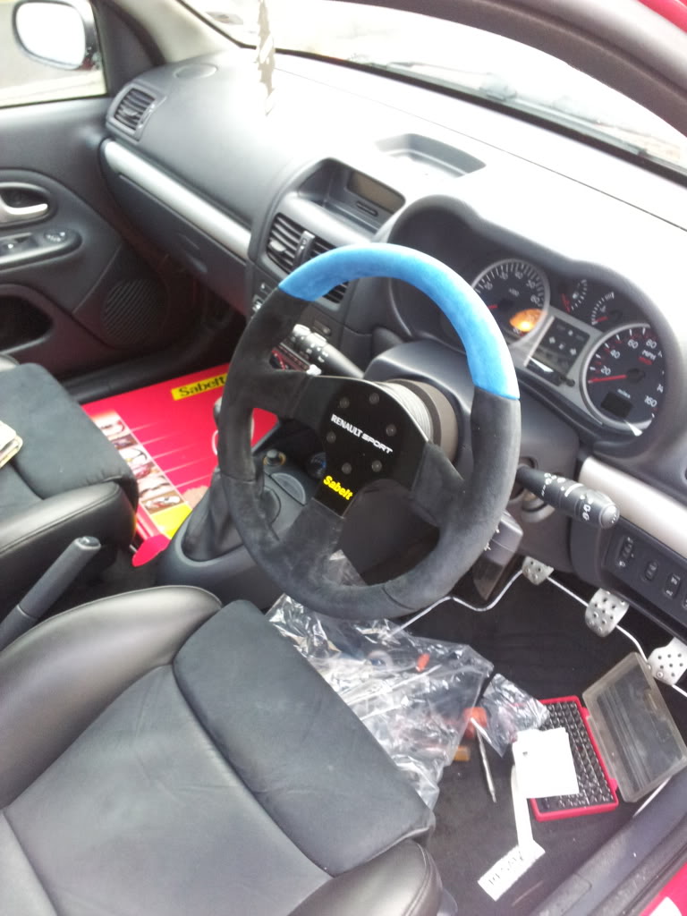

I opted for the Sabelt RenaultSport offering and it's delivered a huge improvement to the driving experience - I feel so much more 'connected' to what's going on at the wheels.
My only gripe would be the aesthetics - Sabelt blue is not a good match for Trophy red/pink.

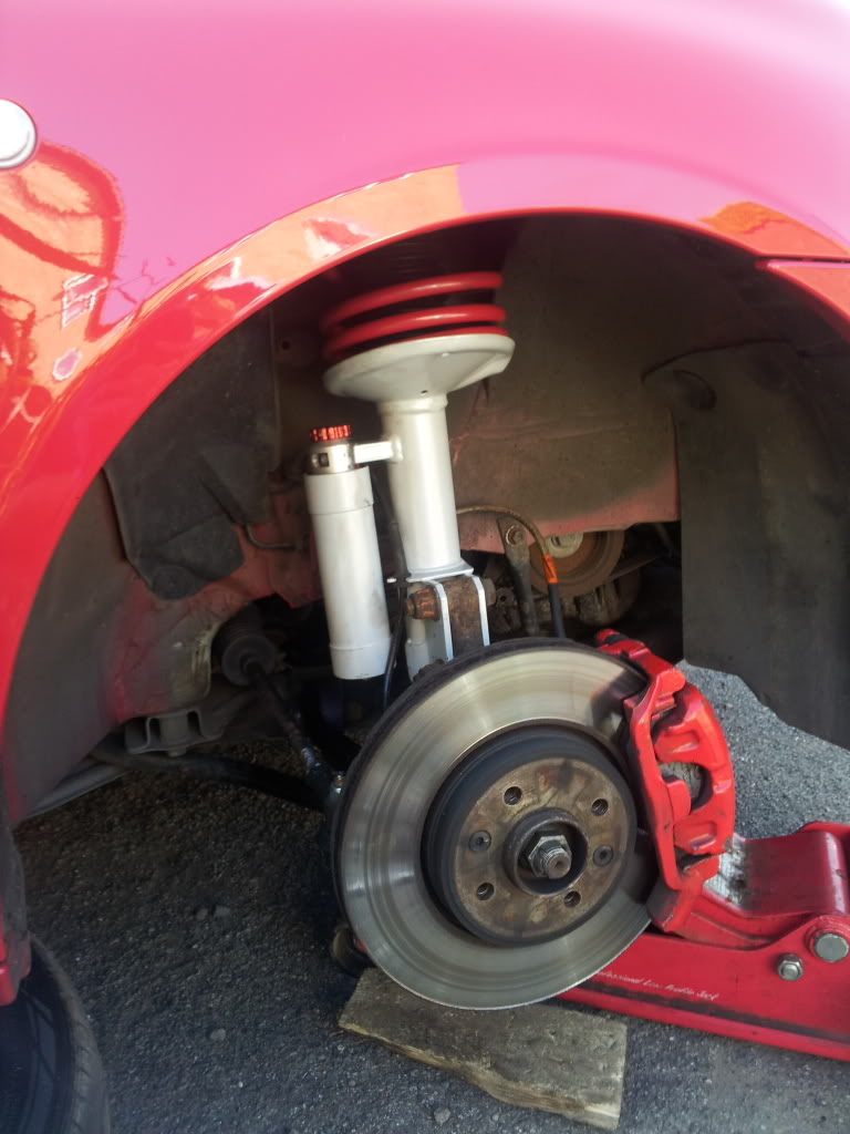

Seeing as the winter is upon us I thought I'd whip the Sachs off and put the 182 cup stuff on for these dark months and check the pressures on the Sachs and give them a nice clean up. Didn't take many pictures whilst working as I was on nights so had to get them done rather quickly so here's the end result.
All was well and there now under the bed nice and warm ;)

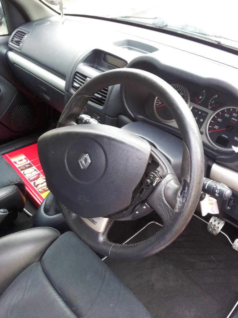

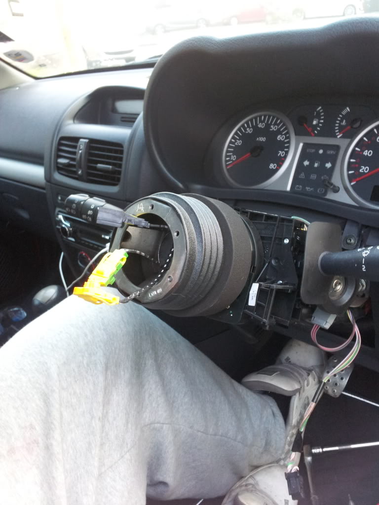

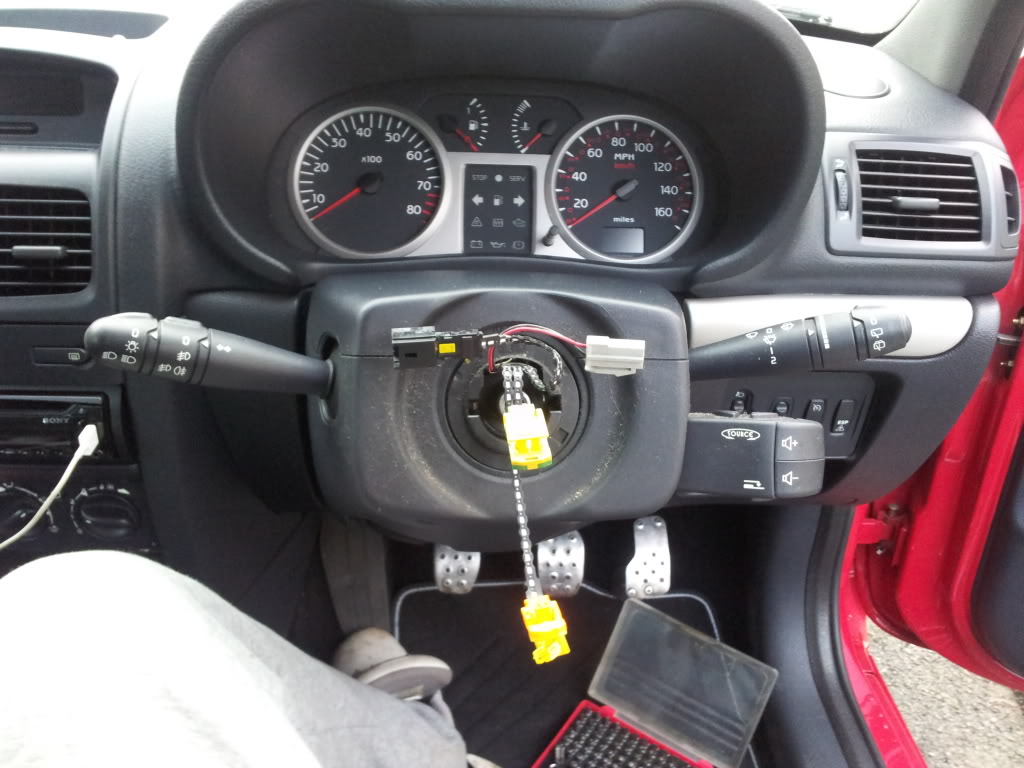

Next up was get rid of the steering wheel that was a)melted and b) belonged on the QE2 and seeing as it was Xmas the missus came up trumps with this
Curiosity of Adam at Renault Wolverhampton and here's a few pics of it being fitted.
The old wheel in all it's glory

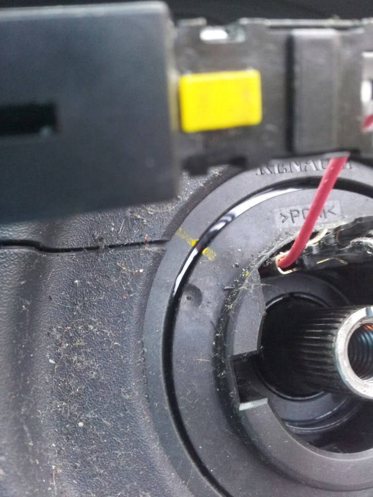

So time to remove the airbag
Then the wheel
Then I marked the squib so I didn't spin it and damage the coil.
Then I replaced the stork with a ph1 item and fitted the boss and fitted resistors in the airbag connectors
Then the wheel

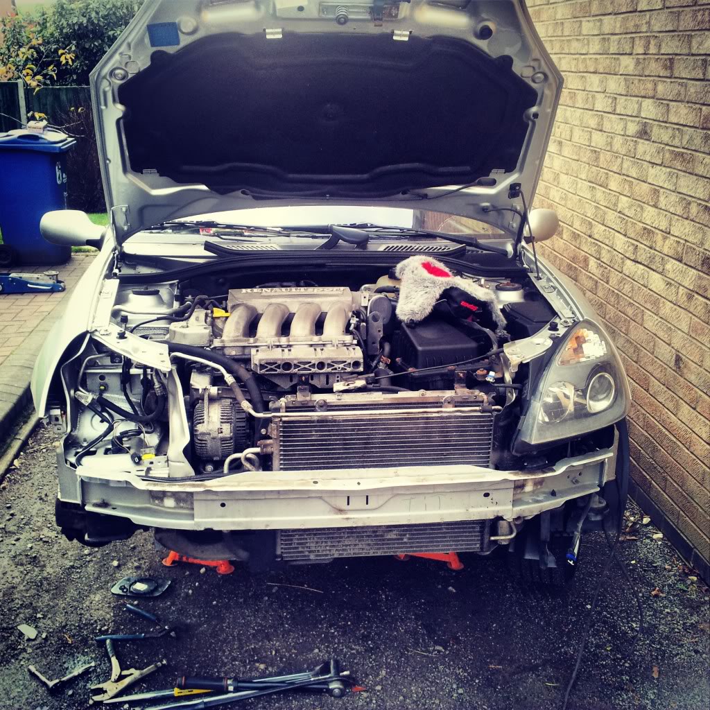

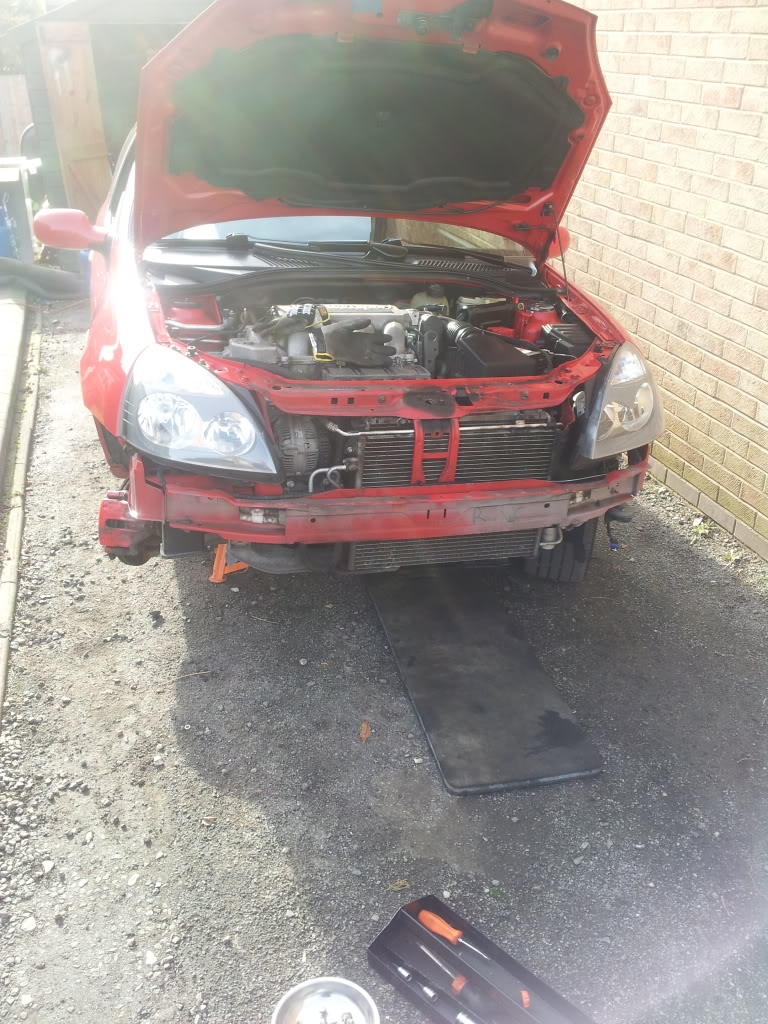

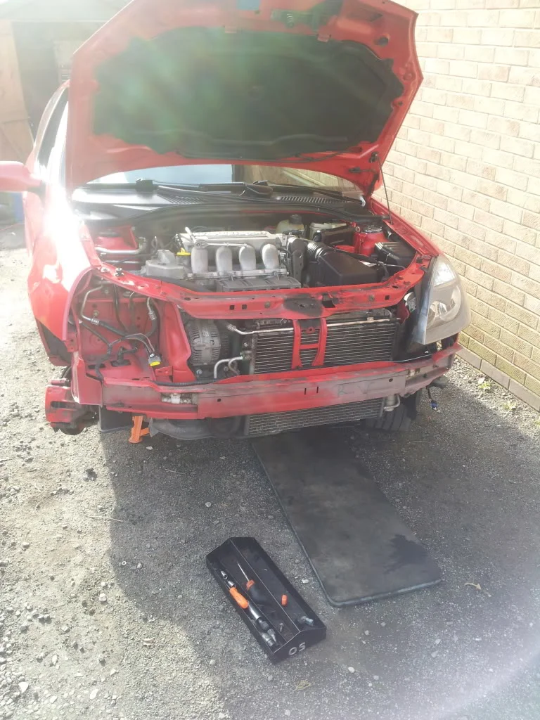

One of the main reasons I've been so busy is I've been repairing other peoples clios so here's a few pics. First of the neighbours 182, aux belt kit and front wheel bearing.
Then me sisters fella has picked up a 172 to replace his megane 250 as there buying there first house. So he picked it up for a bargain with a bit of rough running so I diagnosed and replaced an injector and it's sweet as a nut, also fitted some exhaust mounts and a quick oil change.

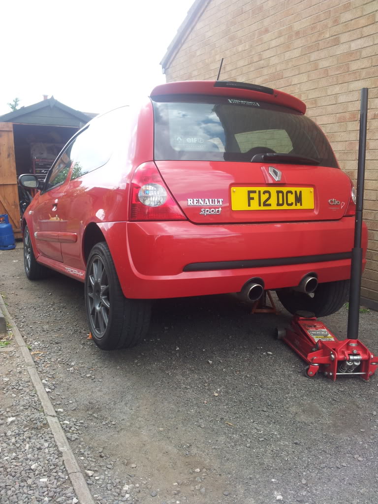

Well few more plans for 2014, over the next couple of months gonna whip the engine out, clean up the engine bay, rebuild the gearbox cause I think the syncro for 3rd had seen better days, sort the small leak on the sump and change the belt and dephaser whilst its out and I'm currently toying with a set of cams :s
Also going to look at a rear arb setup and some of the roll centre hubs off NorthloopCup if the group buy comes up and then you some more work with spring and rear damper setups.
The plan then is to get some real seat time on track and hopefully some tuition.
