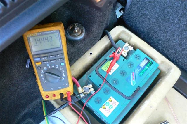

do it yourself, took me 5hrs ish, im no expert either, got a few step by step pics too.

anybody wanting a rough guide type in 'battery relocation' on the search and you will find my post with all the pics.
