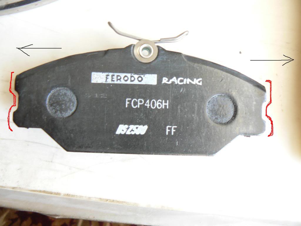

just watch it, as i've seen binding, the pad must be free to move vertically in the carrier
by vertically you mean like this? (with the red lines pointing the areas to file)
or like that:
just received the Brembo hc +ds 2500 kit from k-tec and wanted to be sure before install
ripp
  182 FFAT
yet another question: wouldn't it be less hassle to use the old pads as a guide to file down the DS's? as a template I mean, coupled with the removal of the shims?

Why? Just file/grind them and keep trial fitting until they fit right (moving them around in the grubby carriers will leave marks on any high spots). Mine (565) needed material removing from both the sides and the lower contact edges. As Fred pointed out make sure there's a tiny amount of vert play on them so they're still free when they heat up & expand slightly.
Mine needed removing and refinishing after the few hundred mile break in period as one side was binding slightly. After that they've been perfect with virtually no squeal. Mine are running with the stainless shims as figured this to be less friction versus running on the cast faces of the carriers that seem more prone to clogging from brake dust-so far so good.
or like that:
correct, but why did they send you 406H?

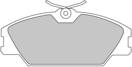

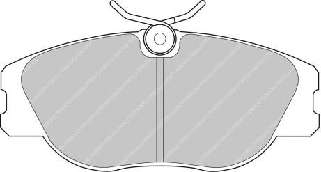

the 565H is a thicker pad with a larger surface area, obvious from the images below, price difference between the 2 is about £10, but some companies sell the cheaper 406H pad at the same price as the more expensive 565H pad which is a bit naughty in my book
406H dimensions and image
129,9x51x18,3mm
565H dimensions and image
130x53,5x19,1mm

as I can see the 565 has a groove in the middle? my 406's have that groove although not shown in the drawing.

yeah its just the image, they all should have that groove down them

clearly with the shims on these pads won't go in, with them removed, a little file needed

removing the caliper is easy, you should figure it out. and yes I would do the job myself than paying someone for a simple task. pads need to be filed at the ends. the shims are some 0,5 mm thick metal plates that are positioned in the area where you will need to file the pads. general opinion is that you'll need to remove these(use a flat screwdriver to get them out if they don't come off by hand). file the pads down until they fit easily in the carrier and have a little play (in a vertical direction)-about 1-1,5 mm. you will also need to push the caliper piston back in as the new pads are thicker and the caliper won't close otherwise. I managed to do this using two spanners, one rested on the piston, the other used as a lever(easy to figure out how to). mount everything back, job done

top pic. they will expand more across the length than the width. easy to tell when trying to fit as they'll probably won't even go in if you don't file that area
