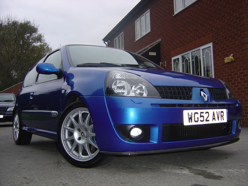

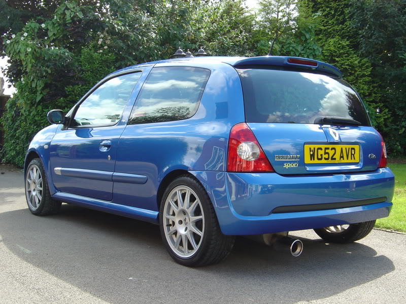

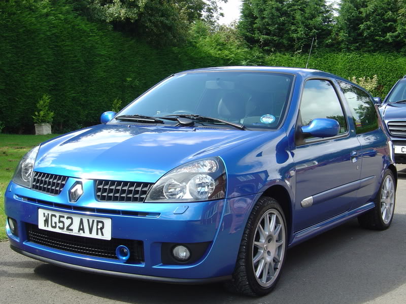

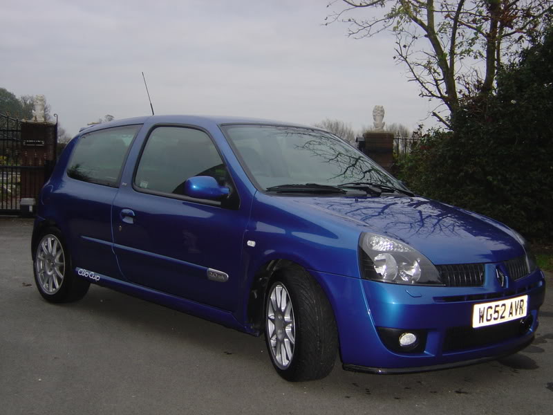

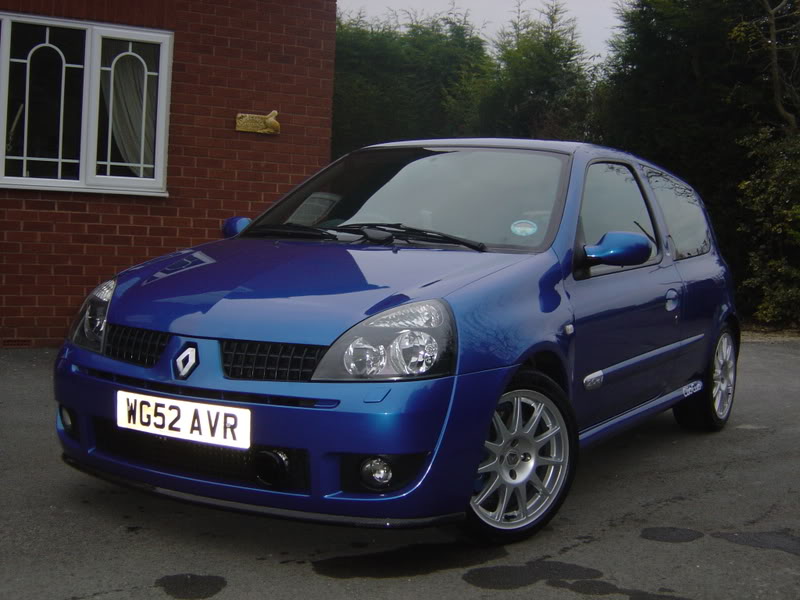

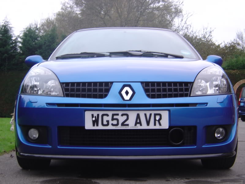

Bin spending the last few months getting my cup all upto scratch. A few mods along the way. Heres a few of it before I started!

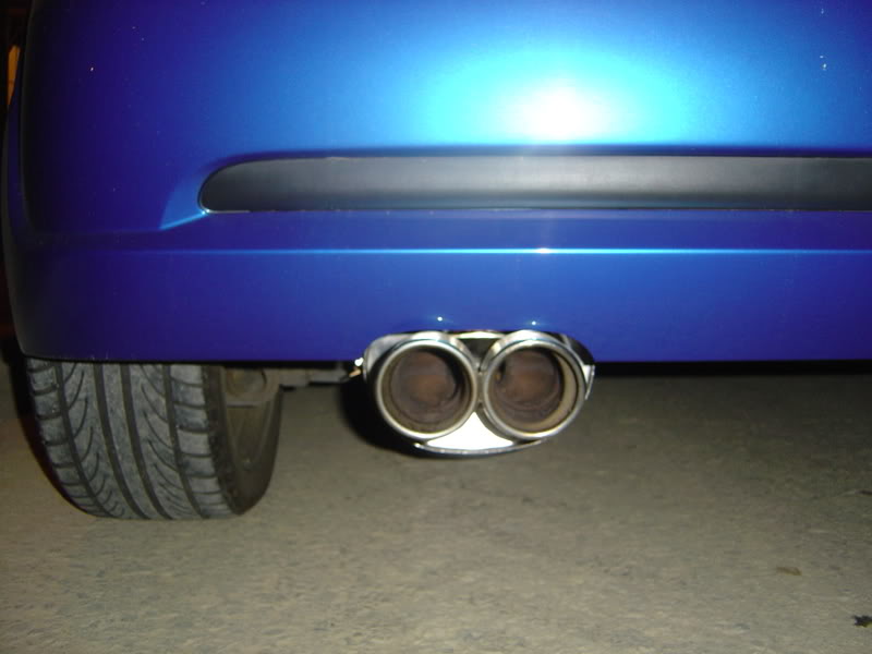

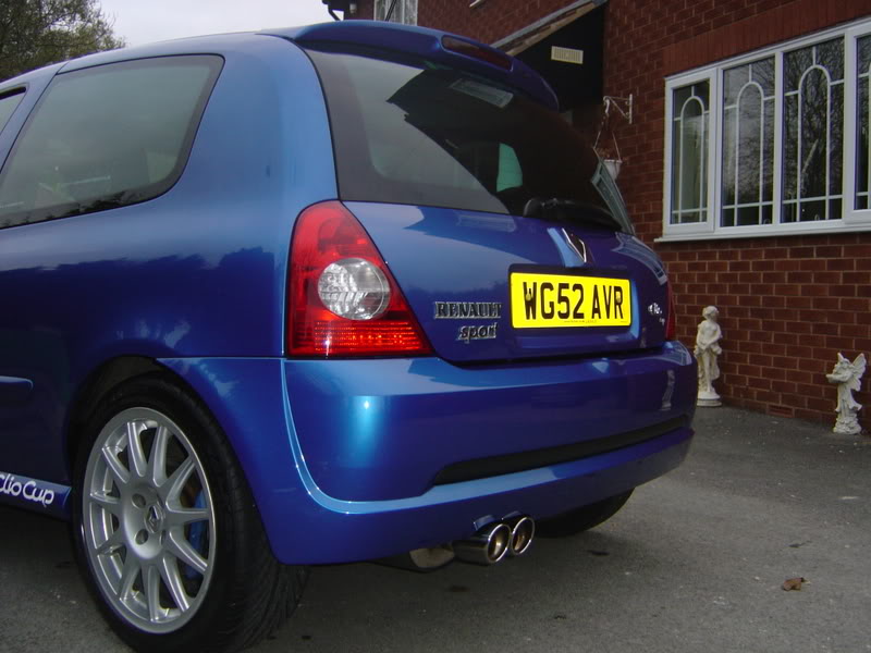

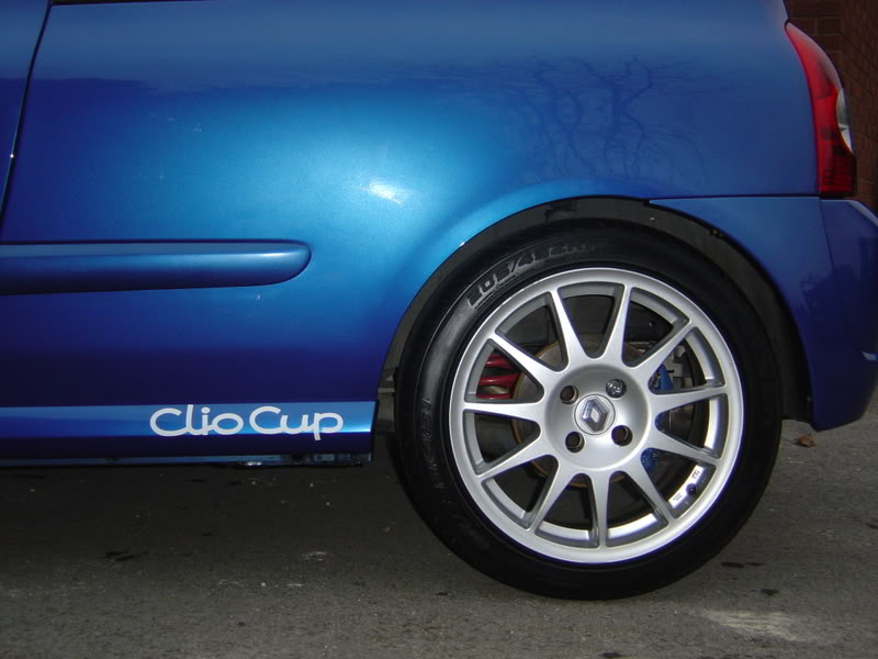

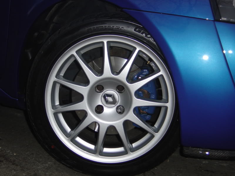

So the first thing i did was to replace the dodgy cat back scorpion exhaust system. So a trip to cardiff to see Charlie at Prospeed. After seeing Len beaches car i decided to go with a twin tail pipe option cut nicely into the bumper. Along with a silenced de-cat pipe. All I can say is Charlie and his lads work was excellent. It has a nice raspy sports sound to the exhaust and the guy was so helpful. Had my tyres replaced and fitted some Falken 451's in 205/45/zr16. They are nice and grippy in the dry but wear as quick as f**k! Not long after some goodies from k-tec arrived. ITG panel filter and a carbon fibre front splitter. Got straight to work fitting these, removing the pipercross open cone filter. Adding the original airbox, removing the acoustic valve and adding 2 custom cold air feeds. Next trip was to see Ben R at angelworks. There i had some brembo max discs fitted (already had goodridge braided hoses and feredo ds2500 pads), eibach sportlines from venommotorsport, Matched inlets and finally a AWT/RS Tuning remap! All i can say is the drive home was fantastic! A completely different car!:cool: Got hold of some clio cup decals for the skirts and a second trip to powerstation for another dyno run and I was all done!

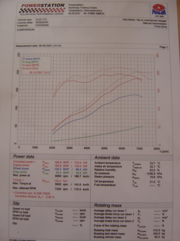

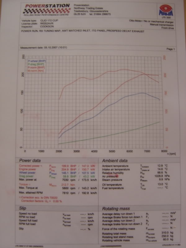

Here are the dyno results and a video.
http://s96.photobucket.com/albums/l162/Quade1881/?action=view&current=MOV01538.flv
Final result was 199.9 bhp and 212.7nm of torque (156.9 ft/lb)
Here comparing the dyno results before and after the mods!

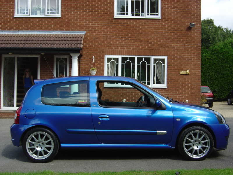

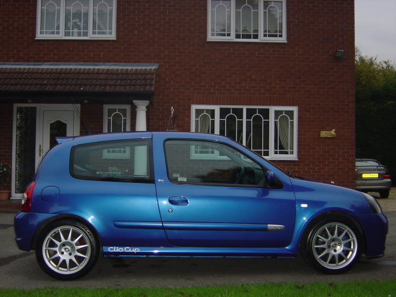

The final thing to do was to give the cup a proper clean! Started by giving it a good wash with autoglym conditioning shampoo. Clayed it and then washed it again. Polished using SRP and waxed using Meguiars tech wax! Not realising the tech wax has polish in it too! doh!
Hope you like.:cool:

Looks mint! I did almost die when i saw that exhaust though.

If that had a single exhaust, that would be my perfect Cup I think! very very nice.
  Saab 93 Aero Wagon
Like it all apart from the exhaust. Very similar to what i wanna have done on mine with the inlet matching and RS remap.

Seems quite optimistic RR figures, i'd of guessed 185 at the most with them maps.... but it still looks awesome! :D

yeh, bit optimistic, Both me and chris and nic just got into the 190's with headwork and 182 mani's.

Yeah I thought the 200 bhp was abit off. But had to keep it to the same rollers I used before, so atleast i know i have made about a 19 bhp gain with the mods! It did have a pipercross open cone filter and scorpion cat back system on it before i started the engine mods. The pro-speed sound good. Its not too loud round town but when you open it up and the cams come in it sounds awesome. Well for a clio anyway!:D

The pro-speed with silenced de-cat and new exhaust bracket was £430. ITG Panel filter was £48. CAF tubing and trumpet £20, Matched inlets plus fitting £220. RS tuning map £265. So in total £983. Not bad but well worth every penny. It holds peek power till 7800 rpm. Is definately abit quicker than standard.
