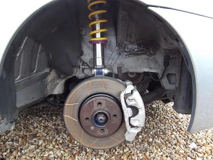

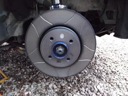

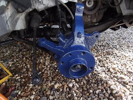

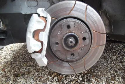

Progressed with the Front Brake install and hubs painted.

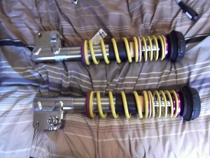

KW Variant 2's ready to be installed. Cant wait to get it on the track eventually,heard nothink but good things about them. I have got the variant 1 on my C20XE corsa which ive owned over 10 years now !
Brembo HC grooved discs up front.

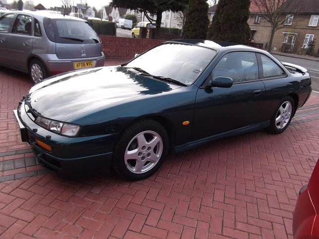

Got alittle distracted ! Purchased a Nissan 1999 200sx S14A 54,000 miles, totally original, 1 owner from new and every service and Mot done at Nissan !
Ive always wanted one and probably one of the best examples in the UK

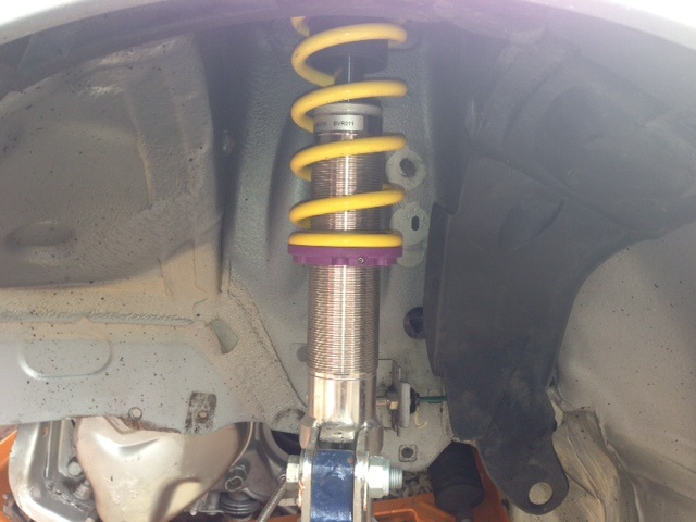

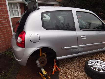

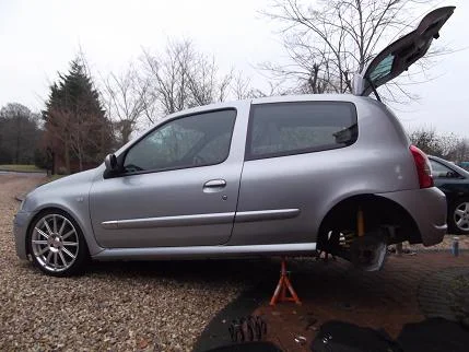

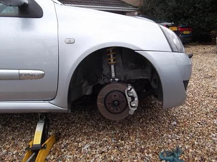

Kw's fitted, this is at there lowest setting on 17's ! Just wanted to see how it looked, awesome but only for show ! Will be raised for the track and smaller alloys !
Made a start on the rear coilovers too, Need to purchase some rear brakes and pads too when i have some spare money !
Just another pic from the other side
Just afew more pics adjusting the front shocks.
Do i purchase some solid Top Mounts ? Not sure if it makes the difference or not ?

Calipers refurbushed, new brake lines and brembo HC grooved discs all fitted, Just need to bleed the rear ass there is still air in the lines.

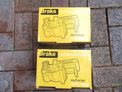

Afew more jobs completed, New refurbished calipers fitted. Brakes bled but will require bleeding again as there is still some air within the system due to the majority of the brake fluid been drained out a while back when the goodridge brake lines being fitted.
New calipers
calipers fitted along with Brembo Hc's

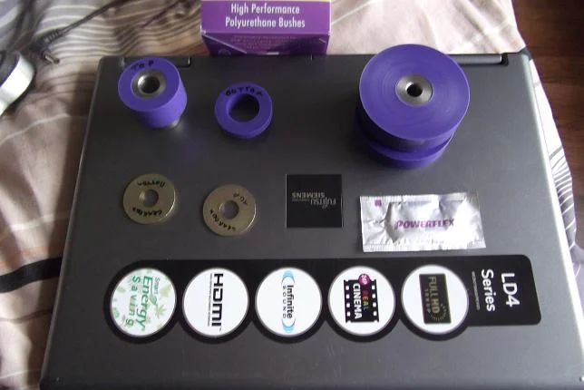

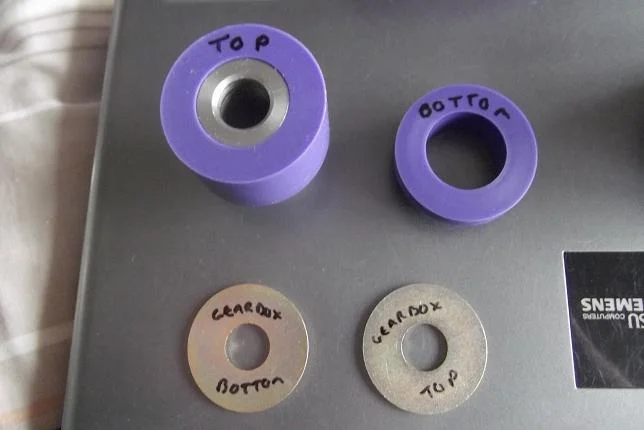

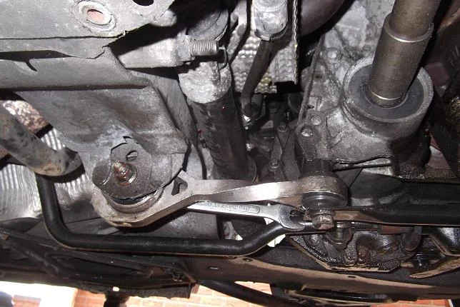

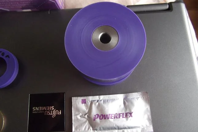

Powerflex Dogmount Bush kit
dogmount in place prior to removal
  clio 172
Bushes laid out
marked up prior to install
The big Bush !

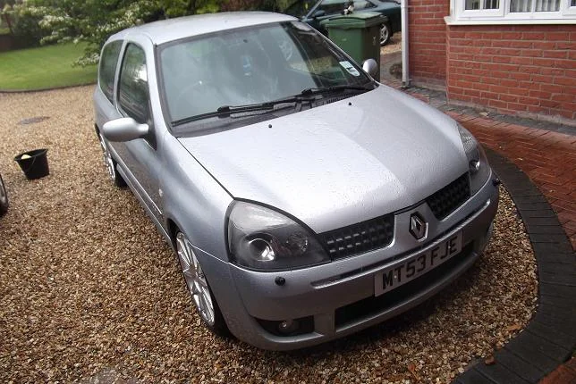

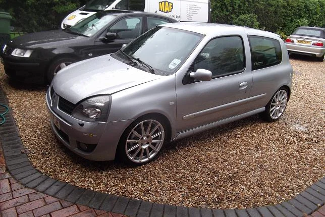

Exterior shot, its a clio !
front end pic
Side view

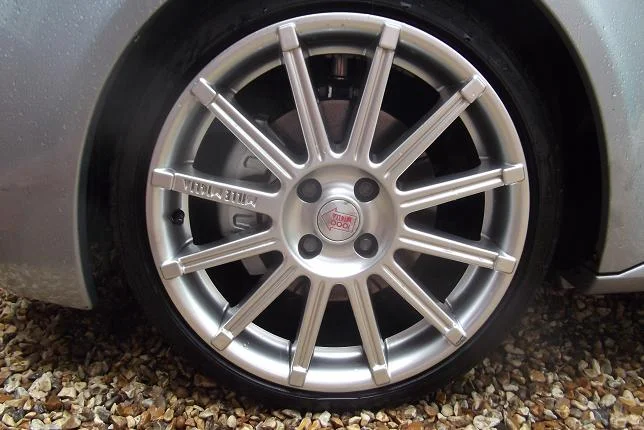

Mille Miglia T12's of my corsa.
Close up, Not bad considering ive had these alloys since 2004 !!!!!!!

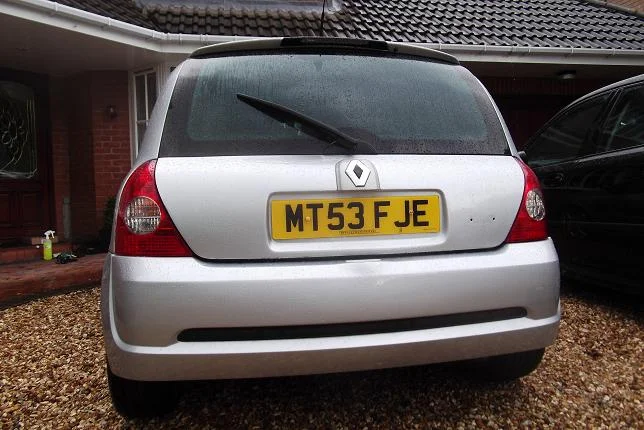

Rear end needs a carbon clio badge from inferno i think !
Rear side view.

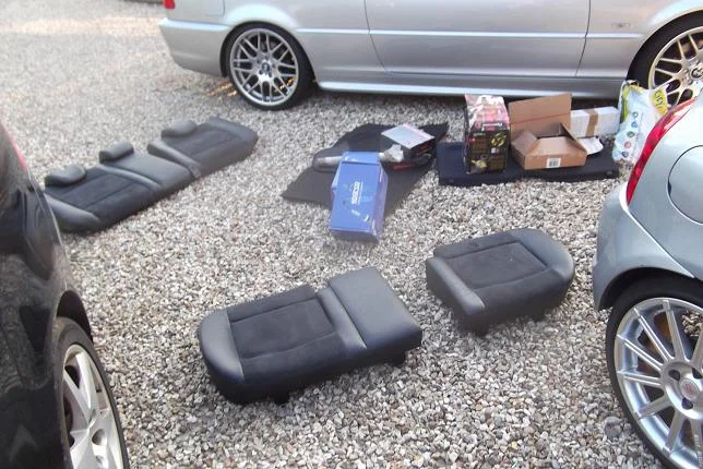

I decided to have another crack at stripping some of the weight out the car.
1st time round i discovered the torx bolt o the drivers side pillar at the bottom had a stipped head so i couldnt get the seat belt and rear door card out and i also found the same with the one for the rear passengers located on the roof !
The previous owner must have caused this !
Managed to get a torx bit to sit tight in the damaged head with the aid of a hammer and to my suprise i was able to undo it ! :approve:

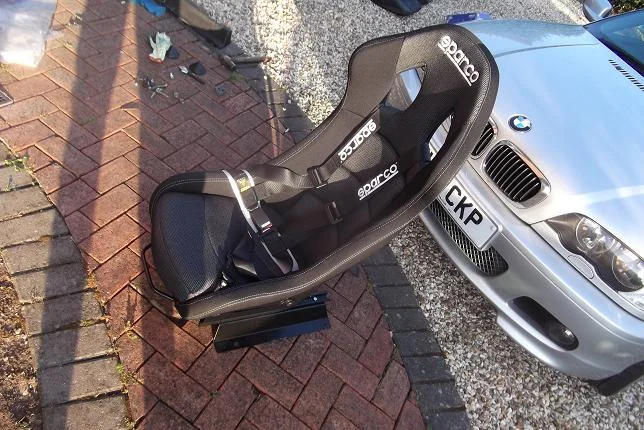

rear seats removed along with junk !
My bucket seats

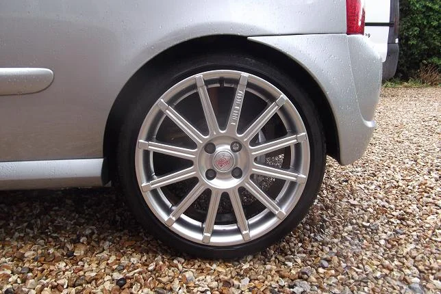

OZ ultraleggras fitted with Toyo T1R'S.

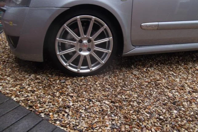

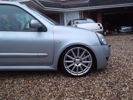

There my Mille Miglia t12's of my corsa ive owned for 10 years. They do suit the car really well
I just put them on because it had some horrid tsw's that someone had sprayed with tin cans !
ive got my 16 inch OZ's on now will take some pics.

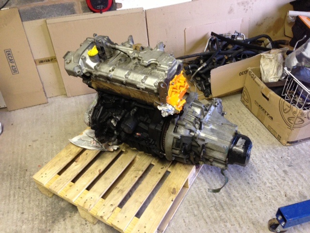

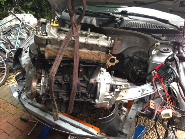

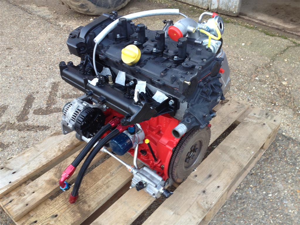

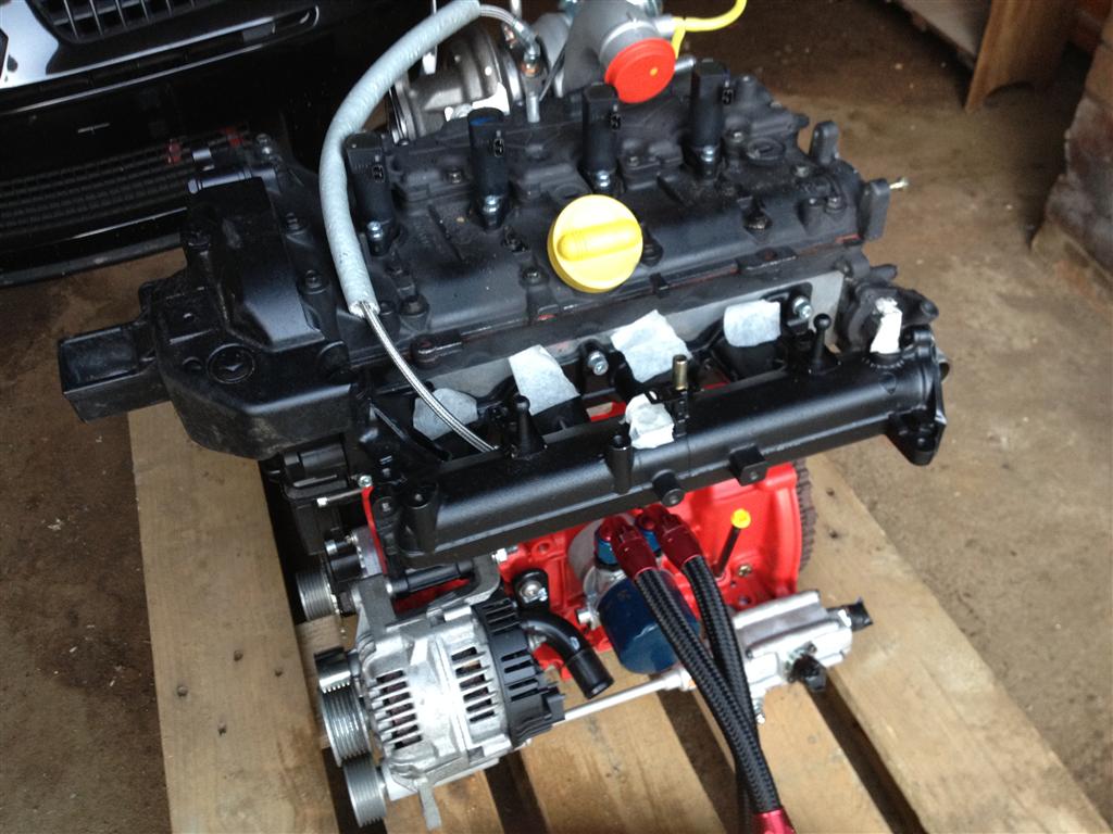

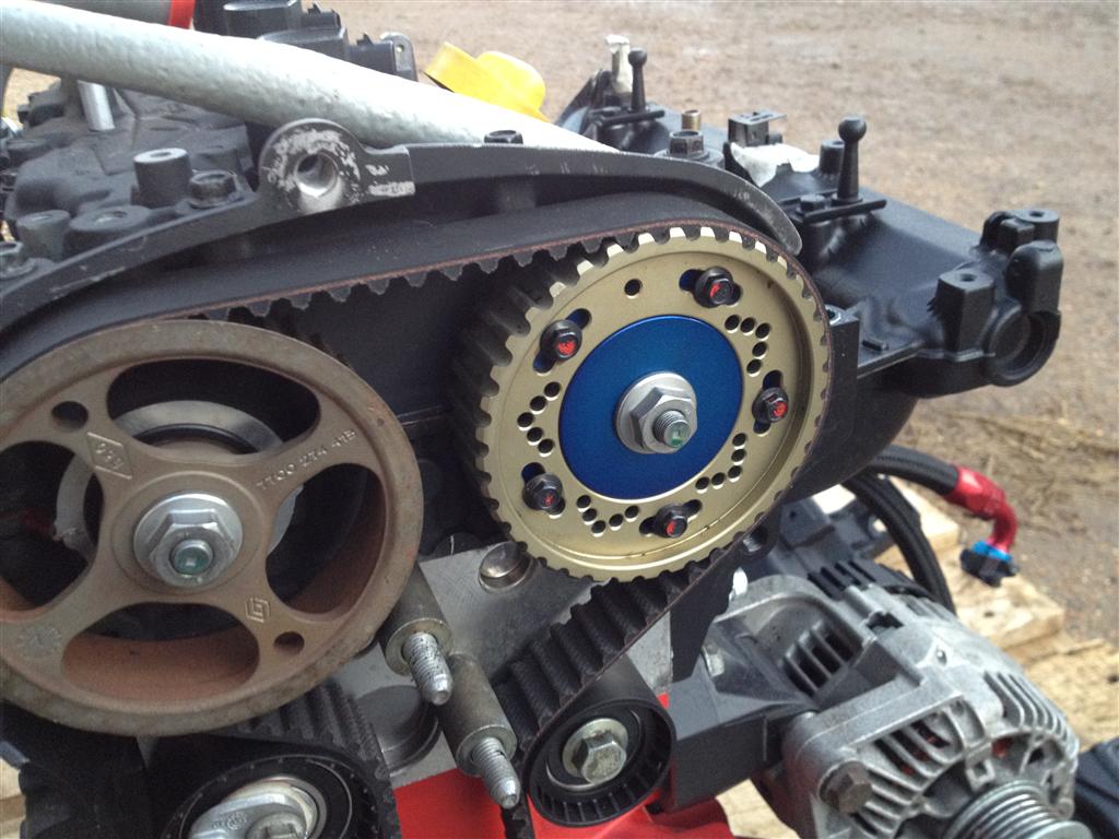

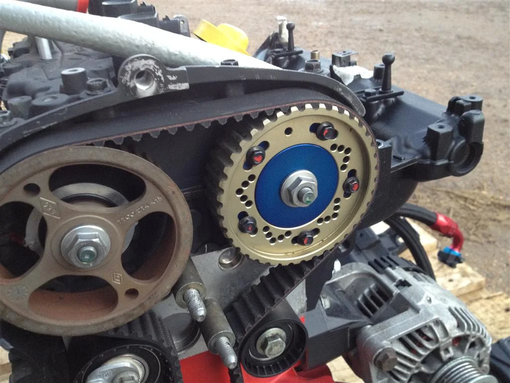

Engine removed about 2 month ago ready for engine block cleaning, cambelt replacement and new PAS pump to be fitted prior to putting on the road.
cant beleive ive owned this car so long and never driven it yet, keep having thoughts of selling everythink as i have to many cars / projects !
Not good thoughts !
anyone local fancy giving me a hand fitting new cambelt and PAS pump while the engine is out ?
  clio 172

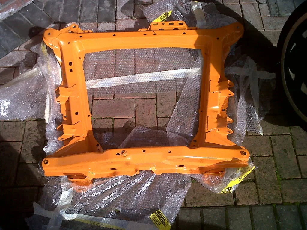

While the engine is out to get new cambelt, belts, dephaser, power steering pumps etc ive decided to clean afew parts and powdercoat.

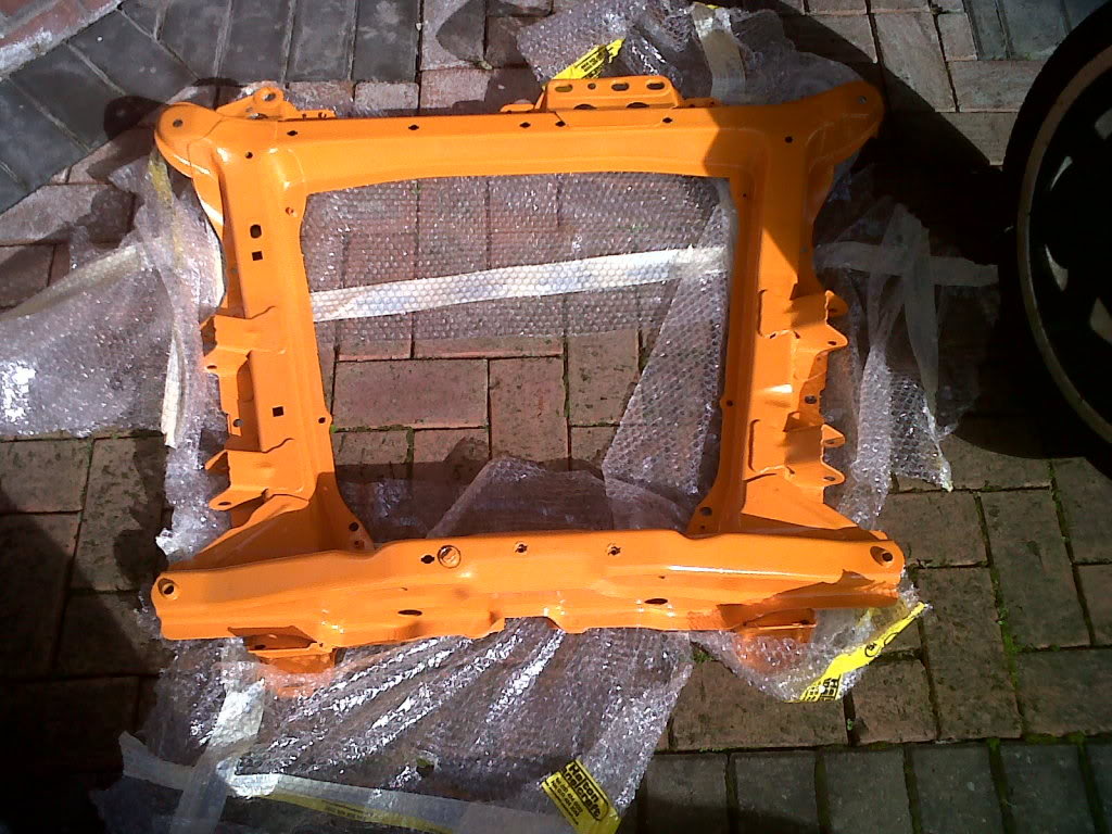

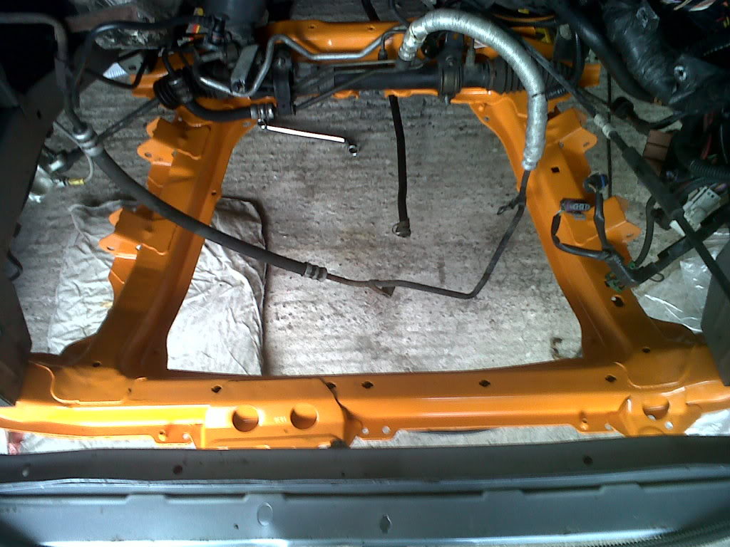

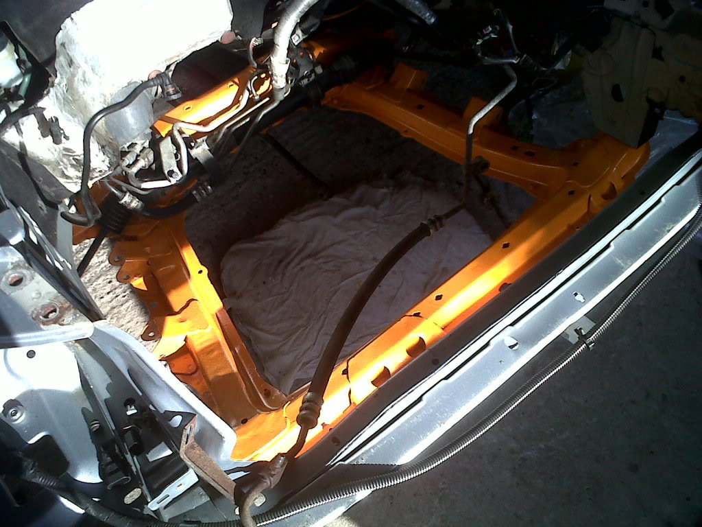

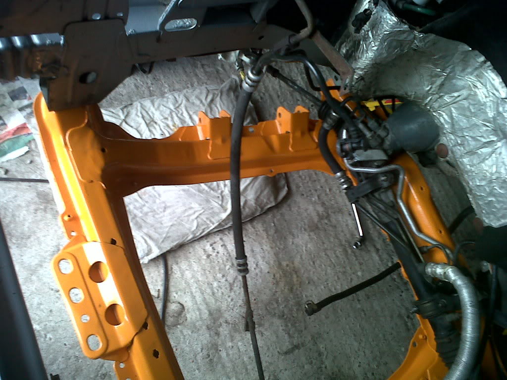

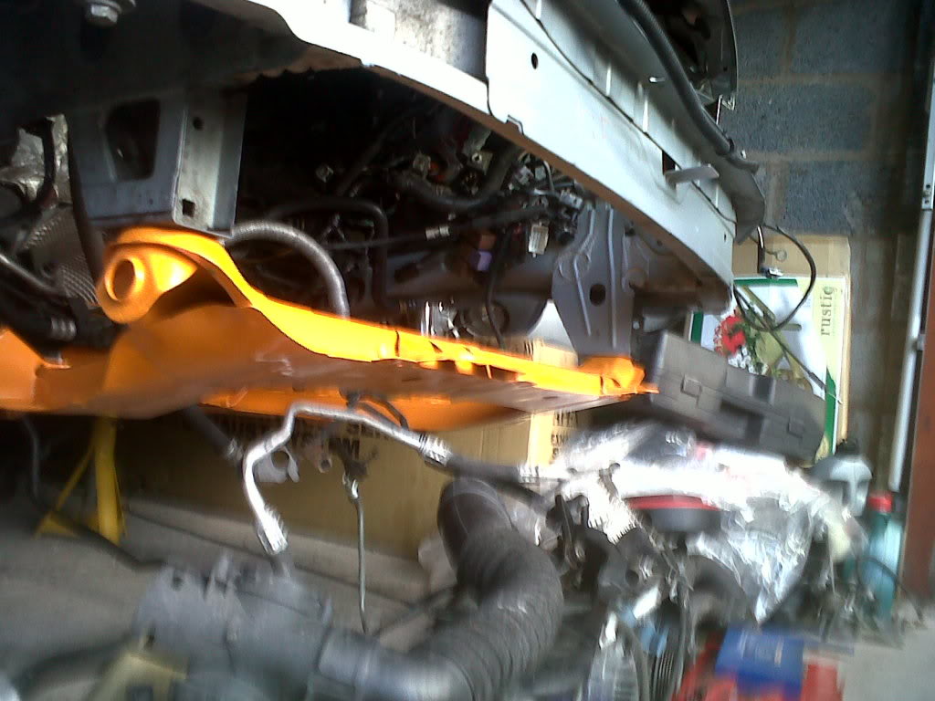

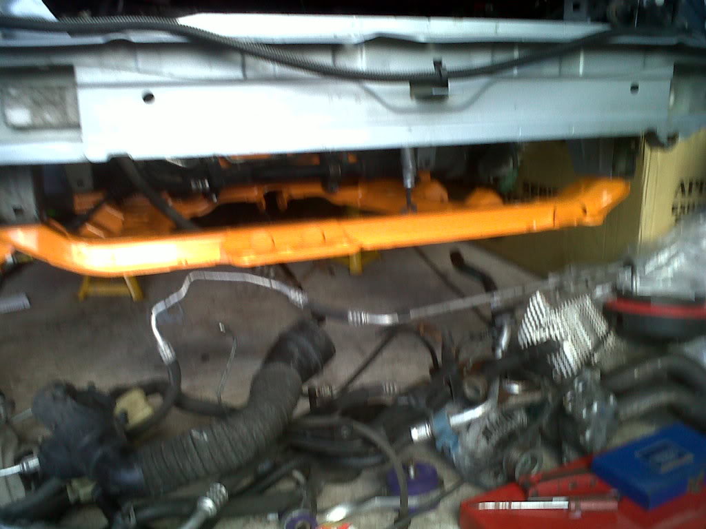

Spent today on the car doing afew jobs on the front end. Lower wishbones re-fitted along with hubs and discs and front wheels back on do I can move it out the garage tommorow.
Engine will be going down to birch wood when I get a day of work !

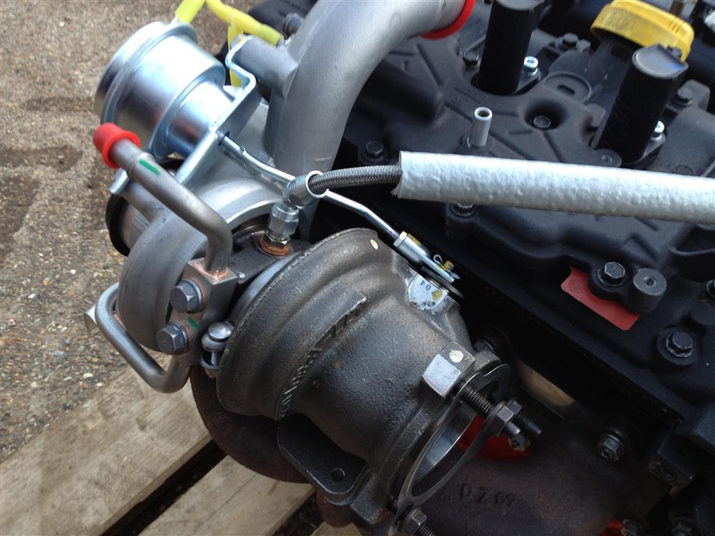

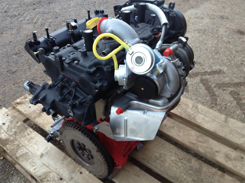

Turbo engine didnt happen as i was in a serious car accident at christmas ! :-(

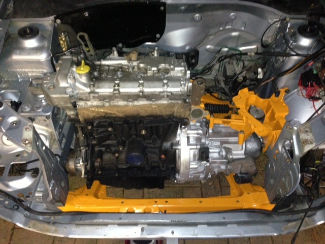

Engine & gearbox install
Engine and box in place
