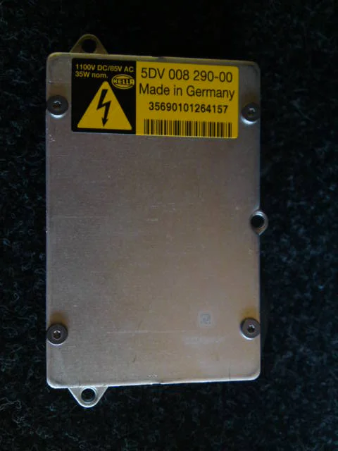

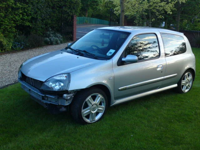

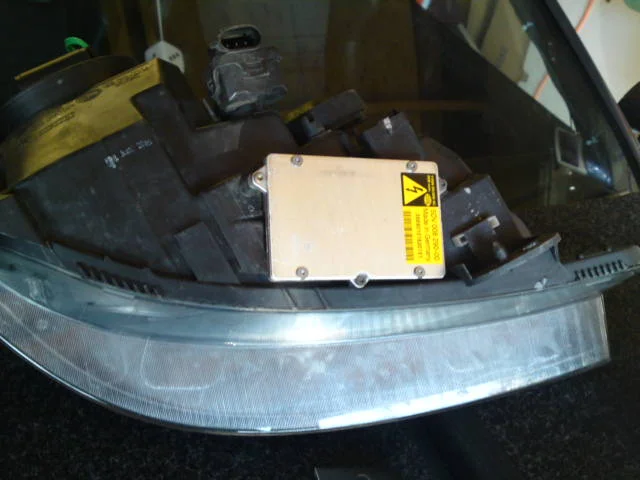

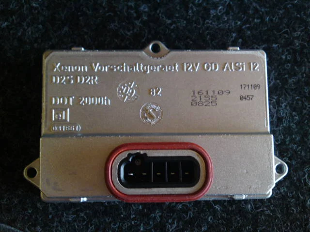

First job was to try and identify what was the issue with none of the xenons working ! Never had a car with xenons either so all a new challenge for me !
First thing was fuses were checked just to see it wasnt somethink as simple as this.
Next step was to remove the front bumper to gain access and remove headlamps for further investigation.
Ive never owned a clio or a renault and bought this with the intention to make it into a trackday car and to hopefully improve it.
I replaced both ballast units with brand new hella ones and also fitted two new xennon bulbs, a new ignitor was also required and the xenons were now working !

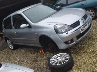

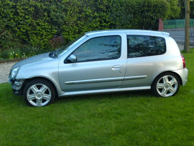

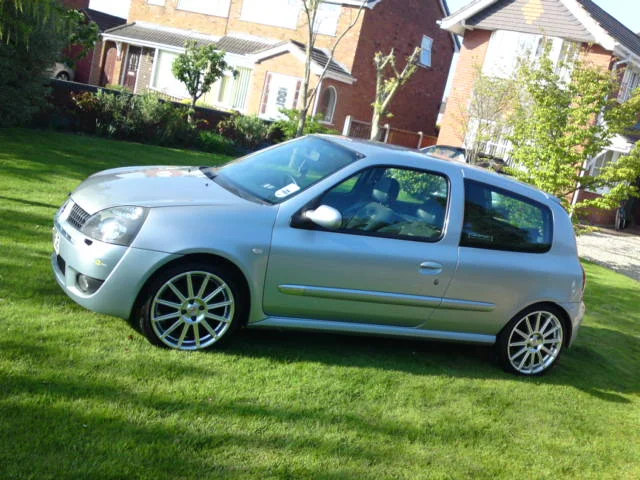

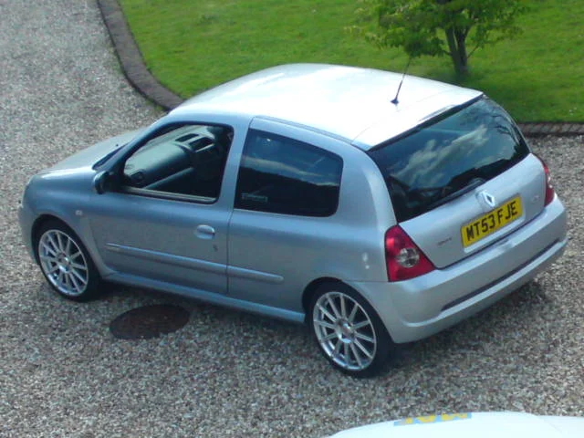

Purchased some 172 alloys so that i could remove the alloys that were on the car when i bought it. tyres need replacing so just a temporary measure until i decide what alloys to eventually put on it !

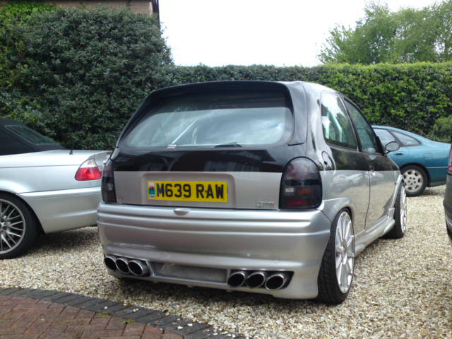

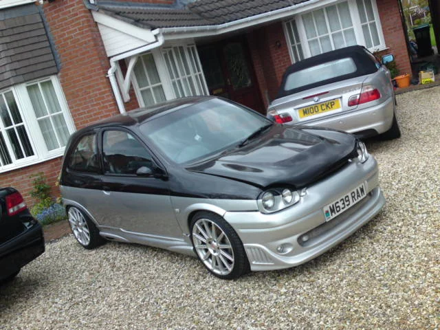

375.webp My first car was a 1.4 sri, owned 10 years now
376.webp I know most people will probably hate it
377.webp I fitted a 2.0 16v fully rebuilt in 2005 !
384.webp afew pic together, old and new !
Going to borrow the alloys of the corsa as there are more or less new tyres just until i get all my jobs done and decide what alloys to fit to the clio. :approve:

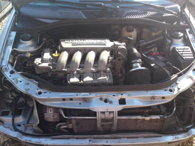

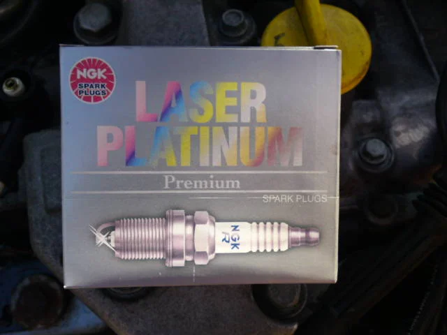

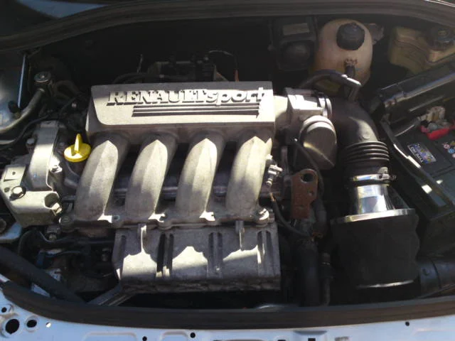

359.webp NGK R platinum plugs installed

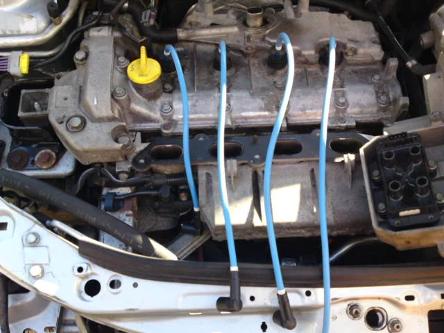

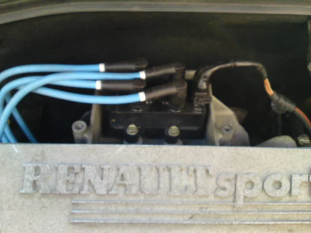

358.webp Pipercross induction kit installed

Replaced alloys with these just until all the jobs are complete.
Mille Miglia T12's, they dont produce these any more, would have been nice in 16 inch
They look really well but will only be on until i fit my KW coilovers next week. Ive got some 16 inch OZ alloys i will be running for track days

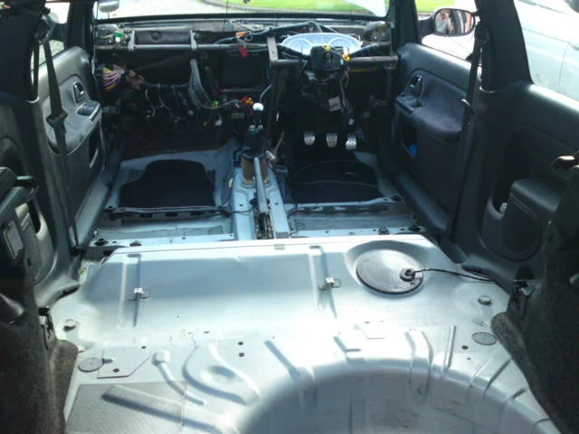

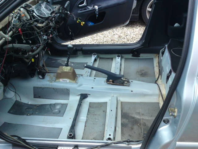

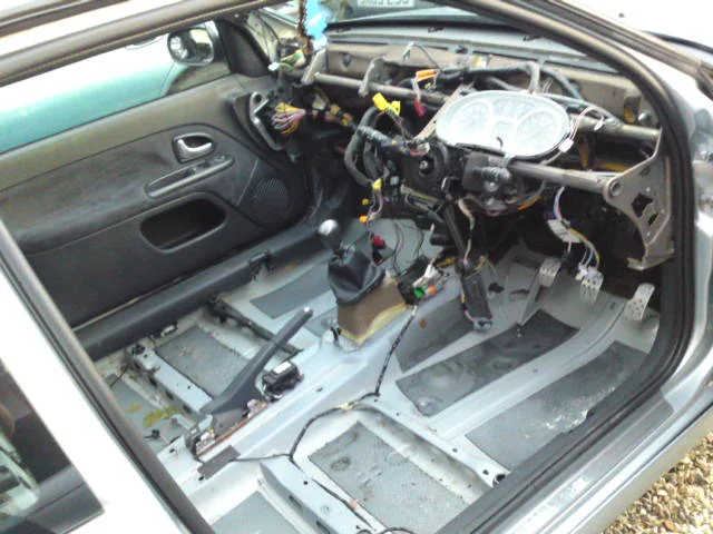

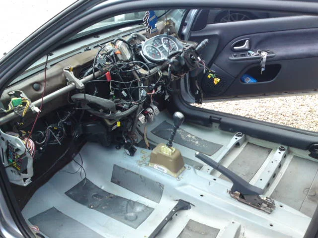

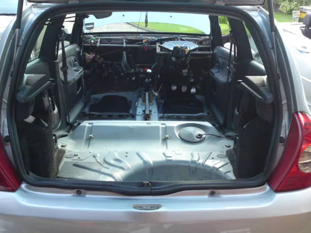

The weight reduction starts here !

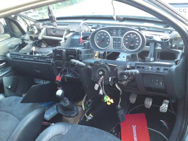

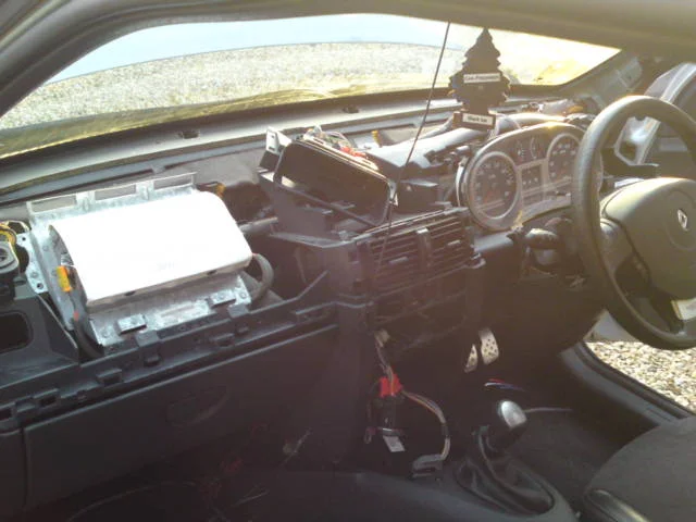

Removal of the upper dash first, airbag units and steering wheel.
Front seats removed , followed by lower dash and carpet

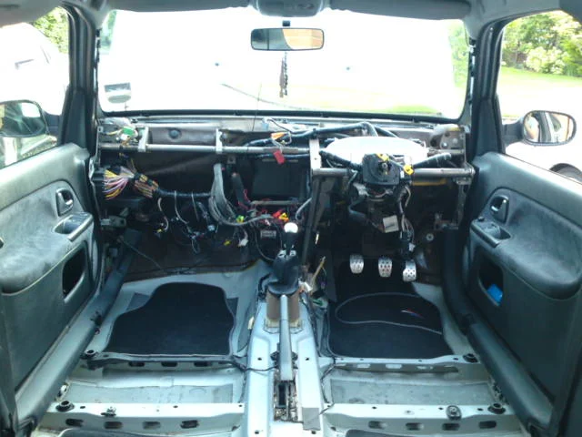

Rear seats also removed.
Started cleaning floorplan of car !
Got alot to fit but time and money is always a factor !

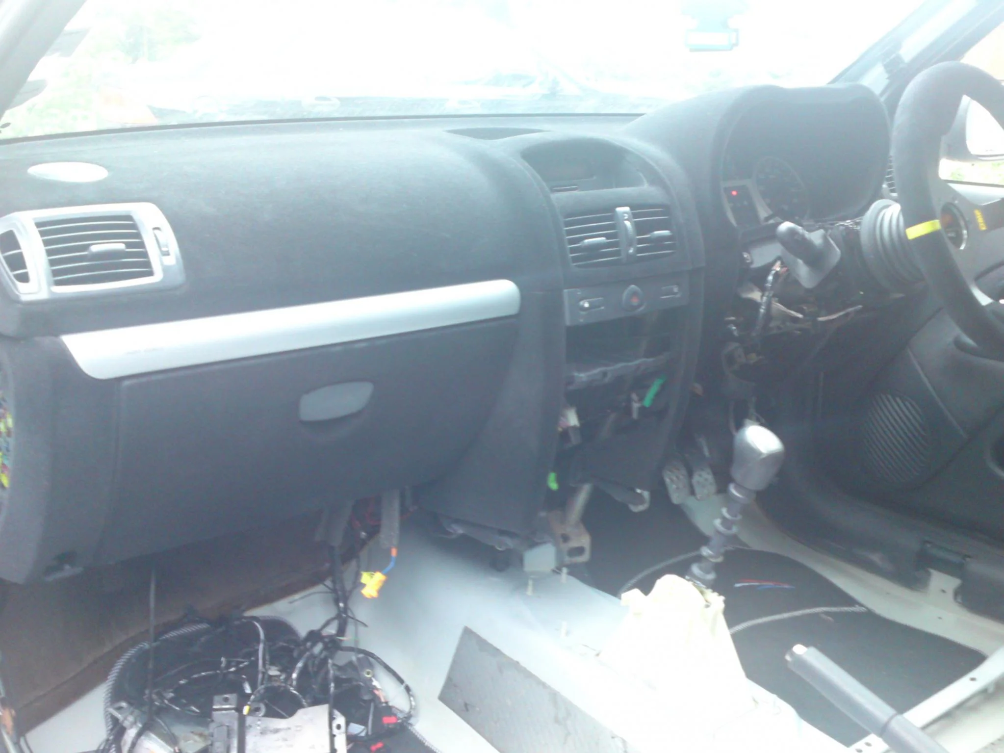

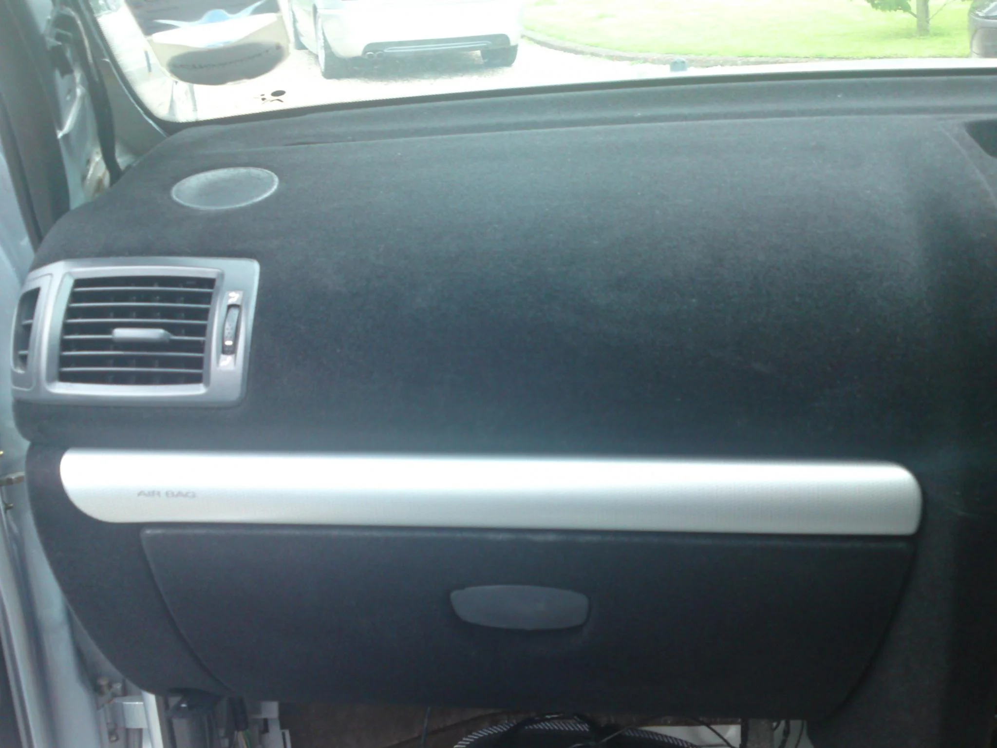

My dash is away at a local firm getting flocked,hopefully get it back on tuesday.
going to get this back into the car before fitting my new seats.

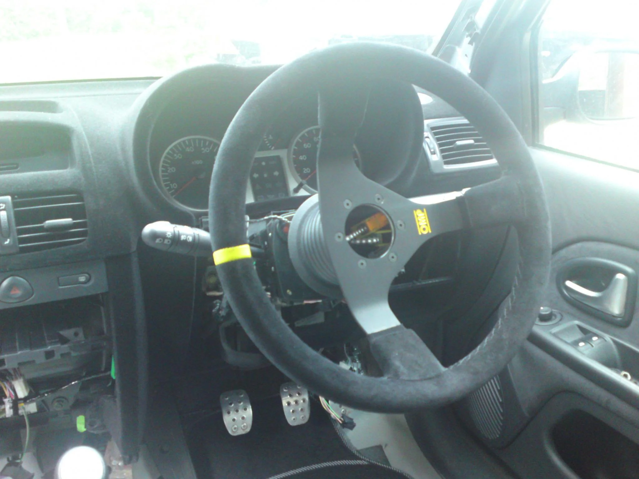

Off to Demon Tweeks in abit to pick up my steering boss and other subframe.
Hopefully all this workwill be worth it in the long run.

My dash is at a Local Company Getting Flocked as we speak, hopefully getting it back this weekend so i can fit it back into the car and get my bucket seats, harnesses and wheel in.
Hopefully should have some pics of the dash work very soon.
Wow looking awesome Raj, cant wait to get it back. These guys are top blokes, so informotive and helpful.
I think there work speaks for itself and they definately know what there talking about.
I will get some photo's up when i get it back so people can see the quality of Autoflocks work.
I would strongly recommend you talk to these guys if your interested in getting some flocking done.

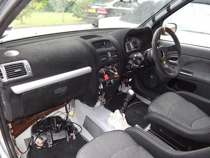

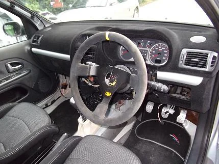

Just got my Flocked dash back from AutoFlock motor sport today, looks fantastic ! Really really happy with it :approve:
Just fitted it along with my new steering wheel, looks really good.
I will be getting some pics up very soon, to sunny outside to get any decent pics

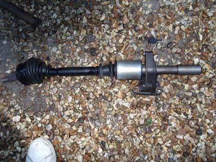

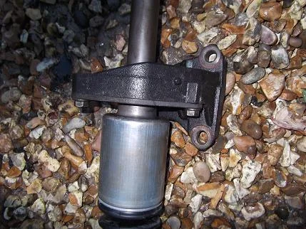

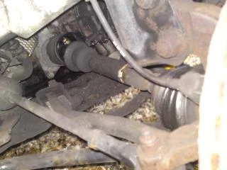

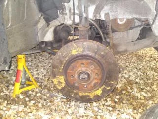

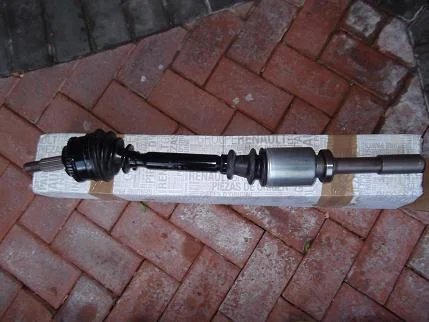

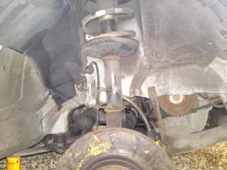

Drivers side inner CV boot rubber split, needs to be removed and replaced with a new OEM driveshaft.
Old brakes and shocks to be removed and replaced with new Brembo discs and new suspension.

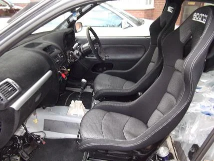

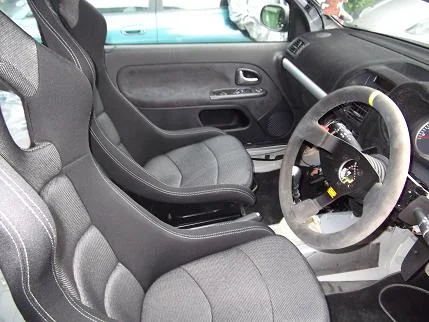

Seats and wheel test fitted along with the flocked dash.
Feels so much nicer with the seats and wheel and dash, feels alot more racey and kind of forget that its a clio !

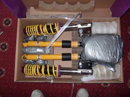

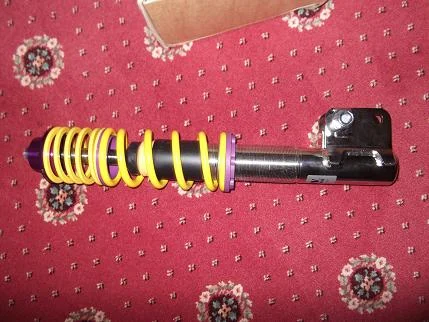

Need to get cracking and get the KW Variant 2 on and then get the OZ alloys on !
Next on the List will be fitting these to the car !
I run the variant 1 on my corsa and they are superb !
It will be on rails on these !
That dash is looking good. What brand are them coilovers mate, are the rears adjustable aswell, what is the range of drop on these then
Liam
The Coilovers are KW Variant 2 adjustable height and damping front and rear . Will check waht the range is on them.

Suspension is now on, New Brembo grooved discs and pads on front< just need to bleed them today and adjust suapension height as it is slammed on the front so going to raise it.
